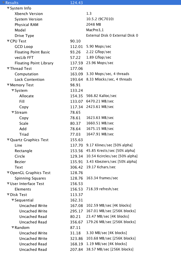

My configuration:
P5W DH Deluxe
Intel Pentium D 940 (dual core 3.2Ghz)
2x1024 Geil 667 Mhz
6600 GT 128M
2xSeagate 500G sata2 -- on the orange ports
Kalyway 10.5.2 - vanila kernel
tested with xbench - 124 ( looks slow to me. )
Should i upgrade or somtin ?
tnx :angel:
