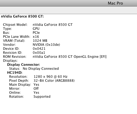

pippopippo1 Posted October 31, 2009 Share Posted October 31, 2009 Hi gurus, i still have problem with my SL installation: VIDEO I followed the above instructions and used EFI strings to set up my video card: 8500gt 1024M. It works fine at 1280x960, 60Hz, but: it does not show me if Quartz extreme is supported or not (as 10.5 does); i cannot switch to 75Hz ! AUDIO audio does not work with any kext (voodoo, AppleHda, etc..); Mybe I'll fix my problems patching my dsdt file but I have any competence to to that. attached my dsdt file (changed bin in txt in order to upload) Can You help me please? Attached my dsdt extraction from everest (in windows). My CPU: Core Duo E650 2,33 ghz my video: 8500 GT 1024M mb: p5k-vm 1 pci card for firewire 6g ram thanks a lot!! acpi_dsdt.txt Link to comment https://www.insanelymac.com/forum/topic/62111-how-to-asus-p5k-vm-guide/page/28/#findComment-1315650 Share on other sites More sharing options...

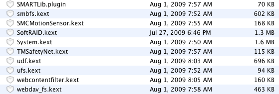

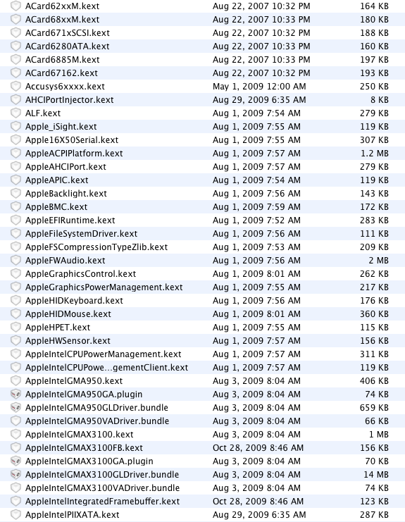

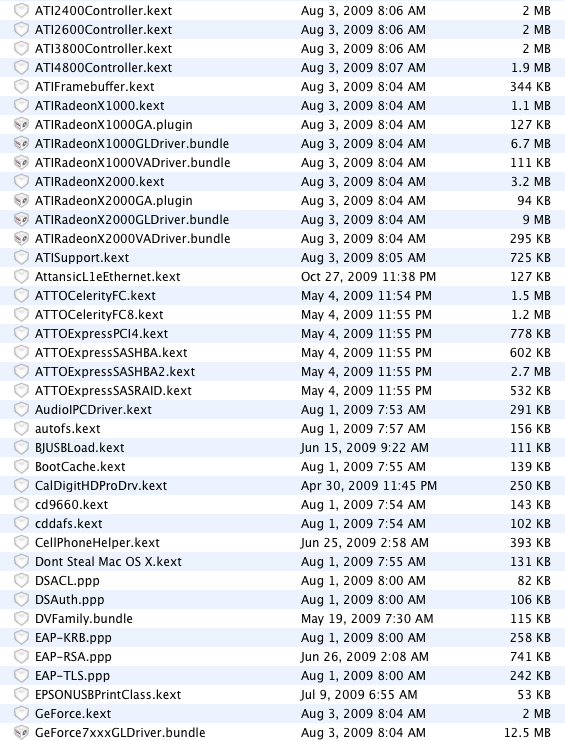

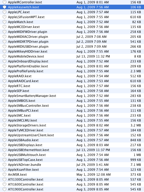

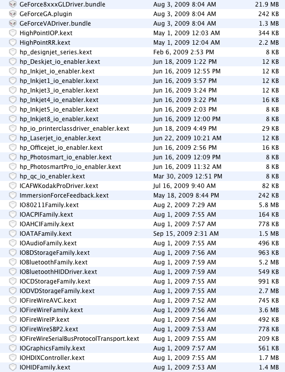

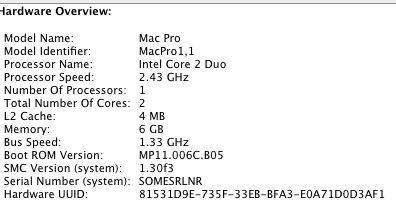

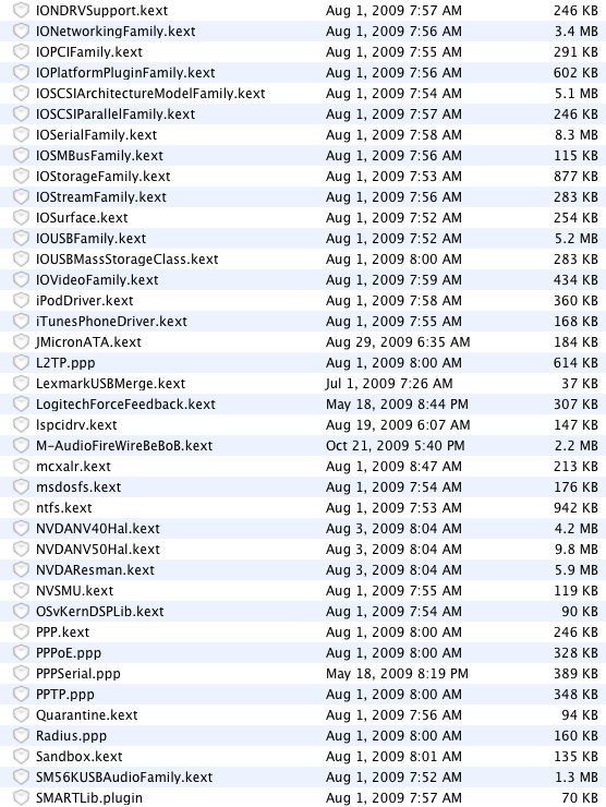

pippopippo1 Posted October 31, 2009 Share Posted October 31, 2009 BlackCH, You are so kind.. I did exactly what You suggested, but still no sound.. mybe there is some kext conflicting.. attached are my kext in System/Library/Extensions....could You check if there are some to delete? I also attached 2 System Profiler view (Hardware Overview and Graphics/Display). thanks a lot !!! Link to comment https://www.insanelymac.com/forum/topic/62111-how-to-asus-p5k-vm-guide/page/28/#findComment-1315958 Share on other sites More sharing options...
BlackCH Posted October 31, 2009 Share Posted October 31, 2009 You miss the original (vanilla) AppleHDA.kext on the S/L/E folder! You need that to get sound working with my kexts Link to comment https://www.insanelymac.com/forum/topic/62111-how-to-asus-p5k-vm-guide/page/28/#findComment-1316105 Share on other sites More sharing options...

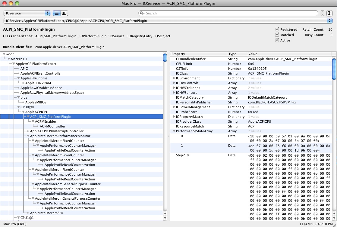

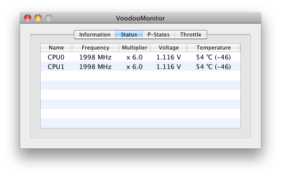

leo333 Posted November 2, 2009 Share Posted November 2, 2009 I used BlackHC's DSDT and the P5K-VM.kext but I still have high temperatures. CSTInfo shows in IORegistryExplorer and VoodooMonitor shows that the frequency is jumping. Only the voltage does not drop, indicating that C-States are not actually working. I did not use the smbios.plist that BlackHC provided because I would not get any temp readings if I set MacPro1,1 - I did not investigate this further and just set it to MacPro3,1 Also, in P5K-VM.kext in the C-States dict, the model to which these are applied are set to "DUMMY", is that correct? I would be glad for any help that I can get regarding this because I would really like to have a cooler and quieter Hackintosh! Thanks, Leon EDIT: BTW my sleep works fine, no USB replug issues or anything! EDIT2: OMFG, BlackHC you are now officially my hero! Keyboard wakeup works and my Magic Mouse reconnects without delay after wakeup! Just like a real Mac! Link to comment https://www.insanelymac.com/forum/topic/62111-how-to-asus-p5k-vm-guide/page/28/#findComment-1318224 Share on other sites More sharing options...
DB1 Posted November 2, 2009 Share Posted November 2, 2009 I used BlackHC's DSDT and the P5K-VM.kext but I still have high temperatures. CSTInfo shows in IORegistryExplorer and VoodooMonitor shows that the frequency is jumping. Only the voltage does not drop, indicating that C-States are not actually working. I did not use the smbios.plist that BlackHC provided because I would not get any temp readings if I set MacPro1,1 - I did not investigate this further and just set it to MacPro3,1 Also, in P5K-VM.kext in the C-States dict, the model to which these are applied are set to "DUMMY", is that correct? I would be glad for any help that I can get regarding this because I would really like to have a cooler and quieter Hackintosh! Thanks, Leon EDIT: BTW my sleep works fine, no USB replug issues or anything! EDIT2: OMFG, BlackHC you are now officially my hero! Keyboard wakeup works and my Magic Mouse reconnects without delay after wakeup! Just like a real Mac! I'm intrigued that a problematic dsdt for BlackCH works flawless for you - I also am having sleep issues. Can you provide more detail on your hardware and anything else plugged in (USB / Firewire / bluetooth etc.) Link to comment https://www.insanelymac.com/forum/topic/62111-how-to-asus-p5k-vm-guide/page/28/#findComment-1318248 Share on other sites More sharing options...

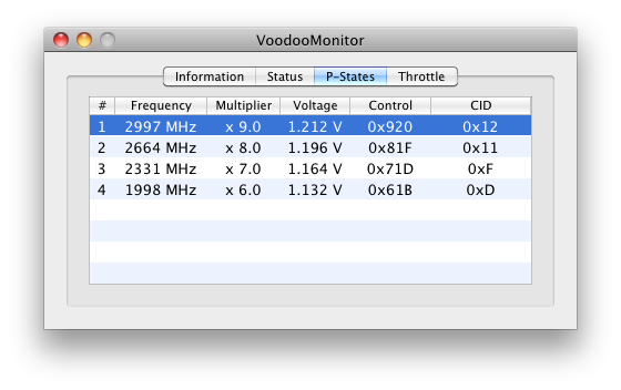

DB1 Posted November 3, 2009 Share Posted November 3, 2009 Leo333 Can you post also your dsdt.dsl and the output from kextstat in terminal also a screen grab of voodoo monitor P-states tab. I have spotted something that might sort out your temperatures issue. And have a lead on my sleep issues. I'm busy at work at the moment but will have some time this evening to try and sort things out (GMT). Thanks Link to comment https://www.insanelymac.com/forum/topic/62111-how-to-asus-p5k-vm-guide/page/28/#findComment-1318686 Share on other sites More sharing options...

leo333 Posted November 3, 2009 Share Posted November 3, 2009 Leo333 Can you post also your dsdt.dsl and the output from kextstat in terminal also a screen grab of voodoo monitor P-states tab. I have spotted something that might sort out your temperatures issue. And have a lead on my sleep issues. I'm busy at work at the moment but will have some time this evening to try and sort things out (GMT). Thanks Thanks for taking the time to look into my issues, I really appreciate that! Now that you say it, my voltage does actually drop about 0.02 below the lowest P-State, but that might just be that the board is a bit weirdo in that regard. I am actually using exactly BlackHC's DSDT, I will post it anyway. EDIT: @BlackHC: I tried using your smbios.plist with MacPro1,1 And the modified fakeSMC.kext. I can now see the temperature in iStat (Awesome!) but it is still at the usual 54˚C idle EDIT: 0.02 Volt instead of 0.2 Volt DSDT.dsl.zip stockholm_kextstat.txt Link to comment https://www.insanelymac.com/forum/topic/62111-how-to-asus-p5k-vm-guide/page/28/#findComment-1318812 Share on other sites More sharing options...
DB1 Posted November 4, 2009 Share Posted November 4, 2009 Thanks for taking the time to look into my issues, I really appreciate that! Now that you say it, my voltage does actually drop about 0.02 below the lowest P-State, but that might just be that the board is a bit weirdo in that regard. I am actually using exactly BlackHC's DSDT, I will post it anyway. EDIT: @BlackHC: I tried using your smbios.plist with MacPro1,1 And the modified fakeSMC.kext. I can now see the temperature in iStat (Awesome!) but it is still at the usual 54˚C idle EDIT: 0.02 Volt instead of 0.2 Volt Leon, I notice your IOREG shows only 2 Performance step arrays although Voodoo monitor output is showing 4 p-states & they are auto injecting as you have nothing in dsdt to inject them. I had the same at the outset of trying speed stepping so I injected via dsdt & get the six native to my CPU. Also I see in IOREG CStateOverride - Boolean - true, which i have not seen in any of my playing with speedstep I just have CSTinfo. BlackCH do you see this value in yours? I'm thinking that this is because you are auto loading p-state but over riding c-state where i'm injecting both. Attached is my latest dsdt brought up to same as MasterChief V3.0 + a few alterations he will include in his next update. I have modified the PSS section to reflect the p-states for your CPU so you should see 4 p-states in IOREG. I'd appreciate if you can try it and feedback. If it works for you and you still have all sleep functionality it will confirm for me the the dsdt is ok and that mine & blackCH's sleep problems are related to our CPU's or Video cards or the method we use for video injection. V3.0_dsdt.zip Re temperatures: the values you see in Voodoo monitor & istat are incorrect for our mobo. The best way to check is via Hardware monitor in bios but obviously you will only see an idle temp. I noticed it out by 12c (Voodoo out by approx 10c). What i did was to alter the tjmax value on the plist for the new fakeSMC (by oldnapalm) from 100 to 90 and recompiled it, now istat shows me a value similar to what I see in bios hardware monitor. It's possible similar can be done with Voodoo monitor but I've not looked at that yet. fakesmc.kext.zip Link to comment https://www.insanelymac.com/forum/topic/62111-how-to-asus-p5k-vm-guide/page/28/#findComment-1319253 Share on other sites More sharing options...

BlackCH Posted November 4, 2009 Share Posted November 4, 2009 Leon, I notice your IOREG shows only 2 Performance step arrays although Voodoo monitor output is showing 4 p-states & they are auto injecting as you have nothing in dsdt to inject them. I had the same at the outset of trying speed stepping so I injected via dsdt & get the six native to my CPU. Also I see in IOREG CStateOverride - Boolean - true, which i have not seen in any of my playing with speedstep I just have CSTinfo. BlackCH do you see this value in yours? I'm thinking that this is because you are auto loading p-state but over riding c-state where i'm injecting both. No, I dont have that value on the IOreg at the moment. I didnt add the PPS data on the DSDT 'cos it seems to work fine just with the ones on the SSDT tables. My CPU has only two states and they appear in the IOreg just fine. I had 'CStateOverride' value while playing with the SMC_PlatformPlugin.kext. Whenever I had this value on the IOReg my CPU was hotter as before(+10-15°); This changed when I replaced the 'iMac5,1' (I dont remember exactly if that was the model I replaced, sorry) with MacPro1,1 in the plist. This data is included in the P5K-VM.kext if you want to compare it with your legacy kext. Link to comment https://www.insanelymac.com/forum/topic/62111-how-to-asus-p5k-vm-guide/page/28/#findComment-1319769 Share on other sites More sharing options...
leo333 Posted November 4, 2009 Share Posted November 4, 2009 @DB1: Your DSDT works like a charm, I can sleep, wake up, it now even steps up to the multipliers in between, i.e. I no longer get jumping between 6.0x and 9.0x but just occasionally it jumps up 7.0x. I think I am going to replace BlackHC's DSDT with yours permanently. Thanks for taking the time to figure out my _PSS table! Now, I think the CStateOverride was because I had booted with dropSSDT=yes. Now that I booted without this argument it's gone... Will update later when I reboot to check if it really is that. Temperatures: I checked in the BIOS and actually in there they were about 54˚ idle as well. At first I nearly freaked out but then I googled and discovered that this CPU is known for reporting whacky temperatures. Just google "E8400 temperature problems" and you'll see what I mean. The machine has been running stable for over a year now with occasional video encoding and games. Ubuntu also reports 54˚C, so I am skeptical about wether this value reported by the CPU is correct. I did a load test and it went up to a warm but not alarming 62˚C. An idle-load difference of 10˚C seems about right, but that still does not explain why I did not see the temperatures drop dramatically after getting C-States to work but only by about 5˚C. Maybe the temperature is stuck at 50˚C - I have actually never seen it below 50˚C, even after waking up from sleep in a cold room it still reports 50-51˚C - weird?! Anyway, I am not too worried anymore about the temperatures anymore because the 1001 BIOS fixed my fan issues - my computer is now pretty quiet - not entirely but it's OK. I still have to keep my case open a tiny bit but that's fine, it doesn't bother me too much. If you want me to test anything else in relation to your sleep issues that helps you pinpoint why it's failing I would be happy to do so - I'll be watching this thread. Cheers! Leon Link to comment https://www.insanelymac.com/forum/topic/62111-how-to-asus-p5k-vm-guide/page/28/#findComment-1319824 Share on other sites More sharing options...
