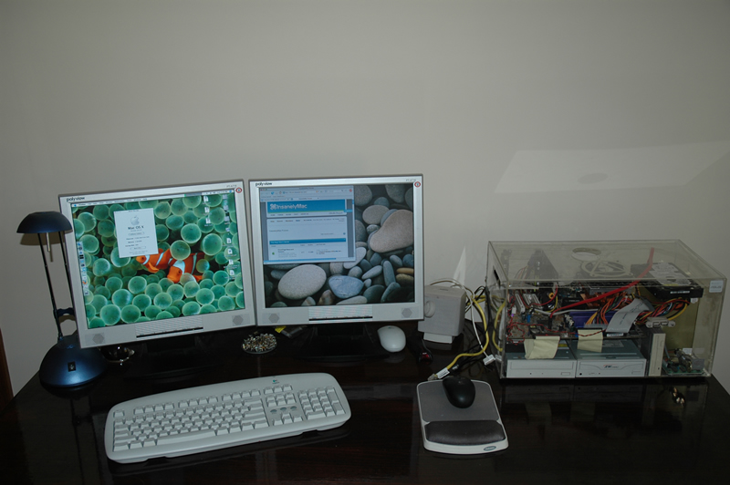

gdog Posted March 24, 2007 Share Posted March 24, 2007 (edited) Summary: How I chose, built, and configured a silent dual-head BadAxe2 / Core2Duo / GeForce 7600 / OSX 10.4.9 / WinXP system, and how you can do so too! I've just completed buildling my 10.4.9 BadAxe2 system, and now that I have everything working perfectly, I thought I'd write it up, end to end, in case it could help someone else. My primary goal going into this was to build a Core 2 Duo box with dual monitor support. I've been using two monitors for years, and can't contemplate going back to just one. The Mac Pro is far too expensive, and the mac mini can't drive two monitors. The iMacs are out because I don't want to bundle a 20" monitor that could be useful for many years with internals that I'll want to upgrade in a couple years. Unfortunately, Apple's desktop product line is a bit thin, so I decided to build. My next goal was to achieve as close to 100% compatibility as possible. After reading more threads here than I can count, I decided to follow bofors' lead in many regards. Thanks bofors for all your tutorials! Before I dive in further, I need to thank some people. There are literally dozens of different people whose posts were invaluable through this process, but a few that stand out are: bofors, devilhood, taruga, JaS, Rammjet, munky, and DiaboliK. I'm sure I'm forgetting to mention many people whose posts I learned from, but when I was building, I was paying more attention to the content than the authors a lot of the time :-) I'm going to break the tutorial into three posts. The first covers my research and hardware ordering. The second covers the physical build. The third covers software and driver installation. Part 1: Pre-build Planning After reading more forum threads than I can remember, it seemed as though my best bet of a painless build would be with an Intel BadAxe2 motherboard and a GeForce 7600 graphics card. The BadAxe2 (BOXD975XBX2KR) was a bit more money than I had hoped to spend, but it has working on-board gigabit ethernet, audio, SATA, USB, and Firewire, and it leaves the door open to possible overclocking in the future. I paid $189 at MWave.com. For video I chose the XFX GeForce 7600 GS. The GS was 1/3 less expensive than the GT ($80 vs. $120), and I don't really need a high-end card. Also, it has a heat sink instead of a fan, so it will be quieter. I paid $80 (after $20 rebate) from TigerDirect.com For a case and power supply I went with the Antec Sonata II. I built my Fedora Linux server in my basement about four years ago with the original Sonata case and was quite happy with it. I paid $50 (after $50 rebate) from NewEgg.com. I decided on the Core 2 Duo e6300 CPU after seriously considering going for the e6400 instead. In the end I decided the performance difference wouldn't be that big, especially if I tinker with overclocking. I paid $179 for the e6300 at Frys.com. Last up was 2 GB of memory. I ended up ordering two Corsair ValueSelect DDR2-667 sticks from NewEgg.com for $65 each. The total money spent was $628 for the parts above, plus a little under $50 for all the shipping (one of the problems with ordering everything from different stores). I already had a spare Sony DVD+-RW drive lying around, and a Maxtor 250GB SATA hard drive, which completed the hardware list. After waiting a couple days, things started to arrive... on to the build! Part 2: Hardware Setup I'm not going to go into excruciating detail here. The instructions included with the BadAxe2 are pretty thorough. Below is the high-level view of what I did. Feel free to ask if you have any questions! Also be sure to look through some of bofors' posts (here and here for example) for similar information. Install the RAM into the motherboard Install the CPU into the motherboard Remove the Antec Sonata II "air duct" system Install the motherboard into the Sonata II (total of 10 brass standoffs and philip screws) Install the Intel heat sink and fan onto the CPU. The heat sink assembly that came with my e6300 already had some silver heat transfer "goo" applied to it, so I went with that. Connect the CPU fan power to the motherboard Connect the 2x12 power cable from the power supply to the motherboard Connect the 2x2 power cable from the power supply to the 2x4 power connector on the motherboard using the 2x2 to 2x4 adapter that came with the BadAxe2 Connect a 1x4 molex power plug (the type used to power IDE devices) from the power supply to the PCIE power input on the motherboard (right behind the ethernet jack). This isn't strictly necessary, but can't hurt. Connect the other 1x4 molex on that power cable to the 120mm fan at the back of the case. Connect the fan speed monitoring cable from the power supply to one of the 3 fan plugs on the motherboard. Connect all the front-panel connections (USB, Firewire, Audio, Power, Reset) as per the diagrams included with the BadAxe2. I had a leftover "speaker" connector from the front of the case which I wasn't sure what to do with. I also chose not to plug the blue LEDs into any power. Install the GeForce video card into the PCIE slot closest to the CPU. Pop out one of the 5 1/4" bay covers and install my IDE DVD drive onto the tray rails hidden on the back of the cover. Slide the DVD drive in, and connect to power and IDE via the cable that came with the motherboard. Install my SATA hard drive onto one of the 3.5" drive trays. Slide the hard drive in, connect to SATA power, and connect to SATA port #1 (the lower-left of the four black SATA ports on the motherboard) Plug the case in, cross my fingers, and power it up! Here's a photo of the completed hardware build: Part 3: Software setup Things you'll need: Mac OS X 10.4.8 [JaS AMD-Intel-SSE2-SSE3 with PPF1] DVD The following files, either on a CD, DVD, USB drive/stick, or network drive: JaS.10.4.9.Combo.Update.Intel.SSE3 Taruga's AppleHDAPatcher_v1.15 from here The Sigmatel 9274D config file STAC9274D_83847621.txt from here Diabolik's Natit.Dual.7600.Series.Installer from here Partition planning: Partitioning always comes down to personal preferences. OSX will be my primary operating system, so I'm going to make a pretty small WinXP partition (20 GB), two 60 GB partitions for OSX (the second will be for occasionally backing up my OSX partition via CloneTool or something similar), and the rest will be a "data" partition. Initial WinXP install: Boot from WinXP SP2 install CD Delete any existing partitions Create a 20,006 MB partition (C:) Do NOT try to create any additional partitions yet! If you do, they will end up as extended partitions, which is not what you want. Select your new partition in the list and hit ENTER for Windows install Choose to format as NTFS Quick WinXP installs, asks a few questions, reboots, installs, etc. Hopefully you're familiar with this already, so let's skip ahead... WinXP installation complete! Now a few more things before we start on OSX... WinXP configuration: Go into "My Computer" and give the WinXP disk a name (I called mine WinXP) so it's easier to identify later in the OSX Disk Utility. Insert the "Intel Express" driver CD from the BadAxe2 motherboard kit and the installer should run. Select "Chipset", "Audio", and "Network" driver install. It'll reboot twice during install. Insert the "XFX GeForce 7600" driver CD and select "video drivers" and then "windows driver". It'll reboot when done. Next you should update the BadAxe2 BIOS to the latest version if you haven't done so yet. Go to http://www.intel.com/products/motherboard/d975xbx2/tools.htm and select "BIOS Updates" link. On the "Downloads" page, select the latest version of the BIOS. At the time of this writing, it's 03/15/2007. The next page will have four download choices. Choose the one with "EB" (Express BIOS) in the name. Run the downloaded program to update the BIOS. The machine will shut down for a few seconds, then start up again and do the update, and will then reboot again. Partitioning: There are plenty of ways to create the additional partition(s) needed for OSX. One straightforward way that I used a couple times was DISKPART as described in devilhood's dual-boot tutorial. For example: Run -> diskpart list disk select disk 0 create partition primary size=60000 id=af select partition 1 active exit If you prefer a visual interface, you can go into WinXP's "Administrative Tools" control panel, run "Computer Management", and select "Disk Management" from the choices on the left. Then you can create partitions using the GUI (right-click on the "unalloced space" to create a new partition). Just be sure they are all "primary" partitions, do not assign a drive letter, and do not format them. Initial OSX Installation: Insert the "Mac OS X 10.4.8 [JaS AMD-Intel-SSE2-SSE3 with PPF1]" DVD and reboot. Be sure to press any key to boot from DVD when it asks. The installer can take a long time to load, be patient. Select a language from the menu and click the blue arrow to continue Next up is the "Welcome to the JaS OS 10.4.8 AMD Intel SSe2 SSe3 Installer" menu. Do NOT start installing yet. Instead, run "Disk Utility" from the Finder "Utilities" menu. The finder can be slow to respond to mouse clicks, so be patient. Disk utility should list all the partitions created earlier in windows. Select the one you want to install OSX on, click "Erase", choose Volume Format "Mac OS Extended (Journaled)", give it name (mine is named "OSX" - pretty clever, eh?), and click "Erase". Quit Disk Utility, and the JaS Installer will re-appear. Click "Continue". Choose the destination partition -- the one you just erased and gave a clever name to -- and click "continue". Select the appropriate packages. I unchecked "Printer Drivers" and "Language Translations", and I checked "X11". Most importantly, be sure to check "JaS Intel 10.4.8 ATA kexts". Leave "Support for the most common hardware" and "Titan Nvidia and ATI Support" unchecked. Click "Install", and feel free to click "Skip" when the really long/slow "Checking your installation DVD" appears. Wait a while for the install to complete, and then the installer will reboot. Take the 10.4.8 DVD out of the drive before the boot starts. This way you'll know that your Darwin boot loader is working correctly. Initial OSX Configuration: Select a country Select "Do not transfer my information" Select a keyboard Skip the "Apple ID" screen by clicking "Continue" At the "Registration Information" screen, hit COMMAND-Q to bring up the "Skip" menu, and click "Skip". Create your local user account and click "Continue" Select your timezone and click "Continue" Leave the date and time alone and click "Continue" We're done! At this point OSX is running and I have mirrored output on both my monitors at 1024x768. We'll fix that shortly. After a few seconds I get a pop-up from the Apple Updater saying new software is available, so the onboard ethernet seems to be working! Click cancel, you can update things later. Now you need to get the other utilities mentioned earlier onto your OSX drive. I got them from a network share on my Linux server in my basement by pressing COMMAND-K and entering the server address as "smb://hostname/sharename". You can also copy them from a USB thumb drive, or a CD/DVD you burned earlier, etc. 10.4.9 Upgrade: The very first thing to do is run the "JaS.10.4.9.Combo.Update.Intel.SSE3.pkg" app. The install is very straightforward, just select your OSX partition and click "Install". You'll be prompted for your password. The installer sets a default front-side-bus (FSB) speed of 200MHz, but for an e6300 it should be 266. Use your favorite technique to edit /Library/Preferences/SystemConfiguration/com.apple.Boot.plist. I open Terminal and use vi. Change the "Kernel Flags" section so it looks like: <key>Kernel Flags</key> <string>fsb=266</string> While you're in there, if you want to be able to choose which OS to boot, add the following lines to give a 4-second boot menu: <key>Timeout</key> <string>4</string> After saving the file, reboot. I've been through this process about 6 times, and a few times I was able to continue on to the below steps without rebooting, but the last two tries, I got a crash when trying to mount the MPIP image if I didn't reboot first, so better safe than sorry. After the reboot, run the "MPIP103_10.4.9.SMB.CIFS.AFP.FIX.dmg" application that came with the JaS 10.4.9 Update. This will fix SMB file sharing, and takes about a minute. Natit Video: Now run diabolik's "Natit.Dual.7600.Series.Installer.mpkg". As before, select your OS partition, and in the package selecter, leave AGPGart unchecked. Very simple and easy. Sigmatel Audio: Last, drag the "STAC9274D_83847621.txt" file onto Taruga's "AppleHDAPatcher_v1.15" app to get audio working. Reboot one last time. Finishing up: Assuming everything worked right, you're back in OSX 10.4.9, with working audio and dual-head video! Open the "System Preferences" app from the dock and select "Sound". The "Output" section should list "Internal Speakers" and "Digital Out". Assuming you have speakers plugged into the green jack on the motherboard, you should hear a macos "chirp" when you click on the "output volume" slider. Click "Show All" at the top of the window, and this time select "Displays". A resolution selector should appear on both displays to allow switching to 1280x1024 or whatever your display's native resolution is. You can also click on "Arrangement" and drag the displays around so the logical placement matches the physical placement. For example, my second display is to the left of my primary. I also recommend clicking "Color" on each display window and running the "Calibrate -> Expert Mode" assistant. Now you can also go to the "Finder" menu and select software update, and install all those updates (iTunes, etc.). The 10.4.9 update should not be in the list any more. If for some reason it is, be sure to uncheck it. Since "sleep" doesn't work on Hackintoshes, you should go back into System Preferences, choose Energy Saver, and slide the "Put the computer to sleep" slider all the way to the right. Conclusion: All I can say is I'm glad this build and write-up are behind me, so I can start using my new machine! Thanks again to all the contributors to this forum... Feel free to comment, ask questions, criticize, etc! Here's a couple closing photos of the completed project (the computer is under the desk, on the right, with an Apple sticker on the front): Edited June 5, 2007 by gdog Link to comment https://www.insanelymac.com/forum/topic/46317-how-to-dual-head-dual-boot-silent-badaxe2core2duogeforce-76001049-build/ Share on other sites More sharing options...
