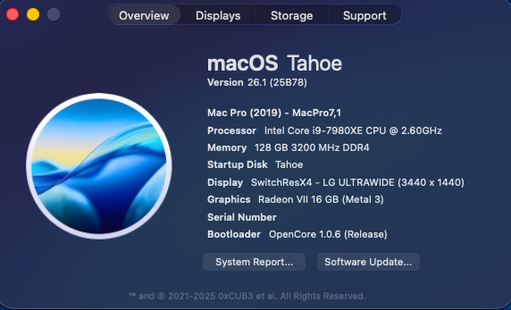

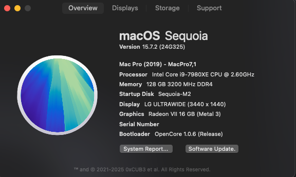

MacOS: Sequoia 15.7.7 and Tahoe 26.5.2/26.6 beta 3 with OpenCore 1.0.7

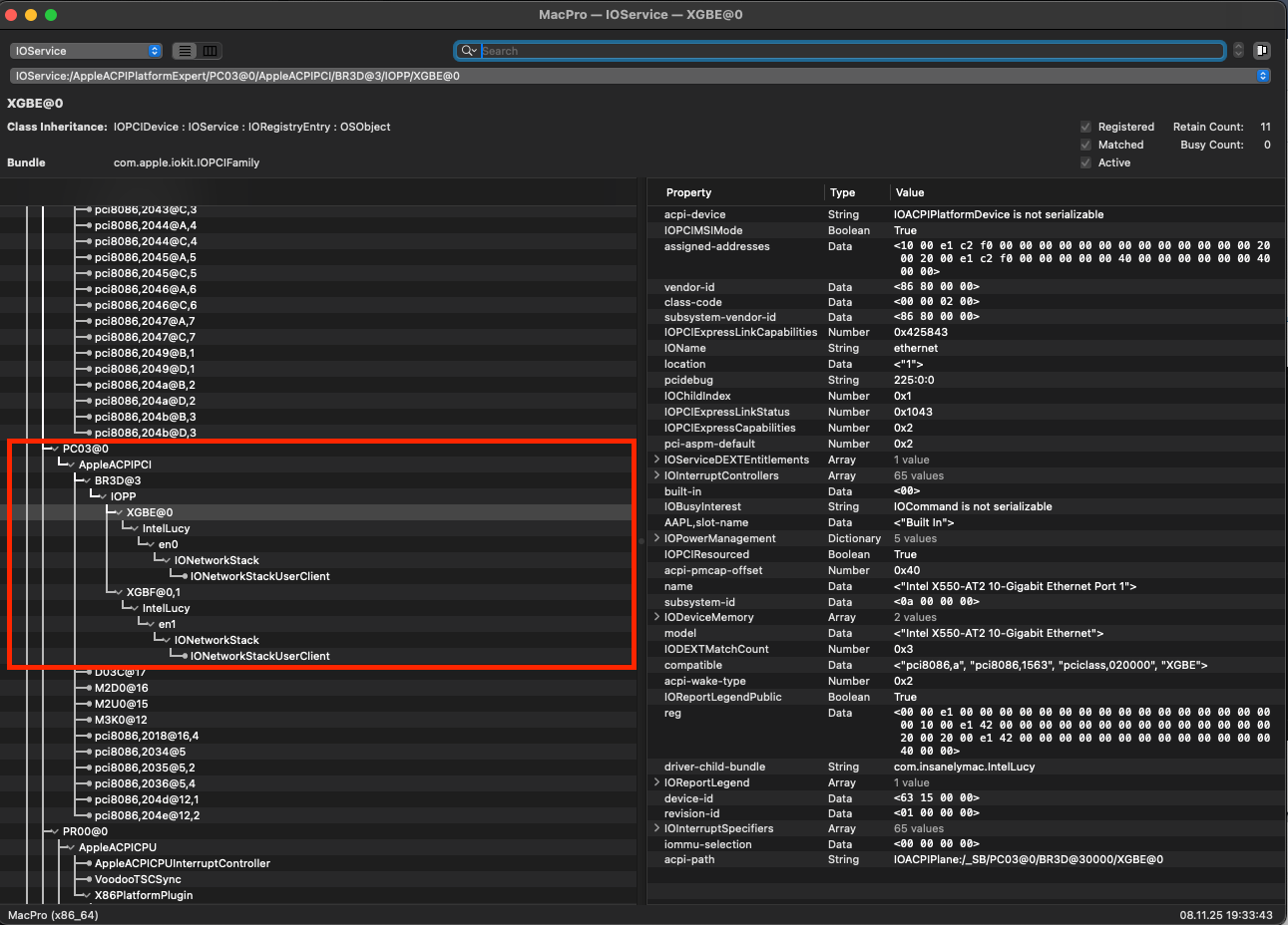

Starting with version 1.1.1 of this EFI-Folder distribution, IntelLucy.kext version 1.1.553 provides now ethernet connectivity for all Intel X520m X540 and X550 NICs under all macOS version including Tahoe with and without AppleVTD enabled. Successfully tested with direct NIC -> router LAN connection as well as with my MikroTik CRS309 switch with H!Fiber Marvel 113C SFP+ RJ45 (30m) and MikroTik S+RJ10 transceivers. No way to get IntelLucy work with my former Netgear ProSafe XS508M switch! Many thanks for all the kind help and hard work of @Mieze

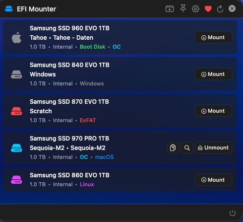

a.) EFI-Mounter:

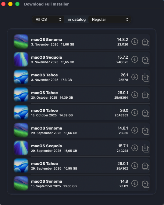

c.) DownloadFullInstaller
https://github.com/perez987/DownloadFullInstaller. After the download, you have to disable Gatekeeper for this Application:
xattr -cr ./Download\ Full\ Installer.app

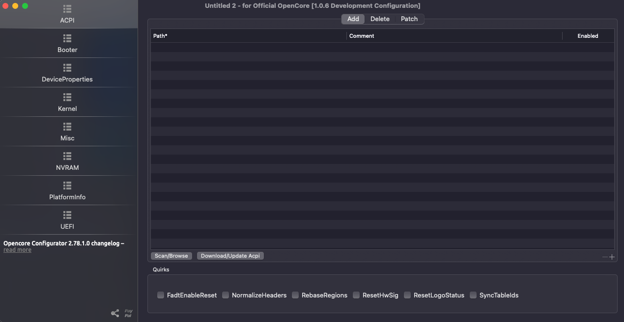

a.) Complete your SMBIOS credentials with Opencore Configurator (OCC) and use your own USB-Mapping-Kext before booting with this EFI. If you don't have any, follow my XHC USB Kext Creation Guideline (sorry, this guideline is not in any other forum) or use USBMap.
b.) Add/delete or enable/disable all system specific kexts for your build in EFI/OCI/Kexts and config.plist -> Kernel -> Add.
c.) For the adaptation of SSDTs and ACPI-patches in EFI/OC/ACPI, config.plist->ACPI -> Add and config.plist->ACPI -> Patch (by default everything disabled), see my else partly outdated installation guide for Mojave.
Important note: If you do not adopt and enable SSDT-X299-HDEF.aml, add bootarg "alcid=2" or the layout-id you need for your onboard sound chip (Supported codecs). The boot args are in NVRAM -> UUID -> 7C436110-AB2A-4BBB-A880-FE41995C9F82 -> boot-args. Otherwise AppleALC.kext won't inject.  If you do not adopt and enable the CPxx -> PRxx replacements for your CPU in config.plist->ACPI -> Patch, edit SSDT-PLUG.aml and replace PR00 by CP00, save the file and enable it for booting.

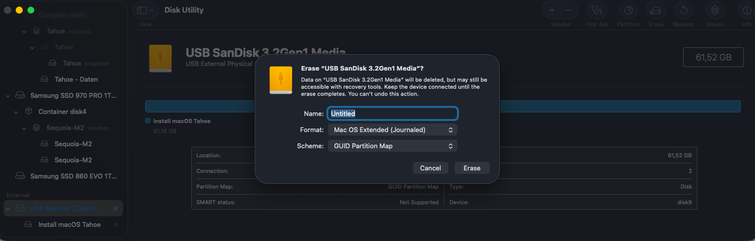

3.) Format a 32GB USB Boot Stick with Apple's Disk Utility. Name: "Untitled", Format: "MacOS Extended", Scheme: "GUID Partition Map"
4.)  Open a terminal and enter the following command:
sudo /Applications/Install\ macOS\ Tahoe.app/Contents/Resources/createinstallmedia --volume /Volumes/Untitled

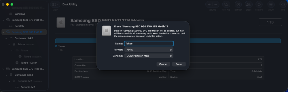

6.) Format the destination drive for your macOS installation with Apple's Disk Utility. Name: "Tahoe", Format: "APFS", Scheme: "GUID Partition Map"

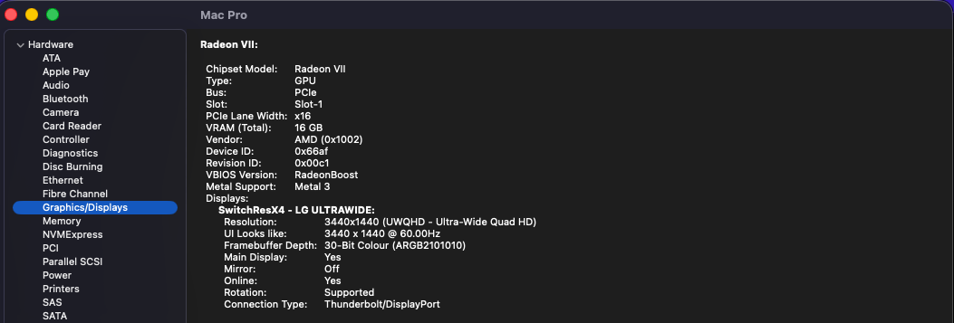

1.) Graphics: no issues under macOS with WhateverGreen.kext 1.7.1d7. For SMBIOS macPro7,1,  WEG is not deemed necessary.

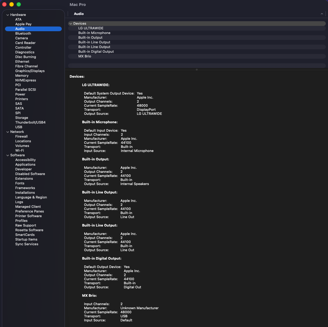

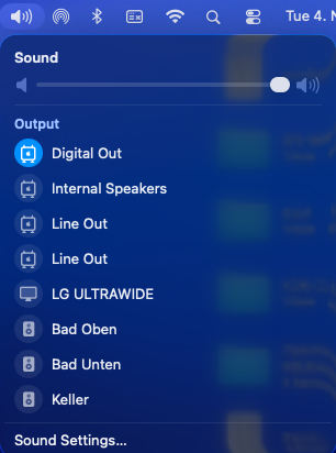

2.) Audio: no issues under macOS, despite Tahoe. For Tahoe, use OCLP-Mod AppleHDA root patching in line with BCMC or the Experimental Fork of OCLP 3.0.0 Nightly (Wi-Fi and AppleHDA). Everything else is already set in the respective EFi-Folders.

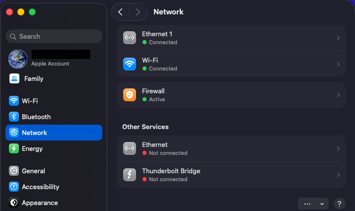

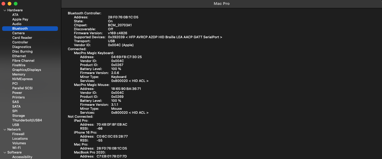

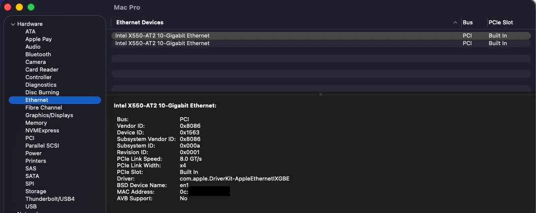

3.) LAN/WIFI/Bluetooth:

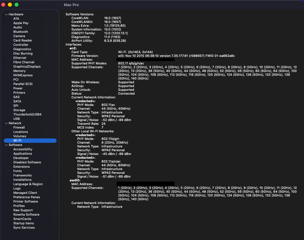

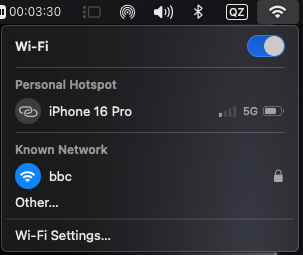

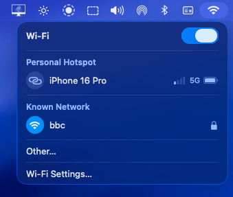

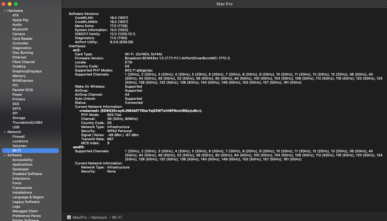

Tahoe - BCMC WIFI working with known limitations, just follow the detailed instructions by the author. Ethernet via IntelLucy version 1.1.5 or Apple's native DEXT Driver for Intel X520, X540 and X550. AppleVTD enabled (DisableIOMapper=False). Nearly everything as already pre-configured in my EFI-Folder distribution. Bluetooth supported natively.
Tahoe - Experimental Fork of OCLP 3.0.0 Nightly: AppleHDA, Wi-Fi and AWDL fully operational. For details see:

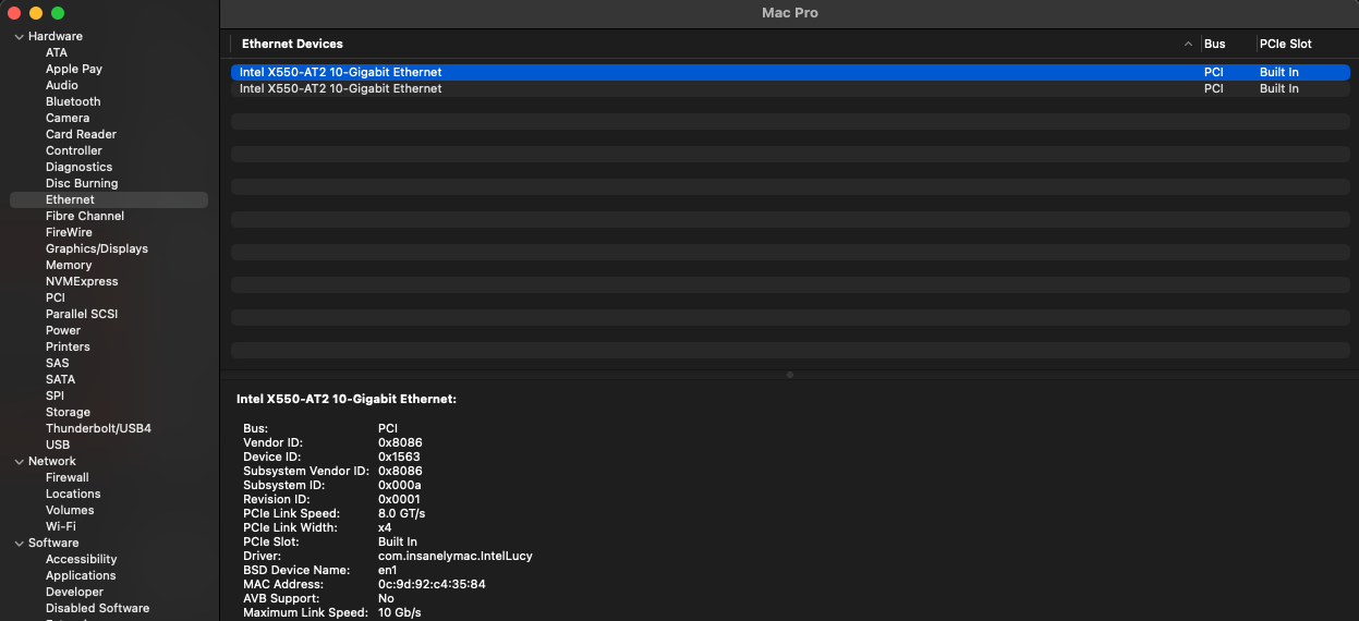

Sequoia, Sonoma - No issues of Broadcom OCLP WIFI root patch with BCM43602CDP and IntelLucy.kext v.1.1.5 with AppleVTD enabled (DisableIOMapper=False). Everything set and pre-configured in my EFI-Folder distribution: Just install OCLP WIFI root patch. Bluetooth supported natively.

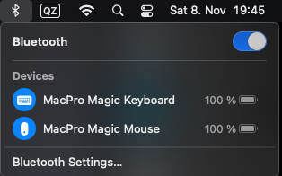

 MacOS Versions below - No issues with Bluetooth, Wifi, LAN. Everything as configured in my EFI-Folder distribution.

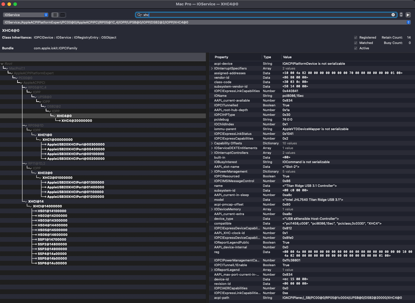

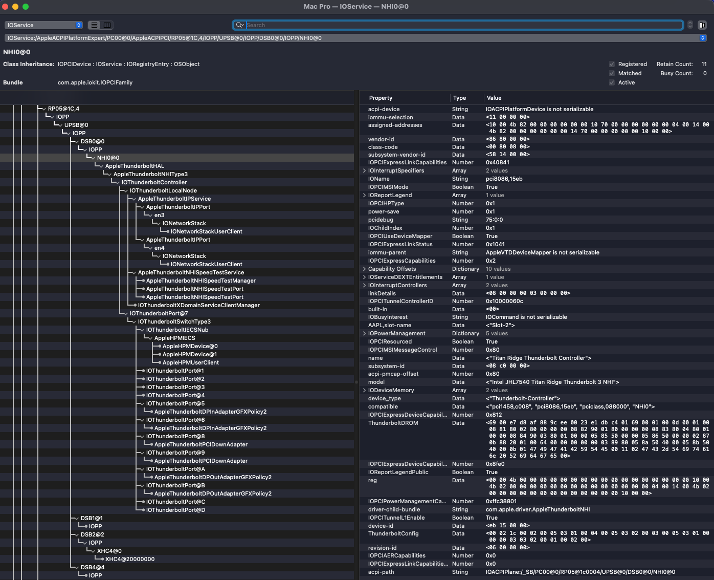

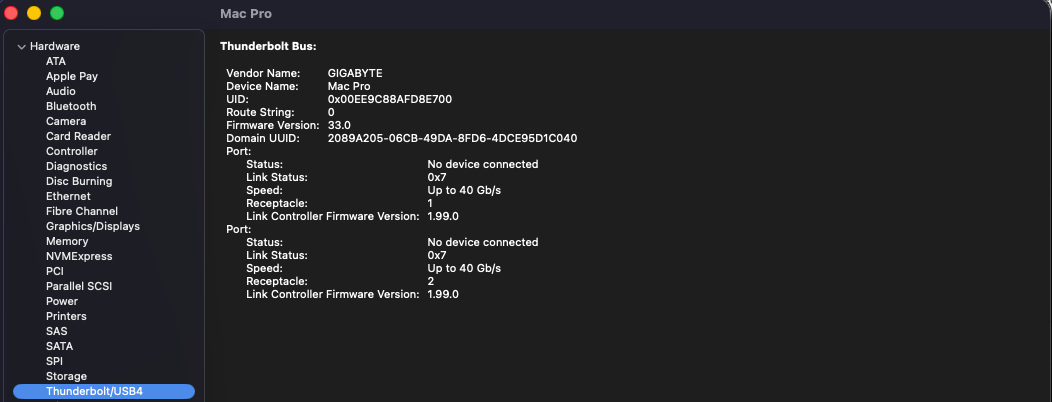

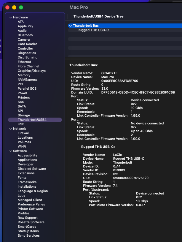

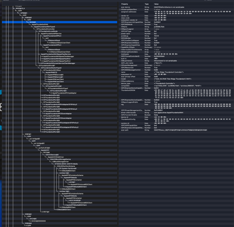

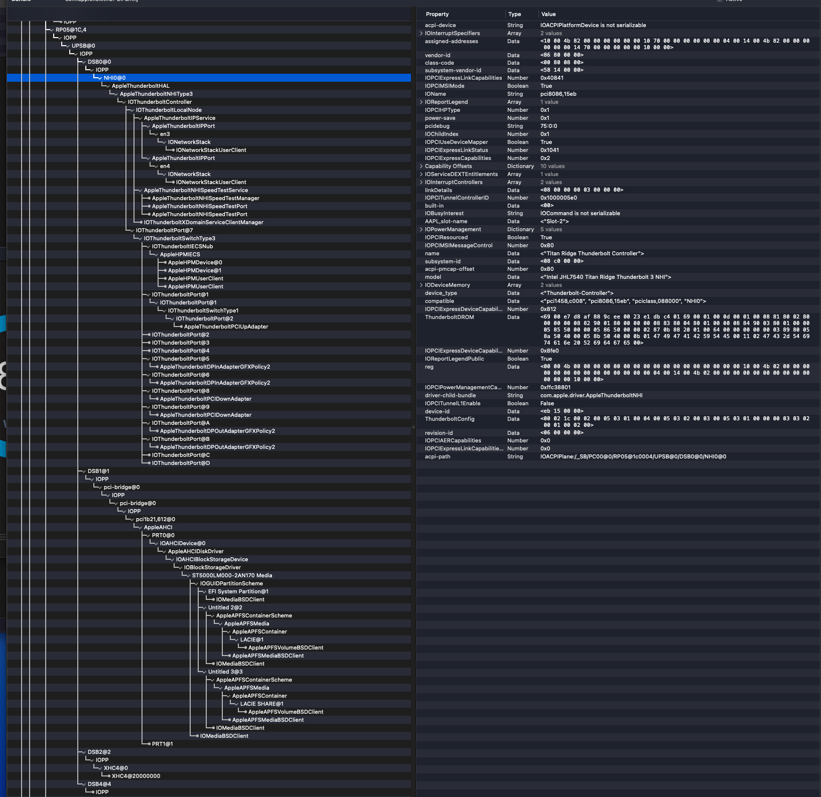

4.) Thunderbolt: Different tries with flashed Gigabyte Titan Ridge rev. 1.0 (NVM23, DSM2), flashed Gigabyte Titan Ridge rev. 2.0 (NVM33, NVM50) and HackingDROM SSDT implemented in my EFI-Folder distribution.
LaCie Rugged TB2 4TB HDD works flawlessly with the shortened pins on the TB header including Hot-plug (BTW, it doesn’t work at all when the Thunderbolt header is connected to the ASUS X299 Sage 10G), my Dell SD1-T0500 Portable Thunderbolt 3 NVMe (500GB), as well as any USB-C stick, won’t connect at all. No other TB 3 devices to test with.

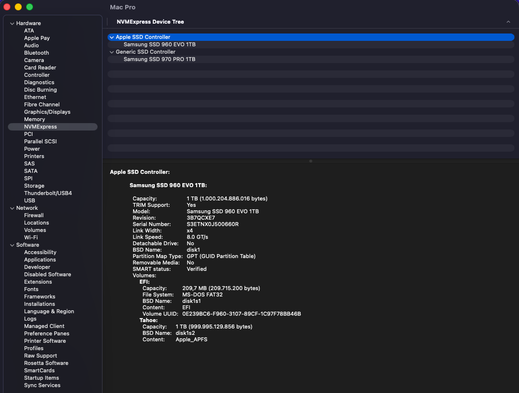

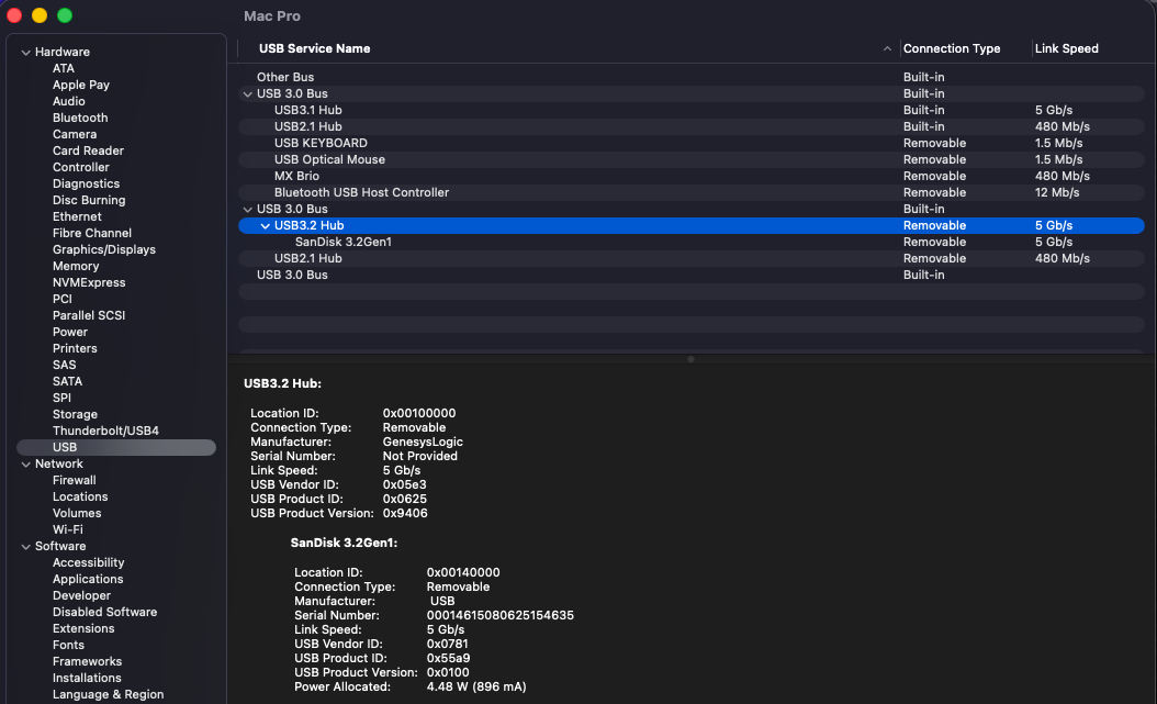

5.) USB Ports: All available USB Ports of the ASUS X299 Sage 10 G are implemented and fully working under all macOS Versions.

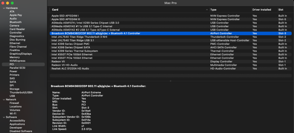

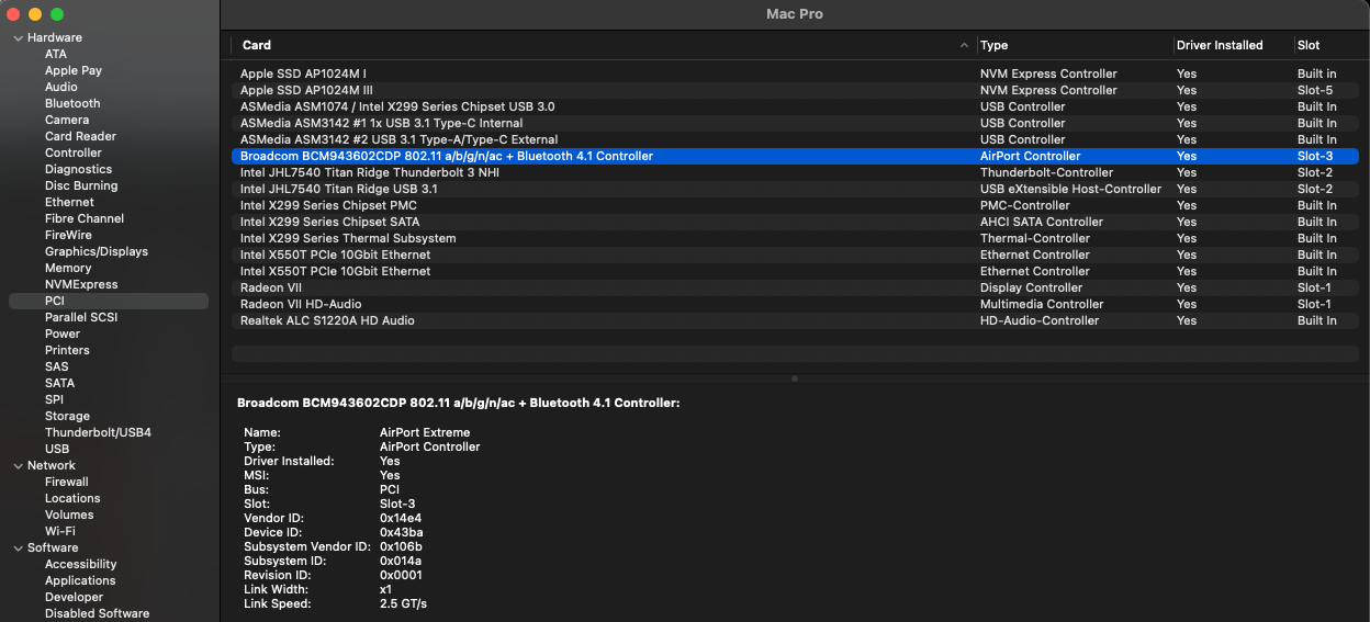

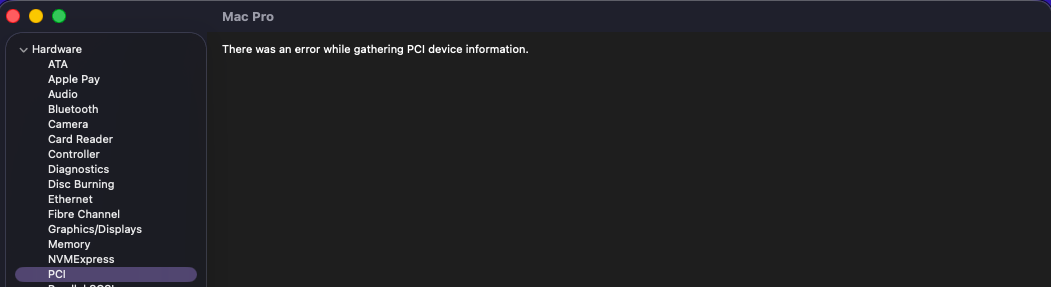

6.) PCI: All PCI devices properly implemented under "System Information" -> "PCI" under all macOS Versions:
BCMC WIFI enabled under Tahoe however still corruppts  PCI device information:

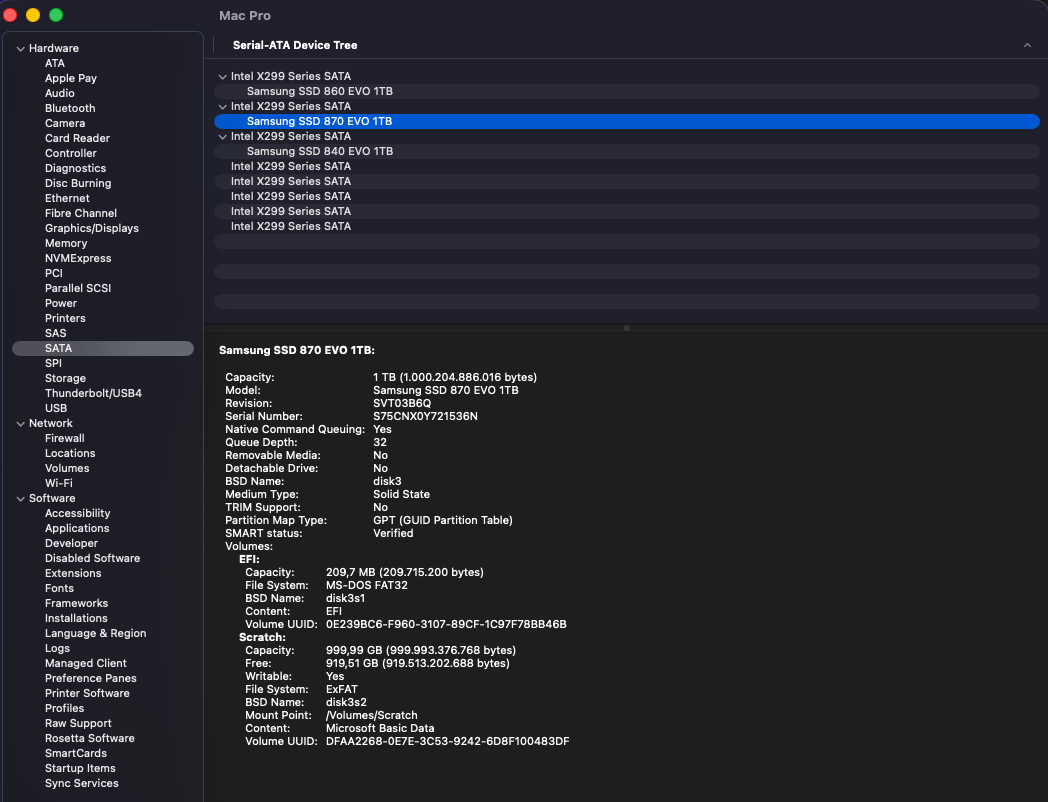

7.) NVMe/SATA

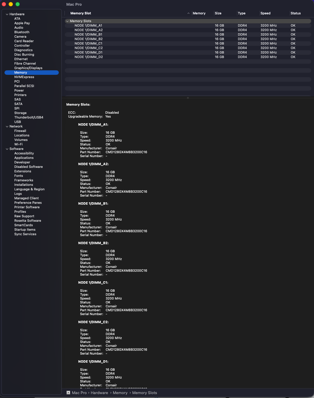

8.) Memory

1.) IntelLucy.kext version 1.1.5:  IntelLucy.kext now also works with AppleVTD enabled (DisabelIOMapper=false) under Tahoe. Many thanks to Mieze for all her hard work to achieve this tremendous breakthrough.
