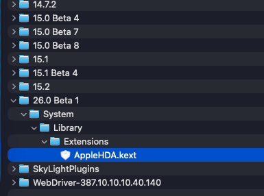

Ludox Posted July 1, 2025 Share Posted July 1, 2025 ok I open it I have the system\libray\ folder where there is AppleHDA.kexts of beta 26, the procedure to install it? Link to comment https://www.insanelymac.com/forum/topic/361162-pre-release-macos-tahoe/page/79/#findComment-2835724 Share on other sites More sharing options...
deeveedee Posted July 1, 2025 Share Posted July 1, 2025 @Ludox If you're trying to manually install AppleHDA.kext, it's not going to be as easy as you think. See here for a better understanding. Best to use OCLP if you are going to install AppleHDA. 3 Link to comment https://www.insanelymac.com/forum/topic/361162-pre-release-macos-tahoe/page/79/#findComment-2835726 Share on other sites More sharing options...

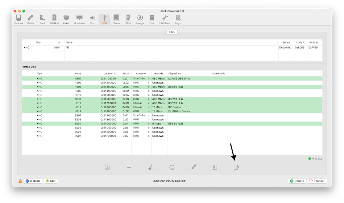

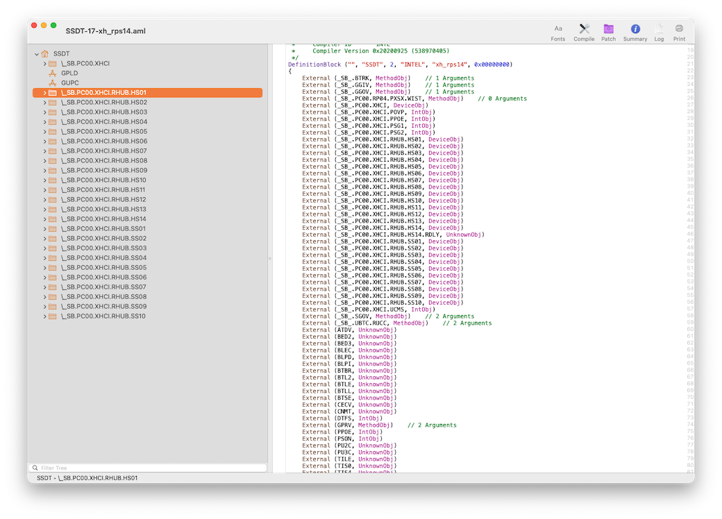

Max.1974 Posted July 1, 2025 Share Posted July 1, 2025 (edited) 9 hours ago, naiclub said: Hello friend, I tried to do as you suggested to turn off Hot Plug and reduce the number of SSDT to 2-3 pieces. The result is still the same. Hello friend, I tried to do as you suggested by unplugging the DVD-ROM first, but the result is stuck at the same point. P.S. (UIAC.aml, RHUB, XHCI, SSDT) I don't know how to do these things and I don't have the knowledge. Most of the time, someone else does it for me. Hi @naiclub using Hackintool, with your usb ports mapping (need use USBMap available in GitHub from CorpNewT page) you can extract your UIAC. You need export in USB Menu and click on last button like print: Will extract in your Desktop SSDT-UIAC.aml SSDT-USBX.aml USBports.kext (you can use but for Tahoe I recommend still use USBMap.kext) Them if you want implement you Hardware I recommend you use @LAbyOne tool to extract all your ACPI devices: ACPIDump app ACPIDump.zip https://github.com/LAbyOne/ACPIDump After Run "All ACPI Table" you will see many ACPI tables on your Desktop. Hackintool does this too. But I used this program. You need search for some SSDT like "xh_rps" and you can use it or better fine tuning, you can see my video tutorial how to formalize and edit this SSDT: See that mine is SSDT-17-xh_rps14 My video tutorial to edit some parts of SSDT (its easy): Spoiler After that you can use for boot, don't forget inject in info.plist inside of your Usb kext the updates for macOs Tahoe You can send me PM if you need my friend! Good Lucky Edited July 1, 2025 by Max.1974 5 Link to comment https://www.insanelymac.com/forum/topic/361162-pre-release-macos-tahoe/page/79/#findComment-2835736 Share on other sites More sharing options...
