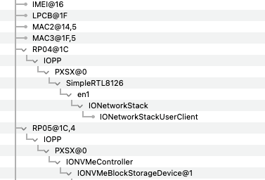

7 hours ago, MaLd0n said:
感谢 Realtek 5g 网卡驱动程序
https://github.com/laobamac/SimpleRTL8126Ethernet
我很快就会测试它,目前这里没有电缆。
Well,the SimpleRTL8126 is in developing now,it can only init device but can't get correct IP address.I will continue that project when OCLP-Mod for Tahoe  released.

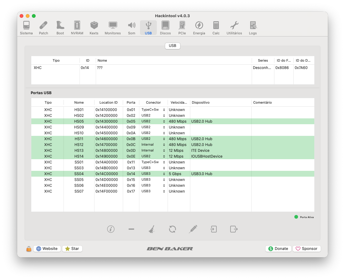

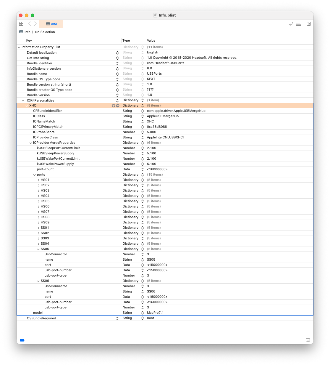

Are you got installer screen ? I think your USB have unnecessary patches just use XHC or XHCI and nothing more. Your SMBIOS at the end, use your working kext UsbMap or USBPorts and fix with USBMap from CorpNewT
Use USBMapInjectorEdit.command and inject U and then C and L if you need - Rename your SMBIOS just for XHCI or XHC, save and boot
Limited at 15 ports
