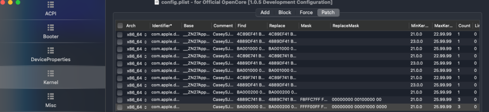

maly70 Posted July 27, 2025 Share Posted July 27, 2025 13 hours ago, Casey_S.J. said: Aquantia patches are compatible with Tahoe. We just need to change MaxKernel to 25.99.99, which has been done in my GitHub repo: https://github.com/CaseySJ/Aquantia-macOS-Patches Thank you Casey_S.J., this is really nice of you to answer, I change to to 25.99.99 but the speed is 700KB/S with Aquantia 107 Link to comment https://www.insanelymac.com/forum/topic/361162-pre-release-macos-tahoe/page/116/#findComment-2837969 Share on other sites More sharing options...

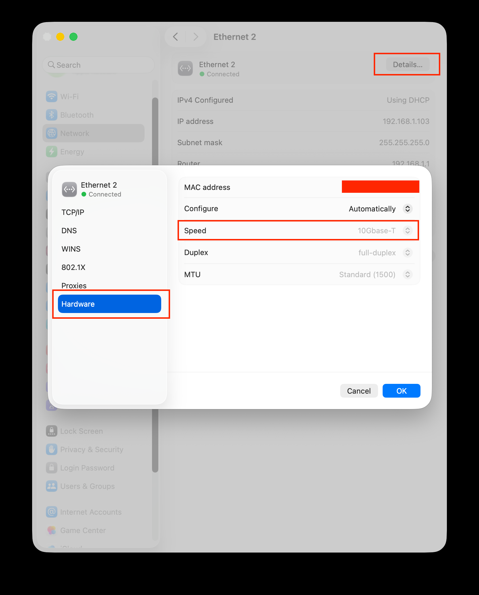

maly70 Posted July 28, 2025 Share Posted July 28, 2025 1 hour ago, Casey_S.J. said: Can you please check the following... What Speed are you seeing? I see, 1000 BaseT, every time I change it to 10GB it will change to 1000 BaseT Link to comment https://www.insanelymac.com/forum/topic/361162-pre-release-macos-tahoe/page/116/#findComment-2837971 Share on other sites More sharing options...

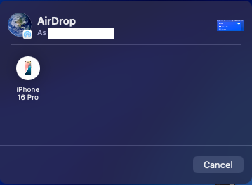

LockDown Posted July 28, 2025 Share Posted July 28, 2025 12 hours ago, arsradu said: Hey guys, Does AirDrop/Handoff work properly for you with Beta 4? I can't seem to get it to work anymore. Is this a new bug? itlwm? It does not 2 Link to comment https://www.insanelymac.com/forum/topic/361162-pre-release-macos-tahoe/page/116/#findComment-2837981 Share on other sites More sharing options...

maly70 Posted July 28, 2025 Share Posted July 28, 2025 28 minutes ago, maly70 said: still the same Casey, dunno what is the problem. I am using set 2 patch, Ventura and z590 Gigabyte Master Casey it works now with a download speed of 346MB/S and dunno how this came from but it is true, thanks a lot for your help and your time my Friend 1 Link to comment https://www.insanelymac.com/forum/topic/361162-pre-release-macos-tahoe/page/116/#findComment-2837983 Share on other sites More sharing options...
Casey_S.J. Posted July 28, 2025 Share Posted July 28, 2025 16 minutes ago, maly70 said: Casey it works now with a download speed of 346MB/S and dunno how this came from but it is true, thanks a lot for your help and your time my Friend Is this with AppleVTD disabled and the Aquantia patches enabled? If so, glad to hear it! Link to comment https://www.insanelymac.com/forum/topic/361162-pre-release-macos-tahoe/page/116/#findComment-2837984 Share on other sites More sharing options...
schrup21 Posted July 28, 2025 Share Posted July 28, 2025 16 hours ago, arsradu said: Does AirDrop/Handoff work properly for you with Beta 4 Handoff is working fine here - i think Airdrop only works with an airport adapter (because of AWDL). I'm using a Asus USB AC53 Dongle for WiFi and a DELL DW1830 for Bluetooth. 1 Link to comment https://www.insanelymac.com/forum/topic/361162-pre-release-macos-tahoe/page/116/#findComment-2837989 Share on other sites More sharing options...

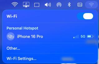

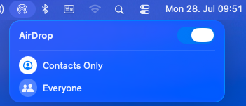

arsradu Posted July 28, 2025 Share Posted July 28, 2025 (edited) No no. My bad. I was talking about my Desktop setup which uses the BCM943602CDP WiFi card with a dedicated PCIe adapter. So it would normally work with OCLP. But I forgot we don't have WiFi yet. So only BT is working and if I'm not mistaken, AirDrop needs both. So yeah, without WiFi working, it's normal not to work. Edited July 28, 2025 by arsradu 1 Link to comment https://www.insanelymac.com/forum/topic/361162-pre-release-macos-tahoe/page/116/#findComment-2837990 Share on other sites More sharing options...
arsradu Posted July 28, 2025 Share Posted July 28, 2025 37 minutes ago, schrup21 said: Handoff is working fine here - i think Airdrop only works with an airport adapter (because of AWDL). I'm using a Asus USB AC53 Dongle for WiFi and a DELL DW1830 for Bluetooth. Yeah, I forgot we don't have Broadcom WiFi yet (I'm using the BCM943602CDP card with a PCIe adapter). I remember we were able to use Handoff via Ethernet, right? As long as it's the same Apple ID and same network. That doesn't seem to work (or not anymore). Anyway, thank you very much for your answer. 1 Link to comment https://www.insanelymac.com/forum/topic/361162-pre-release-macos-tahoe/page/116/#findComment-2837991 Share on other sites More sharing options...
kgp Posted July 28, 2025 Share Posted July 28, 2025 (edited) 1 hour ago, arsradu said: Yeah, I forgot we don't have Broadcom WiFi yet (I'm using the BCM943602CDP card with a PCIe adapter). I remember we were able to use Handoff via Ethernet, right? As long as it's the same Apple ID and same network. That doesn't seem to work (or not anymore). Anyway, thank you very much for your answer. I am using a BCM94360CD and Airdrop seems to be working on Tahoe Beta 4. Everything implemented in EFI and config.plist as suggested for OCLP under Sequoia. I also see my personal iPhone hotspot. Just no way to connect due to the missing OCLP WIFI patch under Tahoe. Edited July 28, 2025 by KGP-iMacPro 4 Link to comment https://www.insanelymac.com/forum/topic/361162-pre-release-macos-tahoe/page/116/#findComment-2837993 Share on other sites More sharing options...

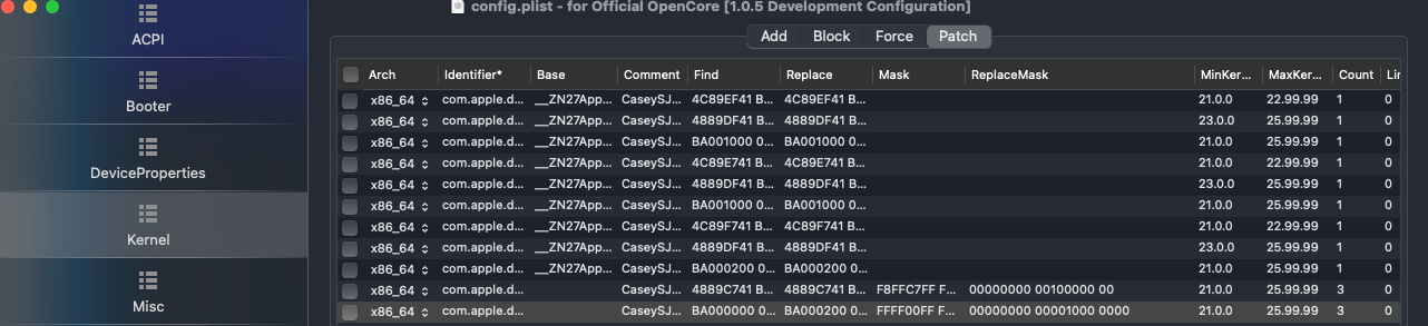

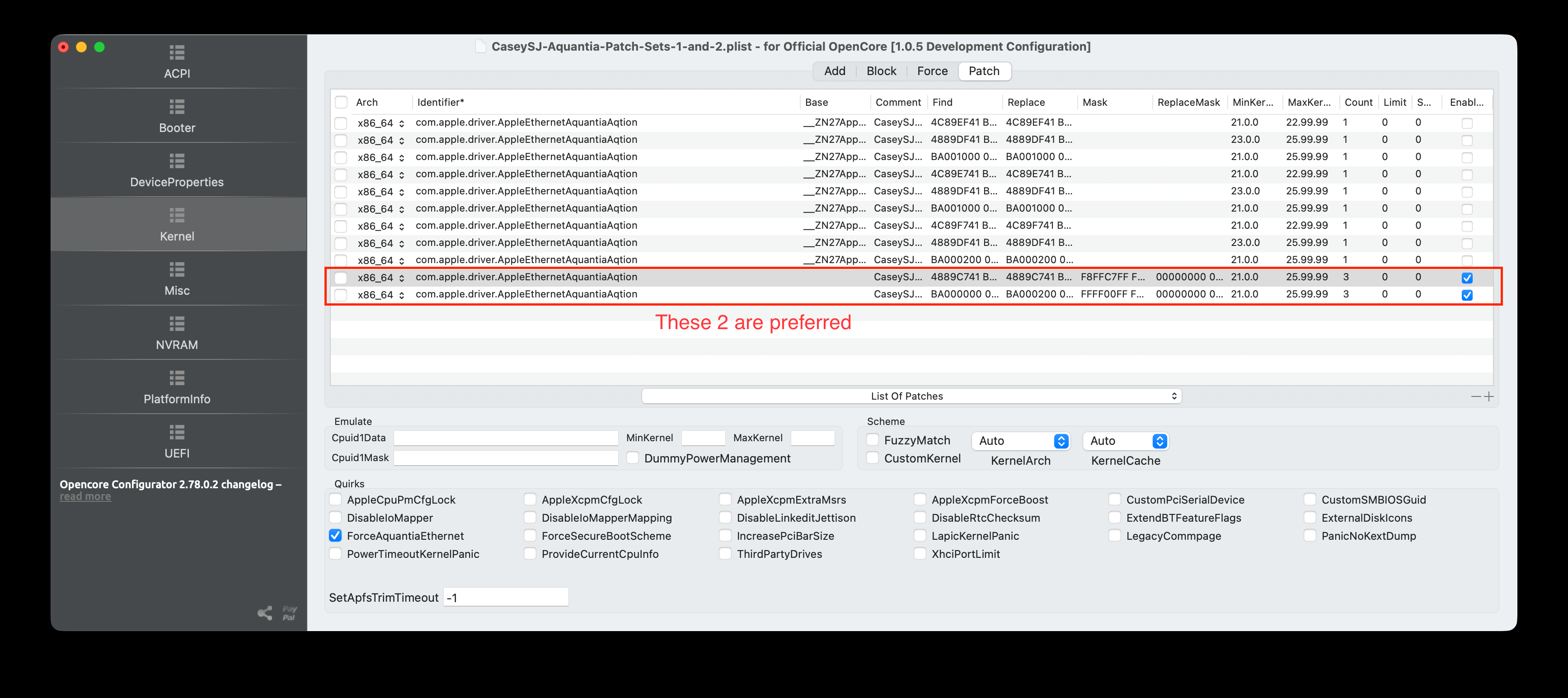

kgp Posted July 28, 2025 Share Posted July 28, 2025 @Casey_S.J., implementing Set 2 of your Aquantia patches with OCC reveals the following errors with ocvalidate NOTE: This version of ocvalidate is only compatible with OpenCore version 1.0.5! Kernel->Patch[9]->Replace requires ReplaceMask to be active for corresponding bits! Kernel->Patch[10]->Replace requires ReplaceMask to be active for corresponding bits! CheckKernel returns 2 errors! Completed validating /Volumes/EFI/EFI/OC/config.plist in 3 ms. Found 2 issues requiring attention. Any thoughts on that? Link to comment https://www.insanelymac.com/forum/topic/361162-pre-release-macos-tahoe/page/116/#findComment-2837994 Share on other sites More sharing options...
schrup21 Posted July 28, 2025 Share Posted July 28, 2025 43 minutes ago, KGP-iMacPro said: Airdrop seems to be working I doubt it 😉 Airdrop transmits data via Apple Wireless Direct Link, which is basically an ad hoc connection between the WiFi adapters. You may find an airdrop capable device, this part works via Bluetooth LE, but you will not be able to send. See here: https://owlink.org/wiki/ 2 Link to comment https://www.insanelymac.com/forum/topic/361162-pre-release-macos-tahoe/page/116/#findComment-2837995 Share on other sites More sharing options...
kgp Posted July 28, 2025 Share Posted July 28, 2025 48 minutes ago, schrup21 said: I doubt it 😉 Airdrop transmits data via Apple Wireless Direct Link, which is basically an ad hoc connection between the WiFi adapters. You may find an airdrop capable device, this part works via Bluetooth LE, but you will not be able to send. See here: https://owlink.org/wiki/ That's what is the case. Everything is set but no connectivity due to the missing OCLP WIFI patch. 2 Link to comment https://www.insanelymac.com/forum/topic/361162-pre-release-macos-tahoe/page/116/#findComment-2837996 Share on other sites More sharing options...

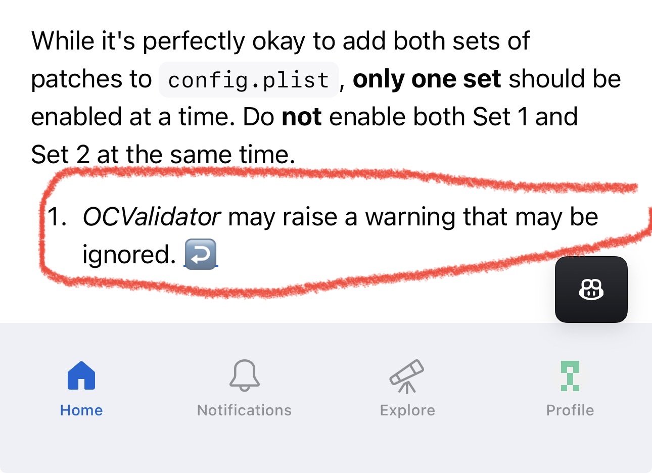

Casey_S.J. Posted July 28, 2025 Share Posted July 28, 2025 (edited) 8 hours ago, KGP-iMacPro said: @Casey_S.J., implementing Set 2 of your Aquantia patches with OCC reveals the following errors with ocvalidate NOTE: This version of ocvalidate is only compatible with OpenCore version 1.0.5! Kernel->Patch[9]->Replace requires ReplaceMask to be active for corresponding bits! Kernel->Patch[10]->Replace requires ReplaceMask to be active for corresponding bits! CheckKernel returns 2 errors! Completed validating /Volumes/EFI/EFI/OC/config.plist in 3 ms. Found 2 issues requiring attention. Any thoughts on that? Those warnings have been present ever since the patches were created, so there’s this footnote in the GitHub ReadMe: Edited July 28, 2025 by Casey_S.J. 4 Link to comment https://www.insanelymac.com/forum/topic/361162-pre-release-macos-tahoe/page/116/#findComment-2837998 Share on other sites More sharing options...
