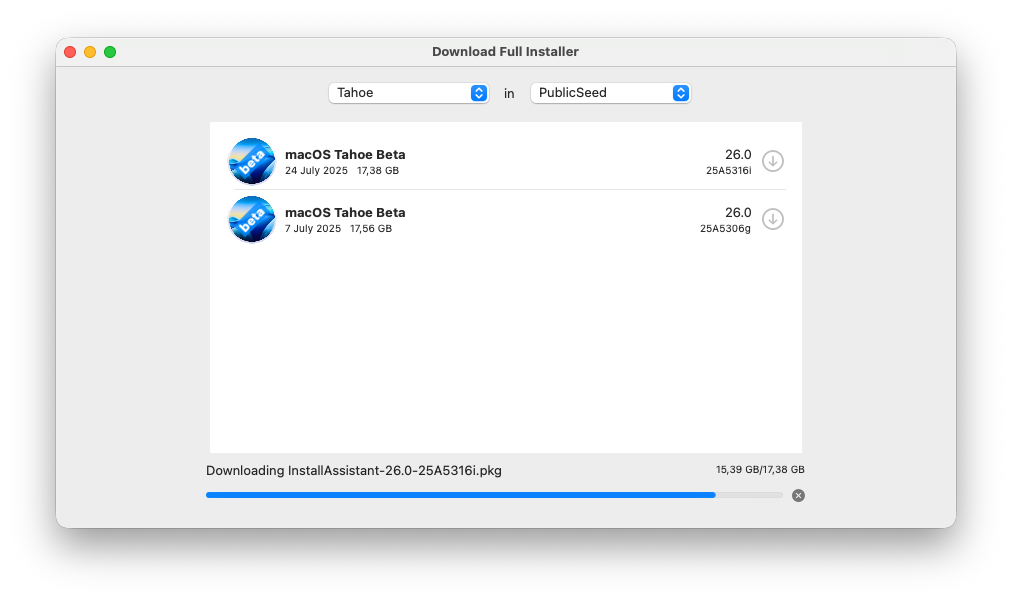

Max.1974 Posted July 25, 2025 Share Posted July 25, 2025 https://github.com/perez987/DownloadFullInstaller/releases 10 1 Link to comment https://www.insanelymac.com/forum/topic/361162-pre-release-macos-tahoe/page/115/#findComment-2837909 Share on other sites More sharing options...

meg2014 Posted July 25, 2025 Share Posted July 25, 2025 1 hour ago, maly70 said: hi mates, with Tahoe Aquantia 10G ethernet is not working, is there any changes to CaseyJ Aquantia patch! Miliuco, can you provide me pls with Download Full Installer Tahoe version.. thanks a lot mate Yes, Aquantia can be a problem, which is too bad. I still have one, but it's just too much trouble getting it to work reliably and every update can be a real headache to get it to work for a new OS - I just gave up. And, I doubt CaseySJ will be updating his set of patches. If your Aquantia is a card installed in your motherboard, I can recommend purchasing a used X540-AT2 (or X540-at1 if you can find it), and use the IntelLucy driver (intelLucy.dmg), which is readily available on this site (lookup @Mieze - who has written a number of ethernet drivers that are widely used in our machines). The price on eBay is very reasonable (around $20-$25), but if you don't want used, you can buy refurbished units on Aliexpress - just make sure they are X540-AT2. You may even find new there, if you're lucky. Finally, I should note that you could also purchase a X550 on eBay or on Aliexpress too. 1 Link to comment https://www.insanelymac.com/forum/topic/361162-pre-release-macos-tahoe/page/115/#findComment-2837913 Share on other sites More sharing options...

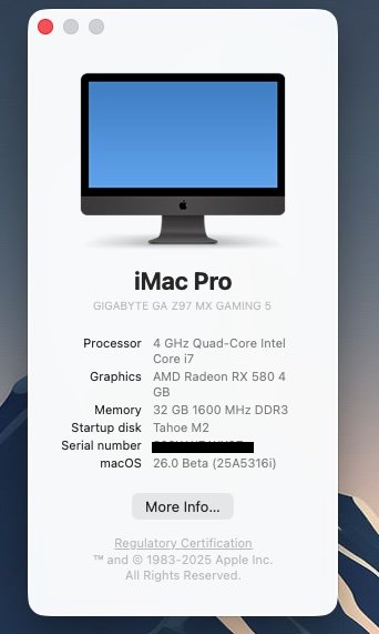

gsxb Posted July 26, 2025 Share Posted July 26, 2025 On 7/24/2025 at 4:11 PM, hiphopboy said: anybody knows how to enable the feature "Copy text on image" on Tahoe beta 4 ? Done beta 4 : How are you able to edit the text under the iMac ( in bold ), to say HP Elitedesk 800 G4 SFF. my ocd just kicked in 🤣🤣 Link to comment https://www.insanelymac.com/forum/topic/361162-pre-release-macos-tahoe/page/115/#findComment-2837925 Share on other sites More sharing options...

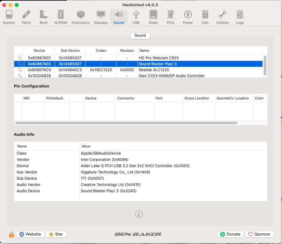

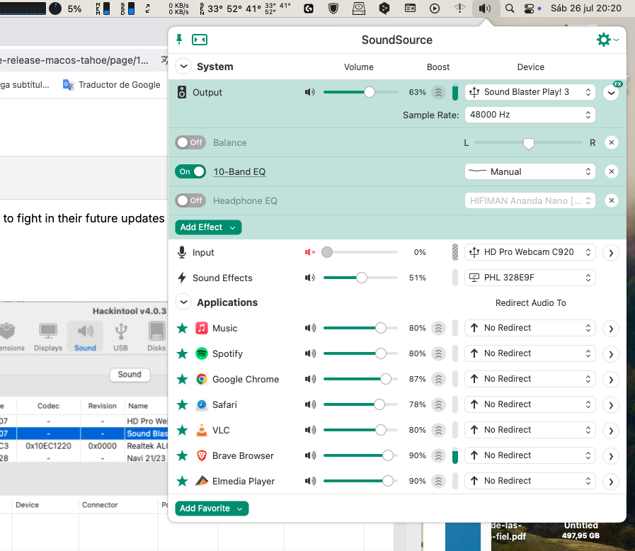

Derty Posted July 26, 2025 Share Posted July 26, 2025 Well, to those who don't want to fight in their future updates with the AppleHDA---- sound-blaster-play-3 no precise drivers... the audio quality is superior to that of the motherboard... and it costs 18 euros... is a cowardly solution, but .... Spoiler Spoiler Spoiler 6 Link to comment https://www.insanelymac.com/forum/topic/361162-pre-release-macos-tahoe/page/115/#findComment-2837942 Share on other sites More sharing options...
