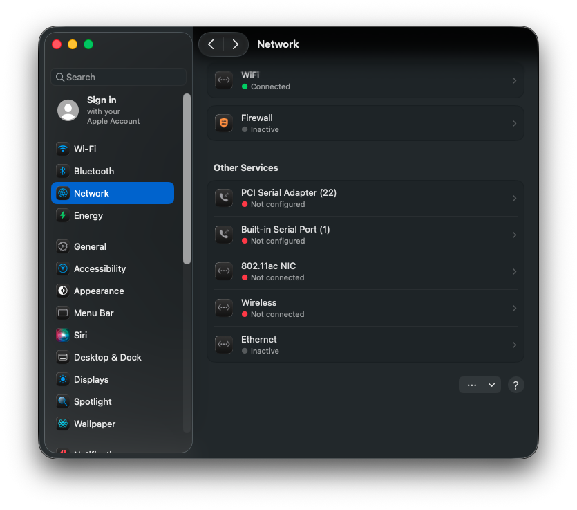

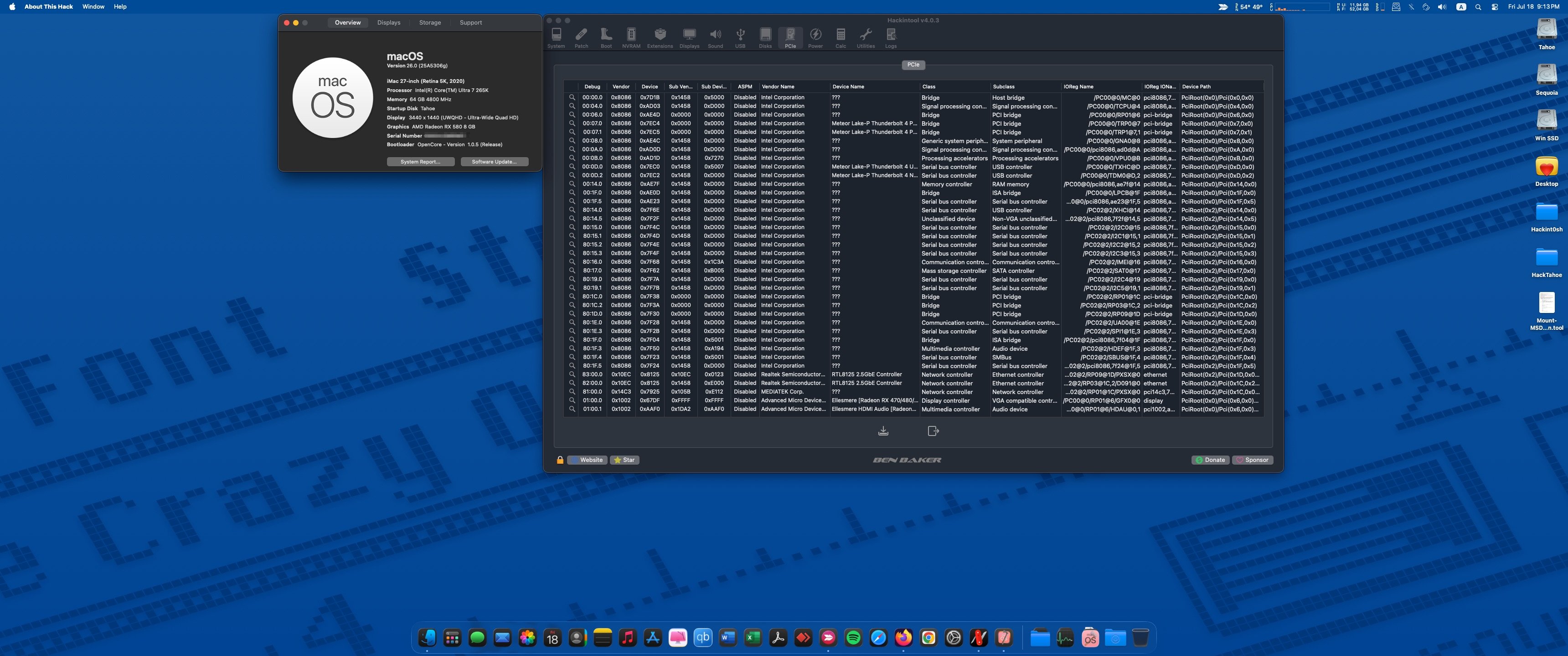

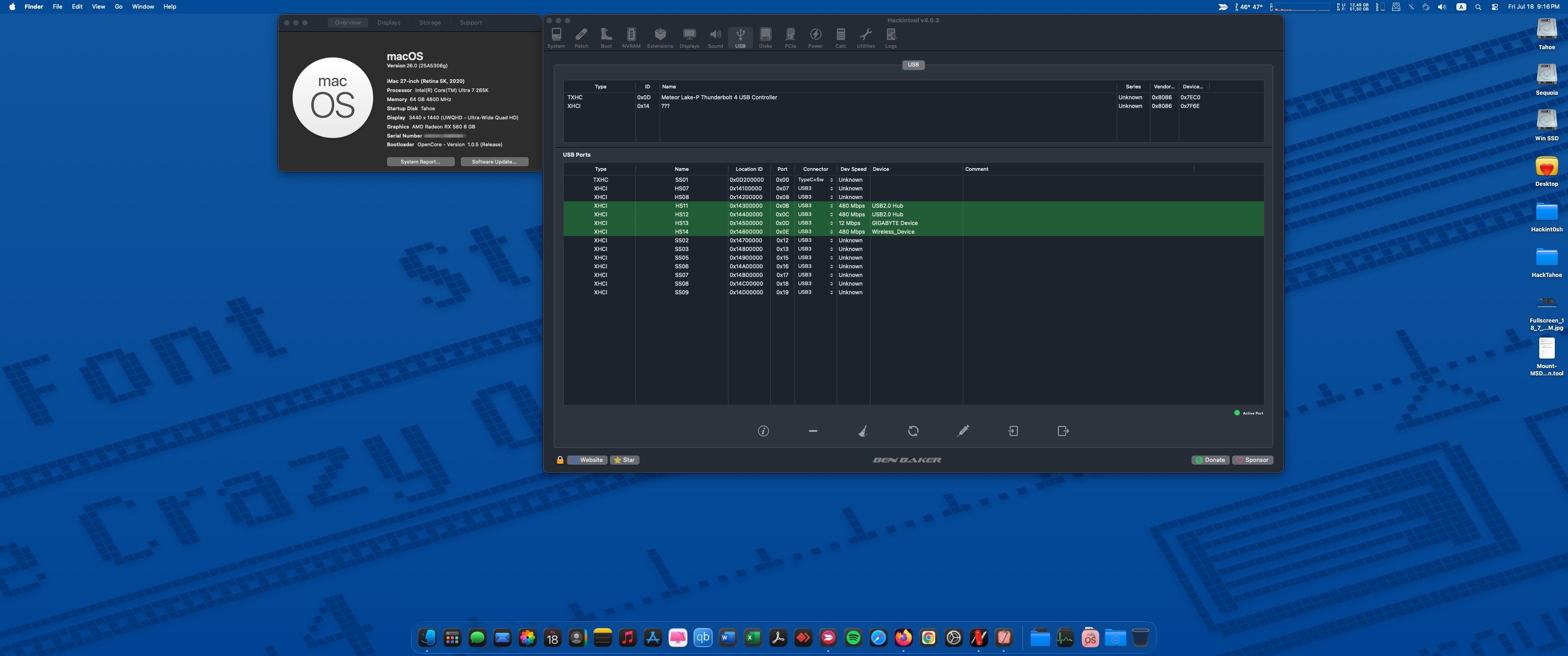

Moviemakergr Posted July 18, 2025 Share Posted July 18, 2025 (edited) On Z890 GAMING X WIFI7 > https://www.gigabyte.com/Motherboard/Z890-GAMING-X-WIFI7/sp#sp Everything works except (Yet) Wi_Fi and BT (MediaTek) NOT RTL8125 2.5 Integrated NOT (add on RTL 8125 2.5 works maybe different revision) Working (Fix) and I don't have a ΤΗ device to test. USB Type c (same port with TH working) be continued.. Spoiler EFI.zip Edited July 31, 2025 by Moviemakergr 2 Link to comment https://www.insanelymac.com/forum/topic/361162-pre-release-macos-tahoe/page/106/#findComment-2837378 Share on other sites More sharing options...

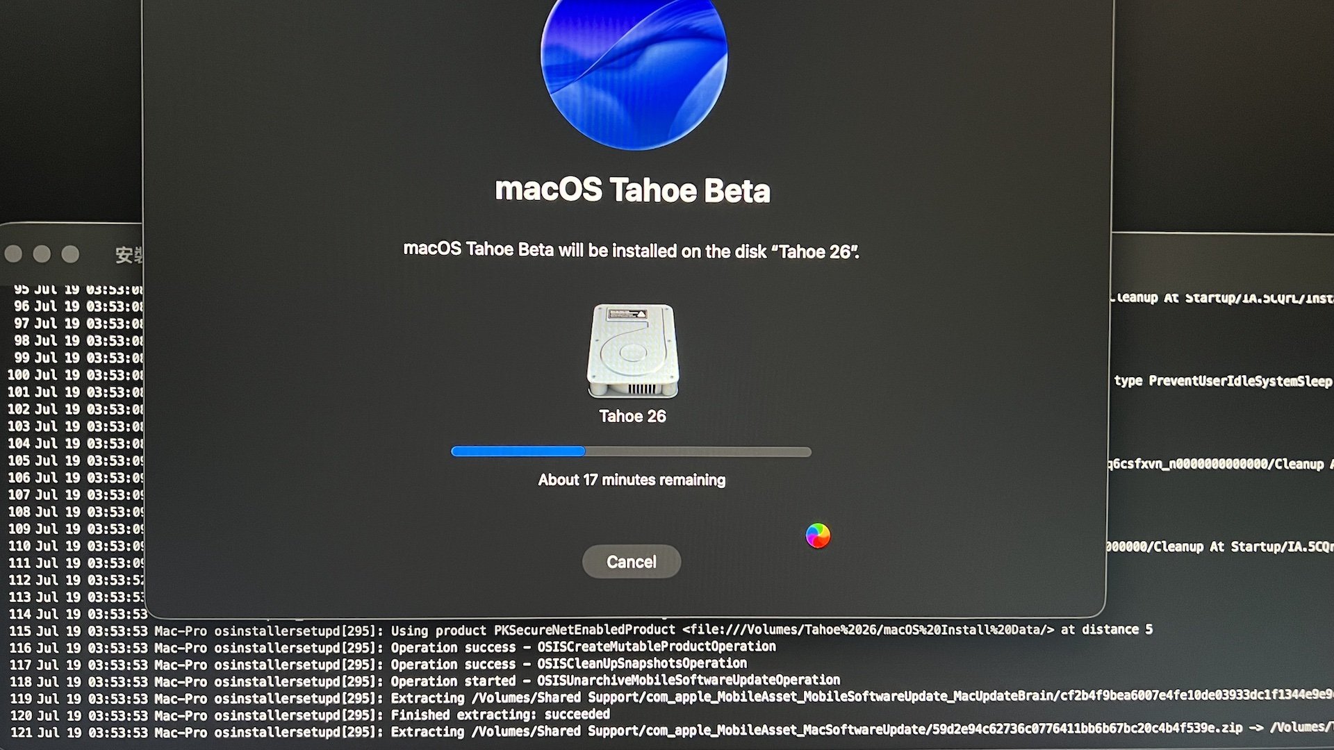

Ben.Cheng Posted July 19, 2025 Share Posted July 19, 2025 (edited) Hi everyone, I created a USB installer using Apple’s official InstallAssistant.pkg, and used it to perform a clean installation (not an upgrade or Time Machine restore) of macOS Tahoe 26 on an NVMe SSD. With Beta 1, everything worked fine — I was able to install and boot into the system successfully. However, starting from Beta 2 (currently on Beta 3), I consistently run into an issue where the installer gets stuck at "About 17 minutes remaining" and never proceeds. Interestingly, if I install macOS Tahoe on any SATA SSD, the installation completes without any issues. My setup: - CPU: Intel i7-10700K - Motherboard: GIGABYTE Z490 VISION G - RAM: 32GB x2 DDR4-3600 - NVMe SSDs tested: Samsung 970 EVO / WD PC SN730 - OpenCore: 1.0.5 with SMBIOS: iMac20,1 This configuration works perfectly from macOS Big Sur 11 through Sequoia 15, as well as macOS Tahoe 26 Beta 1. I’ve tried various combinations to troubleshoot the issue, including: - Switching between different versions of OpenCore, Lilu, and WhateverGreen - Install on the NVMe SSD via connected with USB Type-C adapter - Changing SMBIOS to MacPro7,1 - Installing with and without NVMeFix.kext Unfortunately, the installer still freezes at "About 17 minutes remaining" every time when using an NVMe SSD. As a workaround, I currently install the macOS Tahoe 26 Beta 2/3 on a SATA SSD, then use Disk Utility to restore the installation back to the NVMe SSD, which allows me to bypass the installation freeze in Beta 2 and 3. Is there a proper fix for this issue? Any advice or insights would be greatly appreciated. I've attached screenshots of the issue and my config.plist for reference. Thanks in advance! Edit: Apologies for not explaining things clearly in my original post. Here are some additional details: I have already updated Lilu, AppleALC, WhateverGreen, VirtualSMC, SMCProcessor, and SMCSuperIO to their latest Release versions. Please disregard the version comments in Kernel -> Add -> XXX.kext/Comment. I have set the MaxKernel version to 24.99.99 for all BCM94360 Wi-Fi–related kexts: IOSkywalkFamily, IO80211FamilyLegacy, AirPortBrcmNIC, AMFIPass, as well as the Kernel -> Block -> com.apple.iokit.IOSkywalkFamily entry. WhateverGreen and AppleIGC also have their MaxKernel set to 24.99.99. Theoretically, setting MaxKernel = 24.99.99 should prevent these kexts from being loaded on macOS Tahoe (Darwin >= 25.0.0). Even with the boot-args including -lilubetaall, these kexts should not be active. I will also try completely removing the related kexts from Kernel -> Add later to see if that makes any difference. config.plist.zip Edited July 19, 2025 by Ben.Cheng Additional Notes Link to comment https://www.insanelymac.com/forum/topic/361162-pre-release-macos-tahoe/page/106/#findComment-2837400 Share on other sites More sharing options...
laobamac_yyds Posted July 19, 2025 Share Posted July 19, 2025 1 小时前,Ben.Cheng 说: 大家好, 我使用苹果官方的 InstallAssistant.pkg 创建了一个 USB 安装程序,并用它在一块 NVMe SSD 上全新安装(并非升级或 Time Machine 还原)了 macOS Tahoe 26。在 Beta 1 版本中,一切运行正常——我能够成功安装并启动系统。 然而,从 Beta 2(目前是 Beta 3)开始,我不断遇到一个问题,安装程序卡在“剩余约 17 分钟”并且无法继续。 有趣的是,如果我在任何 SATA SSD 上安装 macOS Tahoe,安装就会顺利完成。 我的配置: - CPU:Intel i7-10700K - 主板:GIGABYTE Z490 VISION G - 内存:32GB x2 DDR4-3600 - 测试的 NVMe SSD:Samsung 970 EVO / WD PC SN730 - OpenCore:1.0.5 带 SMBIOS:iMac20,1 此配置在 macOS Big Sur 11 至 Sequoia 15 以及 macOS Tahoe 26 Beta 1 中均能完美运行。 我尝试了各种组合来解决问题,包括: - 在 OpenCore、Lilu 和 WhateverGreen 的不同版本之间切换 - 通过连接 USB Type-C 适配器安装在 NVMe SSD 上 - 将 SMBIOS 更改为 MacPro7,1 - 使用和不使用 NVMeFix.kext 安装 不幸的是,每次使用 NVMe SSD 时,安装程序仍然会在“剩余约 17 分钟”处冻结。 作为一种解决方法,我目前在 SATA SSD 上安装 macOS Tahoe 26 Beta 2/3,然后使用磁盘工具将安装恢复到 NVMe SSD,这使我能够绕过 Beta 2 和 3 中的安装冻结。 这个问题有合适的解决方案吗?如有任何建议或见解,我们将不胜感激。 我已附上该问题的屏幕截图和我的 config.plist 以供参考。 提前致谢! 配置.plist.zip 7.24 千字节 · 0 次下载 It will automatically restart after 1-3 hours, you just need to wait. This issue has been widely occurring since Beta2 3 1 Link to comment https://www.insanelymac.com/forum/topic/361162-pre-release-macos-tahoe/page/106/#findComment-2837405 Share on other sites More sharing options...
strangeron Posted July 19, 2025 Share Posted July 19, 2025 1 hour ago, Ben.Cheng said: Unfortunately, the installer still freezes at "About 17 minutes remaining" every time when using an NVMe SSD. First, the OpenCore EFI (kext, driver, boot, etc.) should be updated. Wi-Fi/BT kexts should not be used in the installation. Note: This may be personal, but I'd be suspicious if I have a Samsung NVMe. Especially the 970 EVO. I've seen it freeze a few times when used with another NVMe. Even though Samsung has released firmware for this series, it's still available. 1 1 Link to comment https://www.insanelymac.com/forum/topic/361162-pre-release-macos-tahoe/page/106/#findComment-2837408 Share on other sites More sharing options...

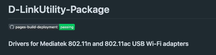

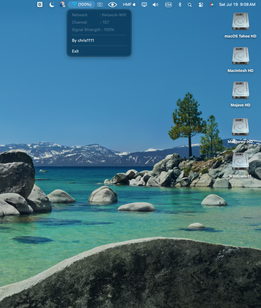

chris1111 Posted July 19, 2025 Share Posted July 19, 2025 (edited) Good News Working with Drivers Mediatek High-performance 802.11n and 802.11ac USB Wi-Fi adapters D-LinkUtility-Package Edited July 20, 2025 by chris1111 8 3 Link to comment https://www.insanelymac.com/forum/topic/361162-pre-release-macos-tahoe/page/106/#findComment-2837416 Share on other sites More sharing options...
Ben.Cheng Posted July 19, 2025 Share Posted July 19, 2025 (edited) 6 hours ago, strangeron said: First, the OpenCore EFI (kext, driver, boot, etc.) should be updated. Wi-Fi/BT kexts should not be used in the installation. Note: This may be personal, but I'd be suspicious if I have a Samsung NVMe. Especially the 970 EVO. I've seen it freeze a few times when used with another NVMe. Even though Samsung has released firmware for this series, it's still available. Apologies for not explaining things clearly in my original post. Here are some additional details: I have already updated Lilu, AppleALC, WhateverGreen, VirtualSMC, SMCProcessor, and SMCSuperIO to their latest Release versions. Please disregard the version comments in Kernel -> Add -> XXX.kext/Comment. I have set the MaxKernel version to 24.99.99 for all BCM94360 Wi-Fi–related kexts: IOSkywalkFamily, IO80211FamilyLegacy, AirPortBrcmNIC, AMFIPass, as well as the Kernel -> Block -> com.apple.iokit.IOSkywalkFamily entry. WhateverGreen and AppleIGC also have their MaxKernel set to 24.99.99. Theoretically, setting MaxKernel = 24.99.99 should prevent these kexts from being loaded on macOS Tahoe (Darwin Kernel >= 25.0.0). Even with the boot-args including -lilubetaall, these kexts should not be active. I will also try completely removing the related kexts from Kernel -> Add later to see if that makes any difference. Edited July 19, 2025 by Ben.Cheng Link to comment https://www.insanelymac.com/forum/topic/361162-pre-release-macos-tahoe/page/106/#findComment-2837418 Share on other sites More sharing options...
Ben.Cheng Posted July 19, 2025 Share Posted July 19, 2025 (edited) 8 hours ago, laobamac_yyds said: It will automatically restart after 1-3 hours, you just need to wait. This issue has been widely occurring since Beta2 Thank you very much for your helpful reply. I followed your advice and waited — after about 50 minutes, the installation process resumed and the system was finally installed. I'm really glad to have the installation completed. I truly appreciate you taking the time to share this information — it made a big difference. Thanks again! Edited July 19, 2025 by Ben.Cheng Correction 2 Link to comment https://www.insanelymac.com/forum/topic/361162-pre-release-macos-tahoe/page/106/#findComment-2837419 Share on other sites More sharing options...

surfinchina Posted July 19, 2025 Share Posted July 19, 2025 3 hours ago, eSaF said: Wow 50 minutes!!! Personally I would have given up, at the exact stage my own was 5 minutes max. Still, happy to hear you were patient enough to see it through. Enjoy. Like you I get impatient but sometimes if I reboot back into the installer it doesn't hang the 2nd or 3rd time. This worked for me in beta 1, beta 2 there was no wait at all - took about 5 minutes all up. 3 Link to comment https://www.insanelymac.com/forum/topic/361162-pre-release-macos-tahoe/page/106/#findComment-2837429 Share on other sites More sharing options...

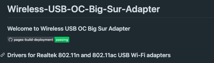

LockDown Posted July 20, 2025 Share Posted July 20, 2025 (edited) 18 hours ago, chris1111 said: Good News Working with Mediatek Driver High-performance 802.11n Wifi USB Adapter D-LinkUtility-Package A quick OT guys.. hi @chris1111 A suggestion... It would be better to rename your all your wifi packages. currently, Its too universal which makes it difficult for others to identify which is which for. D-LinkUtility-Package = Ralink/Mediatek Wireless-USB-OC-Big-Sur-Adapter = Realtek And so on... Now back to Topic 👍 Edited July 20, 2025 by LockDown 1 Link to comment https://www.insanelymac.com/forum/topic/361162-pre-release-macos-tahoe/page/106/#findComment-2837440 Share on other sites More sharing options...
chris1111 Posted July 20, 2025 Share Posted July 20, 2025 (edited) 2 hours ago, LockDown said: A quick OT guys.. hi @chris1111 A suggestion... It would be better to rename your all your wifi packages. currently, Its too universal which makes it difficult for others to identify which is which for. D-LinkUtility-Package = Ralink/Mediatek Wireless-USB-OC-Big-Sur-Adapter = Realtek And so on... Now back to Topic 👍 Thanks @LockDown its already specify for the 3 Realtek utility I add the same for the Mediatek utility done! Note; D-Link and Ralink was the first builder of the utility associate with Mediatek this is why the name is D-LinkUtility-Package Spoiler Edited July 20, 2025 by chris1111 3 Link to comment https://www.insanelymac.com/forum/topic/361162-pre-release-macos-tahoe/page/106/#findComment-2837443 Share on other sites More sharing options...
laobamac_yyds Posted July 20, 2025 Share Posted July 20, 2025 21 hours ago, Ben.Cheng said: Thank you very much for your helpful reply. I followed your advice and waited — after about 50 minutes, the installation process resumed and the system was finally installed. I'm really glad to have the installation completed. I truly appreciate you taking the time to share this information — it made a big difference. Thanks again! You're welcome. I'm glad you successfully installed it 4 Link to comment https://www.insanelymac.com/forum/topic/361162-pre-release-macos-tahoe/page/106/#findComment-2837463 Share on other sites More sharing options...

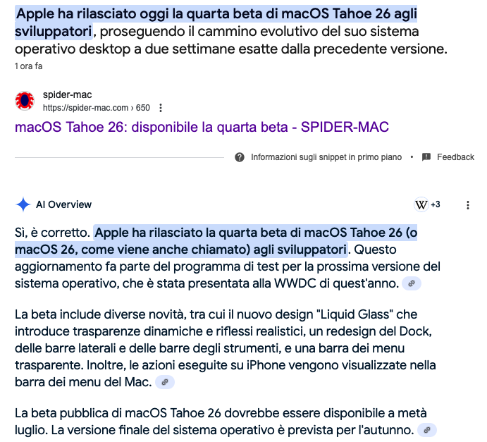

webipsum Posted July 21, 2025 Share Posted July 21, 2025 (edited) macOS Tahoe 26: disponibile la quarta beta Ooops... Error 404 We are sorry, but the page you are looking for does not exist EDIT: I read somewhere...: Apple has changed its public release plan this year: beta 4 will be released on July 21st, public iOS/macOS versions will be released on the 23rd. Edited July 21, 2025 by webipsum I read somewhere... Link to comment https://www.insanelymac.com/forum/topic/361162-pre-release-macos-tahoe/page/106/#findComment-2837555 Share on other sites More sharing options...
