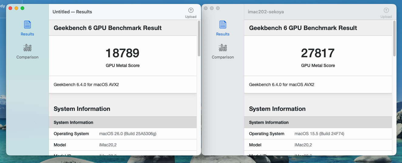

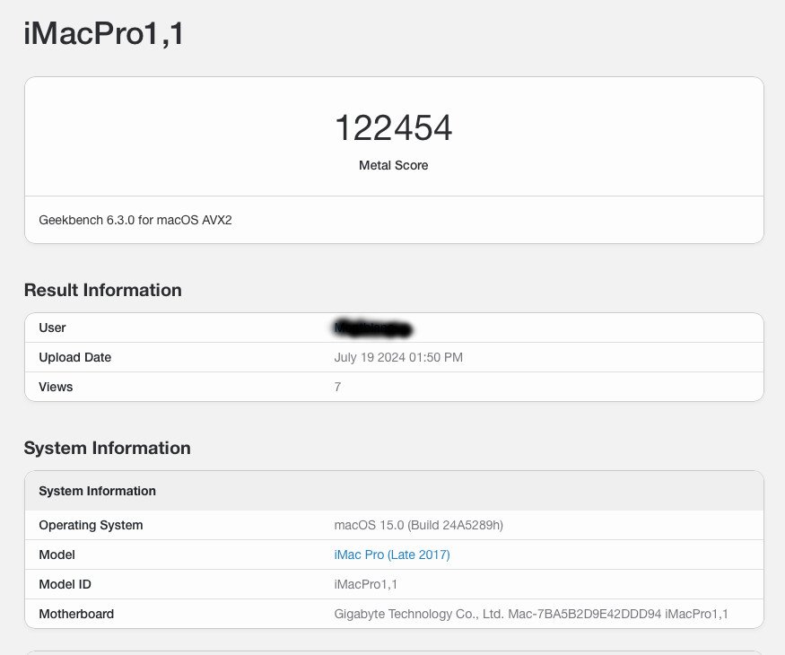

pico joe Posted July 16, 2025 Share Posted July 16, 2025 (edited) I tried to compare the Geekbench scores, and yes, the scores dropped on Tahoe3. Spoiler Edited July 16, 2025 by pico joe 2 Link to comment https://www.insanelymac.com/forum/topic/361162-pre-release-macos-tahoe/page/105/#findComment-2837170 Share on other sites More sharing options...

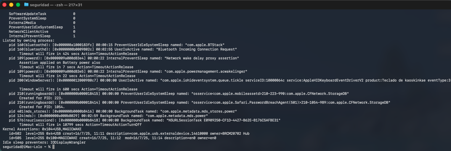

kaoskinkae Posted July 16, 2025 Share Posted July 16, 2025 (edited) We continue studying the beta 3 of Tahoe on my two computers. On the OLD: I get to sleep when using the SSDT SSDT-XHCXPRW.aml. By removing the USB ports to be woken up. I can return from sleep by pressing the POWER key. On the NEW computer: I can't get to sleep, it goes into sleep and after a few seconds it wakes up again. I have passed a command from terminal and that is what it says. I don't know if it is related to the Bluetooth keyboard and mouse devices on the Mac. SOLUTION Edited July 17, 2025 by kaoskinkae 1 Link to comment https://www.insanelymac.com/forum/topic/361162-pre-release-macos-tahoe/page/105/#findComment-2837182 Share on other sites More sharing options...

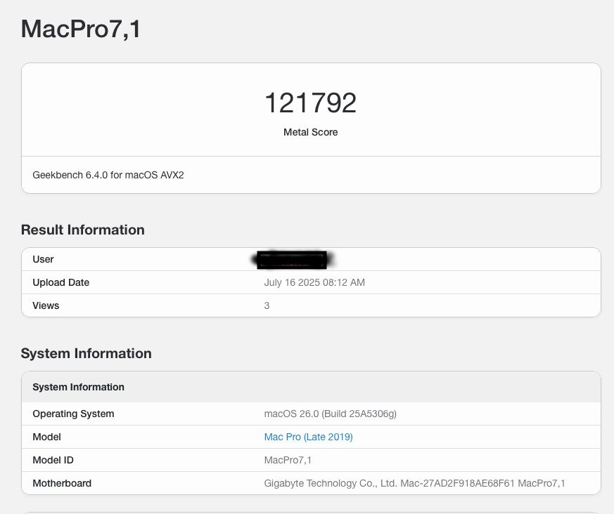

Montblanc Posted July 16, 2025 Share Posted July 16, 2025 2 hours ago, pico joe said: I tried to compare the Geekbench scores, and yes, the scores dropped on Tahoe3. Reveal hidden contents Not seeing much difference here between Sequoia and Tahoe b3 with my RX6600 XT. I have changed from iMacPro1,1 smbios to Mac Pro 7,1 though, so this might make a difference in results? Spoiler 2 1 Link to comment https://www.insanelymac.com/forum/topic/361162-pre-release-macos-tahoe/page/105/#findComment-2837188 Share on other sites More sharing options...
deeveedee Posted July 16, 2025 Share Posted July 16, 2025 (edited) @Montblanc I am finding that GeekBench 6 Metal Benchmarks for my RX 560x are ~20% lower with SMBIOS MacPro7,1 than they are with SMBIOS MacMini8,1 for my hack here. When testing with SMBIOS MacMini8,1, I am not seeing any significant GB6 Metal benchmark differences between macOS Sequoia and Tahoe Beta 3. However, I did see a temporary drop in GB6 Metal Benchmarks immediately after upgrading to Tahoe Beta 3. This temporary drop resolved itself and GB6 Metal benchmarks returned to "normal" after a few reboots of Tahoe Beta 3. In summary: RX 560x GB6 Metal Benchmarks in Tahoe Beta 3 are ~20% lower with SMBIOS MacPro7,1 than they are with SMBIOS MacMini8,1 No significant RX 560x GB6 Metal Benchmark differences between Tahoe Beta 3 and Sequoia when tested with SMBIOS MacMini8,1 (I haven't tested macOS earlier than Tahoe Beta 3 with SMBIOS MacPro7,1) See other test results here. EDIT: My system specs are as follows: WhateverGreen.kext 1.7.0 / Lilu.kext 1.7.1 Open Core 1.0.5 Release dGPU: RX 560x 4GB Baffin (Polaris 21) Edited July 16, 2025 by deeveedee 6 Link to comment https://www.insanelymac.com/forum/topic/361162-pre-release-macos-tahoe/page/105/#findComment-2837211 Share on other sites More sharing options...

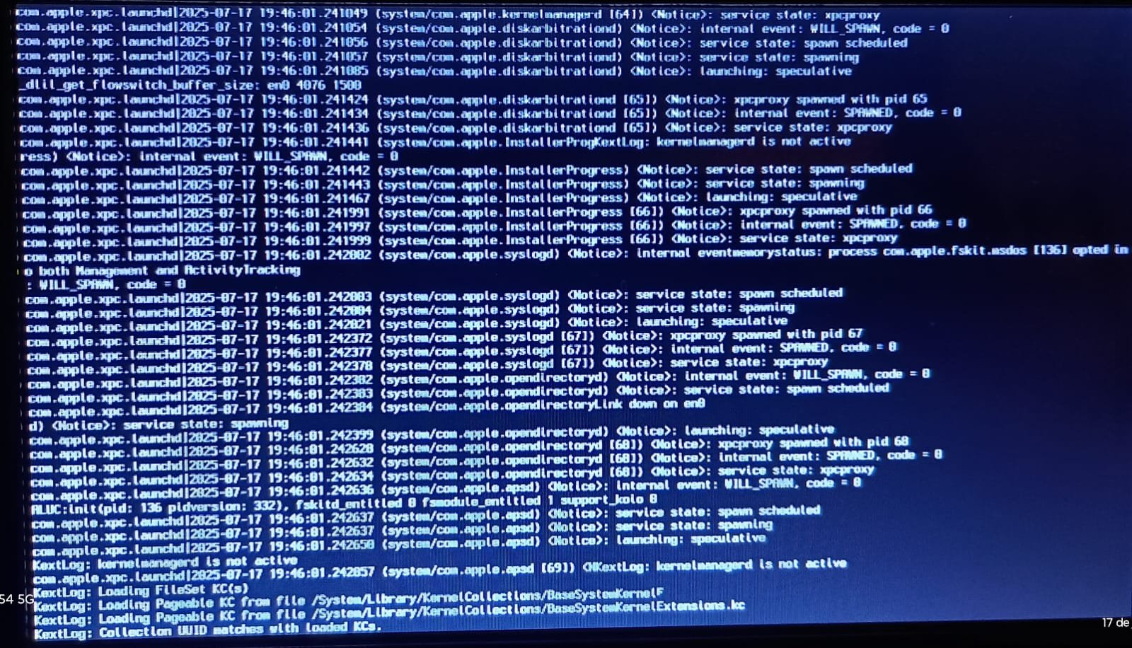

MacWill Posted July 17, 2025 Share Posted July 17, 2025 Always stuck in this part of the boot process. Does anyone have any ideas? With the same configuration, I can get into the Sequoia. config.plist Link to comment https://www.insanelymac.com/forum/topic/361162-pre-release-macos-tahoe/page/105/#findComment-2837349 Share on other sites More sharing options...
Lucas_Udia Posted July 17, 2025 Share Posted July 17, 2025 17 minutes ago, MacWill said: Sempre fico preso nessa parte do processo de inicialização. Alguém tem alguma ideia? Com a mesma configuração, consigo entrar no Sequoia. config.plist 53,49 kB · 1 download test this config friend, good luck! config.plist 1 1 Link to comment https://www.insanelymac.com/forum/topic/361162-pre-release-macos-tahoe/page/105/#findComment-2837350 Share on other sites More sharing options...
kgp Posted July 17, 2025 Share Posted July 17, 2025 59 minutes ago, MacWill said: Always stuck in this part of the boot process. Does anyone have any ideas? With the same configuration, I can get into the Sequoia. config.plist 53.49 kB · 2 downloads Just disable WhateverGreen.kext before this boot step. 😉 2 Link to comment https://www.insanelymac.com/forum/topic/361162-pre-release-macos-tahoe/page/105/#findComment-2837351 Share on other sites More sharing options...

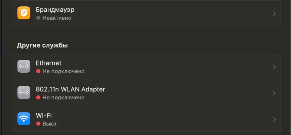

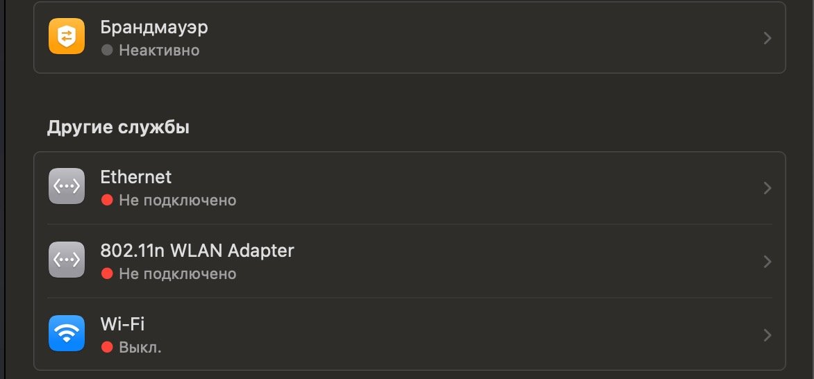

Somankr Posted July 18, 2025 Share Posted July 18, 2025 (edited) Finally Bluetooth works on Tahoe. Previously Bluetooth only worked on the Sequoia. After I disabled all USB kexts, everything works fine in Tahoe and Sequoia with the same OC EFI. Intel Core i7 12600KF, ASROCK RX 6600 XT, Asus Tuf Gaming B660M-Plus WiFi Motherboard Edited July 18, 2025 by Somankr 1 Link to comment https://www.insanelymac.com/forum/topic/361162-pre-release-macos-tahoe/page/105/#findComment-2837371 Share on other sites More sharing options...
