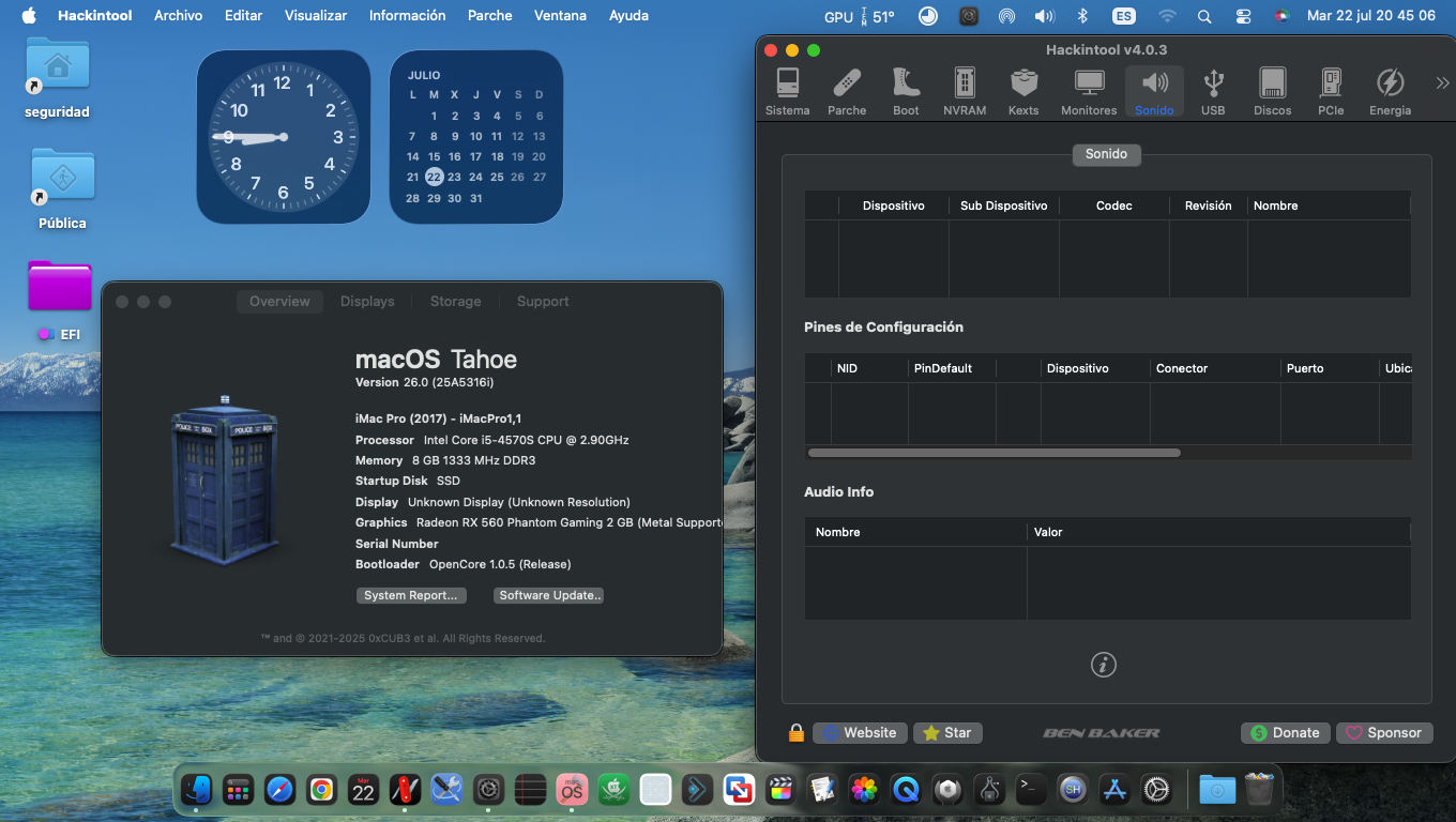

Perfect installation on OLD: using an iMacPro 1.1, deactivation to install WhateverGreen.kext. The installation is quick and complete, but the monitor does not turn on. It remains in standby mode with a red light. Once I calculate the time it finishes installing, or better yet, the system goes into standby mode and shuts down. I activate the kext and the system starts up perfectly, but I have the same problem. We have no sound.

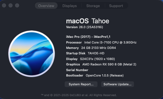

RX590
With WEG:
The system boots.
The recovery disk is inaccessible.
A black screen appears during the update.
Without WEG:
The system boots.
The update is successful.
Recovery is accessible.
I'm guessing SMBIOS is also MacPro7,1? I think this is a common issue with MacPro SMBIOSes. With iMacs, it should be better...if I remember correctly.
Sound works fine for me, with Beta 4 and OCLP-Mod. It even asked me if I wanted to patch the system again after the upgrade. :D
Only thing that doesn't work so far...but I don't really need it, is the patch for Intel Haswell Graphics. It says it can't find metallib for version 25A...

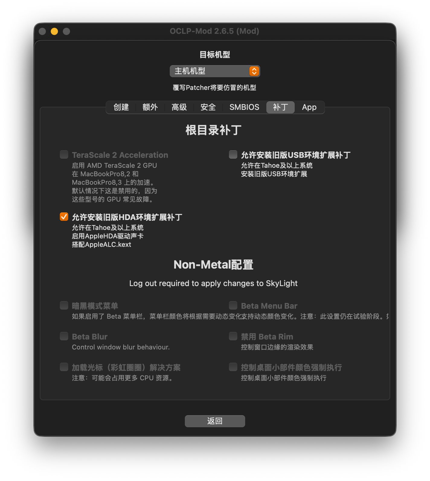

Anyway, for sound, make sure you open up settings and check the option for patching AppleHDA.

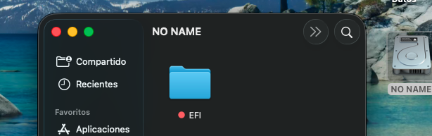

Something curious is that in beta 4 the representation of mounting the EFI looks like "NO NAME"
It happens to me if I open it with the EFI Agent, but with the others it's not what happens if we don't try all the alternatives. Closed topic.
Are you dual-booting with Windows? If so, I think that's Windows' doing, not MacOS'. However, you can simply rename the partition back to EFI from the side panel. :)
