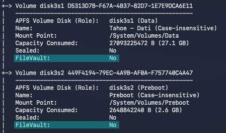

I don't have Sequoia installed on my Z390 system. Only Tahoe Beta. So I boot USB Installer to recovery mode:
FileVault:  NO on Data and Preboot Volume.

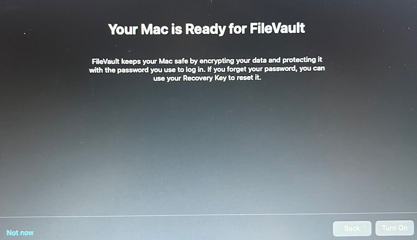

Very smooth upgrade from Tahoe Beta 3 -> Beta 4 on my 15-year old 2010 HackBookPro6,2.  Patiently waiting for non-metal Nvidia Tesla patches from OCLP Devs.  As stated previously, File Vault is no longer automatic - after Tahoe Beta 4 upgrade, macOS asked whether to enable File Vault.
About This Hack: MacBookPro6,2
Spoiler
Prompt for FileVault
Spoiler
EDIT: Note - when I upgraded my HackMini8,1 via incremental OTA (not the full macOS installer), I was not prompted to enable FileVault.  FileVault was disabled prior to the incremental Beta 4 upgrade and remained disabled after the upgrade.  On my HackBookPro6,2, I performed the upgrade with a full USB installer.  After performing the Beta 4 upgrade with a full installer, I was prompted to enable FileVault.

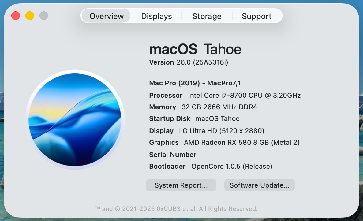

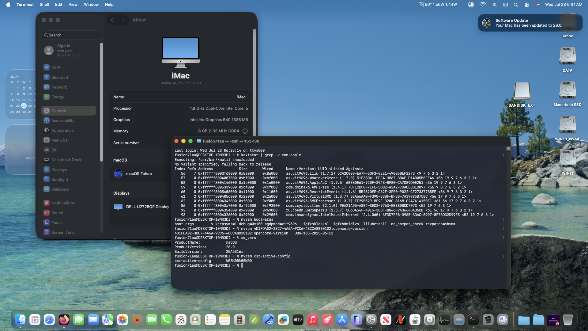

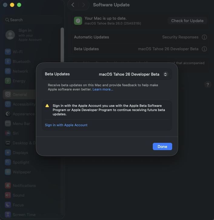

17 hours ago, fusion71au said:
Successful OTA 1.94GB delta update from Beta3 to Beta4_25A5316i for my Skylake NUC6i5SYH.  Surprisingly, I was offered the update even though I was logged out of iCloud and my Apple account.  OK that SIP was disabled...
  Reveal hidden contents
TahoeBeta4offered.png.4f7cd2b1dd0a189719838aaad61f7649.pngTahoeBeta4downloading.png.02b5315913e97f7eed219adc40ffbcb7.pngTahoeBeta4_25A5316ionNUC6i5SYH.thumb.png.ffdaccb9466e3a8d9597625491f92566.pngNotsignedin.png.c5e0e29a99f096d1262a91e8e7746982.png
  • Reverted any root patching
  • SMBIOS iMac20,1
  • OC v1.05, RestrictEvents v1.1.6, AMFIPass 1.4.1
  • nvram csr-active-config 03080000
  • boot-args included revpatch=sbvmm
Same here
only different RestrictEnvents 1.1.7 not working OTA on me .. 🫢

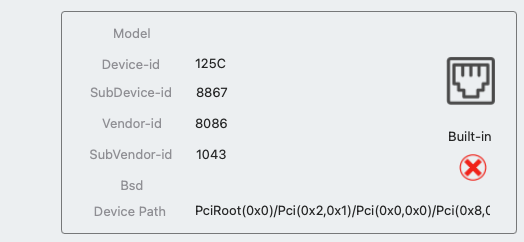

On my x870e hero Tahoe became a bit problematic to instal
I have to disable unsupported Realtek ethernet 5Gbps and also Intel i 226V doesn't work at all
On previous os i can boot without disabling unsupported ethernet and intel ethernet works well with AppleIGC kext
Some of you are using i226V with tahoe and below id? (disableIOMapper does not help here and VTD is not present in AMD motherboard bios)
thank you

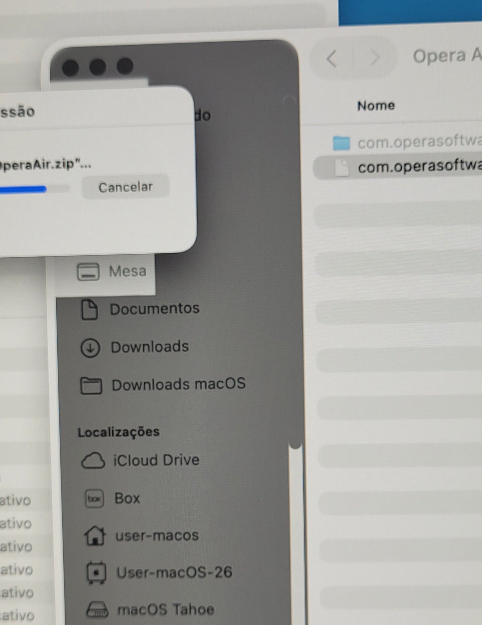

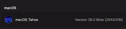

Is this happening to anyone else?
This dark gray, sometimes almost black, tone?
In some areas of the Finder, Menus, and Contexts, etc.?
As if it were mixing Light Mode and Dark Mode?
Tks.
Note: I'm using the same EFI I used with Beta 3, and in Beta 3 it was fine!

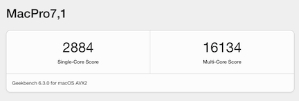

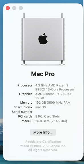

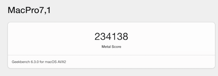

On 7/22/2025 at 11:27 PM, meg2014 said:
So, my final post on this version of the Beta (B4).  System boots great and about 10-15% faster than Beta 3, but not with Whatevergreen (the very latest version).  Whatevergreen must be disabled.
I have a Sapphire Pulse 6800XT, and on the System Report it says "Metal  - supported", but does not identify a version number.  However, if you look at my Geekbench report, you can see that my 6800XT response is excellent - almost as good as a 6900XT.
A couple of issues:  Preview is still buggy and hangs often.  The system isn't as stable as I would like, but its a bit better than Beta 3.  Baby steps I guess.  The CPU scores are a bit low for a i7-14700K, (single core in particular), but after all, its a Beta, right?  This could and should get better as the Beta rollouts continue. (I hope).
I do have Bluetooth (BCM) and audio (via HDMI and capability on my monitors).  No Wifi, of course (but I use a 10G Ethernet card so Wifi just isn't that important to me - I can wait for OCLP).
You don't need to use whatever green kext with rx6800 gpu. just add this to device properties
Edited by BALDY_MAN
  • Like 5
Tks.

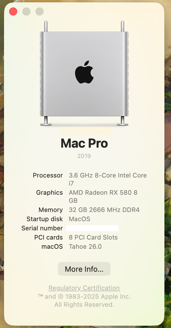

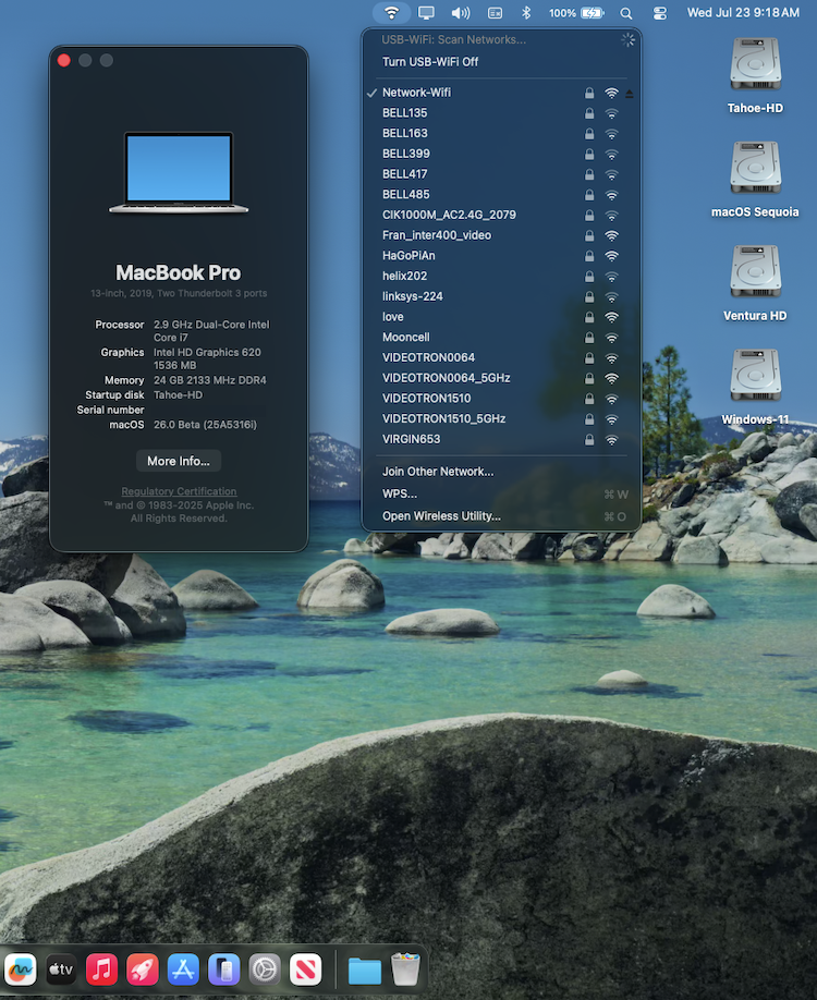

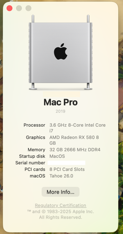

Yes, it is annoying. Especially mail app menu changing dark and light mode as I scroll. Maybe a beta 4 bug?
BTW, how are you getting a different system info display? I only see vertical system info - see attached.
