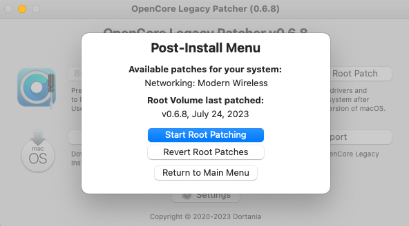

Max.1974 Posted July 25, 2023 Share Posted July 25, 2023 Are you run OCLP and click on Starting Root after adjust your config.plist? Post-Install Root Patch and click blue Botton Link to comment https://www.insanelymac.com/forum/topic/357087-macos-sonoma-wireless-issues-discussion/page/7/#findComment-2808850 Share on other sites More sharing options...

Aguys Posted July 25, 2023 Share Posted July 25, 2023 (edited) 1 hour ago, SavageAUS said: I am still unable to apply the root patches. I'm afraid OCLP only detect BCM94350 not BCM94352, that's why no wireless patch available? Since BCM94352 not natively supported by IO80211FamilyLegacy.kext, yes? I hope I'm wrong. Maybe you can test to spoof your card as BCM94350, and let's see if wireless patch become available. Edited July 25, 2023 by Aguys Link to comment https://www.insanelymac.com/forum/topic/357087-macos-sonoma-wireless-issues-discussion/page/7/#findComment-2808852 Share on other sites More sharing options...

SavageAUS Posted July 25, 2023 Author Share Posted July 25, 2023 I'm afraid OCLP only detect BCM94350 not BCM94352, that's why no wireless patch available? Since BCM94352 not natively supported by IO80211FamilyLegacy.kext, yes? I hope I'm wrong. Maybe you can test to spoof your card as BCM94350, and let's see if wireless patch become available.I can give it a go for the sake of others. I have ordered the same card that’s in my desktop and other laptop (Metabox in signature) it’s just this dell with a different chip giving me grief for now but when the new chip arrives I’m sure it will work as the other 2 did. Perhaps the OCLP devs will add this card into the patch. I’m even happy to send them mine if they need it once I get my new one This is the one I bought.Sent from my iPhone using Tapatalk 3 Link to comment https://www.insanelymac.com/forum/topic/357087-macos-sonoma-wireless-issues-discussion/page/7/#findComment-2808854 Share on other sites More sharing options...

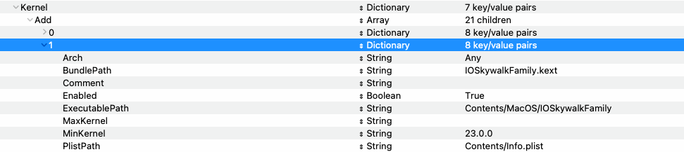

SavageAUS Posted July 25, 2023 Author Share Posted July 25, 2023 I just tested Ventura on my Metabox laptop and it kernel panics. Do we need to add min kernel to OCLP Kexts so they are not injected into Ventura?I just YOLO’d it and set min kernel to 23.0.0 and Ventura is working fine again as is SoHaveWiFi. Sent from my iPhone using Tapatalk Link to comment https://www.insanelymac.com/forum/topic/357087-macos-sonoma-wireless-issues-discussion/page/7/#findComment-2808855 Share on other sites More sharing options...

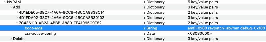

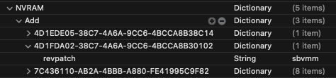

deeveedee Posted July 25, 2023 Share Posted July 25, 2023 39 minutes ago, Max.1974 said: Im used this configs for Sonoma only, Ventura is another EFI. You have revpatch=sbvmm as a boot-arg. Does it work that way? I've only specified revpatch this way 2 Link to comment https://www.insanelymac.com/forum/topic/357087-macos-sonoma-wireless-issues-discussion/page/7/#findComment-2808856 Share on other sites More sharing options...

cankiulascmnfye Posted July 25, 2023 Share Posted July 25, 2023 13 minutes ago, SavageAUS said: I just tested Ventura on my Metabox laptop and it kernel panics. Do we need to add min kernel to OCLP Kexts so they are not injected into Ventura? I just YOLO’d it and set min kernel to 23.0.0 and Ventura is working fine again as is SoHaveWiFi. Sent from my iPhone using Tapatalk Of course. MinKernel 23.0.0 For kext that should not be injected into Sonoma, set MaxKernel to 22.9.9 or if you want to be pedantic: 22.99.99 28 minutes ago, SavageAUS said: I can give it a go for the sake of others. I have ordered the same card that’s in my desktop and other laptop (Metabox in signature) it’s just this dell with a different chip giving me grief for now but when the new chip arrives I’m sure it will work as the other 2 did. Perhaps the OCLP devs will add this card into the patch. I’m even happy to send them mine if they need it once I get my new one This is the one I bought. Sent from my iPhone using Tapatalk I hope these are not actual sizes (for both) Link to comment https://www.insanelymac.com/forum/topic/357087-macos-sonoma-wireless-issues-discussion/page/7/#findComment-2808858 Share on other sites More sharing options...

Max.1974 Posted July 25, 2023 Share Posted July 25, 2023 1 hour ago, deeveedee said: You have revpatch=sbvmm as a boot-arg. Does it work that way? I've only specified revpatch this way Sorry late @deeveedee , yeap, works like that, but your way looks better !!! Thanks ALL!!! 1 hour ago, cankiulascmnfye said: @Aguys Country Code is set via DeviceProperties in my case. It's only relevant for the used frequency bands, I think. I've used XX and DE before and they all worked with Ventura. Maybe I'll give it another shot on the weekend. Both methods are supported. 14 minutes ago, mboy said: My bootloader freezes which I believe is due to com.apple.iokit.IOSkywalkFamily blocking The end of the verbose boot log 06:684 00:015 AAPL: #[EB.LD.LF|IN] 0 1 <"<null string>"> <"1"> 06:715 00:030 AAPL: #[EB.B.SBS|SZ] 723512 06:738 00:023 AAPL: #[EB|B:SHA] <e10c0de554e93abf44f4fc138dd5e12fb30863c8> 06:756 00:018 AAPL: #[EB.WL.PWLFNV|!] Err(0xE) <- RT.GV wake-failure 7C436110-AB2A-4BBB-A880-FE41995C9F82 06:771 00:015 AAPL: #[EB.WL.DT|!] Err(0xE) <- EB.WL.PWLFNV 06:786 00:014 AAPL: #[EB.WL.PWLFRTC|NONE] 06:801 00:015 AAPL: #[EB.WL.DT|!] Err(0xE) <- EB.WL.PWLFRTC 06:820 00:018 AAPL: #[EB.LD.LKC|D] <"boot\System\Library\KernelCollections\BootKernelExtensions.kc.development"> 06:842 00:021 AAPL: #[EB.LD.OFS|OPEN!] Err(0xE) <"boot\\System\\Library\\KernelCollections\\BootKernelExtensions.kc.development"> 06:860 00:018 AAPL: #[EB.LD.LKC|R.2] <"boot\System\Library\KernelCollections\BootKernelExtensions.kc"> Here are my config.plist settings: My works fine, but crashes others apps, im get back intel and LocalSend Drop, and use Ventura for while. Sonoma hav to much issues. Link to comment https://www.insanelymac.com/forum/topic/357087-macos-sonoma-wireless-issues-discussion/page/7/#findComment-2808866 Share on other sites More sharing options...

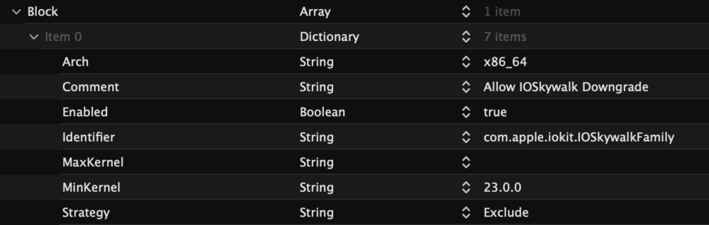

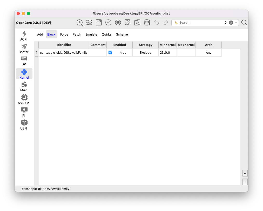

miliuco Posted July 25, 2023 Share Posted July 25, 2023 (edited) @mboy Enabled=True Important: com.apple.iokit.IOSkywalkFamily blocking must have Enabled=True and Strategy=Exclude. Otherwise you get kernel panic at boot. @Cyberdevs You were right, this is causing quite a few errors. Edited July 25, 2023 by miliuco 2 Link to comment https://www.insanelymac.com/forum/topic/357087-macos-sonoma-wireless-issues-discussion/page/7/#findComment-2808867 Share on other sites More sharing options...

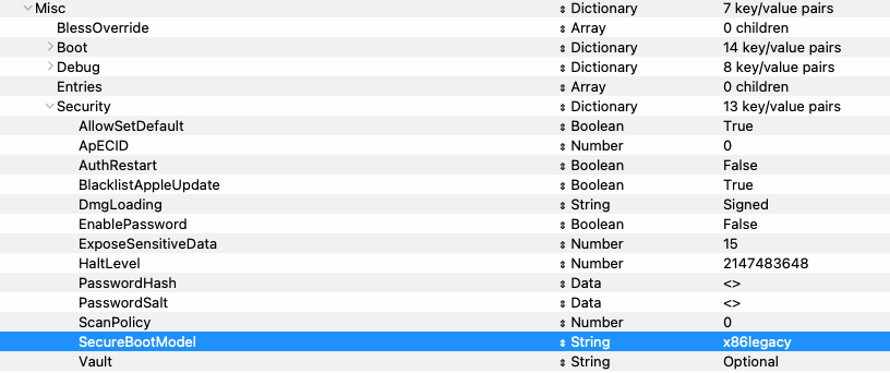

miliuco Posted July 25, 2023 Share Posted July 25, 2023 (edited) @BALDY_MAN Can you upload your Sonoma EFI (only config.plist file) if you can't get wifi networks yet? @Max.1974 You have SecureBootModel=x86legacy, try Disabled. Edited July 25, 2023 by miliuco 1 Link to comment https://www.insanelymac.com/forum/topic/357087-macos-sonoma-wireless-issues-discussion/page/7/#findComment-2808870 Share on other sites More sharing options...

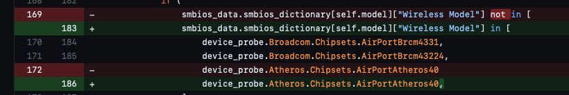

deeveedee Posted July 25, 2023 Share Posted July 25, 2023 (edited) I was inspecting the OCLP Wi-Fi patching and see what appears to be a dependency on SMBIOS Model. OCLP is designed for Real Macs, so OCLP patching adheres to the configs of real SMBIOS MacModels. Could some of the Wi-Fi issues being reported here be because some hacks are using Wi-Fi chipsets that are not the same as their real Mac counterparts? For those who want to review this, here is the commit. Edited July 25, 2023 by deeveedee 2 Link to comment https://www.insanelymac.com/forum/topic/357087-macos-sonoma-wireless-issues-discussion/page/7/#findComment-2808872 Share on other sites More sharing options...
Cyberdevs Posted July 25, 2023 Share Posted July 25, 2023 @deeveedee I think that's a possibility, as you stated OCLP was initially designed for real Macs not hackintoshes, it being working on hacks is a bonus but I think the devs took some of the variations (if not all) about the WiFi cards used in hack as well. I'm installing Sonoma on my 2013 MacBookPro to see if the AirportBrcmFixup.kext is really necessary or not but the EFI folder generated by OCLP adds it automatically so there must be a reason for that. 1 Link to comment https://www.insanelymac.com/forum/topic/357087-macos-sonoma-wireless-issues-discussion/page/7/#findComment-2808873 Share on other sites More sharing options...
Max.1974 Posted July 25, 2023 Share Posted July 25, 2023 (edited) 1 hour ago, miliuco said: @Max.1974 Você tem SecureBootModel=x86legacy, tente Disabled. Hello mi Hermano, thanks in advance, I try it, but not boot, without line boot, stuck on Apple logo. Im uninstall Sonoma patched with OCLP, because have been too much crashes, and im prefer use dual boot with my good Ventura for my work, and enjoy Sonoma without Airdrop, but better stability for now. Thanks!!! Notes: this name x86legacy was renamed automatic by OCLP Edited July 25, 2023 by Max.1974 1 Link to comment https://www.insanelymac.com/forum/topic/357087-macos-sonoma-wireless-issues-discussion/page/7/#findComment-2808874 Share on other sites More sharing options...
mboy Posted July 25, 2023 Share Posted July 25, 2023 1 hour ago, miliuco said: @mboy Enabled=True Important: com.apple.iokit.IOSkywalkFamily blocking must have Enabled=True and Strategy=Exclude. Otherwise you get kernel panic at boot. @Cyberdevs You were right, this is causing quite a few errors. Sorry; bootloader freezes with Enabled=YES. I get a kernel panic with Enabled=NO 1 Link to comment https://www.insanelymac.com/forum/topic/357087-macos-sonoma-wireless-issues-discussion/page/7/#findComment-2808876 Share on other sites More sharing options...

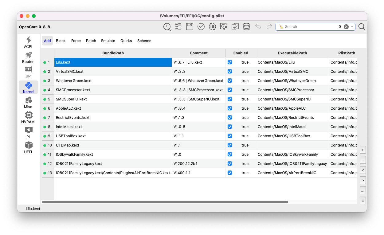

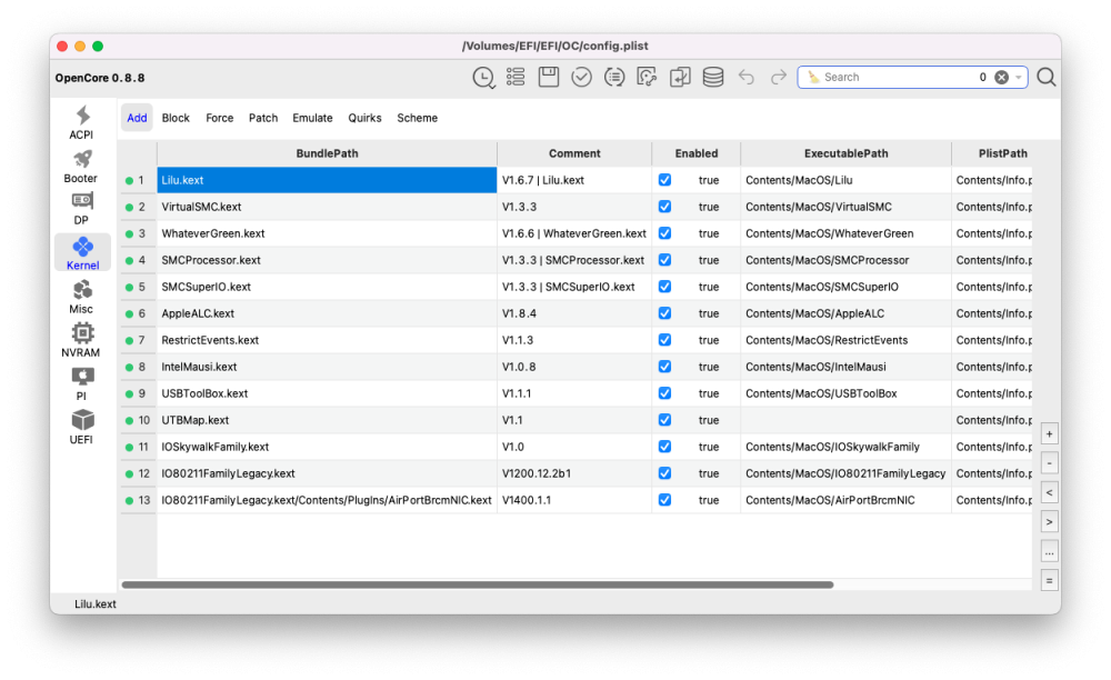

Cyberdevs Posted July 25, 2023 Share Posted July 25, 2023 For those who have issues with fenvi T919 BT/Wireless I attached the kexts required and the order they need to be in the config.plist The AirPortBrcmNIC.kext is inside the IO80211FamilyLegacy.kext and it also needs to be injected. Blocking com.apple.iokit.IOSkywalkFamily is a MUST and make sure it is set to Exclude: <key>Block</key> <array> <dict> <key>Arch</key> <string>Any</string> <key>Comment</key> <string>Allow IOSkywalk Downgrade</string> <key>Enabled</key> <true/> <key>Identifier</key> <string>com.apple.iokit.IOSkywalkFamily</string> <key>MaxKernel</key> <string></string> <key>MinKernel</key> <string>23.0.0</string> <key>Strategy</key> <string>Exclude</string> </dict> </array> You don't need any other kexts for the fenvi T919 so remove them to avoid any issues. Kext order Spoiler Hackintool screenshot Spoiler Blocking the com.apple.iokit.IOSkywalkFamily Spoiler Another addition: If you use the nightly GUI app it might not work because it's few commits behind so I suggest to build from the last commit. The GUI didn't apply Haswell Graphics patches to my 2013 MacBook Pro but the manual build did. 1783627072_WirelessKextsforSonoma.zip 4 2 Link to comment https://www.insanelymac.com/forum/topic/357087-macos-sonoma-wireless-issues-discussion/page/7/#findComment-2808879 Share on other sites More sharing options...
deeveedee Posted July 25, 2023 Share Posted July 25, 2023 22 minutes ago, Cyberdevs said: For those who have issues with fenvi T919 BT/Wireless I attached the kexts required and the order they need to be in the config.plist The AirPortBrcmNIC.kext is inside the IO80211FamilyLegacy.kext and it also needs to be injected. Blocking com.apple.iokit.IOSkywalkFamily is a MUST and make sure it is set to Exclude: <key>Block</key> <array> <dict> <key>Arch</key> <string>Any</string> <key>Comment</key> <string>Allow IOSkywalk Downgrade</string> <key>Enabled</key> <false/> <key>Identifier</key> <string>com.apple.iokit.IOSkywalkFamily</string> <key>MaxKernel</key> <string></string> <key>MinKernel</key> <string>23.0.0</string> <key>Strategy</key> <string>Exclude</string> </dict> </array> Thanks! Should Enabled be true? 1 Link to comment https://www.insanelymac.com/forum/topic/357087-macos-sonoma-wireless-issues-discussion/page/7/#findComment-2808882 Share on other sites More sharing options...

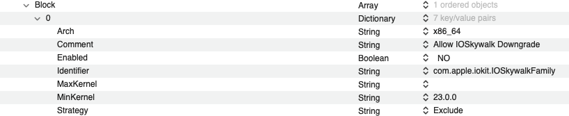

Cyberdevs Posted July 25, 2023 Share Posted July 25, 2023 32 minutes ago, deeveedee said: Thanks! Should Enabled be true? Yes it should, I just copied the block section from the reference page in OpenCore Legacy Patcher and it's set to false there, might be a mistake. Thanks for the correction. 1 Link to comment https://www.insanelymac.com/forum/topic/357087-macos-sonoma-wireless-issues-discussion/page/7/#findComment-2808889 Share on other sites More sharing options...
deeveedee Posted July 25, 2023 Share Posted July 25, 2023 9 minutes ago, Cyberdevs said: Yes it should, I just copied the block section from the reference page in OpenCore Legacy Patcher and it's set to false there, might be a mistake. Thanks for the correction. I don't think it's a mistake on the OCLP reference page. That config.plist looks like a template for all MacModels. OCLP must use that config.plist template to create the customized config.plist for each specific Mac Model. 1 Link to comment https://www.insanelymac.com/forum/topic/357087-macos-sonoma-wireless-issues-discussion/page/7/#findComment-2808891 Share on other sites More sharing options...
Cyberdevs Posted July 25, 2023 Share Posted July 25, 2023 5 minutes ago, deeveedee said: I don't think it's a mistake on the OCLP reference page. That config.plist looks like a template for all MacModels. OCLP must use that config.plist template to create the customized config.plist for each specific Mac Model. That makes sense Link to comment https://www.insanelymac.com/forum/topic/357087-macos-sonoma-wireless-issues-discussion/page/7/#findComment-2808892 Share on other sites More sharing options...
surenmunoo Posted July 25, 2023 Share Posted July 25, 2023 3 hours ago, deeveedee said: I was inspecting the OCLP Wi-Fi patching and see what appears to be a dependency on SMBIOS Model. OCLP is designed for Real Macs, so OCLP patching adheres to the configs of real SMBIOS MacModels. Could some of the Wi-Fi issues being reported here be because some hacks are using Wi-Fi chipsets that are not the same as their real Mac counterparts? For those who want to review this, here is the commit. I use BCM4360 which is listed for real Macs but cannot boot with changes. I am using the mod OC and created a new EFI with no Fork/Mod and I managed to boot Sonoma with the changes but when I try to enable the patch it says no patches available 1 Link to comment https://www.insanelymac.com/forum/topic/357087-macos-sonoma-wireless-issues-discussion/page/7/#findComment-2808900 Share on other sites More sharing options...
