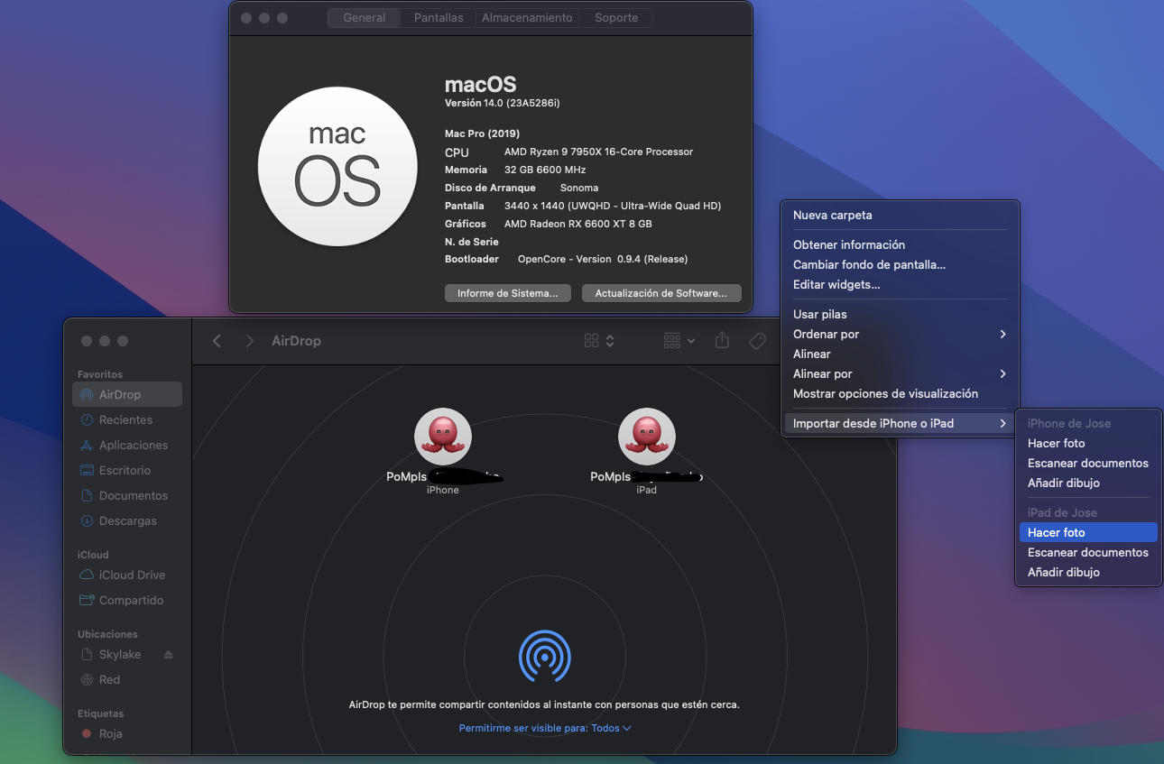

PoMpIs Posted July 24, 2023 Share Posted July 24, 2023 Honestly, the developers have done a great job... Works like a charm, even on my current computer, which is an AMD 👌 AirDrop is addictive 🥰 6 Link to comment Share on other sites More sharing options...

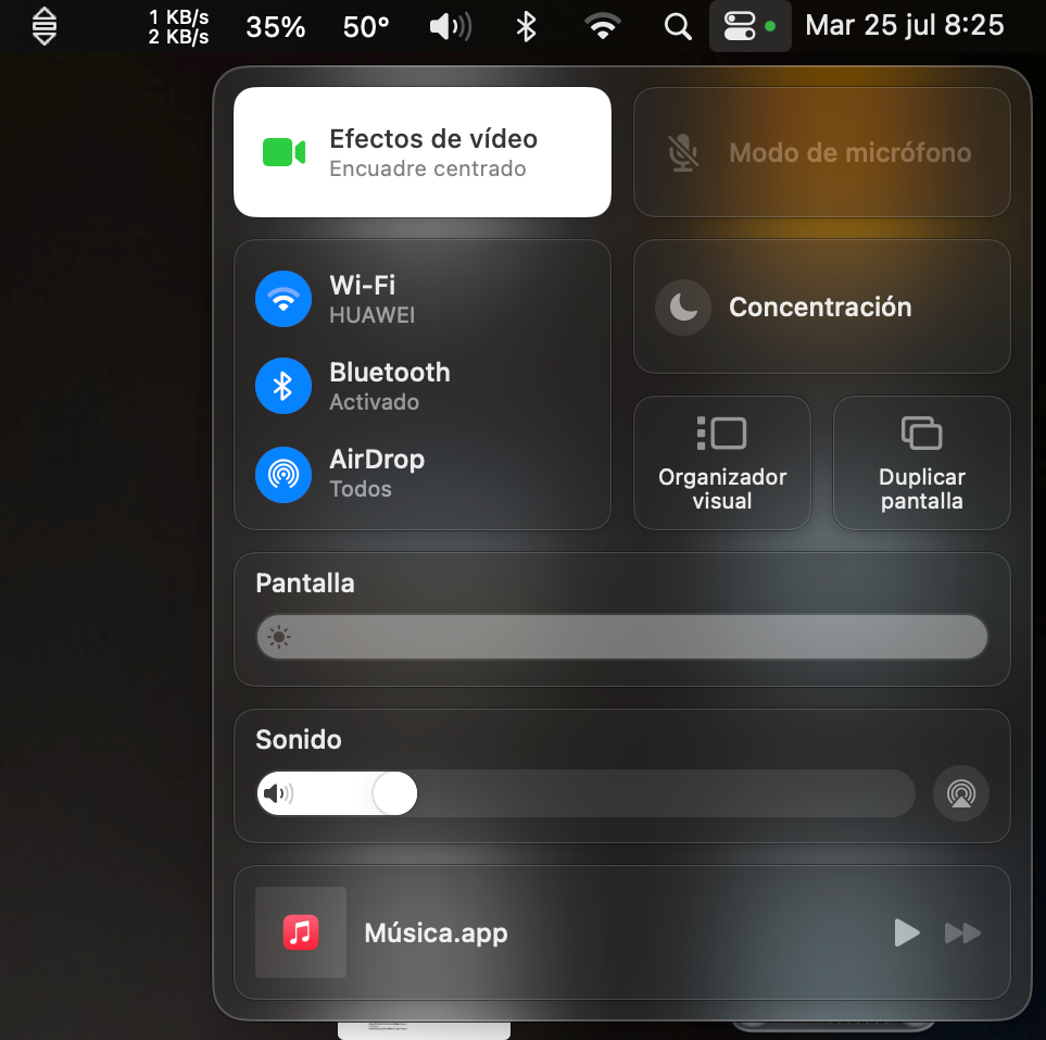

eSaF Posted July 24, 2023 Share Posted July 24, 2023 (edited) Honestly Guys hand on heart, this is not a swipe or gripe at the OCLP progress, as I think it is phenomenal the level they have reached to get our Broadcom wifi working and the estimate that was quoted sometime ago was about 6 months to get even a semblance of a working wifi. I noticed a difference in the iPhone Camera Hand Off to Mac between Ventura and Sonoma. The Staging Feature where your portrait is kept central on the screen even when you move around. I don't know if it's just my system or a limitation so far in the OCLP Beta. All in all I am happy where we are as I predict big things will come from the Devs in time to come. Edited July 24, 2023 by eSaF 4 Link to comment Share on other sites More sharing options...

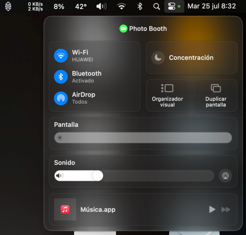

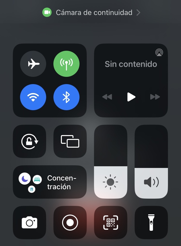

miliuco Posted July 24, 2023 Share Posted July 24, 2023 @eSaF My iPhone 11 has the same control center on Ventura and Sonoma, it is not as yours, phone model has to do with it. Spoiler 1 1 Link to comment Share on other sites More sharing options...

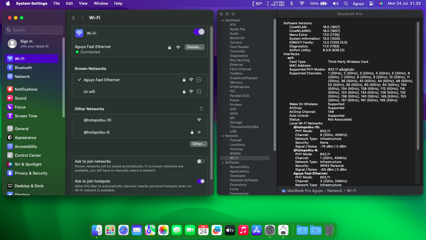

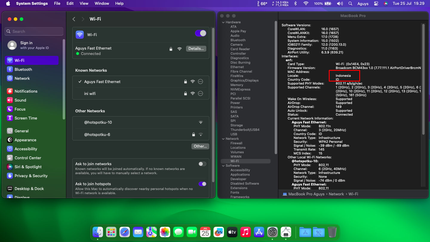

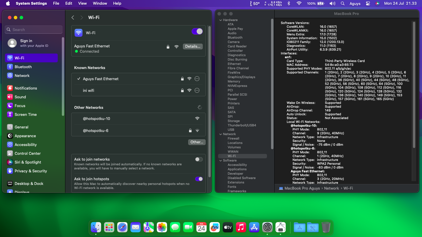

Aguys Posted July 24, 2023 Share Posted July 24, 2023 Join the party, DW1820A... 2 2 Link to comment Share on other sites More sharing options...

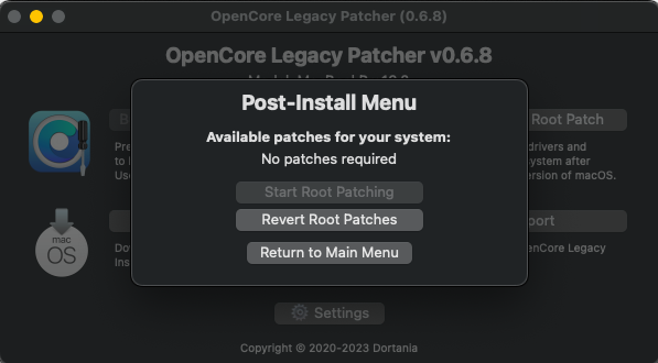

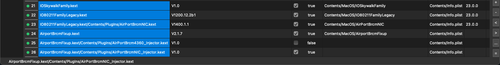

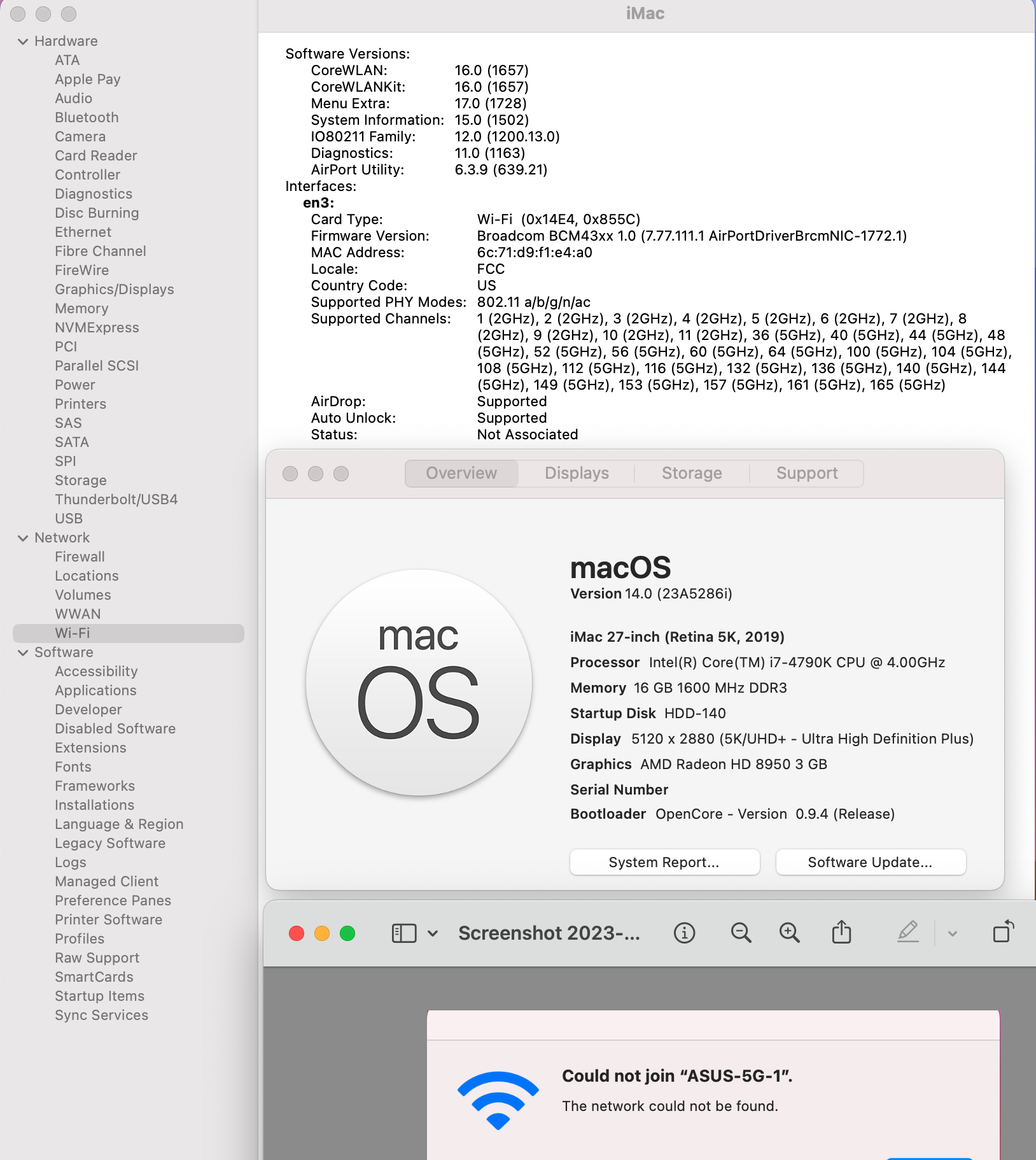

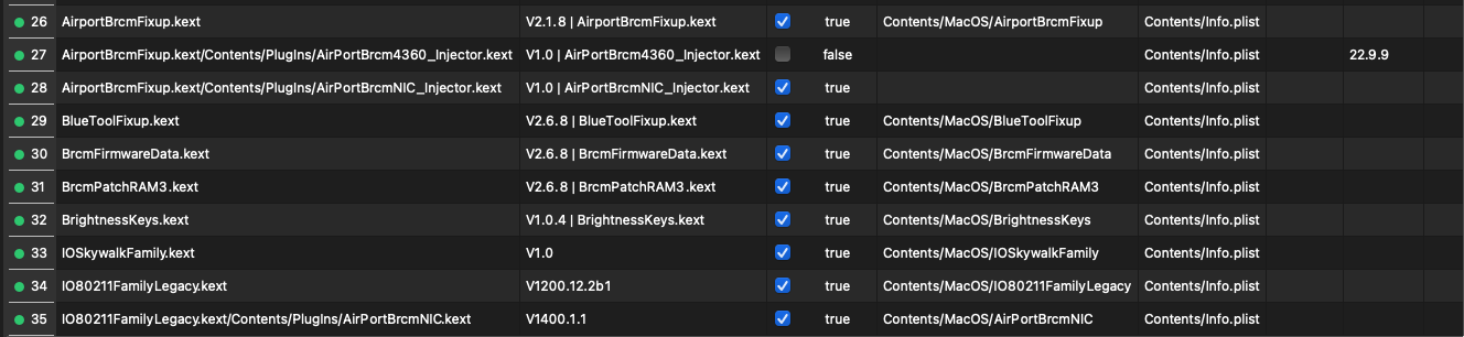

SavageAUS Posted July 25, 2023 Author Share Posted July 25, 2023 Pretty sure this time it is not user error. No root patching required? DW1560 chip I have rebooted and cleared NVRAM. I am happy to purchase a BCM94360NG for this machine if needed, but if I don't need too I won't Spoiler 2 1 Link to comment Share on other sites More sharing options...

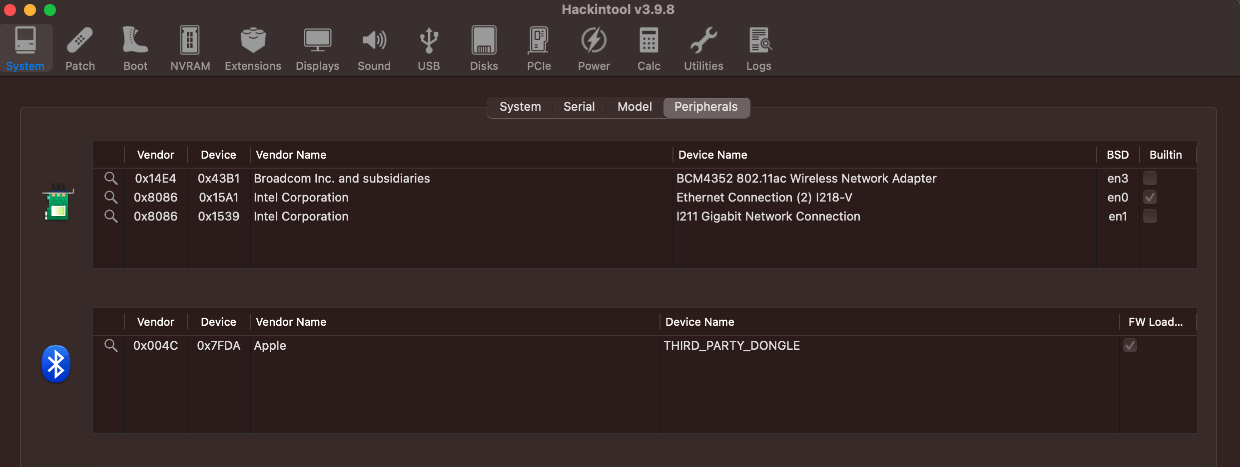

jsl2000 Posted July 25, 2023 Share Posted July 25, 2023 (edited) 7 hours ago, SavageAUS said: Pretty sure this time it is not user error. No root patching required? DW1560 chip I have rebooted and cleared NVRAM. I am happy to purchase a BCM94360NG for this machine if needed, but if I don't need too I won't Reveal hidden contents Thanks for your post. Can you take a look of my config.plist why my BRCM4352 working at Ventura but not working at Sonoma in Z97 hackintosh ? config.plist Edited July 25, 2023 by jsl2000 Link to comment Share on other sites More sharing options...

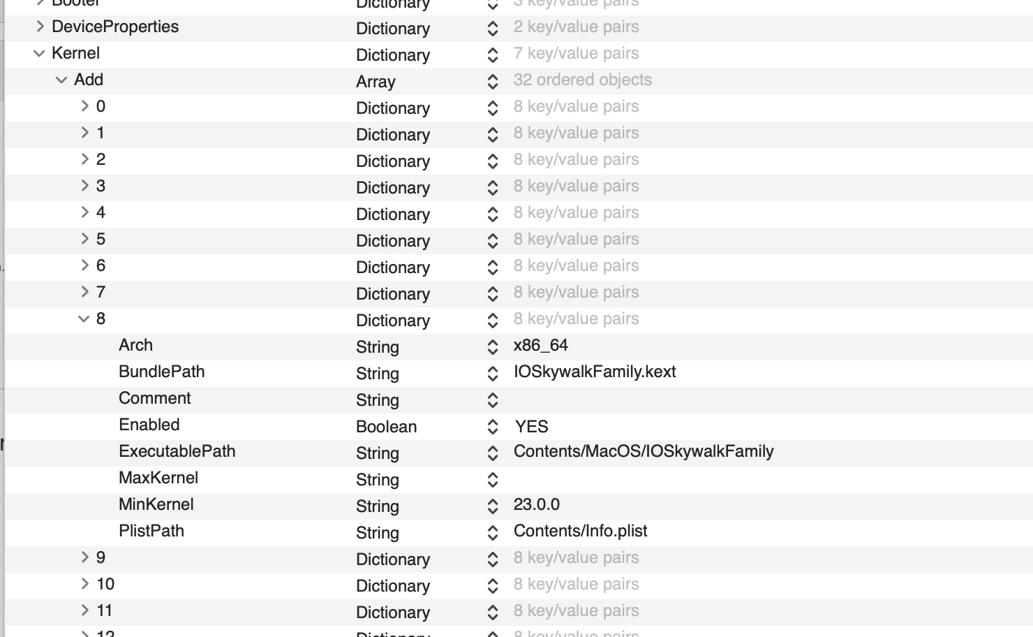

FirstTimeCustomac Posted July 25, 2023 Share Posted July 25, 2023 4 minutes ago, jsl2000 said: Thanks for your post. Can you take a look of my config.plist why my BRCM4360 working at Ventura but not working at Sonoma in Z97 hackintosh ? config.plist 35.42 kB · 1 download I think you are missing the IOSkywalkFamily.kext injection. Link to comment Share on other sites More sharing options...

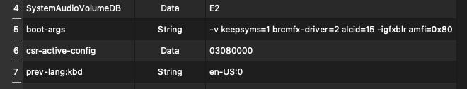

SavageAUS Posted July 25, 2023 Author Share Posted July 25, 2023 Pretty sure this time it is not user error. No root patching required? DW1560 chip I have rebooted and cleared NVRAM. I am happy to purchase a BCM94360NG for this machine if needed, but if I don't need too I won't Spoiler I’ve been at this all day. Can anyone see anything wrong?Sent from my iPhone using Tapatalk Pretty sure this time it is not user error. No root patching required? DW1560 chip I have rebooted and cleared NVRAM. I am happy to purchase a BCM94360NG for this machine if needed, but if I don't need too I won't Spoiler I’ve been at this all day. Can anyone see anything wrong?Sent from my iPhone using Tapatalk Link to comment Share on other sites More sharing options...

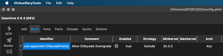

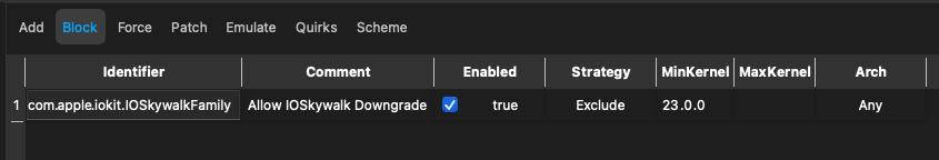

eSaF Posted July 25, 2023 Share Posted July 25, 2023 1 hour ago, SavageAUS said: I’ve been at this all day. Can anyone see anything wrong? Hi Bro sorry if I misunderstand your query but do you have this Entry in your config.plist? This small but important detail was missing in mine and gave me a torrid time until the good folks here pointed out the error. Hope this helps and Good luck. Link to comment Share on other sites More sharing options...
SavageAUS Posted July 25, 2023 Author Share Posted July 25, 2023 Hi Bro sorry if I misunderstand your query but do you have this Entry in your config.plist? This small but important detail was missing in mine and gave me a torrid time until the good folks here pointed out the error. Hope this helps and Good luck.Yeah it’s the 4th pic. Sent from my iPhone using Tapatalk Link to comment Share on other sites More sharing options...
eSaF Posted July 25, 2023 Share Posted July 25, 2023 1 hour ago, SavageAUS said: Yeah it’s the 4th pic. Ok thanks, my bad for missing it. Hopefully someone with your Broadcom 4352 Card will point you in the right direction. Fingers crossed. Link to comment Share on other sites More sharing options...

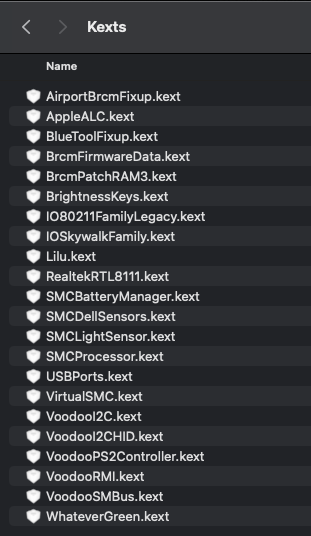

eSaF Posted July 25, 2023 Share Posted July 25, 2023 (edited) @SavageAUS - Here is another suggestion to try, remove those extra kexts from the kext Folder and config.plist and just have these three as shown. Making sure that the IOSkywalkFamily.kext comes before the other two. Reboot clean Nvram and see if you can progress any further. If you do progress, you can add back the B/Tooth and WiFi extra kexts if needed but they must be after the Skywalk kext in the kext tree not before. Edited July 25, 2023 by eSaF 1 Link to comment Share on other sites More sharing options...

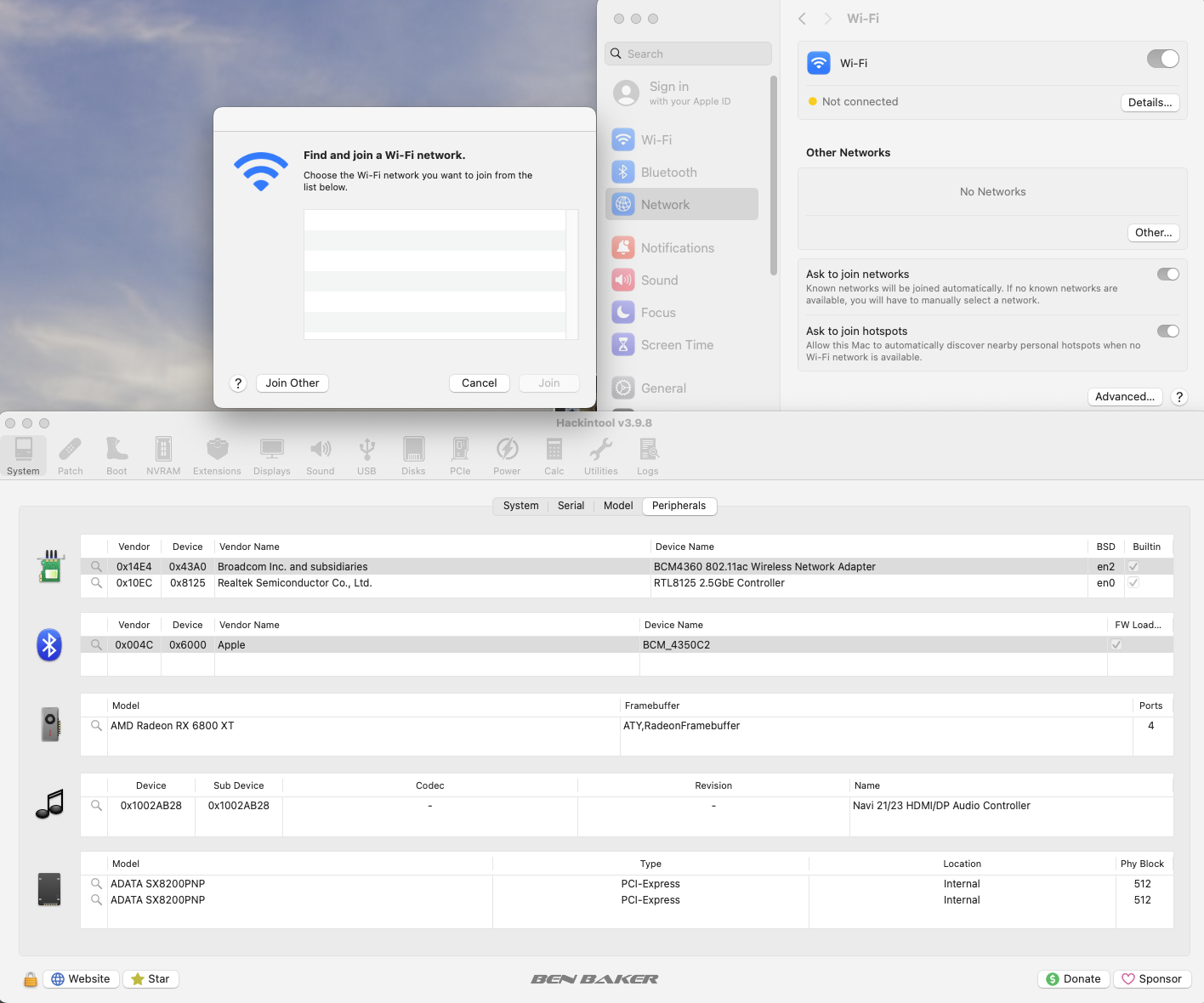

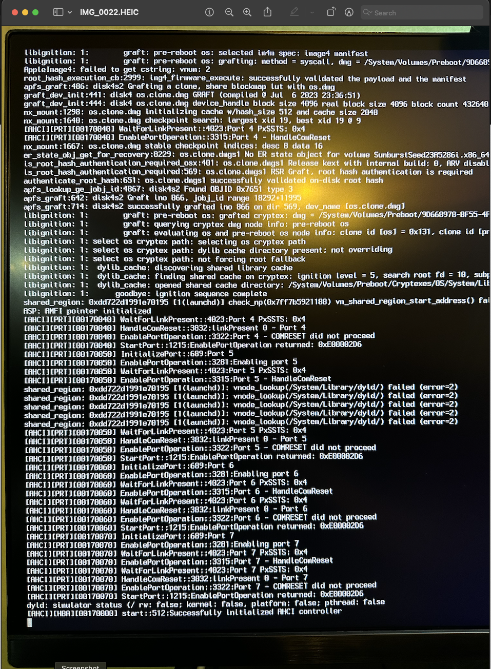

surenmunoo Posted July 25, 2023 Share Posted July 25, 2023 (edited) Well, after staying awake till after midnight last night and working at this WIFI for the whole day today, I finally give up and will stay with wifi on Sonoma, its just not worth the headache this Asus Z790 ProArt is putting me through. Took out my M.2 drives and put them all into my sons PC - Asus Z790 Gaming-E and the same result, systems will not boot with those 3 kexts enabled. I take the same EFI that boots Ventura and Sonoma and copy that to a USB and make this changes, cannot boot Sonoma after that no matter how many NVRAM resets I do, even re-installed Sonoma twice and nothing. My unedited config if anyone wants to see if they can help. I tried with those IO kexts loaded and in order as to what I found on here, turned off AirportBrcmFixup.ext, turn it on - tried many iterations but nada nothing works config.plist.zip And this is the config from the EFI I edited config.plist.zip Edited July 25, 2023 by surenmunoo 1 1 Link to comment Share on other sites More sharing options...
eSaF Posted July 25, 2023 Share Posted July 25, 2023 9 hours ago, miliuco said: My iPhone 11 has the same control center on Ventura and Sonoma, it is not as yours, phone model has to do with it. Good day my fellow 'Hackster' thanks for the feedback, my Phone is also the 11 but I was referring to the display on the P/C it self not the Phone. The difference between Sonoma and Ventura. That's what the pics are showing, but no problem, maybe all change in the next Beta. 1 Link to comment Share on other sites More sharing options...
