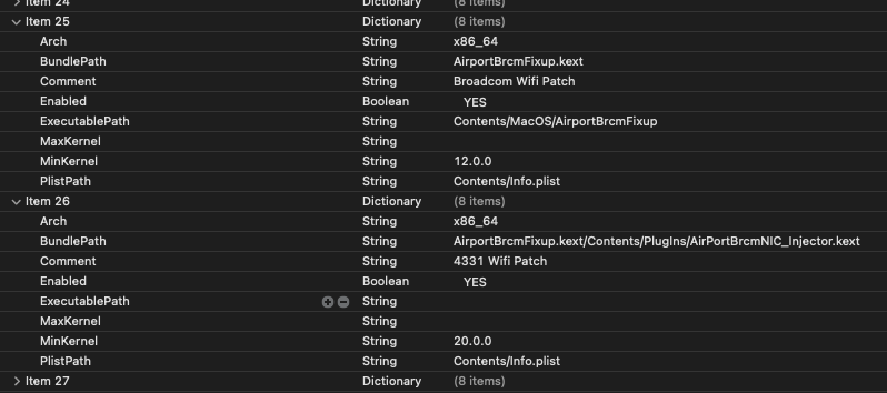

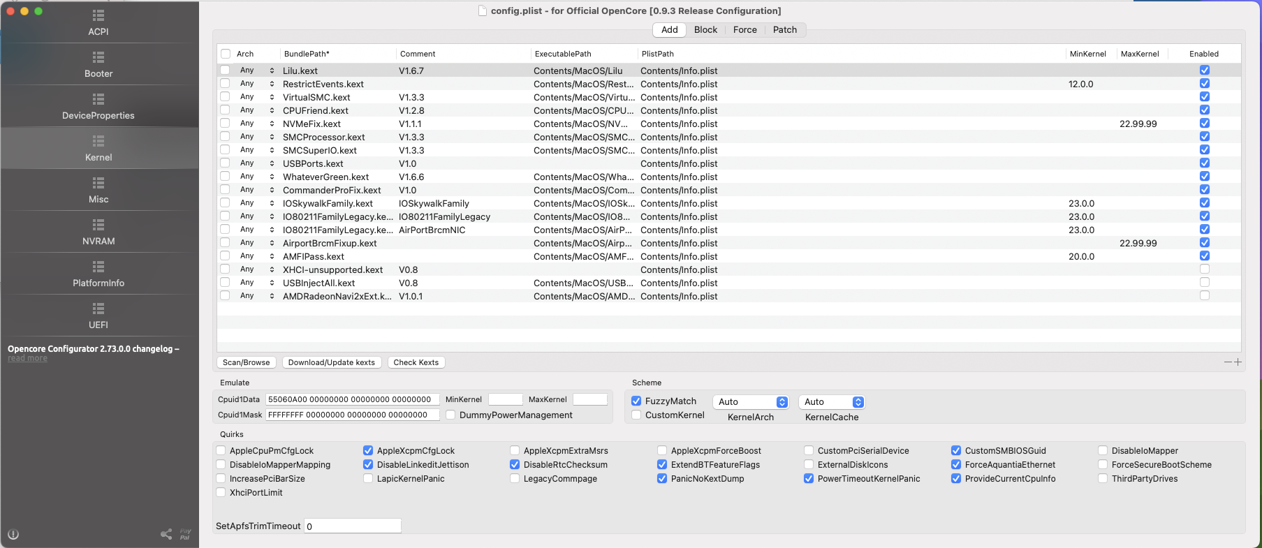

ThriftLover Posted July 29, 2023 Share Posted July 29, 2023 21 hours ago, deeveedee said: Replace AirportBrcmFixup.kext 2.1.7 in OC/Kexts with the AirportBrcmFixup.kext 2.1.7 in the OCLP-Generated EFI (they have the same version, but have different sizes) Hide contents Hmm... Weird. I noticed that they are of a different size because the AirportBrcmFixup.kext from OCLP does not have AirPortBrcm4360_Injector.kext in its PlugIn folder. If you delete AirPortBrcm4360_Injector.kext the size is exactly the same. NO changes in info.plist or the contents of AirportBrcmFixup binary after comparing them in BBEdit. AirportBrcmFixup.kext from iMac18,3 generated EFI also have a different size which is actually missing both AirPortBrcm4360_Injector.kext and AirPortBrcmNIC_Injector.kext but other than that I didn't notice any difference. 2 Link to comment https://www.insanelymac.com/forum/topic/357087-macos-sonoma-wireless-issues-discussion/page/12/#findComment-2809189 Share on other sites More sharing options...
deeveedee Posted July 29, 2023 Share Posted July 29, 2023 (edited) On 7/29/2023 at 4:03 PM, ThriftLover said: Hmm... Weird. I noticed that they are of a different size because the AirportBrcmFixup.kext from OCLP does not have AirPortBrcm4360_Injector.kext in its PlugIn folder. If you delete AirPortBrcm4360_Injector.kext the size is exactly the same. NO changes in info.plist or the contents of AirportBrcmFixup binary after comparing them in BBEdit. AirportBrcmFixup.kext from iMac18,3 generated EFI also have a different size which is actually missing both AirPortBrcm4360_Injector.kext and AirPortBrcmNIC_Injector.kext but other than that I didn't notice any difference. EDIT: @ThriftLover - you were right to think this was weird. I was experimenting with device spoofing and different versions of AirportBrcmFixup.kext as I explain here and misinterpreted my test results. It was the spoofing and NOT the AirportBrcmFixup.kext version that resulted in successful Wi-Fi patching in Sonoma. See my mea culpa here. Leaving my comments below for historical purposes, but my conclusions below are wrong. ============================================= Good find. EDIT: kextstat in Sonoma shows these Brcm kexts on my hack (same as in Ventura) Spoiler EDIT2: The OC config.plist generated by OCLP 0.6.9 does inject the Brcm plugin kext. Spoiler If the kext change really is just removal of the plugins, why not just remove the plugin from the config.plist (or disable it) instead of modifying the kext? EDIT3: @ThriftLover If I disable the AirPortBrcmNIC_Injector.kext kext injection in my config.plist, Wi-Fi no longer works in Sonoma. The OCLP Devs are clearly working more magic than we know. Could it be that somehow, OCLP 0.6.9 post-install patching is partially injecting the plugin kext (thus the removal of the plugins from AirportBrcmFixup.kext) and that OC's Kernel > Add processing is only part of the full kext injection? I don't doubt that you are correct (that the difference between the two AirportBrcmFixup.kexts is the removal of the plugins). Without knowing anything about this and I am making a complete guess, I would say that the plugins are removed from AirportBrcmFixup.kext, so that they don't override kext injection which includes a "partial kext injection" by the post-install patches. Edited July 31, 2023 by deeveedee 2 Link to comment https://www.insanelymac.com/forum/topic/357087-macos-sonoma-wireless-issues-discussion/page/12/#findComment-2809190 Share on other sites More sharing options...

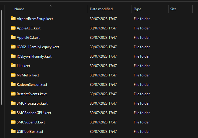

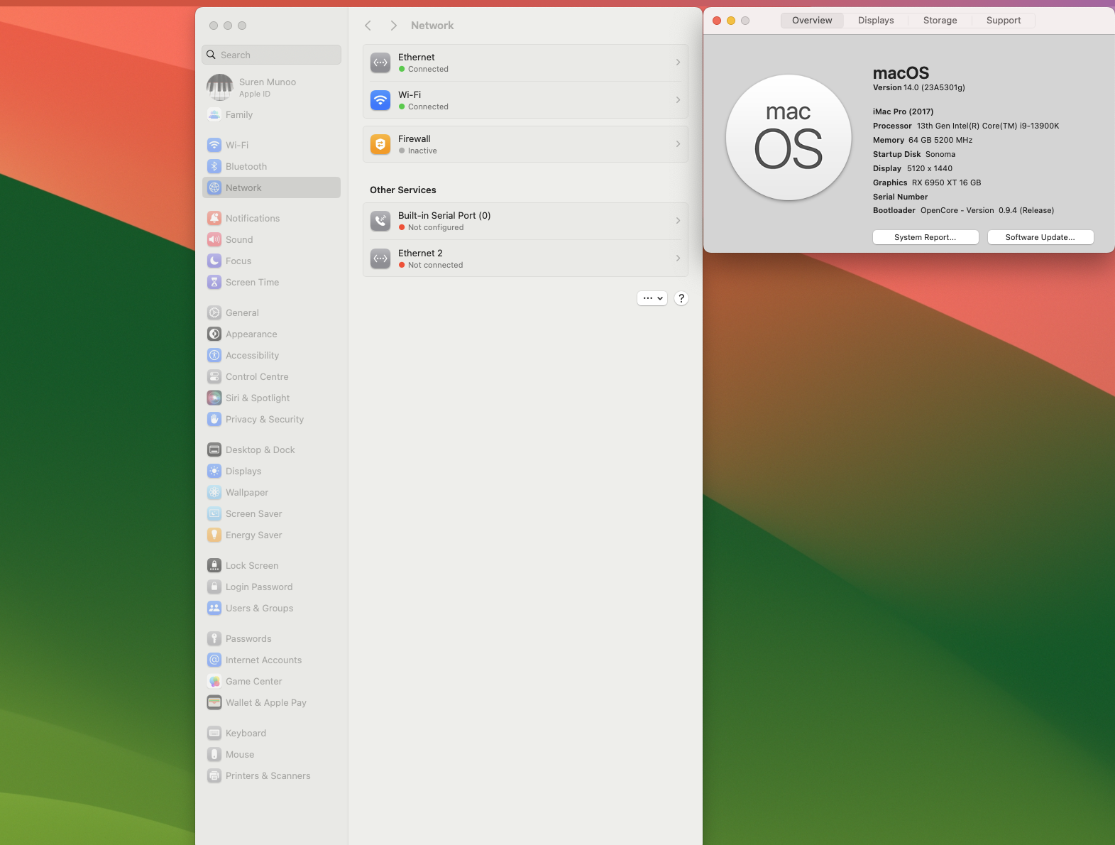

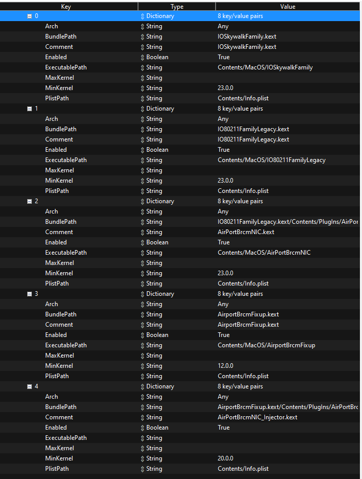

surenmunoo Posted July 29, 2023 Share Posted July 29, 2023 (edited) So, After many trys and many days and nights of Frustrations, I finally got WIFI working and Sonoma booting quickly. I read what @deeveedee posted about getting his wifi working and creating an EFI from OCLP and using that has a reference point to get this going. I did the same and voila, working. Now if someone can look at my config and see why I can't get my usb ports to show in Hackintool. I created all new SSDT's using SSDTTime in windows and just threw all of them in ACPI due to frustration or maybe that amfi.kext is causing the issue ***EDIT *** USB ports now working after some SSDTD changes and a new USB mapping config.plist.zip Edited July 30, 2023 by surenmunoo 4 Link to comment https://www.insanelymac.com/forum/topic/357087-macos-sonoma-wireless-issues-discussion/page/12/#findComment-2809196 Share on other sites More sharing options...

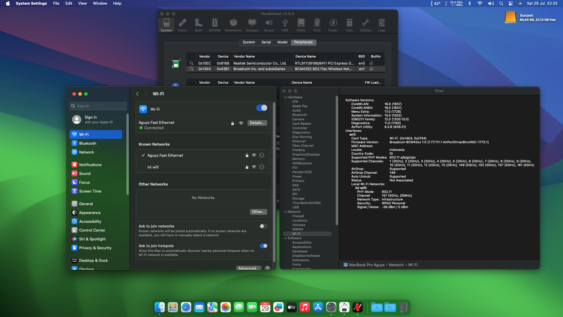

Aguys Posted July 29, 2023 Share Posted July 29, 2023 AW-CE123H (BCM94352HMB) working on already patched system. 3 Link to comment https://www.insanelymac.com/forum/topic/357087-macos-sonoma-wireless-issues-discussion/page/12/#findComment-2809201 Share on other sites More sharing options...

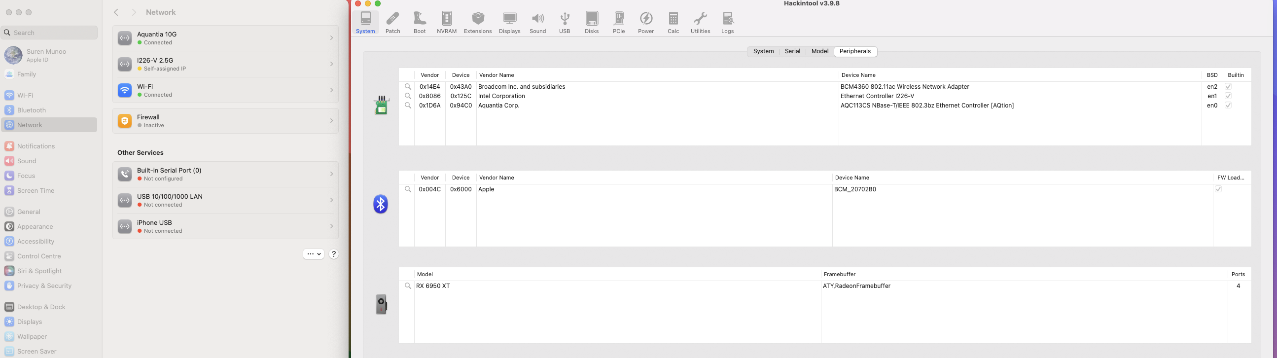

surenmunoo Posted July 30, 2023 Share Posted July 30, 2023 Anyone else that has the I226-V network on their Sonoma not working after doing the patch to get Wifi working, what did you do to fix it. Mine shows up but does not get an IP address. Link to comment https://www.insanelymac.com/forum/topic/357087-macos-sonoma-wireless-issues-discussion/page/12/#findComment-2809205 Share on other sites More sharing options...

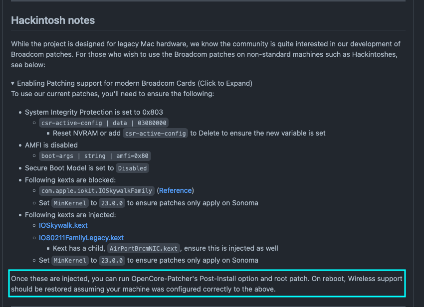

mnfesq Posted July 30, 2023 Share Posted July 30, 2023 On 7/26/2023 at 12:15 AM, cankiulascmnfye said: @surenmunoo In the notes of the Sonoma OCLP Development bracnh it says, that you still have to apply root patches with OCLP 068 afterwards to make it work: Source: https://github.com/dortania/OpenCore-Legacy-Patcher/pull/1077#issuecomment-1646934494 I disabled AMFI and Firefox and WhatsApp for Mac both stopped working. Anyone have a possible solution or workaround? Link to comment https://www.insanelymac.com/forum/topic/357087-macos-sonoma-wireless-issues-discussion/page/12/#findComment-2809212 Share on other sites More sharing options...

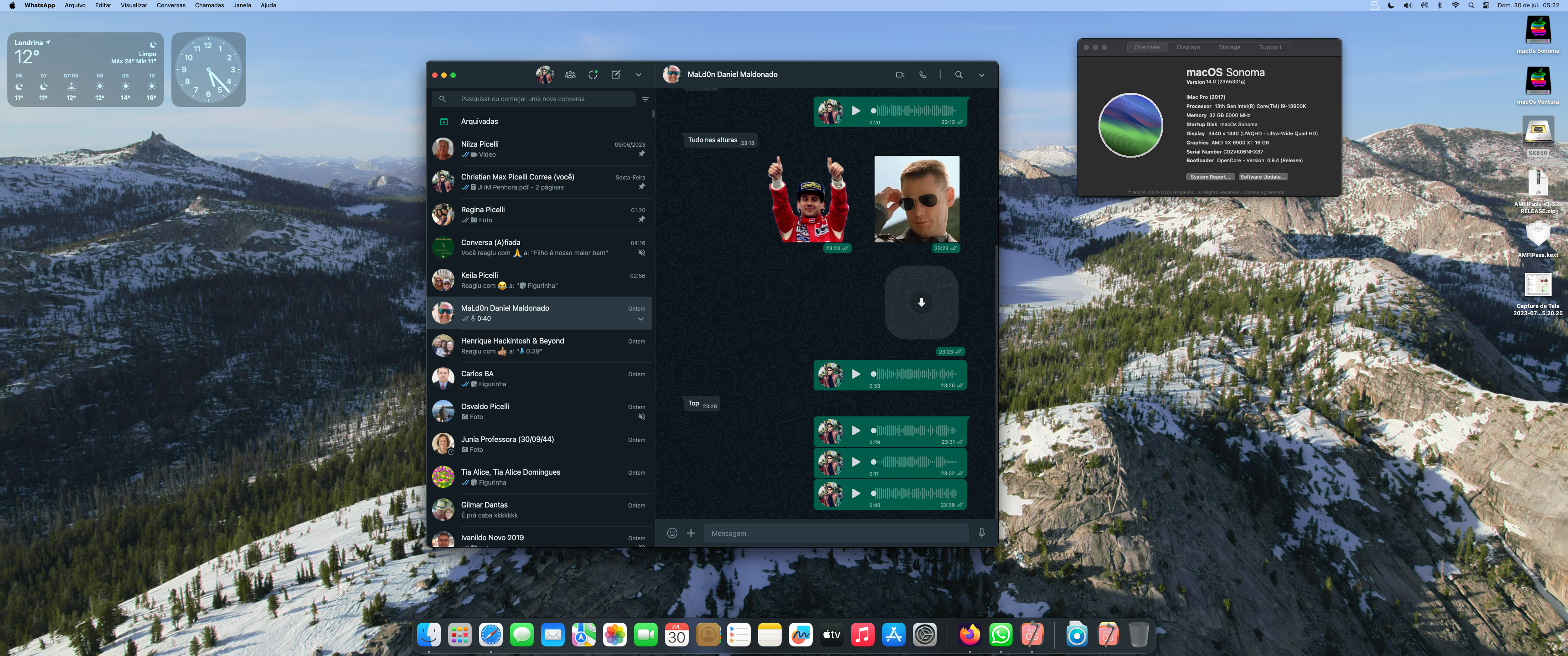

Max.1974 Posted July 30, 2023 Share Posted July 30, 2023 4 hours ago, mnfesq said: I disabled AMFI and Firefox and WhatsApp for Mac both stopped working. Anyone have a possible solution or workaround? Same to me. I will try this kext. 3 hours ago, AppleBreak said: Please try AMFIPass.kext with -amfipassbeta boot flag and remove amfi=0x80 Link to comment https://www.insanelymac.com/forum/topic/357087-macos-sonoma-wireless-issues-discussion/page/12/#findComment-2809218 Share on other sites More sharing options...

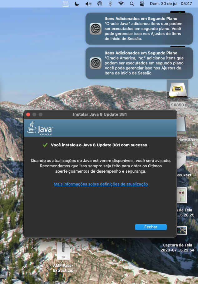

Max.1974 Posted July 30, 2023 Share Posted July 30, 2023 Very nice this AMFIPass.kext Im run executable Patcher program from @chris1111 page. https://gist.github.com/chris1111/781e9324bcd9657af294462c0b3f6582 After that drag and drop OpenCore-Patcher on Terminal to finish and get AMFIPass-v1.3.1-RELEASE.zip on Desktop. Works Airdrop, Wireless, WhatsApp Desktop and Firefox again!! Thanks a LOT to everybody 2 Link to comment https://www.insanelymac.com/forum/topic/357087-macos-sonoma-wireless-issues-discussion/page/12/#findComment-2809219 Share on other sites More sharing options...
emax31 Posted July 30, 2023 Share Posted July 30, 2023 20 hours ago, deeveedee said: It does appear that the key to working Sonoma Wi-Fi with the BCM 94352HMB was replacement of the Acidanthera AirportBrcmFixup.kext 2.1.7 with AirportBrcmFixup.kext 2.1.7 included with OCLP 0.6.9 (different kexts, same version). See here. I don't see any commits in the Acidanthera repo (yet). I'd be curious to know the change if anyone knows. EDIT: Maybe in the Dortania nightly builds? I haven't checked yet. *** Nope - not yet. The difference that I see between the 2 versions of AirportBrcMfixup.kext is the absence of the plugin: AirportbrcM4360_injector.kext 2 Link to comment https://www.insanelymac.com/forum/topic/357087-macos-sonoma-wireless-issues-discussion/page/12/#findComment-2809220 Share on other sites More sharing options...
Max.1974 Posted July 30, 2023 Share Posted July 30, 2023 Java install normally too Link to comment https://www.insanelymac.com/forum/topic/357087-macos-sonoma-wireless-issues-discussion/page/12/#findComment-2809222 Share on other sites More sharing options...

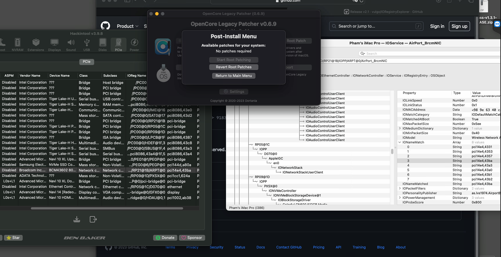

hoaug Posted July 30, 2023 Share Posted July 30, 2023 (edited) @deeveedee sorry for bothering, can you help me a bit. i tried doing the same as you did, however i can't activate the root patch because it's greyed out ( cant press root patch - OCLP 0.6.9 nightly build ). without OCLP wifi can turn on but not find any wifi signal. (i have mapped the usb correctly, did your way in the most accurate way) am i doing something wrong, please help me. below is my EFI, thank you very much! ( my wifi is BCM943602CDP ) EFI.zip Edited July 30, 2023 by kinhhoang161 Link to comment https://www.insanelymac.com/forum/topic/357087-macos-sonoma-wireless-issues-discussion/page/12/#findComment-2809231 Share on other sites More sharing options...
