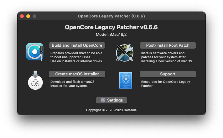

miliuco Posted May 21, 2023 Share Posted May 21, 2023 (edited) Just now I've noticed the huge change in the graphical interface that OCLP 0.6.6 is receiving. Pleasantly surprised. It almost looks like a different app. I don't know where khronokernel and the others find the time to make so many contributions. Spoiler My iMac16,2 is still very easy to use with OCLP and Ventura 13.4, no issues, all is working fine. EDIT: as a beta, OCLP 0.6.6 sometimes hangs when relaunching as root. Apart of this, no other issue so far. Edited May 21, 2023 by miliuco 4 Link to comment https://www.insanelymac.com/forum/topic/354499-installing-new-macos-on-unsupported-hardware-oclp-patcher-and-others/page/10/#findComment-2804934 Share on other sites More sharing options...

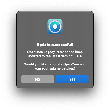

miliuco Posted May 23, 2023 Share Posted May 23, 2023 Thanks @deeveedee Updated flawlessly. Very nice new UI. Surprised by the new update system, detecting an older OCLP version and offering updating it, even building a new OpenCore EFI, installing it into the macOS disk and applying root patches, impressive. Spoiler 2 Link to comment https://www.insanelymac.com/forum/topic/354499-installing-new-macos-on-unsupported-hardware-oclp-patcher-and-others/page/10/#findComment-2805039 Share on other sites More sharing options...

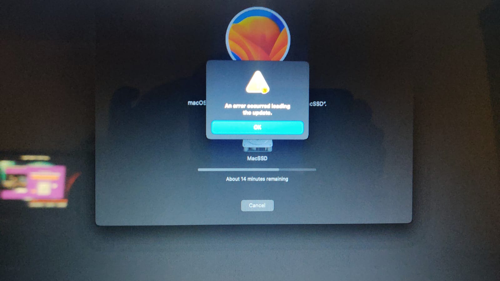

Allan Posted May 26, 2023 Share Posted May 26, 2023 Hello guys! I'm facing an issue trying to install macOS Ventura (last stable release) on a MacbookPro 8,3 + OCLP 0.6.6 + USB stick 16GB, 2.0 I've erase the disk, and begin the installation, but when it's get closer to end I got this message: "An error occurred while updating or installing macOS" Pic bellow 👇 Spoiler Do you have some tips? Thank you 1 1 Link to comment https://www.insanelymac.com/forum/topic/354499-installing-new-macos-on-unsupported-hardware-oclp-patcher-and-others/page/10/#findComment-2805178 Share on other sites More sharing options...
STLVNUB Posted May 26, 2023 Share Posted May 26, 2023 16 minutes ago, Allan said: Hello guys! I'm facing an issue trying to install macOS Ventura (last stable release) on a MacbookPro 8,3 + OCLP 0.6.6 + USB stick 16GB, 2.0 I've erase the disk, and begin the installation, but when it's get closer to end I got this message: "An error occurred while updating or installing macOS" Pic bellow 👇 Reveal hidden contents Do you have some tips? Thank you If You Use The CreateMediaInstall Method Try This DON"T BOOT OF THE USB INSTEAD Run The ??.App From The USB ( ?? Means The Installer ) Should Sort Out The Problem Well it Did Here 1 Link to comment https://www.insanelymac.com/forum/topic/354499-installing-new-macos-on-unsupported-hardware-oclp-patcher-and-others/page/10/#findComment-2805179 Share on other sites More sharing options...
deeveedee Posted May 26, 2023 Share Posted May 26, 2023 (edited) @Allan - If you're still looking for fixes, generate the installer with OCLP. EDIT: @Allan if it's any consolation, I've experienced the same error when attempting to install Ventura 13.2.1 using an installer that I created with GibMacOS. I didn't spend any time debugging. I just created the installer with OCLP and it worked. Edited May 27, 2023 by deeveedee 1 1 Link to comment https://www.insanelymac.com/forum/topic/354499-installing-new-macos-on-unsupported-hardware-oclp-patcher-and-others/page/10/#findComment-2805181 Share on other sites More sharing options...
Slice Posted May 26, 2023 Share Posted May 26, 2023 2 hours ago, Allan said: Hello guys! I'm facing an issue trying to install macOS Ventura (last stable release) on a MacbookPro 8,3 + OCLP 0.6.6 + USB stick 16GB, 2.0 I've erase the disk, and begin the installation, but when it's get closer to end I got this message: "An error occurred while updating or installing macOS" Pic bellow 👇 Reveal hidden contents Do you have some tips? Thank you One of the possible reason is ExtendedFirmwareFeature doesn't contain 35 bit. 2 1 Link to comment https://www.insanelymac.com/forum/topic/354499-installing-new-macos-on-unsupported-hardware-oclp-patcher-and-others/page/10/#findComment-2805185 Share on other sites More sharing options...

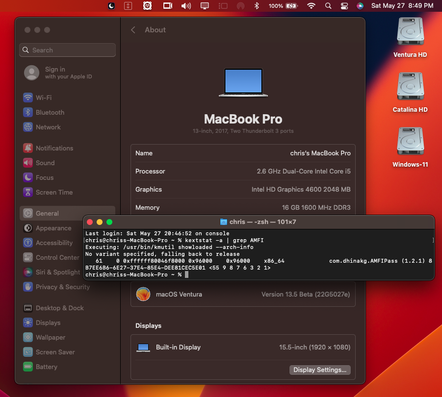

chris1111 Posted May 28, 2023 Share Posted May 28, 2023 AMFIbeta2 work on Hackintosh HP Probook 650 G1 I use the Binary kext AMFIPass.kext with my EFI, no OC install from the patcher, only RootPatch from AMFIbeta2 Good news I will Integrate this Future on HP-Probook-EliteBook-Package-Creator-OC 2 1 Link to comment https://www.insanelymac.com/forum/topic/354499-installing-new-macos-on-unsupported-hardware-oclp-patcher-and-others/page/10/#findComment-2805218 Share on other sites More sharing options...
