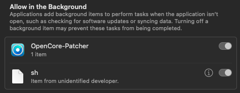

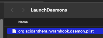

deeveedee Posted January 25, 2023 Share Posted January 25, 2023 (edited) Answered my own question: I was able to click the "I" information icon for the "sh" login item and see that it is for NVRAM hook. Spoiler =============================== After upgrading Ventura to 13.2 and applying post-install patches with OCLP 0.6.1, I have a login item "sh" that I didn't notice before. It may have been there before - I just didn't notice it. Does anyone know anything about the "sh" login item (from unidentified developer) and why it's there? Ventura login items Spoiler Edited January 25, 2023 by deeveedee Link to comment https://www.insanelymac.com/forum/topic/354499-installing-new-macos-on-unsupported-hardware-oclp-patcher-and-others/page/5/#findComment-2800541 Share on other sites More sharing options...

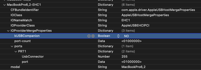

deeveedee Posted January 25, 2023 Share Posted January 25, 2023 I'm reviewing the OCLP-generated EFI to see if I can learn any more about USB patching for my old hack. USB ports are working well on my hack, but I'm always trying to learn. For the MacBookPro6,2, OCLP generates USB-Map.kext with an Info.plist that includes the property kUSBCompanion (boolean: false) as shown below. Does anyone know anything about the kUSBCompanion property? I added this to my USBPorts.kext but am not noticing any difference in behavior. Thank you for any suggestions. USB-Maps.kext Spoiler Link to comment https://www.insanelymac.com/forum/topic/354499-installing-new-macos-on-unsupported-hardware-oclp-patcher-and-others/page/5/#findComment-2800543 Share on other sites More sharing options...

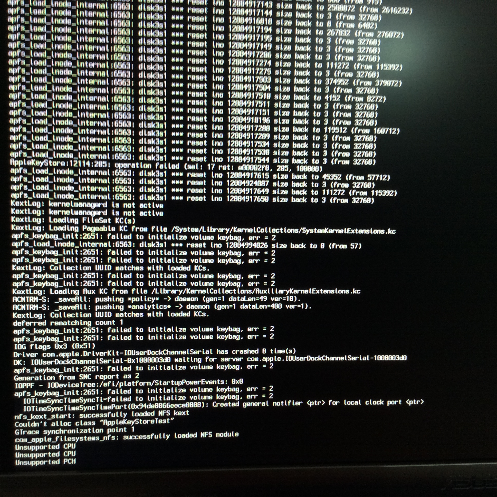

bestal Posted January 27, 2023 Author Share Posted January 27, 2023 hello friends I made a fresh install with 13.2 opencore 0.8.9 from usb. I patched it with oclp 6.1.. i get unsupported cpu error. efi this please help .thanks... EFI.zip Link to comment https://www.insanelymac.com/forum/topic/354499-installing-new-macos-on-unsupported-hardware-oclp-patcher-and-others/page/5/#findComment-2800675 Share on other sites More sharing options...
deeveedee Posted January 27, 2023 Share Posted January 27, 2023 (edited) @ruslan61 I read something from Slice somewhere that indicated that such a verbose output indicated an issue with graphics. Are you sure you have patched graphics correctly? EDIT: Here are a few things I noticed in your config.plist: You have Booter > Patches Reroute HW_BID to OC_BID and Skip Board ID check both enabled. OCLP 0.6.1 uses only Skip Board ID check for my hack (I think OCLP switched to Skip Board ID check and discontinued HW_BID with version 0.5.2, but not certain). Are you sure you should have both patches enabled? You are using AAPL,ig-platform-id which looks to be for Ivy Bridge. Is that correct for your rig? If so, did you read and follow this to be sure you are using the correct AAPL,ig-platform-id? I'm not familiar with some of the kexts you are injecting, so I can't comment. Are they all from the EFI generated by OCLP? You have DeviceProperties > PciRoot(0x0)/Pci(0x1b,0x0) > layout-id = 0x0b (11) and boot-arg alcid=1. I think you only need to define one of them? When you define both with AppleALC, the boot-arg overrides the DeviceProperty. You are using SMBIOS iMac20,2 for your Ivy Bridge system. If your CPU is Ivy Bridge, shouldn't your SMBIOS be iMac13,x? Not sure, but this is something to check. Here's more info. Edited January 27, 2023 by deeveedee Link to comment https://www.insanelymac.com/forum/topic/354499-installing-new-macos-on-unsupported-hardware-oclp-patcher-and-others/page/5/#findComment-2800678 Share on other sites More sharing options...
