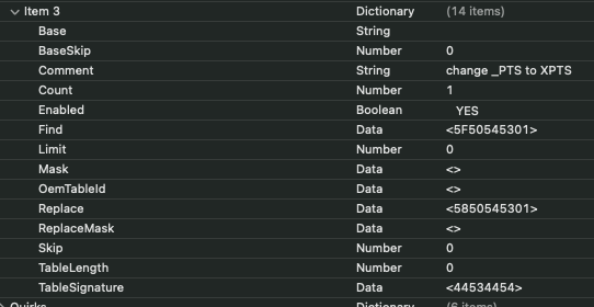

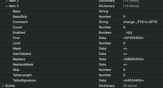

I discovered an interesting ACPI patching case with my hack's DSDT.  I have an ACPI patch in my Open Core config.plist that changes _PTS -> XPTS.  When I created the patch, I inspected my extracted DSDT table with MaciASL and I observed two instances of the string _PTS in the DSDT Table:
the method definition (the instance I wanted to replace with XPTS)
Method (_PTS, 1, NotSerialized)
and a debug statement
ADBG (Concatenate ("_PTS=", ToHexString (Arg0)))
With my ACPI Patch count set to 0 and my Table Signature set to "DSDT" (so that all instances of _PTS in my DSDT were replaced by XPTS), my _PTS -> XPTS patch appeared to work fine (I inspected the patch result by using MaciASL's "File > New from ACPI" utility.  However, when I changed the patch count from 0 to 1 (because I only want to replace the Method _PTS and not the Debug statement), my patch stopped working.  With a patch count of 1, inspection of the DSDT with MaciASL's "File > New from ACPI" showed that Method (_PTS) remained unchanged.
I inspected my DSDT.aml with hexfiend and found an instance of _PTS earlier in the DSDT.  This instance of _PTS does NOT appear when viewed with MaciASL.  Open Core was performing the _PTS -> XPTS replacement on an instance of _PTS that I did not intend to replace (and that I could not inspect with MaciASL).
EDIT: There are a couple of ways that I can think to address this issue.  I chose to add a byte to my ACPI Patch Find/Replace bit sequences for _PTS -> XPTS.  My new ACPI patch for _PTS -> XPTS is as follows:
Spoiler
The additional byte <01> distinguishes the Method (_PTS) from other instances of _PTS in my DSDT.
EDIT2: For anyone who wants to check my work (I'm open to a second opinion and to being corrected), my original, unpatched DSDT.aml is attached.

For anyone who's interested in my previous post, I think I figured out why Open Core finds the _PTS pattern that does not appear in MaciASL.  My hack's DSDT table (see aml attached to previous post) defines
External (_SB_.TPM_.PTS_, MethodObj)
which I did not think should match my defined Find Hex sequence <5F505453> (Ascii _PTS).  However, when inspecting my DSDT.aml with hexfiend, the External declaration appears as Hex <5F53425F 54504D5F 5054535F> (Ascii _SB_TPM_PTS_).  Because the '.' characters are not included in the External declaration in DSDT.aml, this External declaration of _SB_.TPM_.PTS_ appears to Open Core as a pattern match for _PTS.
I'd be interested in observations / opinions from others.
EDIT: If I am correct, I believe that my original _PTS->XPTS ACPI patch (with a 4-byte Find sequence <5F505453>) is incorrectly changing the declaration of
External (_SB_.TPM_.PTS_, MethodObj) to
External (_SB_.TPMX.PTS_, MethodObj).
EDIT2: If I am observing this correctly, I believe that you may have unintended consequences when performing Open Core binary Find/Replace ACPI patches that do not carefully define the Find Hex sequence and that do not restrict one or more of the following in the Open Core ACPI Patch rule:  Base, Count, OemTableId, TableSignature.  When possible, I'd recommend restricting Open Core ACPI Patches by defining Count AND either OemTableId or TableSignature.  Inspect the results of ACPI Patches by using a utility like MaciASL's "File > New from ACPI".
EDIT3: There was no need for me to speculate.  I inspected the patched DSDT with MaciASL's "File > New from ACPI" and with hexfiend and both confirm that my old 4-byte _PTS->XPTS patch was changing the declaration of External (_SB_.TPM_.PTS_, MethodObj).
MaciASL
Spoiler
hexfiend
Spoiler
My old _PTS -> XPTS ACPI Patch (with 4-byte Find/Replace sequence) is wrong (for my hack's ACPI).
Spoiler
Edited by Slice

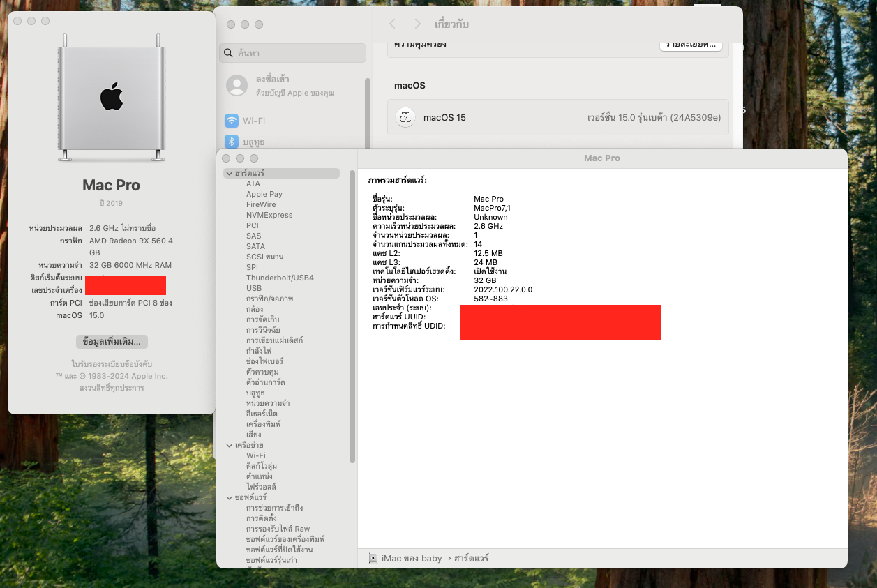

3 hours ago, naiclub said:

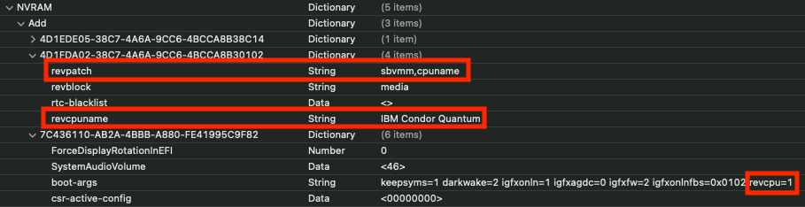

How can I change the correct CPU name?
If other suggestions don't work, try RestrictEvents.kext with revpatch=cpuname / revcpuname=value.
Edited by deeveedee

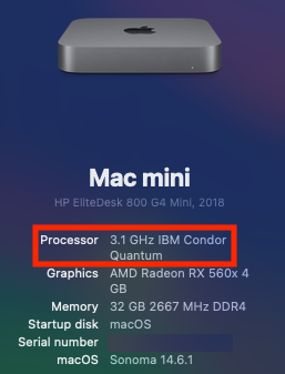

I think I'm the first to run macOS on the new IBM Quantum CPU 🤣
About This Hack
Spoiler
OC config.plist: revcpuname
Spoiler
About This Hack
  Reveal hidden contents
hello grandma I did that and it didn't work. I got this weird image.
  • Sad 1
@naiclub Please post your previous and current config.plist (post both versions).  I suspect that you have incorrectly typed the comma-delimited string for revpatch.
