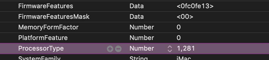

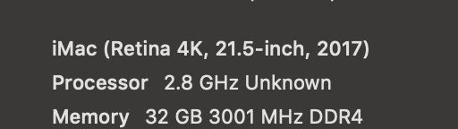

Pavo Posted May 12, 2019 Share Posted May 12, 2019 Anyone know what value needs to go into ProcessorType of the SMBIOS section? My CPUs are 10-Core Xeon E5-2670v2 with a CPU type of 0x0105 in IOREG. Link to comment https://www.insanelymac.com/forum/topic/350754-opencore-general-discussion/page/10/#findComment-2673415 Share on other sites More sharing options...
MacPato Posted May 12, 2019 Share Posted May 12, 2019 Okay how are we fixing this ProcessorType in OC, what should the format be and could someone give examples as to what we need to add to the config to pick this up as nothing seems to work. Link to comment https://www.insanelymac.com/forum/topic/350754-opencore-general-discussion/page/10/#findComment-2673416 Share on other sites More sharing options...
Pavo Posted May 12, 2019 Share Posted May 12, 2019 1 hour ago, Pavo said: Anyone know what value needs to go into ProcessorType of the SMBIOS section? My CPUs are 10-Core Xeon E5-2670v2 with a CPU type of 0x0105 in IOREG. Ok I have found the magic number, but it was a pain in the ass. Had to convert 0x0a0a to decimal which gives me 2750 integer. Now CPU in System Preferences shows Processor: 2 x 2.5 GHz 10-Core Intel Xeon E5. Link to comment https://www.insanelymac.com/forum/topic/350754-opencore-general-discussion/page/10/#findComment-2673418 Share on other sites More sharing options...
