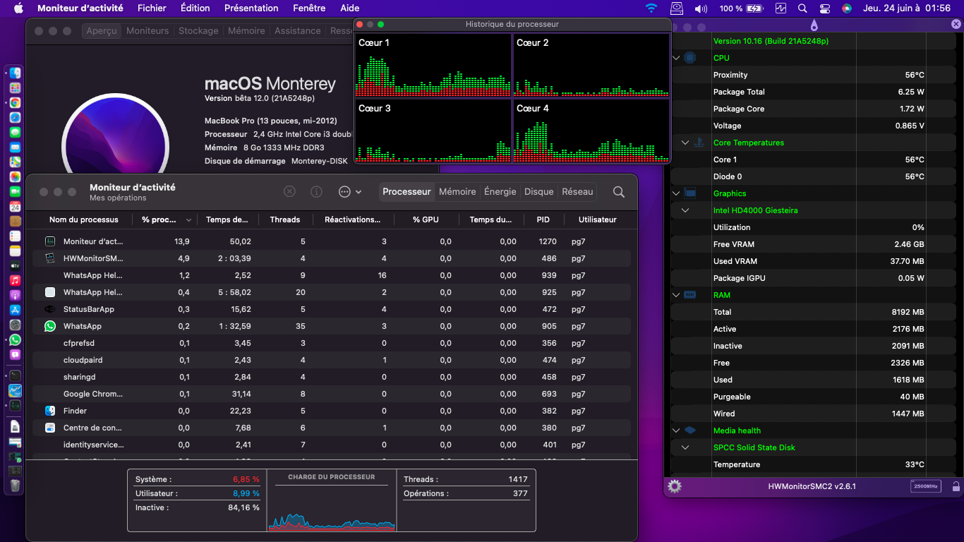

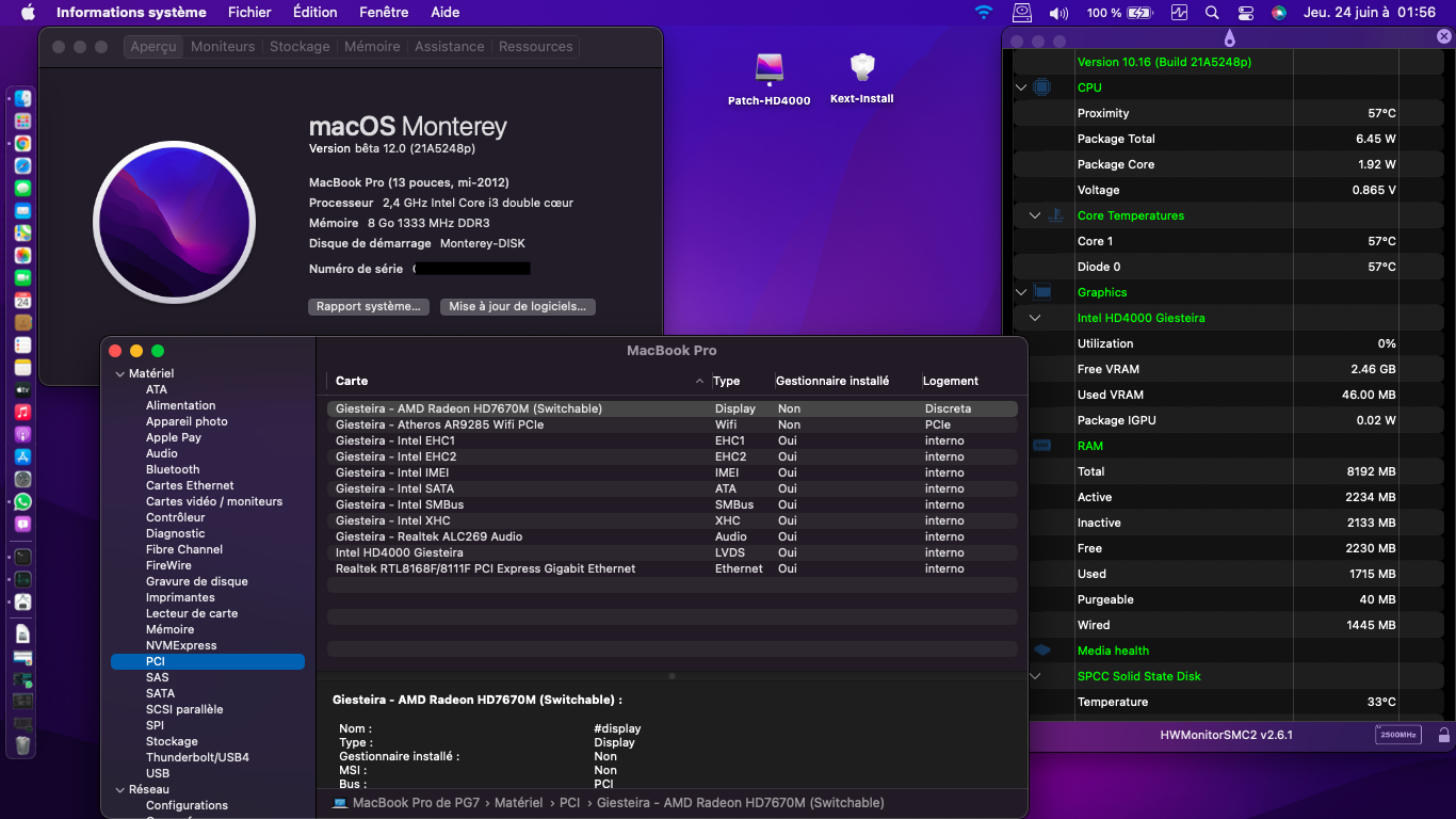

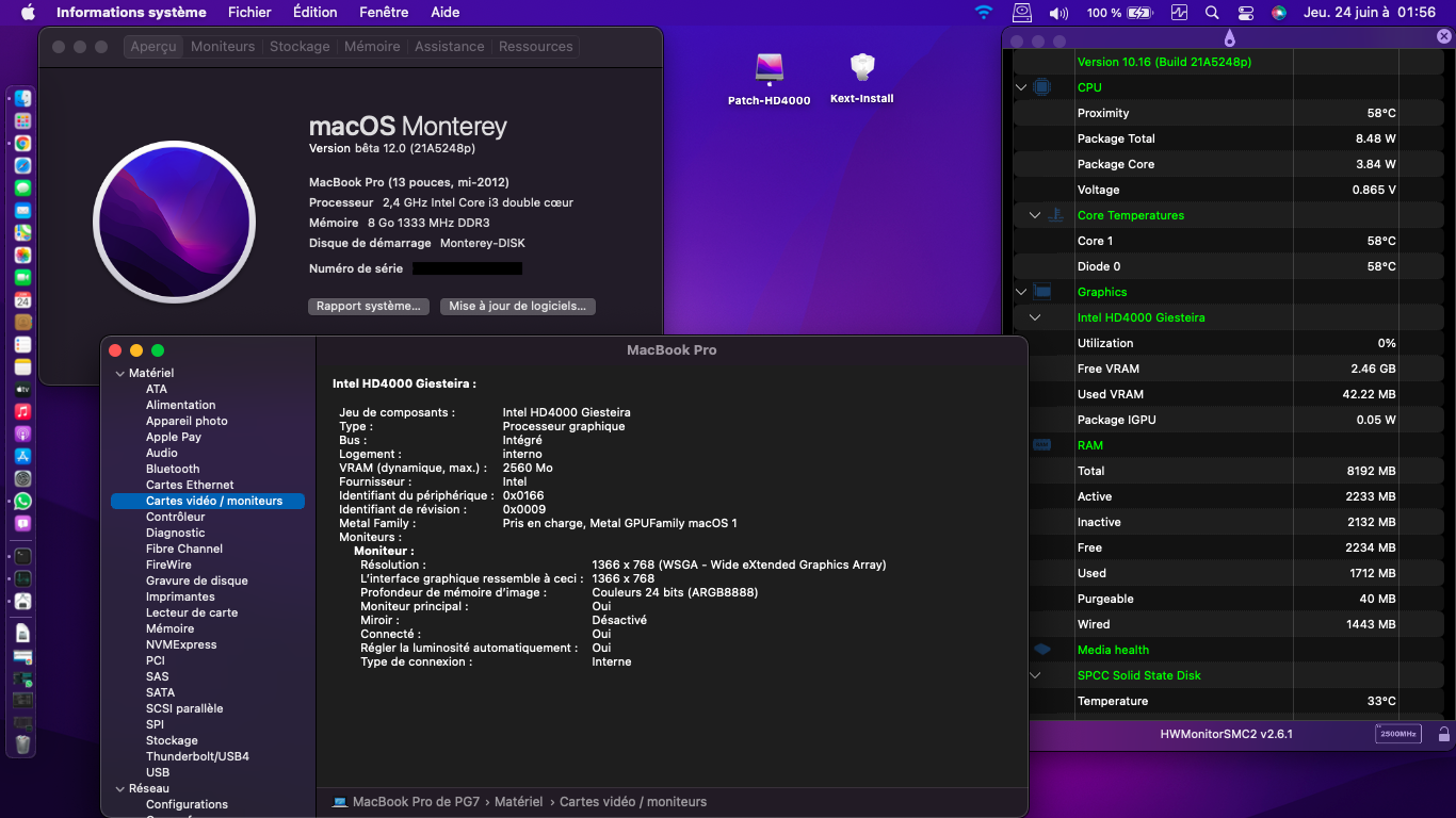

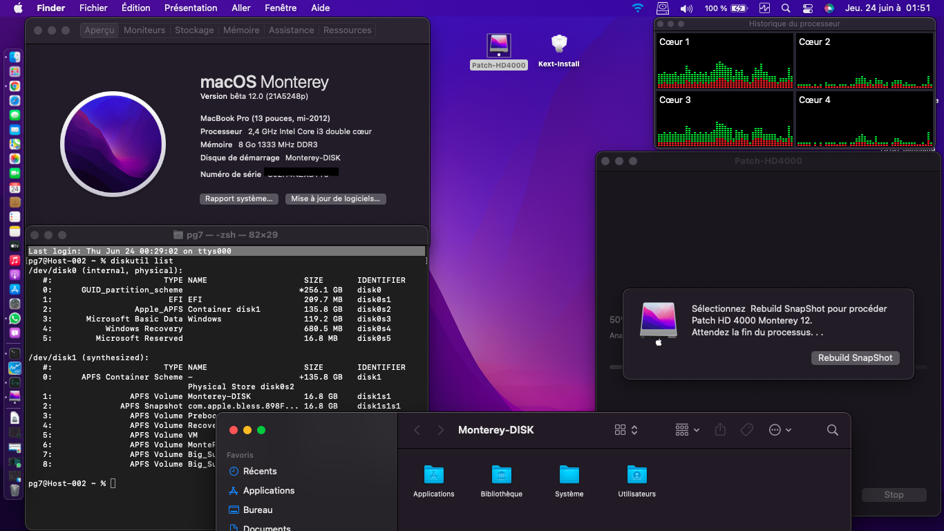

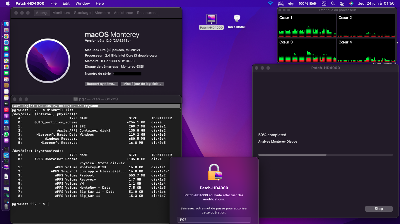

8 hours ago, chris1111 said:
It run smooth here on HP Probook 6570b
Samsung NP350V5C-S06FR
intel i3-3110M
intel HD4000 (Radeon disabled by DSDT)
8 Go Memory
SSD
Clover r5137
Chris1111 Kext Patch
very correct processor management
Thanks Chris1111 and the rest of the team (clover and OCLP)
Spoiler
283259246_Capturedecran2021-06-24a01_51_16.thumb.png.f535ca0ba5c837cc791306d44bd385a4.png1808851520_Capturedecran2021-06-24a01_50_59.thumb.png.8216741ea07dee248183d963c0dfac27.png
Spoiler
1921974062_Capturedecran2021-06-24a01_56_41.thumb.png.d2046b7382e8599ee82998569704773d.png1535566244_Capturedecran2021-06-24a01_56_16.thumb.png.c69be472b2154df36e50d051e9b0314b.png
Spoiler
975967930_Capturedecran2021-06-24a01_56_51.thumb.png.66bef4fd88609c9174f2458dca820590.png
  • Like 3
intel i3-3110M
8 Go Memory
SSD
Clover r5137
  Reveal hidden contents
Great Job :guitar: :thumbsup_anim:Thanks :D
I have commit on Github add all disk Number 10 to 0 on the list
Spoiler
if (tName contains "10:" or tName contains "9:" or tName contains "8:" or tName contains "7:" or tName contains "6:" or tName contains "5:" or tName contains "4:" or tName contains "3:" or tName contains "2:" or tName contains "1:" or tName contains "0:") and tName contains "APFS" and (tName does not contain "VM" and tName does not contain "- D" and tName does not contain "Update" and tName does not contain "Preboot" and tName does not contain "Recovery" and tName does not contain "Container" and tName does not contain "Snapshot") then
Edited by chris1111
  • Thanks 1

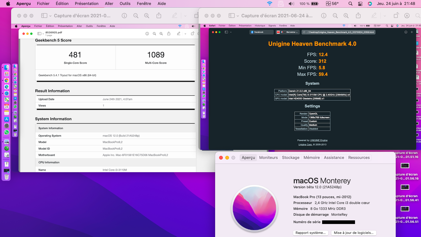

not so bad for an HD4000 on MonteRey !!!
still some little worries:
- Apple TV = crash
- QuickTime Player = Crash
- Photo Booth = Crash
- Safari and Edge = No worries
this with the OCLP v0.1.9
*** cannot install versions v0.2.0 / v0.2.1 / v0.2.2 error!
* with Chris's intel HD4000 patch:
- AppleTV = reading bug
- QuickTime Player = Bug does not record the video!
- Photo Booth = OK
- Safari and Edge = frozen system on Facebook!
(I hope to test OCLP v0.2.2)
Spoiler
1175322235_Capturedecran2021-06-24a21_48_38.thumb.png.eced68439a2cc02fb8b78ba9476b35b6.png
  • Thanks 1

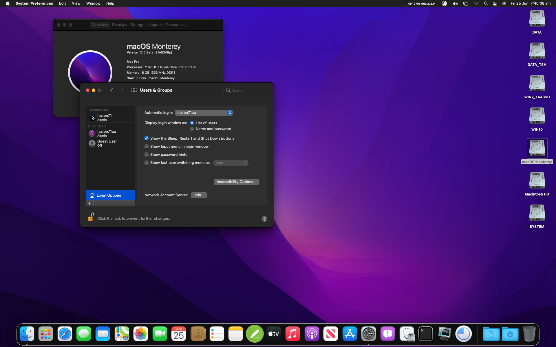

Managed to successfully update from BigSur 11.5beta1 to Monterey 12.0beta1 on my legacy desktop (GA-P55aUD3 with unsupported/non metal ATI HD5770)...
Spoiler
Notes
  • Downloaded Monterey and directly ran full installer app from Apple Developer Software catalog (with @crazybirdy's installScript_110fullapp utility).
  • Changed SMBIOS temporarily from MacPro5,1 to iMac17,1 to allow installer app to proceed with the install (Clover r5137+latest kexts and SIP enabled).  Later switched back to MacPro5,1 SMBIOS with SIP disabled in Clover (CsrActiveConfig=0x0fef) to allow post install system volume patching.
  • Good idea if upgrading from earlier macOS to Monterey with unsupported non Metal graphics card to enable automatic login before the update.  If auto login is not enabled, you will get stuck in a black screen loop (gIOScreenLock error) before the login screen appears on first boot after install is completed.  I actually had to boot to recovery and delete /var/db/.applesetupdone ---> rerun setup of new admin user from scratch ---> enable auto login with the new admin user since I had omitted this step before the update.
  • cc @pico joe: Unfortunately kexts for my Atheros 9287 wireless card (HS80211Family.kext & AirPortAtheros40.kext from High Sierra) were incompatible with Monterey beta1 ---> kernel panics.  My EW-7811UTC USB wireless works OK though.
  • cc @ASentientBot: OCLP 0.1.9+ Terascale2 patching also needs updating for Monterey - patching failed so no openGL graphics acceleration...
 I think the newer versions of OCLP added hardware checks eg in my case, v0.2.2 wouldn't apply the post install graphics patches because an AirPort wireless card was not detected 😡.

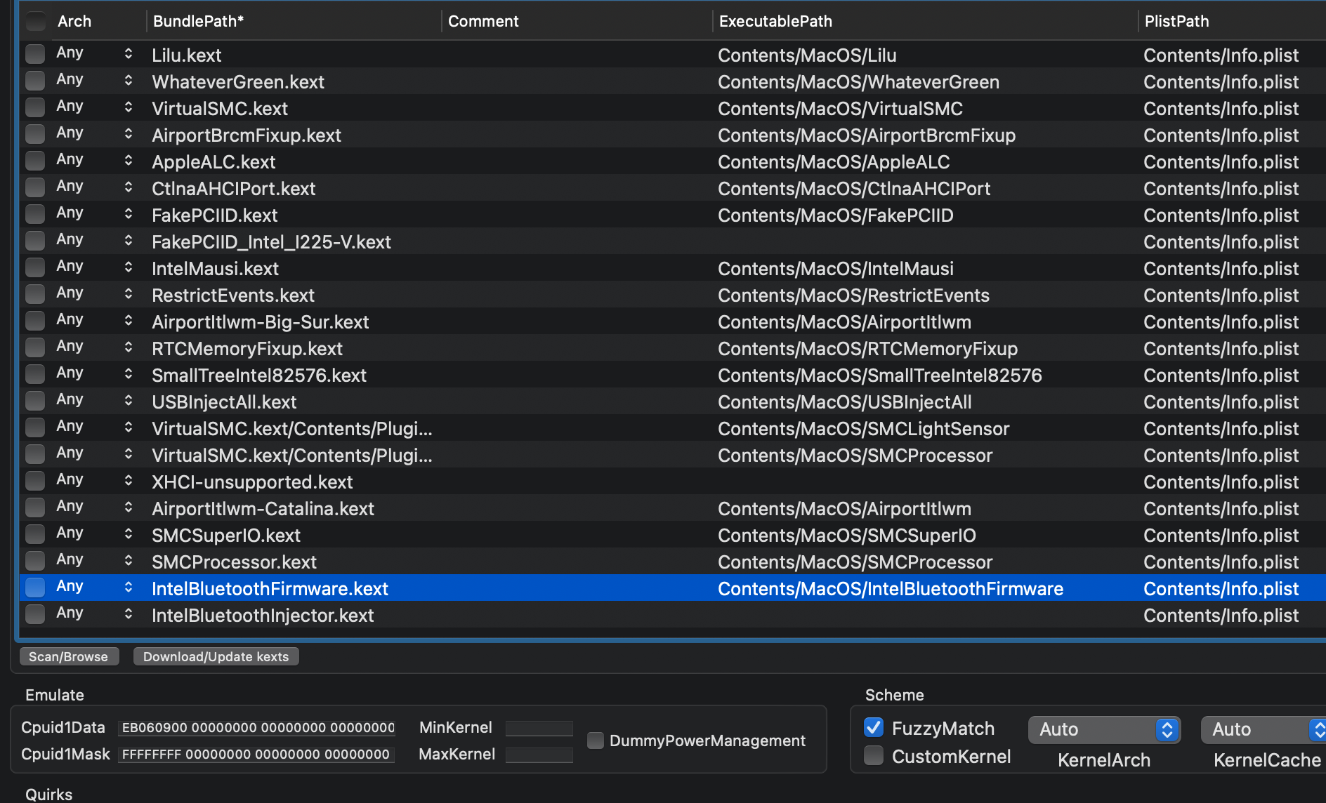

30 minutes ago, Middleman said:
I have. Try to boot with SecureBoot disabled and use -lilubetaall -wegbeta -no_compat_check. Use EC060800 as the CPUID1Data and use USBInjectAll.kext with XHCIPortLimit enabled. Add the SMC plugins for processor and superio. Vit9696’s Intel I-225V kernel patch and also the FakePCIID Intel I225V needs to be disabled also because it is now natively supported. That could be the cause.
Okay so I have made the changes to the config file just that I cannot find this patch any where (Vit9696’s Intel) also do I need to remove Intelbluetoothinjector.kext and Intelbluetoothfirmware.kext? If yes what do I replace with? Any other kexts that you see there that needs removing disabling
Am running Monterey beta 1 on my hardware. When on Big Sur, bluetooth works by using IntelBluetoothFirmware.
However, In Monterey bluetooth is not working. I even used a usb bluetooth dongle but still bluetooth not working. Anyone know what i can do?
