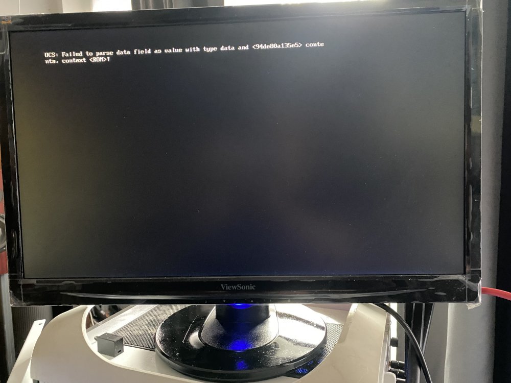

valiant Posted April 7, 2021 Share Posted April 7, 2021 OK, so I navigated the new system, and plugged in all the information to the platforminfo.plist and ran the config script. It seemed to go well, so I Q-Flashed with the new OpenCore ROM, and rebooted. Unfortunately I got the following error: OCS: Failed to parse data field as value with type data and <94de80a135e5> contents, context <ROM>! I went back through the thread and found the part where I should copy the MAC address from the System Report, so I then reinstalled the ROM I had backed up and rebooted back into the Oz version and did that, complete with all the :: symbols, and pasted that into the platforminfo.plist, then went through the whole thing again. What happens is that I get the option to boot from a drive, but when I hit enter it goes black then loops back to the same screen. Selecting either one of the drives does not work. Does anyone have any idea of where I’m going wrong with this? Thanks. Link to comment https://www.insanelymac.com/forum/topic/343145-guide-z77mx-quo-aos-migrating-from-ozmosis-to-opencore/page/7/#findComment-2754951 Share on other sites More sharing options...
IronManJFF Posted April 8, 2021 Author Share Posted April 8, 2021 Make sure ROM is of type Data and 6 bytes long Link to comment https://www.insanelymac.com/forum/topic/343145-guide-z77mx-quo-aos-migrating-from-ozmosis-to-opencore/page/7/#findComment-2755005 Share on other sites More sharing options...
valiant Posted April 8, 2021 Share Posted April 8, 2021 This is what I've got, is that 6 bytes? <key>ROM</key> <data> 94de80a135e5 </data> Nope. I googled and that's 12 bytes. But it's my MAC address, as recommended. What should I be using instead? Thanks. Link to comment https://www.insanelymac.com/forum/topic/343145-guide-z77mx-quo-aos-migrating-from-ozmosis-to-opencore/page/7/#findComment-2755014 Share on other sites More sharing options...
IronManJFF Posted April 8, 2021 Author Share Posted April 8, 2021 6 bytes hexadecimal = 12 characters Link to comment https://www.insanelymac.com/forum/topic/343145-guide-z77mx-quo-aos-migrating-from-ozmosis-to-opencore/page/7/#findComment-2755025 Share on other sites More sharing options...
IronManJFF Posted April 8, 2021 Author Share Posted April 8, 2021 Send me your config.plist Link to comment https://www.insanelymac.com/forum/topic/343145-guide-z77mx-quo-aos-migrating-from-ozmosis-to-opencore/page/7/#findComment-2755027 Share on other sites More sharing options...
