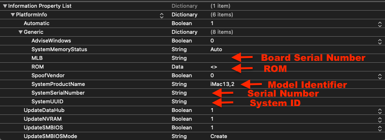

3) Retrieving info, you will need using HackinTool
  • Board Serial Number
  • ROM
  • ModelIdentifier
  • Serial Number
  • System ID
4) Download the MigrationKit from GitHub
5) Now Open this file using XCode or your favorite Plist Editor
6) Fill in the info from Step 3 in the Generic Section (don't touch anything else)
7) Save the file and save it again as MyPlatformInfo.plist somewhere safe outside of the Migration Kit

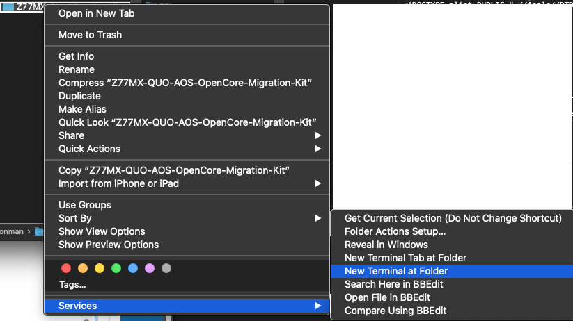

😎 Open a Terminal Window at the Migration Kit location
9) Run the CreateConfig.sh script .. it will merge the config_template.plist with PlatformInfo.plist and create the config.plist file in the OC folder, you run the script by executing this command in the Terminal Window
./CreateConfig.sh

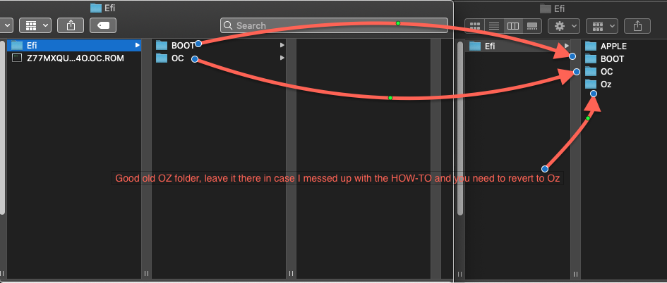

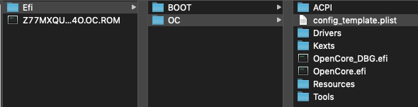

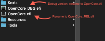

10 ) Open your EFI folder from your boot drive (the one that has the OZ folder), time to copy the stuff over

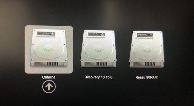

11) Time to flash the OC-friendly firmware, put the firmware on a USB stick and flash it
12) If all goes well when it reboots , you will see the original QUO Boot Logo and then it will greet you with a Bootpicker screen .. kinda like when you hold Option on a real Mac. something like (to see reset NVRAM, Recovery HD and access to UEFI Shell from this screen .. press Spacebar)
13) Choose which OS to Boot and enjoy!

Flashed and then copy the OC folders from migration kit and rename the sample plist file to config.plist to the Efi folder at fs0:, like the instructions but from the boot commands options like when you add the boot entry manually with Osmosis.

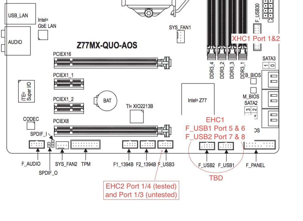

Make sure the USB connector from the PCI-E adapter is connected to F_USB3.
Edited by IronManJFF
  • Thanks 1
Yeap, you're the man! first with High Sierra I was using F_USB2 for the adapter because I have a case fan close to F_USB3 and I was trying to keep this cable away from the fan blades and it was working good, so believe me or not, few minutes ago I tried to swap the adapter cable to F_USB1 but not working again so I gave up, now I tried to move it to F_USB3 like you pointed and is working like a charm! thank you and stay safe and healthy...

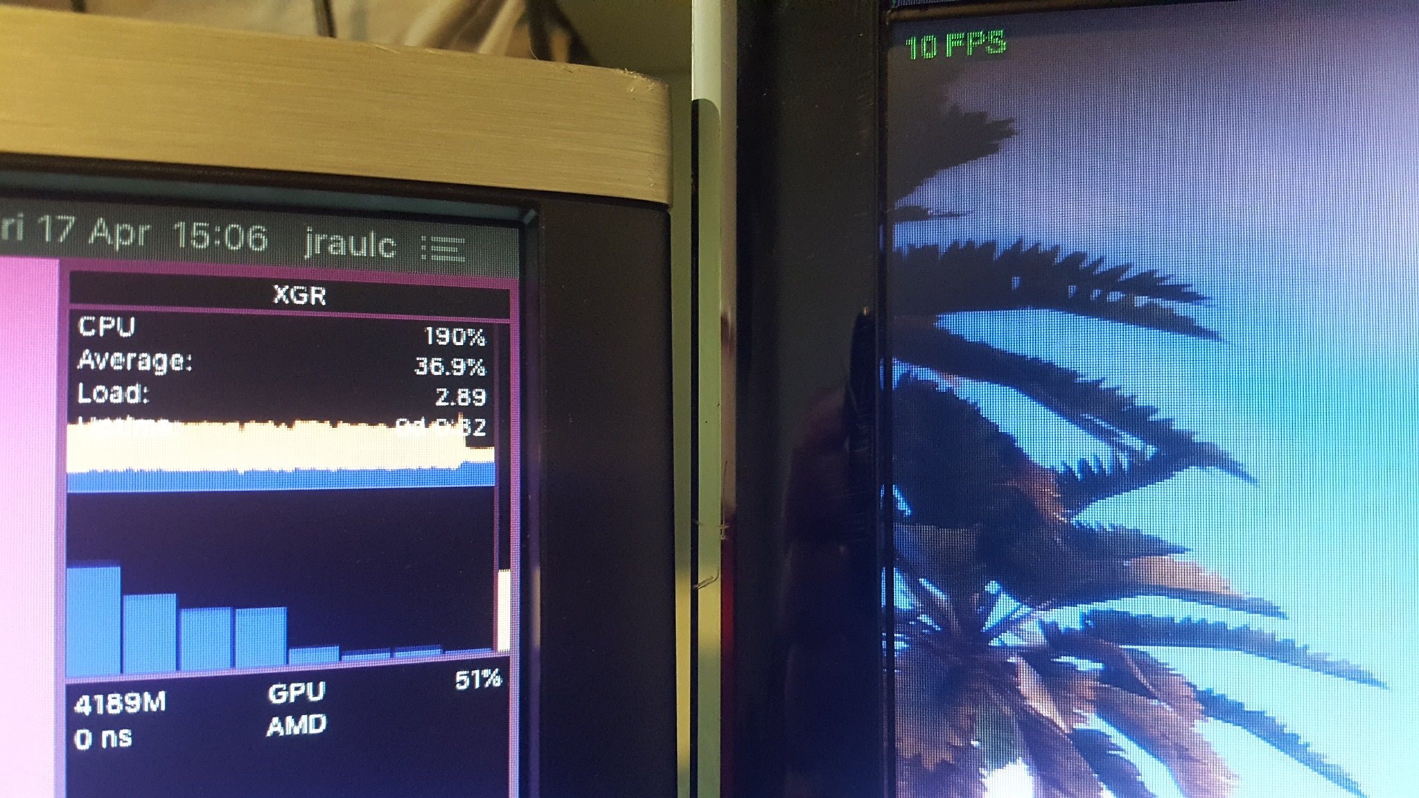

My question, I have being playing some games with mine, 10.14.6, Xeon E3 1230 v2, 32gb 1600mz, 1tb SSD Samung Evo and AMD Radeon RX 590 8g, is more than enough for all the games I play, even with the settings to the highest graphics quality, but the thing is I'm having an issue playing RUST, no matter what I do or change settings I try, (at the game or BIOS) lowest graphics quality it only reduce the GPU stress and high quality the GPU stress goes to 50-60%/4.15 Ram but is always the same issue, everything is going smooth 50-60 FPS (full quality @ 1080p) until around each 15-16 minutes the processor stress go low (checked with XRG, without any other process using the resources, I already disabled the spotlight indexing, after boots open Steam only and then the game RUST) and then the FPS at the game drops too, it drops from 50-60 FPS to 1 FPS, is only during a few seconds and then gradually go back to smooth, 1 FPS, 3 FPS, 5 FPS, 10 FPS, 15 FPS, 20 FPS, 25 FPS (not those numbers exactly but that is the idea) and so on until reach the pick of 50-60 again, is not a CPU temperature issue because I have enough case fans and a nice heatsing, I keep the case front open and close to the AC flow so when it goes hot is around 60º C at the system sensors but from outside is pretty colder than that, the graphic card still cold most the times, without gaming the fans remains off, it only start to spin when I play any game, and last, is not a MB temperature issue because I checked everything with a laser thermometer, the chip-set, north-bridge, capacitors, everything, is not a network lag issue because I'm playing at my own LAN game server and my ping to the LAN game server is ave. 4.5 ms, actually I installed this LAN game server because before I thought it could be a network lag problem when I was playing at online servers, but is not, it not the server side performance because I monitor the game server performance and never reach the 10%-15% of the processor capacity or the ram, at the server side everything is smooth, kindly attach some pictures, the lowest CPU temperature when is not gaming, the screen with the low FPS and graphic from XGR showing the CPU and GPU stress during the issue, and last one is the CPU temperature when gaming...
Any idea what it could be the issue or which one is the best CPU for gaming with this MB, I'm wondering if is better to get another CPU in my case? any suggestion from any one who wants to share own experience is welcome, thank you.

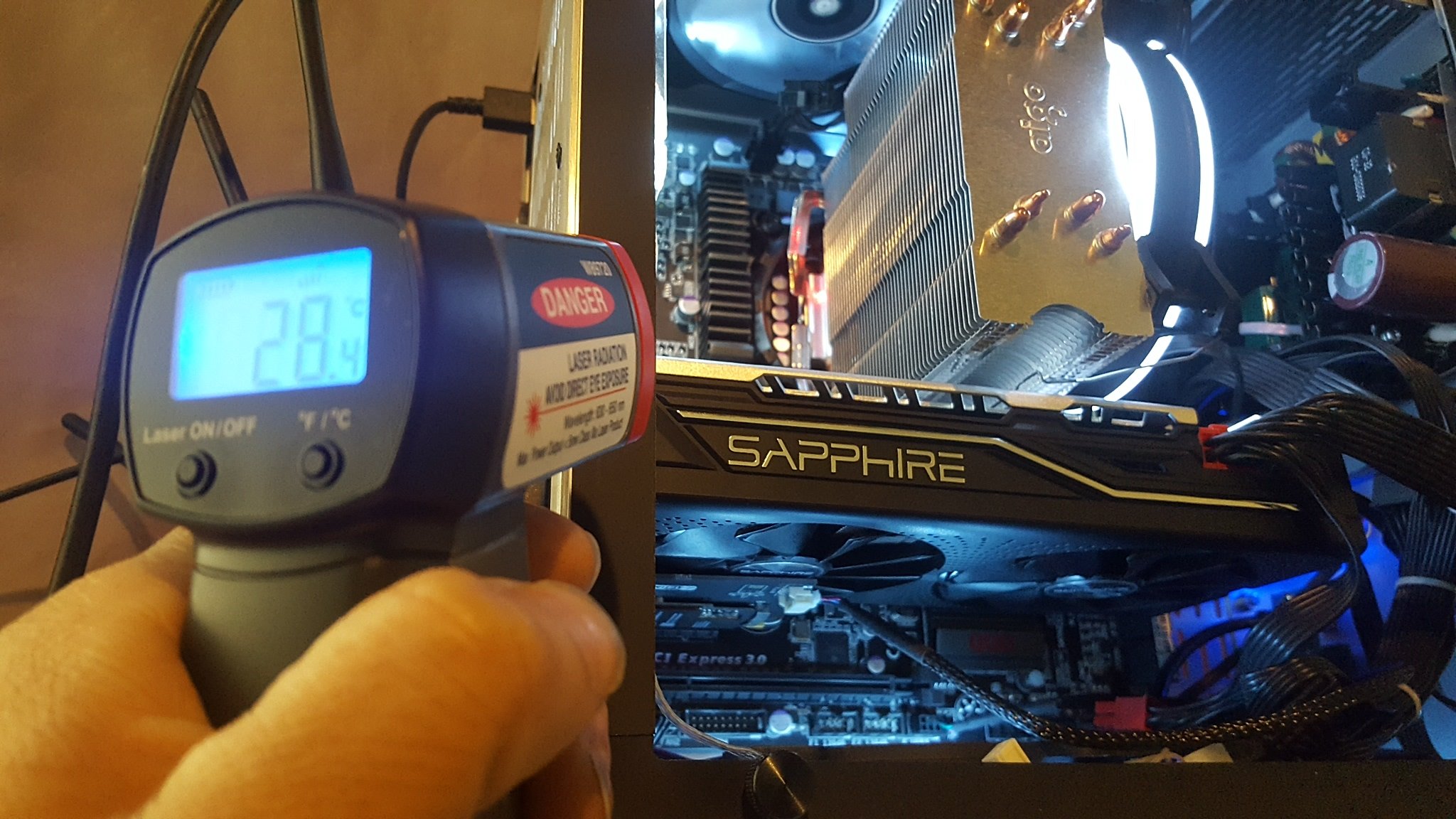

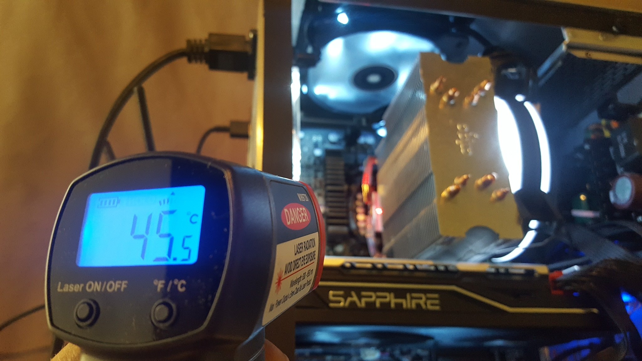

you could use hwmonitor to get internal temps from the cpu and maybe the gpu as well. I moved from an overclocked i5-3570k to the Xeon 1230 v4 and noticed a big improvement in some places. The upgrade to the i7-3770k was where it all went wrong. A piece of fluff must have fallen onto the cpu as I put the water block on and that was enough to bend some pins.
I've always had water cooling for the cpu, and it works great. I don't game so the graphics card rarely gets exercised.
Hope someone can shed some light for you.

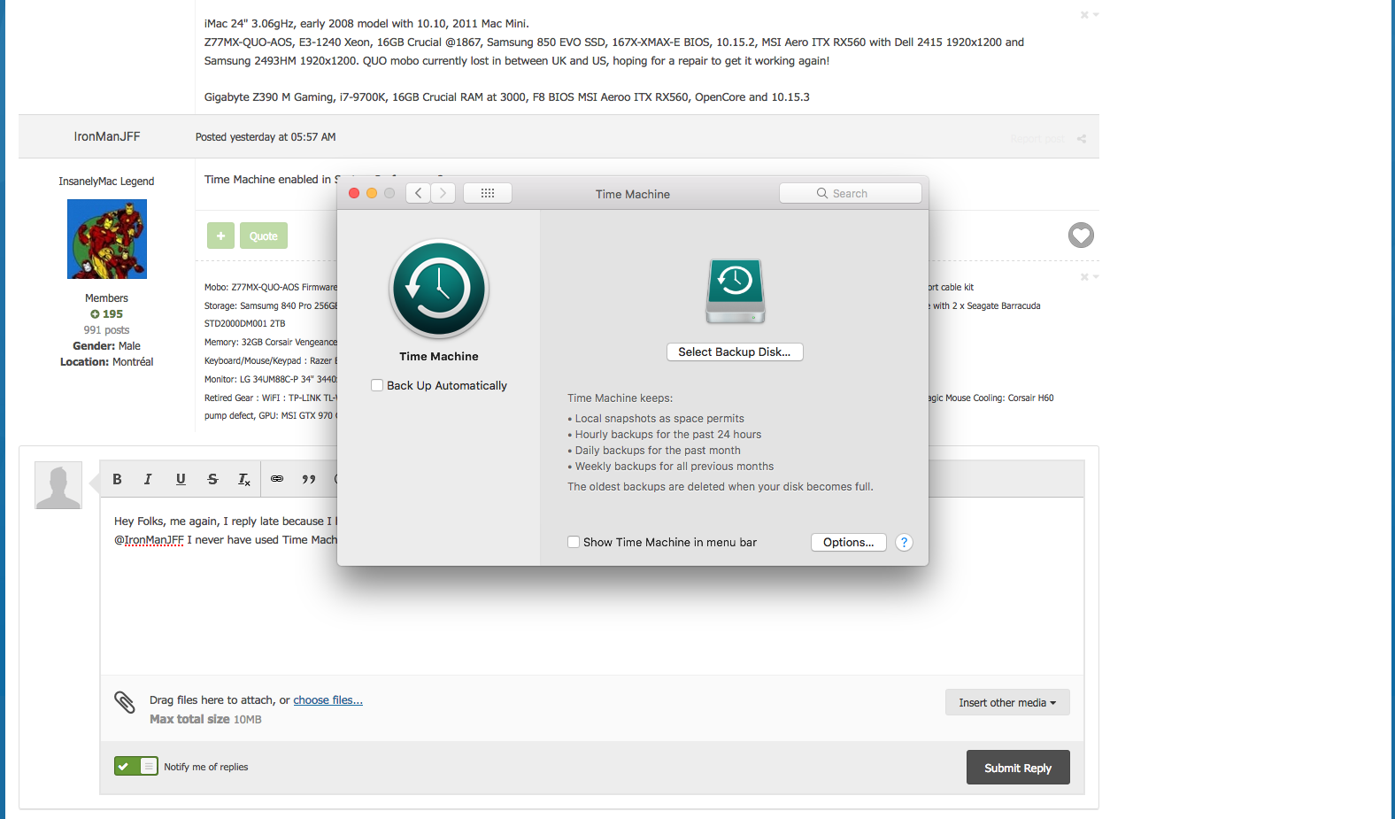

@IronManJFF I never have used Time Machine for my use, at the settings are like the attached picture shows, I hope that means "Disabled"... 184297476_ScreenShot2020-04-19at9_35_55AM.thumb.png.df5b05067d1bb98f57f31175eb5c6177.png

So this is what I found, the issue I mentioned before it only happens playing Rust no matter the graphics quality I pick, is always the same result, all the rest the games goes smooth all the time, CSGO up to 80 FPS, HurtWorld up to 40 FPS (Funny because it suppose to be for those who don't have enough requirements to play Rust so it should be the highest FPS), Stranded Deep up to 56 FPS, so I guess is kind of bug with the game Rust in self, the best result I could get it is tweaking the BIOS settings at Advanced/Frequency Settings/CPU-PCI Base Clock:104.90Mhz, CPU Clock Ratio:35 this makes Memory Frequency:1678MHz (if I try more than that still can boot and runs Rust but it freezes after few minutes) with this settings I can boot and play Rust and reduce the FPS drops to 8 instead of 1 or 2, but still happening every 15-16 minutes, is a little bit better but not the enough yet.
Right now I have 32gb(4x8) Crucial DDR3-1600Mhz 240-pin PC3-12800 and I was expecting to be able to tweak a little bit higher with the frequencies but I couldn't, I don't know if the limitation is at the MB, the CPU or Ram Memory, any experience or guide related to that.?
Should I report this issue like a possible bug to the game company, I mean since I'm not running an official mac hardware...?

You did apply the thermal paste underneath that cooler ?
No matter what you do the system will throttle down if temperature reaches 65,8 C at the CPU integrated heat spreaders

Yes, I used a decent thermal compound, not the best quality but decent, after read your post I checked the CPU temperature just before the issue and some times it was showing 61º up to 65º but during the issue it was going down to 59º again, so I moved the case exactly at front the A/C flow and tried again, the same result with the temperature and issue, then I recall I have another heat-sink, bigger and better, titan fenrir evo, I removed the previous one, clean the CPU, applied a new and better thermal compound, tried again, the same results with temperature and lags, then I was trying different heat-sink position/air flow, left to righ, right to left, bottom to up, and the one that gave me better temperature results it was with the heat sink facing the case top and the heat-sink fan on top of it blowing to up, with this I could get very good temperatures around 55º during the game but still the same result, lags every 15-16 minutes, so after that I decided to try with windows, so I started to move my old virtualbox windows 7 setup to the macOS desktop ruining at this one at quos to create the windows installer, then resize the macos partition and create free space for the windows install, and so on, the final conclusion, is a problem with the Rust game at macOS (Unity Player Version: 2019.3.5f1(d691e07d38ef)) and nothing else, I get event lower temperatures and highest FPS playing on windows with the same configuration, so I reported it like a bug, hopefully they will fix it eventually.
The thing a this point I make the decision to stop playing Rust or those games that require entire days of preparation, since I have a full macOS system running smooth (I was missing the mbp trackpad gestures so I bought a magic trackpad 2 and it works like a charm) I want to use it for something productive, trying to make the case quiet as possible I'm getting a lower specs GPU (Radeon RX 550 4gb) to gain another slot and reduce the heat to be able to use a smaller CPU heat-sink, even I'm planing to buy a Gigabyte Alpine Ridge Thunderbolt 3 PCIe Card to have full access to thunderbolt devices, so here come my next two questions, first, why the integrated thunderbolt is not detected, and second, the Gigabyte Alpine Ridge Thunderbolt it will work fine with the Quo right..?

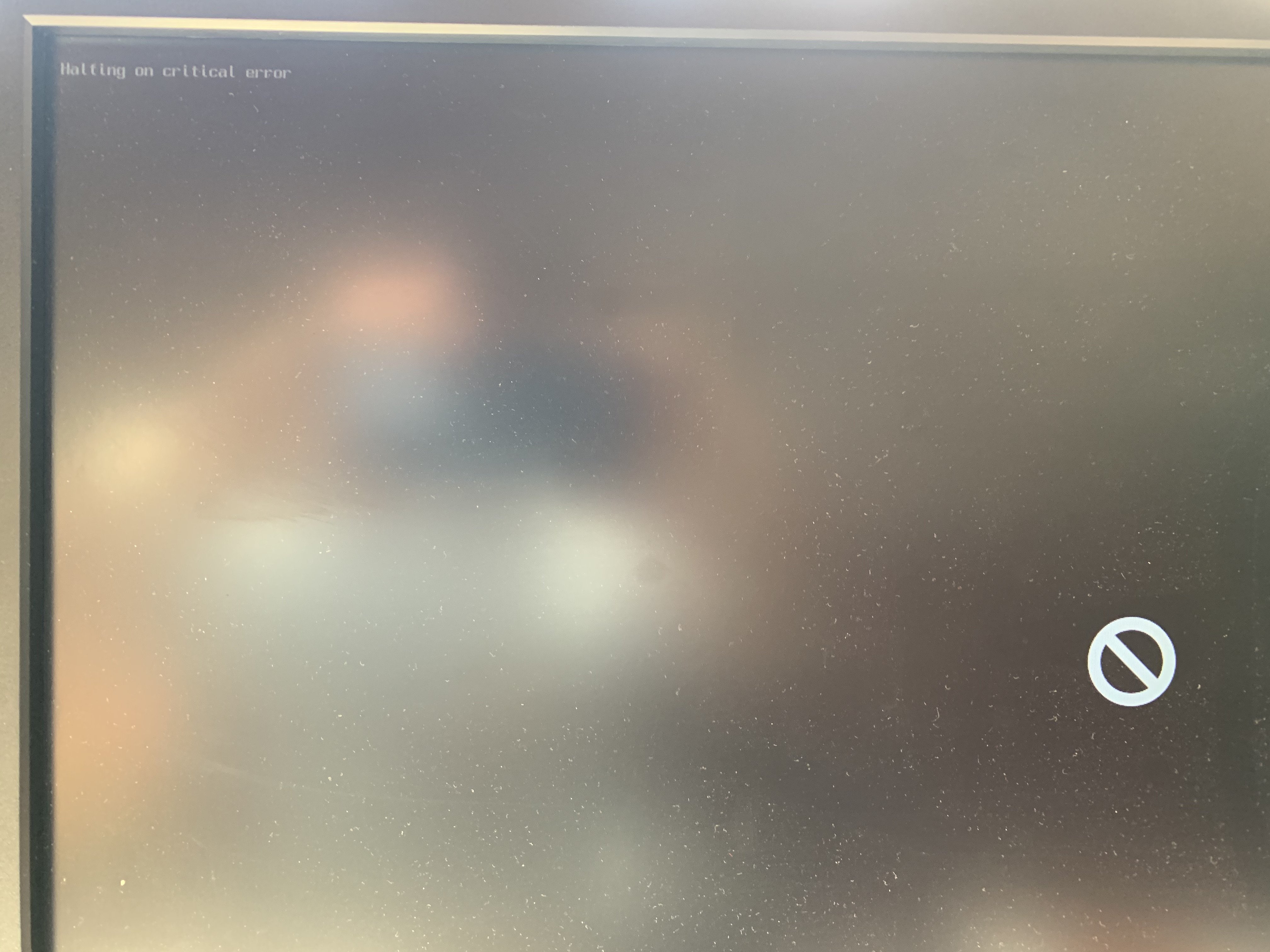

Hi,
thank you very much for this guide.
Unfortunately, I did not have any running macOS (disk with it died) so I installed the latest macOS to an external drive using my MacBook Pro. Then I used Clover Configurator to generate needed information and created config.plist from the template (you can find it attached here) and uploaded it to EFI partition.
Unfortunately, I was not able to boot it. I was able to select the disk from the correct Bootpicker screen and got an error (see attached image).
Could someone please help me?
Is there anything I can do to provide more information?
Thank you.
config.plist
Edited by CiTroNaK
MLB should be equal to SystemSerialNumber+5 digits
Only Platforminfo needs to be edited, everything else should remain as it is in the template
No Graphics card, you might wanna try MacMini6,2 SMBIOS
