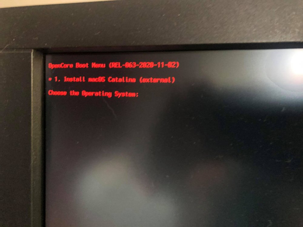

IronManJFF Posted September 26, 2020 Author Share Posted September 26, 2020 3 hours ago, Casm101 said: Wasn't able to boot the installer, I instantly got a kernel panic, and then my system reboots, I can still boot into Catalina thought. Any advice? You could try with Display Options set to "Auto" in firmware ... Dortania's Guide suggest iMac15,1 instead of iMac14,4 for replacement of iMac13,2 .. I haven't tried it. Link to comment https://www.insanelymac.com/forum/topic/343145-guide-z77mx-quo-aos-migrating-from-ozmosis-to-opencore/page/6/#findComment-2738474 Share on other sites More sharing options...
CiTroNaK Posted September 26, 2020 Share Posted September 26, 2020 Yes, I have it with iMac15,1 and I only needed to update kexts (and new SN and so for "new" iMac). Kexts.zip 1 Link to comment https://www.insanelymac.com/forum/topic/343145-guide-z77mx-quo-aos-migrating-from-ozmosis-to-opencore/page/6/#findComment-2738501 Share on other sites More sharing options...
Casm101 Posted September 27, 2020 Share Posted September 27, 2020 12 hours ago, IronManJFF said: Dortania's Guide suggest iMac15,1 instead of iMac14,4 for replacement of iMac13,2 .. I haven't tried it. 8 hours ago, CiTroNaK said: Yes, I have it with iMac15,1 and I only needed to update kexts (and new SN and so for "new" iMac). Kexts.zip I changed my system values to iMac15,1 as well as updated to the kexts given by @CiTroNaK and updated with no problems! Link to comment https://www.insanelymac.com/forum/topic/343145-guide-z77mx-quo-aos-migrating-from-ozmosis-to-opencore/page/6/#findComment-2738525 Share on other sites More sharing options...

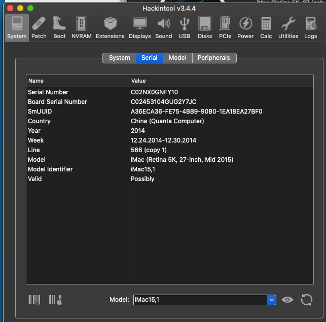

CiTroNaK Posted September 29, 2020 Share Posted September 29, 2020 Please, I have two questions: 1) How can I do the NVRAM reset on 0.6.0+? 2) What is the best way how to generate these? Board Serial Number ROM Serial Number System ID Thank you very much. Link to comment https://www.insanelymac.com/forum/topic/343145-guide-z77mx-quo-aos-migrating-from-ozmosis-to-opencore/page/6/#findComment-2738760 Share on other sites More sharing options...
IronManJFF Posted September 29, 2020 Author Share Posted September 29, 2020 1) Press Command-Option-P-R when Boot Picker is displayed (you can hold Option to force the boot picker to show if it does not by default) 2) Hackintool 1 Link to comment https://www.insanelymac.com/forum/topic/343145-guide-z77mx-quo-aos-migrating-from-ozmosis-to-opencore/page/6/#findComment-2738786 Share on other sites More sharing options...
IronManJFF Posted September 29, 2020 Author Share Posted September 29, 2020 Tried to migrate to iMac15,1.. iMessage is not working. Access to keychain lost ... total disaster... reverting Link to comment https://www.insanelymac.com/forum/topic/343145-guide-z77mx-quo-aos-migrating-from-ozmosis-to-opencore/page/6/#findComment-2738810 Share on other sites More sharing options...
CiTroNaK Posted September 30, 2020 Share Posted September 30, 2020 9 hours ago, IronManJFF said: 2) Hackintool Thank you. Please, how should I proceed with ROM? I did not find it there. Link to comment https://www.insanelymac.com/forum/topic/343145-guide-z77mx-quo-aos-migrating-from-ozmosis-to-opencore/page/6/#findComment-2738823 Share on other sites More sharing options...
IronManJFF Posted September 30, 2020 Author Share Posted September 30, 2020 Unclear .. was told should be your MAC address ..so it would not change or to generate one that would correspond to SMBIOS but I haven't found how to do that. Link to comment https://www.insanelymac.com/forum/topic/343145-guide-z77mx-quo-aos-migrating-from-ozmosis-to-opencore/page/6/#findComment-2738940 Share on other sites More sharing options...

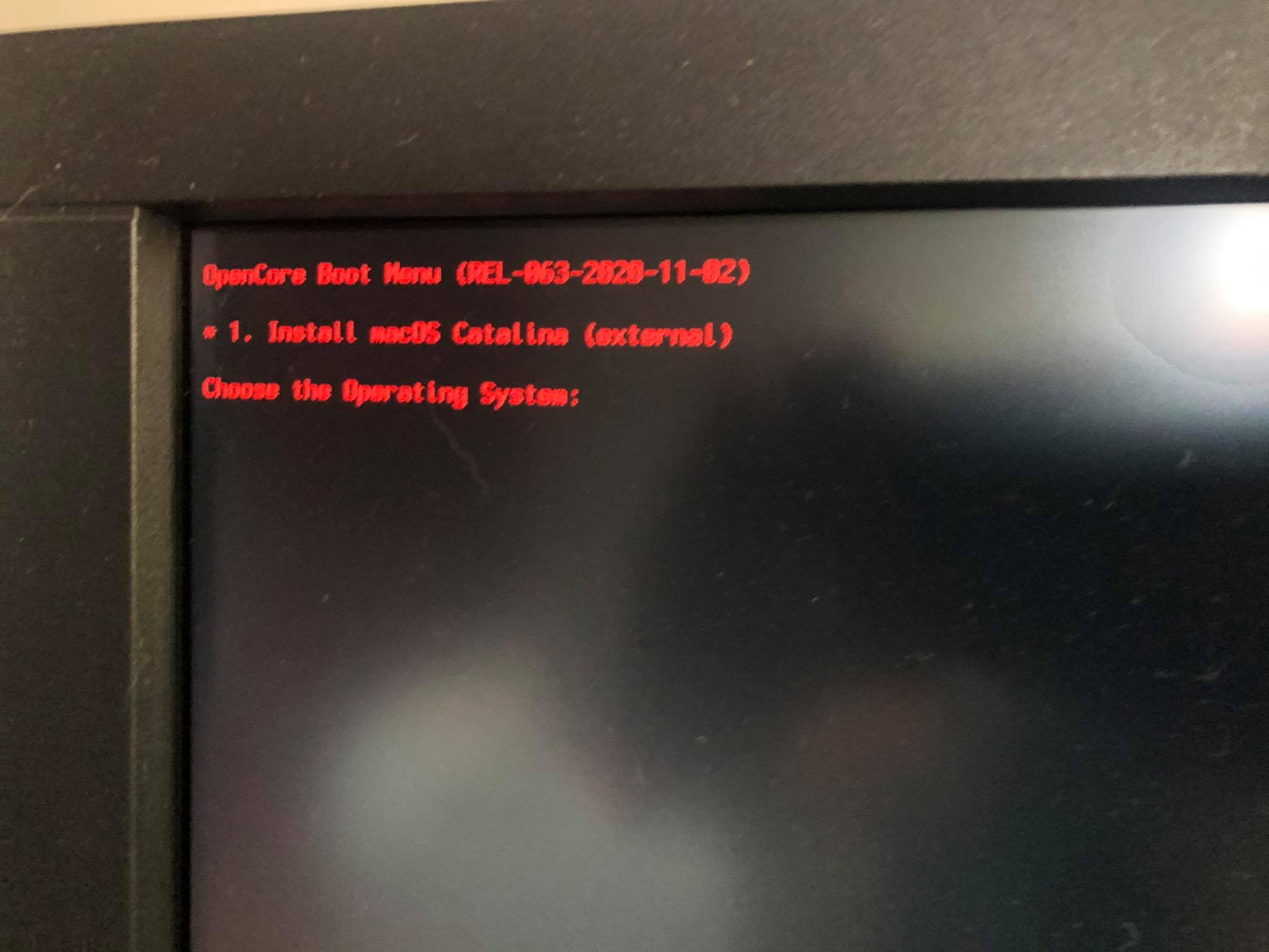

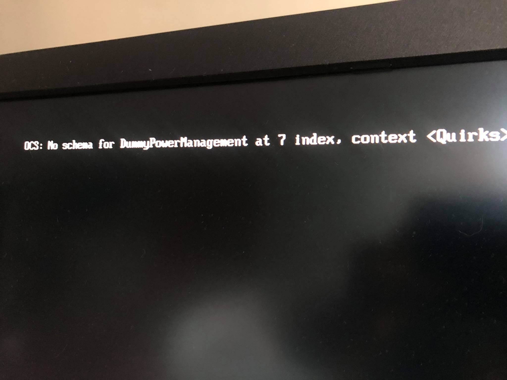

bezna Posted November 24, 2020 Share Posted November 24, 2020 @IronManJFF Dear IronMan thanks for all the help u gave me few years back when i had problem with my Quo. Time has come and i try to update my system to Catalina,,, and how wrong i was to even try. Now my system is totally destroyed. i have follow dortania.github.io opencore instalation guide then i switch files to IronMan EFI i double copy config.plist and other files in EFI folder on my SSD osx I have edited only PlatformInfo.plist with my old i think rom and serials ect. currently im connecting ssd meanted for osx to macbook so i can do changes. please help me boss Link to comment https://www.insanelymac.com/forum/topic/343145-guide-z77mx-quo-aos-migrating-from-ozmosis-to-opencore/page/6/#findComment-2745272 Share on other sites More sharing options...
IronManJFF Posted November 24, 2020 Author Share Posted November 24, 2020 Dn not follow Dortania's Guide ... il will not work. Link to comment https://www.insanelymac.com/forum/topic/343145-guide-z77mx-quo-aos-migrating-from-ozmosis-to-opencore/page/6/#findComment-2745311 Share on other sites More sharing options...
bezna Posted November 24, 2020 Share Posted November 24, 2020 44 minutes ago, IronManJFF said: Dn not follow Dortania's Guide ... il will not work. ok but i have wiped sdd now what should i start with? should i follow ur steps from this guide? "3) Retrieving info, you will need using HackinTool " -I got that information from my mac before it crashed forever but there is possibility i f# something. 4) Download "OC to OC Migration.zip" (to come) and extract it U mean https://github.com/Kazbah/Z77MX-QUO-AOS-OpenCore-Migration-Kit 5) Now Open this file using XCode or your favorite Plist Editor 6) Fill in the info from Step 3 in the Generic Section (don't touch anything else 7) Save as config.plist Done i think 8a) Mounting EFI folder with script 8) Open your EFI folder from your boot drive (the one that has the OZ folder), time to copy the stuff over a)config_template.plist renamed to config.plist 8A) Run CreateConfig.sh (this will merge the config_template.plist with the Platform Info) to create the config.plist in the EFI folder ERROR dosent wana merge. 9) Bios Flash Z77MXQUOAOS.H4O.OC.ROM 10) ssd put back to hackintosh from external enclosure, Testing and .... Link to comment https://www.insanelymac.com/forum/topic/343145-guide-z77mx-quo-aos-migrating-from-ozmosis-to-opencore/page/6/#findComment-2745315 Share on other sites More sharing options...

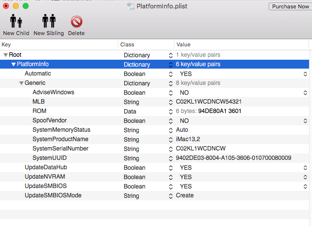

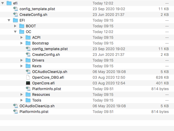

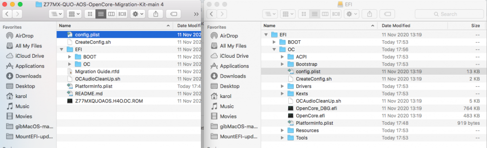

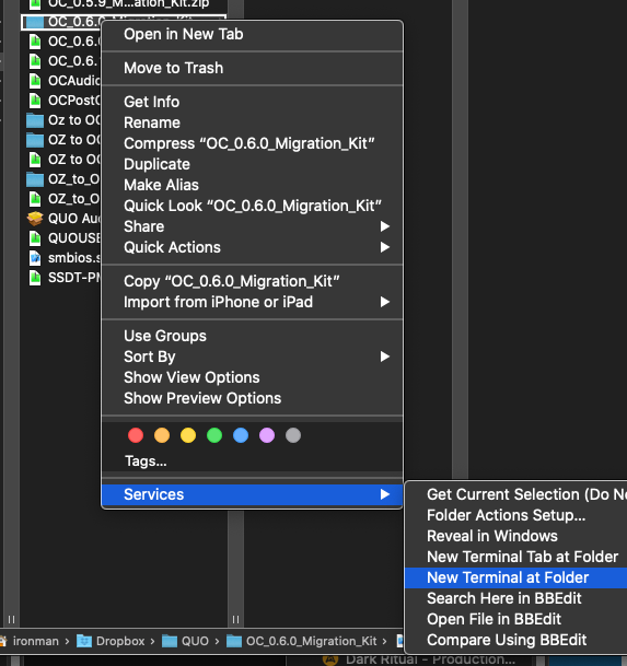

IronManJFF Posted November 24, 2020 Author Share Posted November 24, 2020 (edited) There is no renaming of any files (I changed that to simplify process) PlatformInfo.plist and config_template.plist should not be renamed. config_template.plist should not be edited at all. Step 5) Open PlatformInfo.plist Step 6 ) Unchanged Step 7) Should now read as Run CreateConfig.sh I notice that you copied the Migration Kit to EFI ..that is wrong ... You should copy stuff to EFI only at Step 8 Edited November 24, 2020 by IronManJFF Link to comment https://www.insanelymac.com/forum/topic/343145-guide-z77mx-quo-aos-migrating-from-ozmosis-to-opencore/page/6/#findComment-2745321 Share on other sites More sharing options...

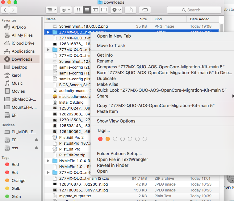

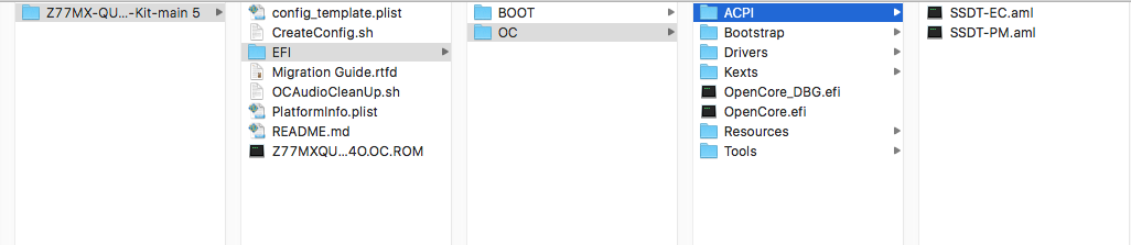

bezna Posted November 24, 2020 Share Posted November 24, 2020 There is no renaming of any files (I changed that to simplify process) PlatformInfo.plist and config_template.plist should not be renamed. config_template.plist should not be edited at all. ok downloaded fresh KIT, - not touching anything Step 5) Open PlatformInfo.plist Done 6) Fill in the info from Step 3 in the Generic Section (don't touch anything else Done Step 7) Should now read as Run CreateConfig.sh Not done. #!/bin/bash echo "==============================================" echo "=== ===" echo "=== Welcome to OC Migration Config Utility ===" echo "=== ===" echo "==============================================" echo "" echo "" DIR="$( cd "$( dirname "${BASH_SOURCE[0]}" )" >/dev/null 2>&1 && pwd )" echo "Running script from $DIR" path_to_EFI="${DIR}/EFI" echo "Path to EFI= " $path_to_EFI path_to_OC="${path_to_EFI}/OC" path_to_BOOT="${path_to_EFI}/BOOT" echo "Checking if it makes senses ..." FILE=$path_to_BOOT if [ -d "$FILE" ]; then echo "$FILE exist" else echo "Could not find BOOT Folder" exit 1 fi FILE=$path_to_OC if [ -d "$FILE" ]; then echo "$FILE exist" else echo "Could not find OC Folder" exit 1 fi echo "==============================================" echo "=== Looks good , lets proceed ===" echo "==============================================" Config="${path_to_OC}/config.plist" FILE=$Config if [ -f "$FILE" ]; then echo "$FILE exist, removing" rm "$FILE" fi echo "Merging Template with your personnal PlatformInfo" /usr/libexec/PlistBuddy -c "Merge ${DIR}/config_template.plist " "$Config" FILE="${DIR}/MyPlatformInfo.plist" if [ -f "$FILE" ]; then echo "$FILE exist" PlatformInfo="$FILE" else echo "Could not find Personnalized Platform Info, using PlatformInfo.plist" PlatformInfo="${DIR}/PlatformInfo.plist" fi /usr/libexec/PlistBuddy -c "Merge ${PlatformInfo} " "$Config" #/usr/libexec/PlistBuddy -c "Print " "$Config" echo "Done" Link to comment https://www.insanelymac.com/forum/topic/343145-guide-z77mx-quo-aos-migrating-from-ozmosis-to-opencore/page/6/#findComment-2745322 Share on other sites More sharing options...
IronManJFF Posted November 24, 2020 Author Share Posted November 24, 2020 (edited) Not done or not working for you ? Edited November 24, 2020 by IronManJFF Link to comment https://www.insanelymac.com/forum/topic/343145-guide-z77mx-quo-aos-migrating-from-ozmosis-to-opencore/page/6/#findComment-2745353 Share on other sites More sharing options...

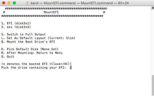

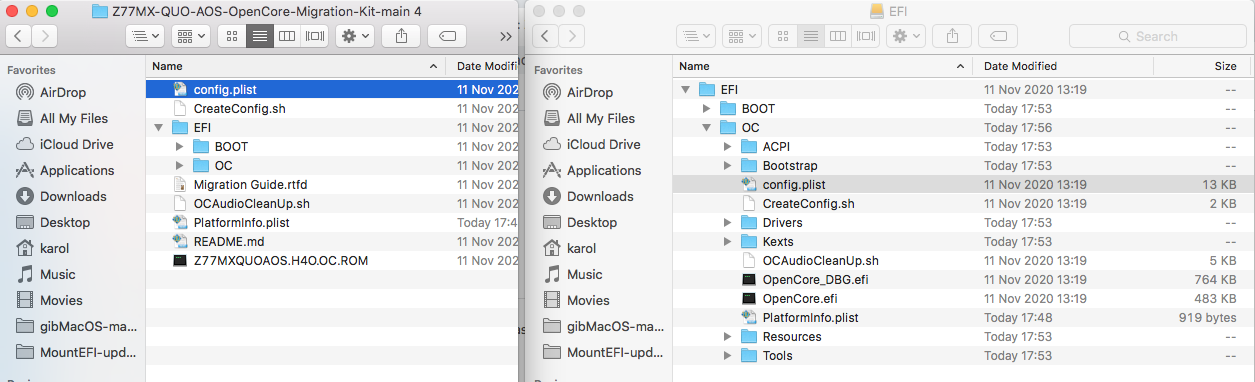

bezna Posted November 24, 2020 Share Posted November 24, 2020 6 minutes ago, IronManJFF said: Not done or not working for you ? oh i meant not working for me;/ files havent merge can i do it manually? Link to comment https://www.insanelymac.com/forum/topic/343145-guide-z77mx-quo-aos-migrating-from-ozmosis-to-opencore/page/6/#findComment-2745355 Share on other sites More sharing options...
IronManJFF Posted November 24, 2020 Author Share Posted November 24, 2020 then in Terminal Window ./CreateConfig.sh Link to comment https://www.insanelymac.com/forum/topic/343145-guide-z77mx-quo-aos-migrating-from-ozmosis-to-opencore/page/6/#findComment-2745356 Share on other sites More sharing options...

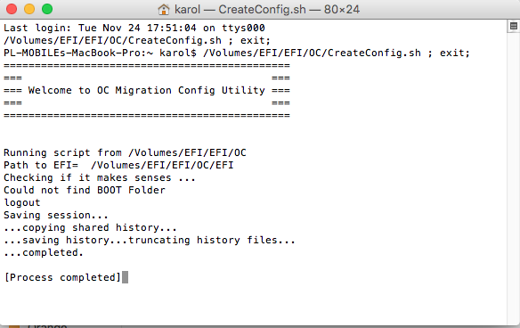

bezna Posted November 24, 2020 Share Posted November 24, 2020 (edited) im using 0.6.3 migration kit on el capitan and i dont have option "service" am i beeing dump now?;/ Last login: Tue Nov 24 18:39:31 on ttys000 PL-MOBILEs-MacBook-Pro:Z77MX-QUO-AOS-OpenCore-Migration-Kit-main 5 karol$ ./CreateConfig.sh ============================================== === === === Welcome to OC Migration Config Utility === === === ============================================== Running script from /Users/karol/Desktop/Z77MX-QUO-AOS-OpenCore-Migration-Kit-main 5 Path to EFI= /Users/karol/Desktop/Z77MX-QUO-AOS-OpenCore-Migration-Kit-main 5/EFI Checking if it makes senses ... /Users/karol/Desktop/Z77MX-QUO-AOS-OpenCore-Migration-Kit-main 5/EFI/BOOT exist /Users/karol/Desktop/Z77MX-QUO-AOS-OpenCore-Migration-Kit-main 5/EFI/OC exist ============================================== === Looks good , lets proceed === ============================================== Merging Template with your personnal PlatformInfo File Doesn't Exist, Will Create: /Users/karol/Desktop/Z77MX-QUO-AOS-OpenCore-Migration-Kit-main 5/EFI/OC/config.plist Merge: "5/config_template.plist" Entry Does Not Exist Could not find Personnalized Platform Info, using PlatformInfo.plist Merge: "5/PlatformInfo.plist" Entry Does Not Exist Done PL-MOBILEs-MacBook-Pro:Z77MX-QUO-AOS-OpenCore-Migration-Kit-main 5 karol$ Edited November 24, 2020 by bezna Link to comment https://www.insanelymac.com/forum/topic/343145-guide-z77mx-quo-aos-migrating-from-ozmosis-to-opencore/page/6/#findComment-2745358 Share on other sites More sharing options...
IronManJFF Posted November 24, 2020 Author Share Posted November 24, 2020 Check your Inbox Link to comment https://www.insanelymac.com/forum/topic/343145-guide-z77mx-quo-aos-migrating-from-ozmosis-to-opencore/page/6/#findComment-2745360 Share on other sites More sharing options...

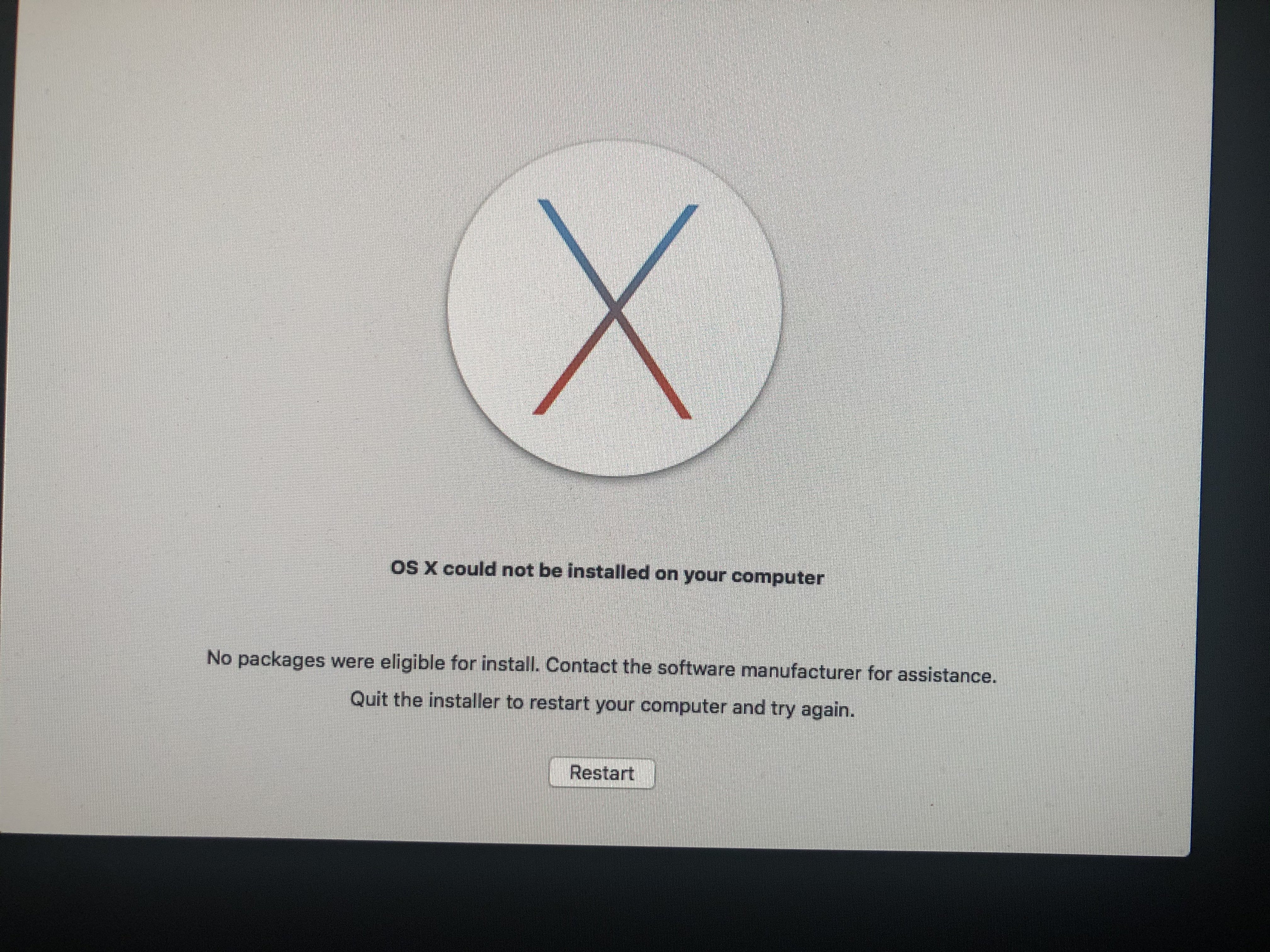

bezna Posted November 25, 2020 Share Posted November 25, 2020 2 hours ago, IronManJFF said: Check your Inbox Thanks a lot for all the help u are the star catalina instaled without problema just like on nativ mac;) sad news os i have Nvidia gpu gtx 1060 and cant get drivers for it so i will have to go back to high sierra. Im trying to instal el capitan on my 2nd ssd as i have instal usb laying around. This ssd is connected to 2nd sata port so this might be a problem will have to check it tomorrow . Cheers and thanks again;) i know im pain in the ass Link to comment https://www.insanelymac.com/forum/topic/343145-guide-z77mx-quo-aos-migrating-from-ozmosis-to-opencore/page/6/#findComment-2745378 Share on other sites More sharing options...

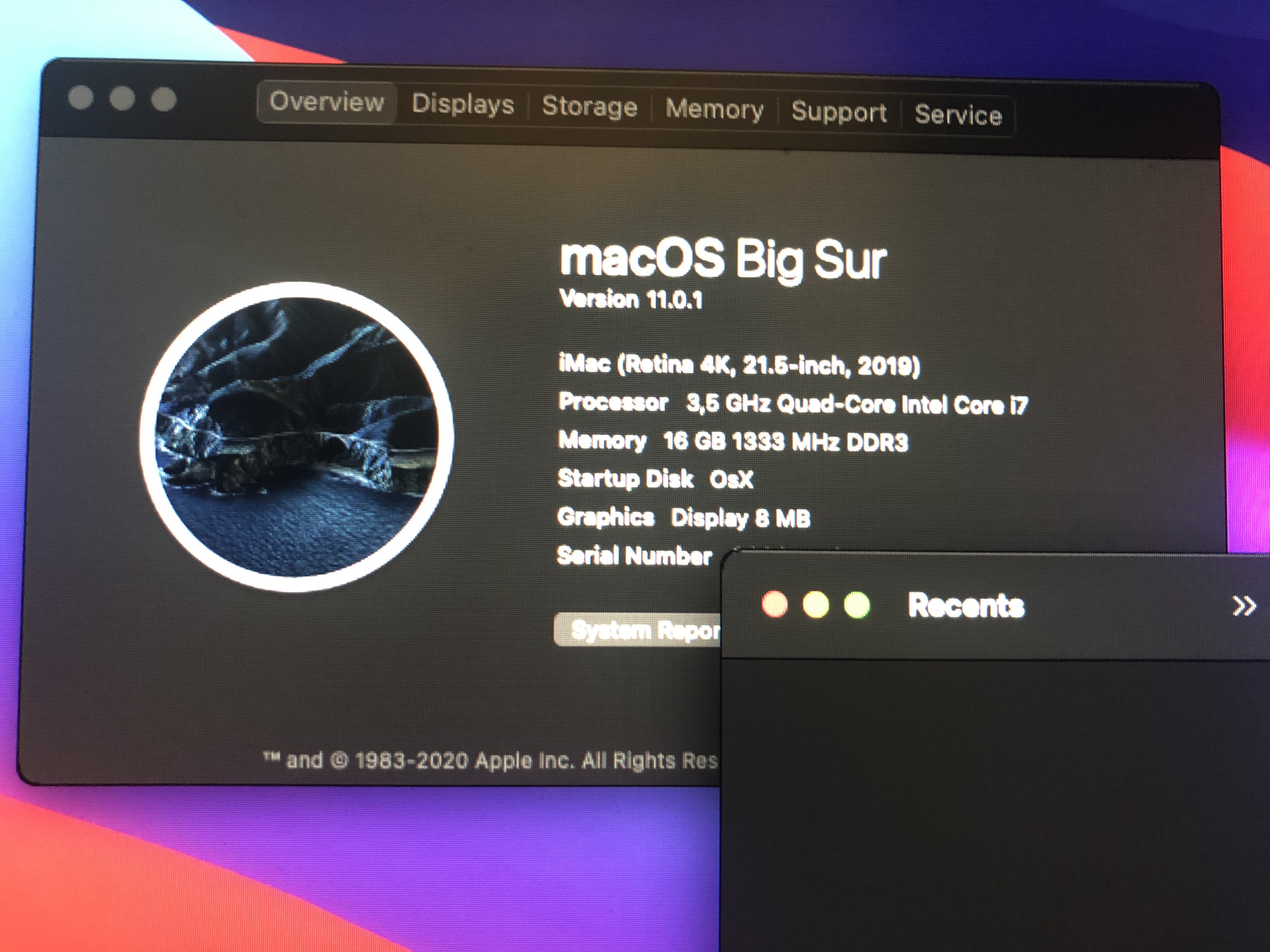

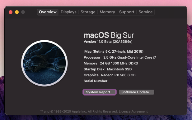

bezna Posted November 25, 2020 Share Posted November 25, 2020 Im pleased to report os big sur Efi provided by IronMan work superb. Just for test i change id of mac to newest imac19.2 and instalation fron catalina to big sur went ok i think there is just a problem with sleep mode . im on nvidia now so no graphic card;/ Iron Man if u want me to test something just let me know. Link to comment https://www.insanelymac.com/forum/topic/343145-guide-z77mx-quo-aos-migrating-from-ozmosis-to-opencore/page/6/#findComment-2745477 Share on other sites More sharing options...
