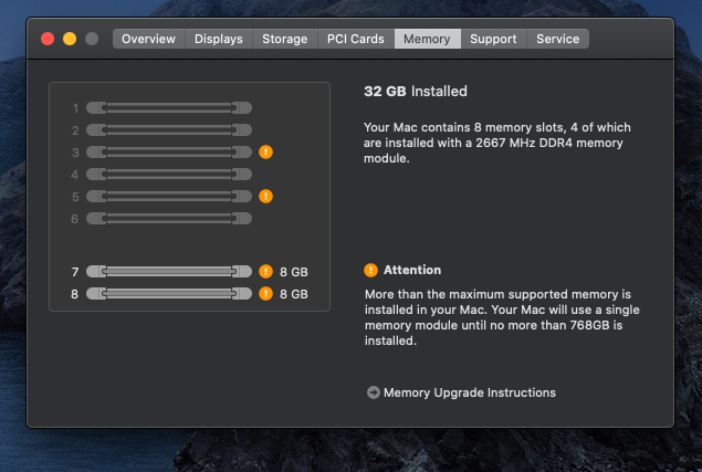

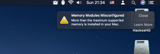

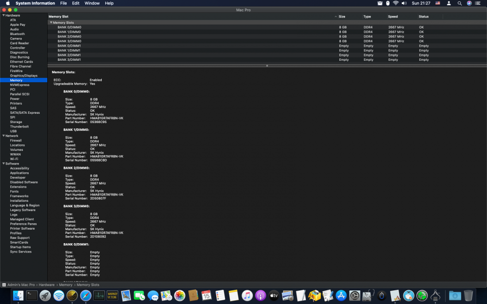

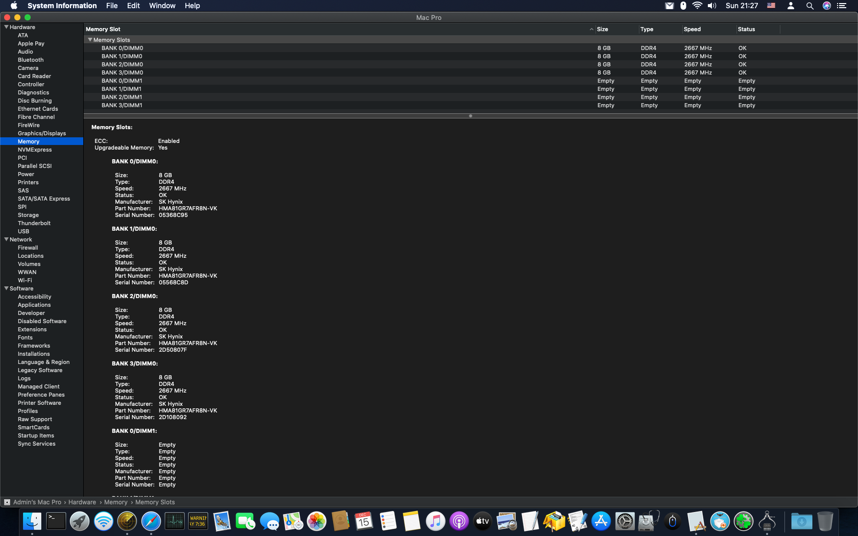

yapan4 Posted December 15, 2019 Share Posted December 15, 2019 On 12/14/2019 at 6:38 AM, iTTT said: yes, macpro7,1 . i also have this same issue. On 12/13/2019 at 1:31 PM, nmano said: "Memory Modules MisConfigured, More than the maximum supported memory is installed in your Mac." Model Identifier: MacPro7,1 How to fix this warning? Thanks guys. SMBIOS platform data for MP7,1 in new CCG 5.9.0.0 generated more correctly. But still no Memory tab in "About This Mac" + message "Memory Modules Misconfigured" 1 Link to comment https://www.insanelymac.com/forum/topic/341661-release-macos-catalina-10152/page/2/#findComment-2700708 Share on other sites More sharing options...
Andrey1970 Posted December 15, 2019 Share Posted December 15, 2019 (edited) 2 hours ago, yapan4 said: But still no Memory tab in "About This Mac" Incorrect PlatformFeature in Clover. Set 0x20 message "Memory Modules Misconfigured" While there is no decision. Edited December 15, 2019 by Andrey1970 3 Link to comment https://www.insanelymac.com/forum/topic/341661-release-macos-catalina-10152/page/2/#findComment-2700718 Share on other sites More sharing options...
yapan4 Posted December 15, 2019 Share Posted December 15, 2019 (edited) 5 hours ago, Andrey1970 said: Incorrect PlatformFeature in Clover. Set 0x20 While there is no decision. Thank you. Just for info - my results after change PlatformFeature 0x22 -> 0x20 Edited December 15, 2019 by yapan4 1 Link to comment https://www.insanelymac.com/forum/topic/341661-release-macos-catalina-10152/page/2/#findComment-2700750 Share on other sites More sharing options...
Matgen84 Posted December 16, 2019 Share Posted December 16, 2019 9 hours ago, yapan4 said: Thank you. Just for info - my results after change PlatformFeature 0x22 -> 0x20 Hi @yapan4 Last month, @Slice pushed memory rank parameters: see below from sample config.plist. Maybe it will help you. <key>#MemoryRank</key> <integer>2</integer> <key>#Memory</key> <dict> <key>Modules</key> <array> <dict> <key>Serial</key> <string>00001001</string> <key>Part</key> <string>C0001403</string> <key>Vendor</key> <string>Kingston</string> <key>Size</key> <integer>4096</integer> <key>Frequency</key> <integer>1333</integer> <key>Slot</key> <integer>0</integer> <key>Type</key> <string>DDR3</string> </dict> <dict> <key>Serial</key> <string>00001002</string> <key>Part</key> <string>C0001404</string> <key>Vendor</key> <string>Kingston</string> <key>Size</key> <integer>4096</integer> <key>Frequency</key> <integer>1333</integer> <key>Slot</key> <integer>2</integer> <key>Type</key> <string>DDR3</string> </dict> 1 Link to comment https://www.insanelymac.com/forum/topic/341661-release-macos-catalina-10152/page/2/#findComment-2700789 Share on other sites More sharing options...
yapan4 Posted December 16, 2019 Share Posted December 16, 2019 (edited) 15 hours ago, Matgen84 said: Last month, @Slice pushed memory rank parameters: see below from sample config.plist. Maybe it will help you. Thanks, I'll try... Update: I have consistently tried all the settings for MemoryRank parameter(w/o, -1, 0, 1, 2) - do not make any difference in my case, still "Memory Modules Misconfigured" SMBIOS Memory.rtf bootlog.txt Edited December 16, 2019 by yapan4 1 Link to comment https://www.insanelymac.com/forum/topic/341661-release-macos-catalina-10152/page/2/#findComment-2700798 Share on other sites More sharing options...

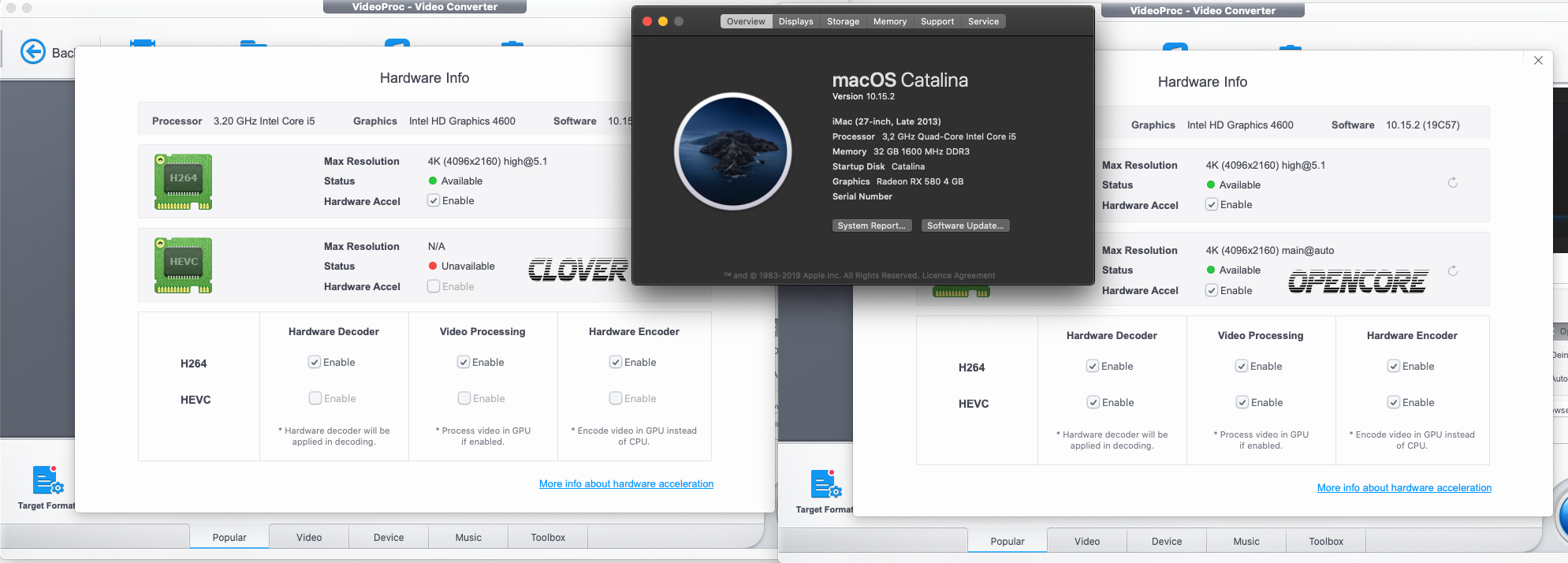

Irish_Man Posted December 17, 2019 Share Posted December 17, 2019 Hi guys, I'm a bit confused. Trying to switch to Opencore but I'm still not familiar with it. I do have both build working and running fine, tho. When I run VideoProc app, I get different results. OpenCore - HEVC Enabled Clover - HEVC Unavailable Can someone tell me how's this possible? Tnx Link to comment https://www.insanelymac.com/forum/topic/341661-release-macos-catalina-10152/page/2/#findComment-2700955 Share on other sites More sharing options...

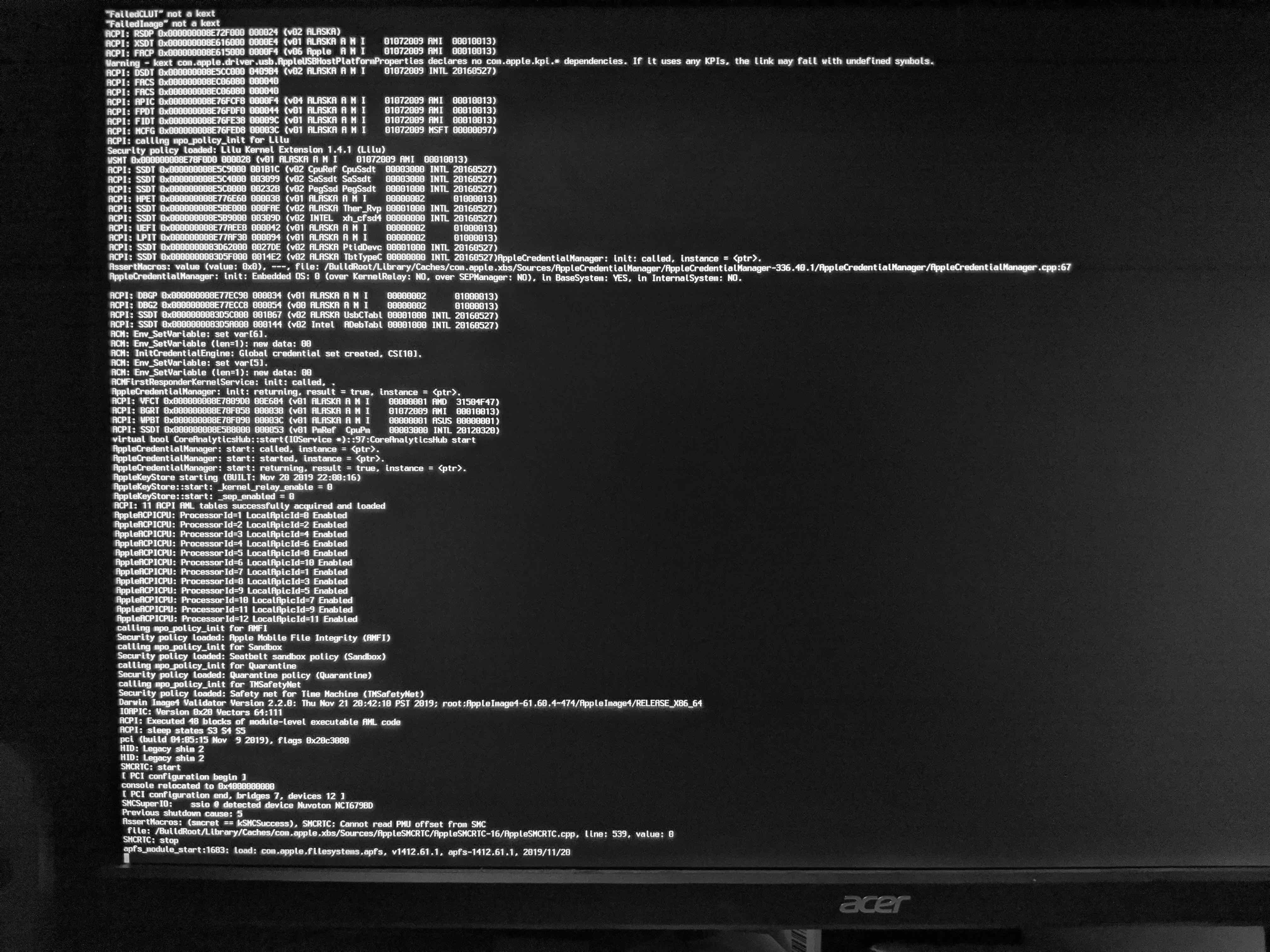

sl0wtarget Posted December 26, 2019 Share Posted December 26, 2019 Help. Please. Just decided 'screw it' I'll try to upgrade to Catalina. Get this after reboot—a link to a thread about prepping for the upgrade would be appreciated. TIA Link to comment https://www.insanelymac.com/forum/topic/341661-release-macos-catalina-10152/page/2/#findComment-2701752 Share on other sites More sharing options...

sl0wtarget Posted December 29, 2019 Share Posted December 29, 2019 On 12/27/2019 at 4:09 AM, C.Frio said: Hi.. Show your rig and from what version you are trying to update..will be easier to someone help... C.frio Isn't my rig in my signature? I'm trying to upgrade from Mojave, 10.14.6 to 10.15.2 Link to comment https://www.insanelymac.com/forum/topic/341661-release-macos-catalina-10152/page/2/#findComment-2702059 Share on other sites More sharing options...
sl0wtarget Posted December 29, 2019 Share Posted December 29, 2019 On 12/27/2019 at 5:50 AM, iCanaro said: @sl0wtarget if your hack is what I see in the signature, you have to commit yourself a little more, it is extremely compatible and not particularly demanding .... obviously you need to know at least the basics of the hack world I got it up and running since 10.13.x, I know basics obviously (although "basics" is a relative term here) but I don't have time. I don't have time to commit, I'm getting older, I work a lot, have a family, home, etc so "demanding" is more a frustration for me than it is for you. A BIOS update of my Z370-F left it usable but trying to get into the BIOS was impossible (and of course I need access for boot override), always a black screen no matter if I used the iGPU or Radeon VII no matter what port (HDMI, DP of either). I swapped in an Asus Z390-F and I'm still not able to boot into macOS on the hard drive or the Mojave installer USB that had my last, successfully working EFI partition. The best course of action I can think of is to install Z390 drivers into the EFI of the Mojave installer from my old MacPro and see if that gets me up and running—what extra drivers do I need for the Z390 as opposed to the Z370? I'll either find out on my own or someone will help me? Link to comment https://www.insanelymac.com/forum/topic/341661-release-macos-catalina-10152/page/2/#findComment-2702062 Share on other sites More sharing options...
iCanaro Posted December 29, 2019 Share Posted December 29, 2019 (edited) @sl0wtarget attach your EFI (without APPLE and Microsoft folders inside) that I see if I can make it better check that you have the correct BIOS configuration Edited December 29, 2019 by iCanaro 1 Link to comment https://www.insanelymac.com/forum/topic/341661-release-macos-catalina-10152/page/2/#findComment-2702064 Share on other sites More sharing options...
sl0wtarget Posted December 30, 2019 Share Posted December 30, 2019 I sent a private message. If I can run the Mojave Installer and recover what I have on the Hackintosh drive (without wiping the volume) that would be a great start, if I can also create a Catalina Installer on another thumb drive that would get me up and running with Catalina that'd be great too. Link to comment https://www.insanelymac.com/forum/topic/341661-release-macos-catalina-10152/page/2/#findComment-2702175 Share on other sites More sharing options...

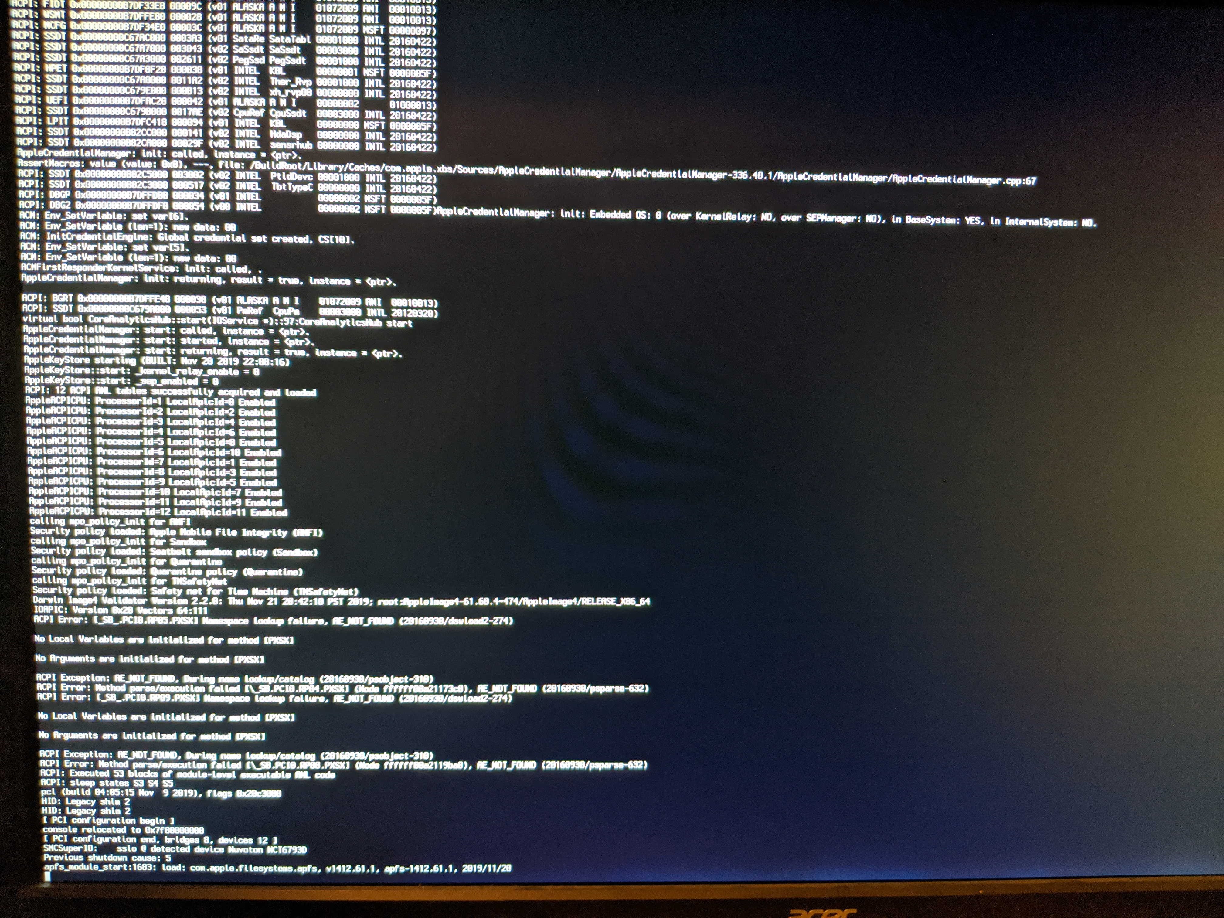

sl0wtarget Posted January 4, 2020 Share Posted January 4, 2020 Trying to upgrade to Catalina, this is the wall I hit. Specs are in signature; Should I try to install from a thumb drive instead of direct from System Preferences/MAS? Thanks Link to comment https://www.insanelymac.com/forum/topic/341661-release-macos-catalina-10152/page/2/#findComment-2702793 Share on other sites More sharing options...
Matgen84 Posted January 4, 2020 Share Posted January 4, 2020 16 minutes ago, sl0wtarget said: Trying to upgrade to Catalina, this is the wall I hit. Specs are in signature; Should I try to install from a thumb drive instead of direct from System Preferences/MAS? Thanks You just need to put SSDT-EC.aml in /EFI/CLOVER/ACPI/patched. Or use ec patch in config.plist change EC0 to EC 4543305f 45435f5f Update Lilu + WEG + AppleALC kexts to latest versions. 2 Link to comment https://www.insanelymac.com/forum/topic/341661-release-macos-catalina-10152/page/2/#findComment-2702795 Share on other sites More sharing options...
