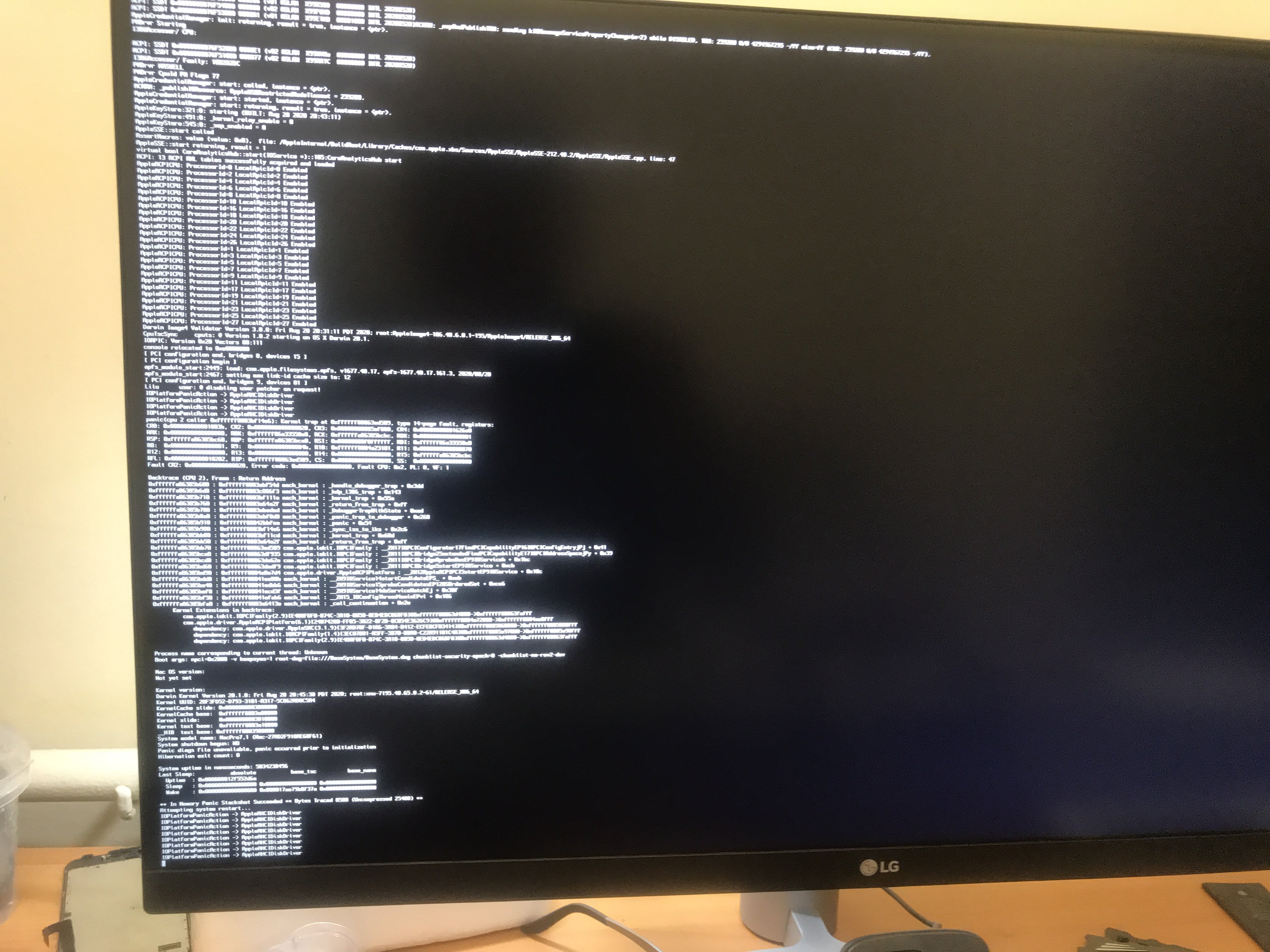

Looks the same as mine, but mines happens right after the first pci configuration end line
can you look at this post from August 11 @dMatik and @pitrysha talking about  dp4 and x99 boards, I have attempted, a couple of weeks back, to contact these two to no avail. but look at the efi and see what's going on :

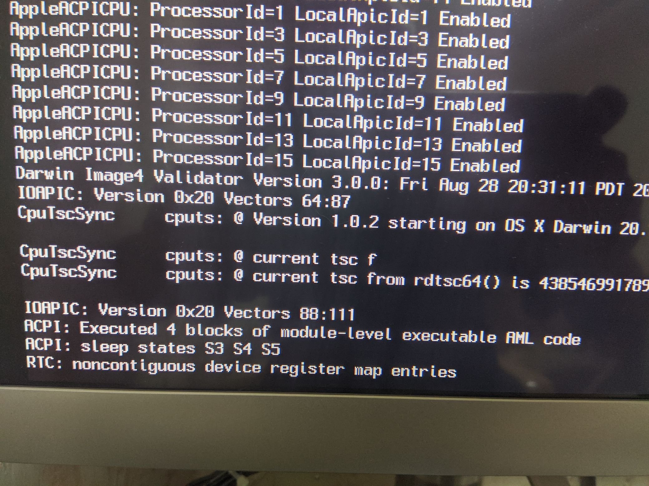

To get rid of this you need the rtc patch i posted earlyer, after this you will have the same kernel panic as the rest of us

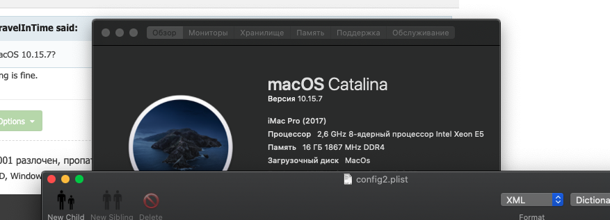

Have anyone tried macOS 10.15.7 ?

About figuring out the problem we need to know which is the device causing it, as far as i have saw it's either a device in UNC0 or PCI0 or the whole bridges, or some sub-bridge thing, then we need to know what's wrong with them, and that's the difficoult part, but we can compare it to real macs or not too far off hackintoshes, i need the original DSDT from an iMac pro and from and x299 hackintosh to have reference and also from the mac pro 2013, since ivybridge x79 hackintoshes seems to soffer from a similar issue to x99.
Too bad thereisn't any big sur source code out in the open source apple website.
