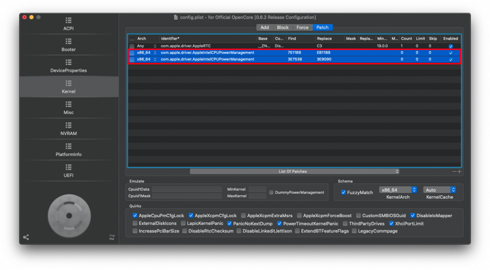

nmano Posted October 21, 2020 Author Share Posted October 21, 2020 I update XCPM 10.16 /11.0 Beta 10 (20A5395g) X99/X299 Enjoy. 3 Link to comment https://www.insanelymac.com/forum/topic/341477-open-core-kernel-kext-patch-for-x99x299-motherboard/page/14/#findComment-2741576 Share on other sites More sharing options...

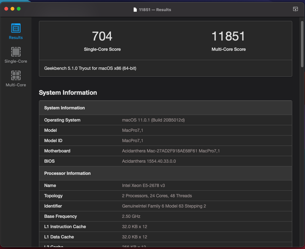

nmano Posted November 1, 2020 Author Share Posted November 1, 2020 2xIntel Xeon E5-2678 Link to comment https://www.insanelymac.com/forum/topic/341477-open-core-kernel-kext-patch-for-x99x299-motherboard/page/14/#findComment-2742698 Share on other sites More sharing options...

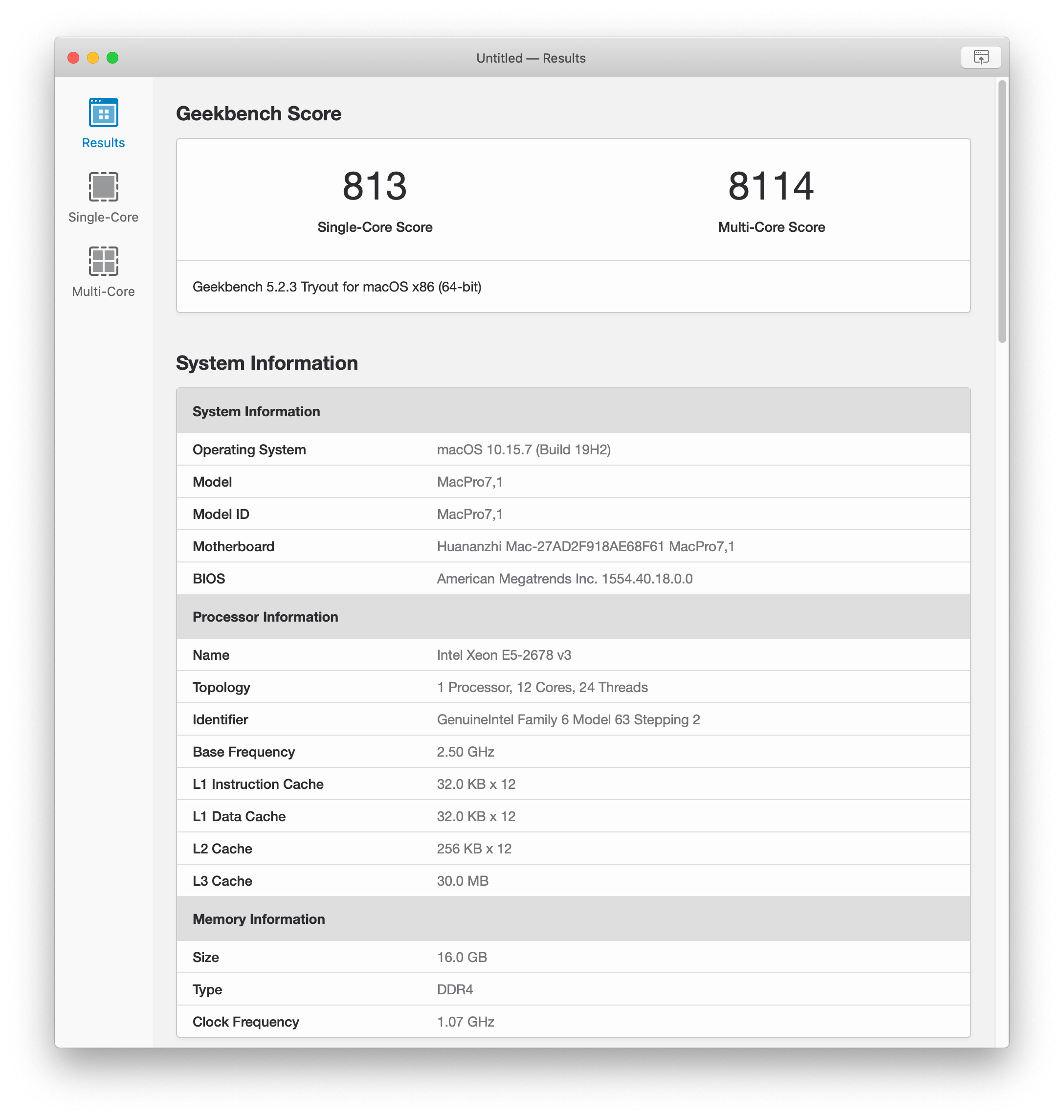

AslashA Posted November 1, 2020 Share Posted November 1, 2020 10 hours ago, nmano said: 2xIntel Xeon E5-2678 You have something wrong. Too few scores in the benchmark. I have with one processor 82х - Single-Core and 81xx - Multi-Core. 1 Link to comment https://www.insanelymac.com/forum/topic/341477-open-core-kernel-kext-patch-for-x99x299-motherboard/page/14/#findComment-2742730 Share on other sites More sharing options...
nmano Posted November 2, 2020 Author Share Posted November 2, 2020 (edited) 17 hours ago, AslashA said: You have something wrong. Too few scores in the benchmark. I have with one processor 82х - Single-Core and 81xx - Multi-Core. Try Geekbench 5.1.0 or Latest Edited November 2, 2020 by nmano Link to comment https://www.insanelymac.com/forum/topic/341477-open-core-kernel-kext-patch-for-x99x299-motherboard/page/14/#findComment-2742798 Share on other sites More sharing options...
AslashA Posted November 2, 2020 Share Posted November 2, 2020 (edited) 1 hour ago, nmano said: Try Geekbench 5.1.0 or Latest I have version 5.2.3 .. Now did the test again. I'm using emulation + AppleXcpmExtraMsrs in OpenCore and PMDrv.kext. I don't use the turbo boost unlock! Edited November 2, 2020 by AslashA 2 Link to comment https://www.insanelymac.com/forum/topic/341477-open-core-kernel-kext-patch-for-x99x299-motherboard/page/14/#findComment-2742805 Share on other sites More sharing options...
Vinicius P. Miranda Posted November 6, 2020 Share Posted November 6, 2020 His is right. 2 processors do not double performance. This would be the ideal scenario, but it is not what happens in practice. Link to comment https://www.insanelymac.com/forum/topic/341477-open-core-kernel-kext-patch-for-x99x299-motherboard/page/14/#findComment-2743160 Share on other sites More sharing options...
AslashA Posted November 10, 2020 Share Posted November 10, 2020 On 11/6/2020 at 9:22 PM, Vinicius P. Miranda said: His is right. 2 processors do not double performance. This would be the ideal scenario, but it is not what happens in practice. No. He also has few points in the single core. Link to comment https://www.insanelymac.com/forum/topic/341477-open-core-kernel-kext-patch-for-x99x299-motherboard/page/14/#findComment-2743519 Share on other sites More sharing options...
