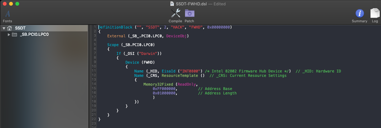

ITzTravelInTime Posted September 16, 2020 Share Posted September 16, 2020 1 hour ago, Антико said: Однако у меня на телефоне есть копия dsdt)) DSDT — копия.aml.zip Perhaps you can take a look? i took a look, it looks very similar to mine, and you too don't have the FWHD and ARTC device, while the chinese mobo has that and boots, perhaps adding it will fix the issue 2 Link to comment https://www.insanelymac.com/forum/topic/341477-open-core-kernel-kext-patch-for-x99x299-motherboard/page/8/#findComment-2737456 Share on other sites More sharing options...

ITzTravelInTime Posted September 16, 2020 Share Posted September 16, 2020 18 minutes ago, Антико said: Think you should try adding them? But what are they responsible for? I don't really understand DSDT))). Sorry, translation difficulties)) Yes but i don't know how to create an ssdt for that, i have attempted but without success 1 Link to comment https://www.insanelymac.com/forum/topic/341477-open-core-kernel-kext-patch-for-x99x299-motherboard/page/8/#findComment-2737459 Share on other sites More sharing options...
hardcorehenry Posted September 16, 2020 Share Posted September 16, 2020 (edited) I don't know if it'll solve your problem. SSDT-FWHD(not tested), edit Scope if not the same. DefinitionBlock ("", "SSDT", 2, "HACK", "FWHD", 0x00000000) { External (_SB_.PCI0.LPCB, DeviceObj) Scope (_SB.PCI0.LPCB) { If (_OSI ("Darwin")) { Device (FWHD) { Name (_HID, EisaId ("INT0800") /* Intel 82802 Firmware Hub Device */) // _HID: Hardware ID Name (_CRS, ResourceTemplate () // _CRS: Current Resource Settings { Memory32Fixed (ReadOnly, 0xFF000000, // Address Base 0x01000000, // Address Length ) }) } } } } Edited September 16, 2020 by hardcorehenry 1 Link to comment https://www.insanelymac.com/forum/topic/341477-open-core-kernel-kext-patch-for-x99x299-motherboard/page/8/#findComment-2737463 Share on other sites More sharing options...
ITzTravelInTime Posted September 16, 2020 Share Posted September 16, 2020 10 minutes ago, hardcorehenry said: I don't know if it'll solve your problem. SSDT-FWHD(not tested), make sure you have the same Scope DefinitionBlock ("", "SSDT", 2, "HACK", "FWHD", 0x00000000) { External (_SB_.PCI0.LPCB, DeviceObj) Scope (_SB.PCI0.LPCB) { If (_OSI ("Darwin")) { Device (FWHD) { Name (_HID, EisaId ("INT0800") /* Intel 82802 Firmware Hub Device */) // _HID: Hardware ID Name (_CRS, ResourceTemplate () // _CRS: Current Resource Settings { Memory32Fixed (ReadOnly, 0xFF000000, // Address Base 0x01000000, // Address Length ) }) } } } } I think it's prettymuch it, but on x99 system it's LPC0 instead of LPCB and a renaming patch doesn't work for it 1 Link to comment https://www.insanelymac.com/forum/topic/341477-open-core-kernel-kext-patch-for-x99x299-motherboard/page/8/#findComment-2737465 Share on other sites More sharing options...
hardcorehenry Posted September 16, 2020 Share Posted September 16, 2020 (edited) 14 minutes ago, ITzTravelInTime said: I think it's prettymuch it, but on x99 system it's LPC0 instead of LPCB and a renaming patch doesn't work for it Rename it manually(not via patch) and compile it. Spoiler Edited September 16, 2020 by hardcorehenry 1 Link to comment https://www.insanelymac.com/forum/topic/341477-open-core-kernel-kext-patch-for-x99x299-motherboard/page/8/#findComment-2737466 Share on other sites More sharing options...
ITzTravelInTime Posted September 16, 2020 Share Posted September 16, 2020 18 minutes ago, hardcorehenry said: Rename it manually(not via patch) and compile it. Reveal hidden contents It works, i get the FWHD device into ioregistry explorer but i still got the same kp, i will continue to look at the differences beetwenn the dsdt of my system and the working one and see if there is anything else in need of a patch 4 Link to comment https://www.insanelymac.com/forum/topic/341477-open-core-kernel-kext-patch-for-x99x299-motherboard/page/8/#findComment-2737467 Share on other sites More sharing options...
