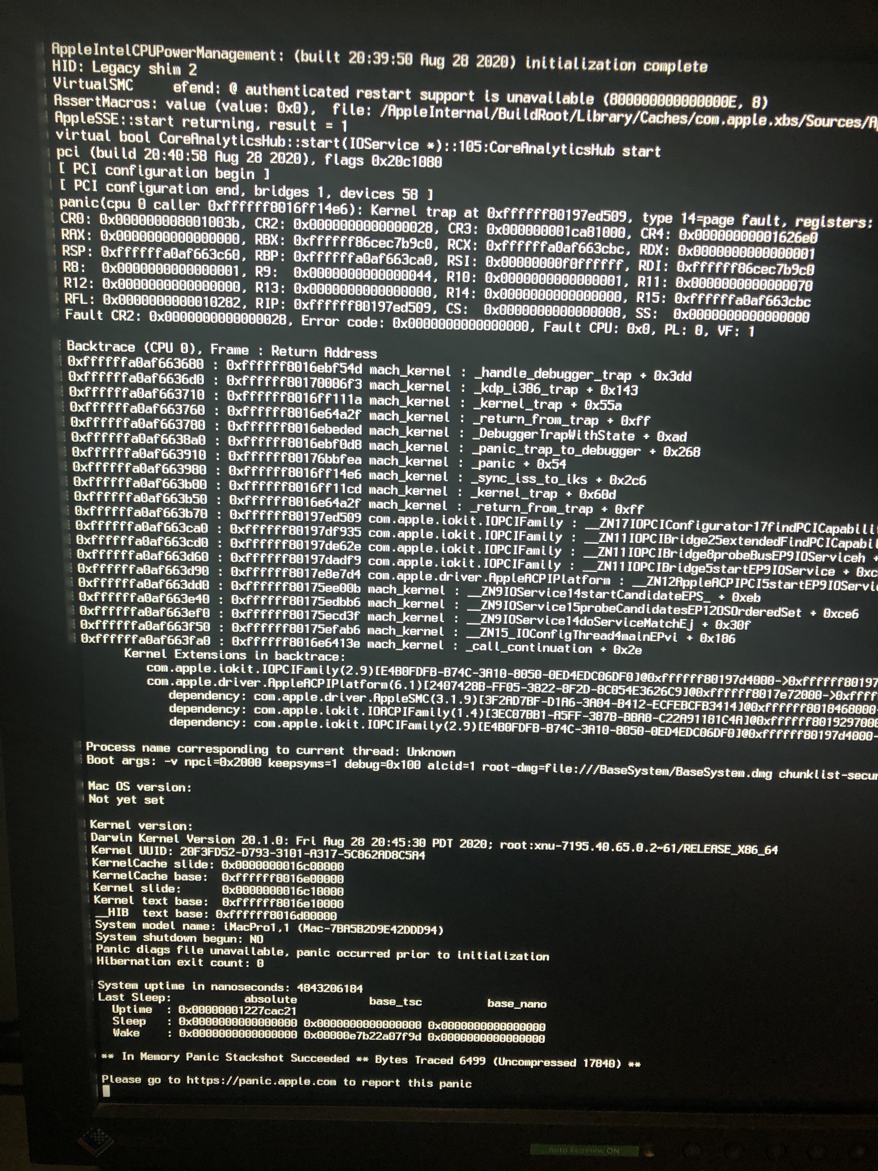

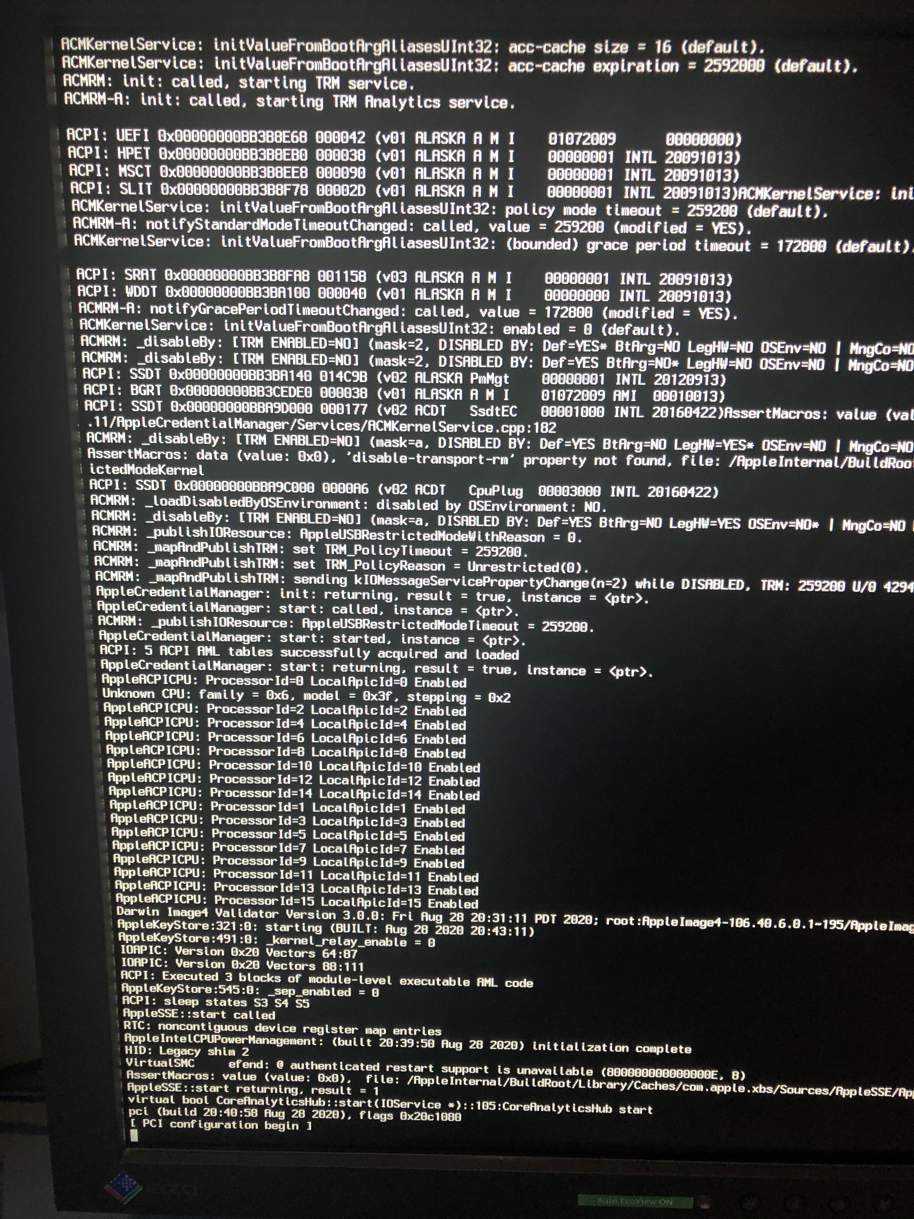

rvilbert Posted September 30, 2020 Share Posted September 30, 2020 I'm not sure if this is useful but i have been trying also to install Big Sur with Opencore on Asus X99 Deluxe / i7 5960x and even though i get stuck, i don't get the kernel panic that everybody seems to get. I may have done something different but I have created/patched my SSDT-EC-USBX.aml and SSDT-PLUG.aml and then apply the various kext and kernel patches in config.plist. I'm getting stuck at PCI Configuration Begin and I'm trying to figure out what i have done wrong. If anyone has any view that would be much appreciated. I have my EFI and boot screen. Thanks a lot TEST OC - EFI 30 SEPT 2020.zip Link to comment https://www.insanelymac.com/forum/topic/341477-open-core-kernel-kext-patch-for-x99x299-motherboard/page/11/#findComment-2738877 Share on other sites More sharing options...

rvilbert Posted September 30, 2020 Share Posted September 30, 2020 You are a star!! I managed to boot with Opencore on Catalina copying your config. Thank you very much! I'm sure you spent ages figuring this out. I tried the same config with Big Sur and ... I ended up with a lovely Kernel panic... so i guess i'm now at the same point with all of you guys. Not sure if this help but here are the boot screen and my config.plist. Thank you again config.plist.zip 1 Link to comment https://www.insanelymac.com/forum/topic/341477-open-core-kernel-kext-patch-for-x99x299-motherboard/page/11/#findComment-2738902 Share on other sites More sharing options...
jmacie Posted September 30, 2020 Share Posted September 30, 2020 yep, happy sailing! same kp same ol same ol. We'll get it sorted at some point. When BigSur is released we can get the word out on reddit, they don't allow beta support. I would say spam opencore thread and BigSur thread, but they think we suck, but I think older x79 has the same KP so that might be another group to get involved later on. Take care, keep an eye out! 2 Link to comment https://www.insanelymac.com/forum/topic/341477-open-core-kernel-kext-patch-for-x99x299-motherboard/page/11/#findComment-2738905 Share on other sites More sharing options...
Cclown98 Posted September 30, 2020 Share Posted September 30, 2020 On beta 9 (big sur) the things are not as great as they used to be, i'm getting sometimes kp related to processor , and other times it will stuck on Legacy shim 2 message 2 1 Link to comment https://www.insanelymac.com/forum/topic/341477-open-core-kernel-kext-patch-for-x99x299-motherboard/page/11/#findComment-2738930 Share on other sites More sharing options...

ITzTravelInTime Posted October 13, 2020 Share Posted October 13, 2020 4 hours ago, RemB said: Thx, Cclown98. I'm in. Whait, how did you do it? did you get that infamus iopcifamily kernel panic as the other people did? Link to comment https://www.insanelymac.com/forum/topic/341477-open-core-kernel-kext-patch-for-x99x299-motherboard/page/11/#findComment-2740269 Share on other sites More sharing options...
jmacie Posted October 13, 2020 Share Posted October 13, 2020 (edited) 1 hour ago, ITzTravelInTime said: Whait, how did you do it? did you get that infamus iopcifamily kernel panic as the other people did? Go on that thread on the other board. I tried to get help from him there are some efi's that some posted. The one they tried to help me with didn't work, but you can look at their efi post #31 it might help, it didn't help me. One of the things someone was suggesting was smbios imac 15.1 or .2, that didn't work, then I tried to work with the efi they posted and the one they made me did not work, but you might glean something from post #31. They were also editing @mahmut's dsdt, don't know what that entailed, dead ends still Edited October 13, 2020 by jmacie Link to comment https://www.insanelymac.com/forum/topic/341477-open-core-kernel-kext-patch-for-x99x299-motherboard/page/11/#findComment-2740285 Share on other sites More sharing options...

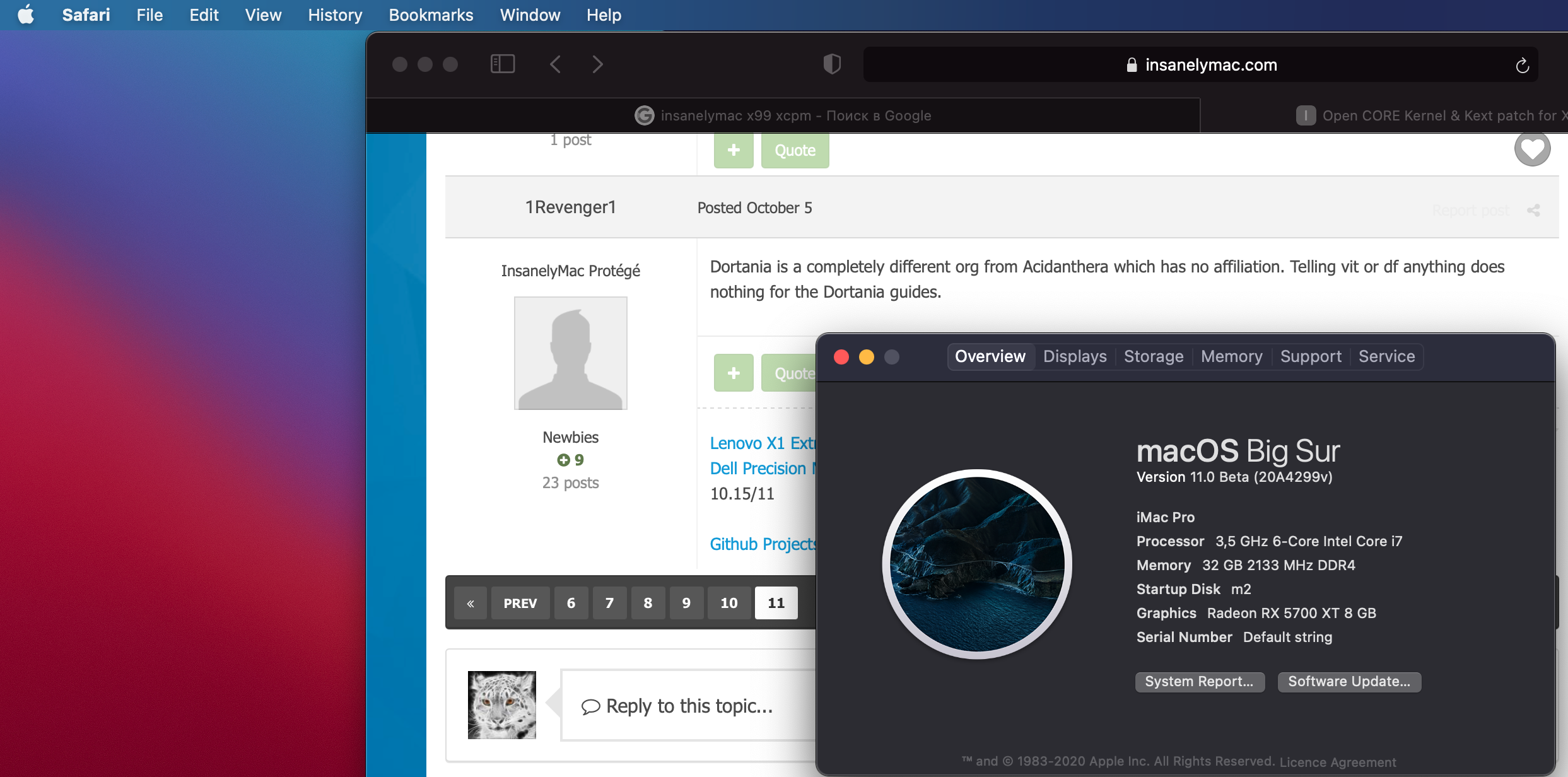

RemB Posted October 14, 2020 Share Posted October 14, 2020 (edited) 6 hours ago, ITzTravelInTime said: Whait, how did you do it? did you get that infamus iopcifamily kernel panic as the other people did? We with acidanthera (OpenCore developers) working on correct patch and/or SSDT. But now you can remove UNCx sections from DSDT and patch RTC. It's working for me. Edited October 14, 2020 by RemB 3 1 Link to comment https://www.insanelymac.com/forum/topic/341477-open-core-kernel-kext-patch-for-x99x299-motherboard/page/11/#findComment-2740298 Share on other sites More sharing options...
jmacie Posted October 14, 2020 Share Posted October 14, 2020 (edited) @RemB I appreciate your efforts. Hopefully you'll succeed and we can move forward with our x99. I don't understand exactly how to affect these patches, but maybe @ITzTravelInTime can relate it to us. Thanks again, johnm edit- well yes this got me past KP. I could not boot, BUT!, we are on our way. I did not understand the instructions above you gave about UNCx or rtc patch, but I went on the other board where you had taken mahmet's dsdt and fixed it. I compared mahmet's asus x99 dsdt to mine, and then looked at the patched dsdt you made and decided his dsdt was approx.the same, so I threw caution to the wind and used the dsdt you patched for mahmet and it did get me way past the KP, I just froze up quite a bit down the line. I totally understand you cannot use a different MB model's dsdt. I'm sure that if my dsdt is patched I will succeed or at least I believe in your work and that ultimately we will succeed with yours and acidanthera's help and expertise. Until then I will plug away. Thank you all, and hopefully @ITzTravelInTime will be able to put this in more laymans terms for each of us! Putting up my unpatched dsdt if you might consider helping me, Thanks johnm dsdt.aml edit again, SUCCESS!!!. Using a dsdt for a different model motherboard, crazy. I left my frozen stuck install while I typed this comment on a different computer. When I clicked over to the install it was ready to install BigSur, so WOW, it's been ulcers for 10+ weeks, and now at least we are not lost souils. @RemB you are my hero. We will get this ironed out and help all the x99ers out there. The patch from acidanthera and you would be sweet. And hopefully I'll get my dsdt properly patched for my board!! I'll keep this updated Edited October 14, 2020 by jmacie 2 Link to comment https://www.insanelymac.com/forum/topic/341477-open-core-kernel-kext-patch-for-x99x299-motherboard/page/11/#findComment-2740299 Share on other sites More sharing options...

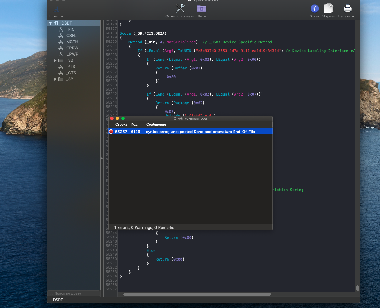

ANTIKO Posted October 14, 2020 Share Posted October 14, 2020 (edited) Могли бы вы мне тоже помочь? Я сделал исправление по вашему совету _ но увы! DSDT.aml DSDT.dsl 1 час назад RemB сказал: Мы с acidanthera (разработчики OpenCore) работаем над правильным патчем и / или SSDT. Но теперь вы можете удалить UNCx-разделы из DSDT и исправить RTC. У меня это работает. Edited October 14, 2020 by Антико Link to comment https://www.insanelymac.com/forum/topic/341477-open-core-kernel-kext-patch-for-x99x299-motherboard/page/11/#findComment-2740306 Share on other sites More sharing options...
RemB Posted October 14, 2020 Share Posted October 14, 2020 29 minutes ago, Антико said: Могли бы вы мне тоже помочь? Я сделал исправление по вашему совету _ но увы! DSDT.aml DSDT.dsl Мне не удается скачать приложенные файлы. Но думаю сегодня ближе к вечеру будет решение без правки ДСДТ. 2 Link to comment https://www.insanelymac.com/forum/topic/341477-open-core-kernel-kext-patch-for-x99x299-motherboard/page/11/#findComment-2740309 Share on other sites More sharing options...
ANTIKO Posted October 14, 2020 Share Posted October 14, 2020 2 минуты назад RemB сказал: Мне не удается скачать приложенные файлы . Но думаю сегодня ближе к вечеру будет решение без правки ДСДТ. Моя вина, неправильно отредактировал сообщение. Увы, уже в дороге. Подождём, спасибо большое. Link to comment https://www.insanelymac.com/forum/topic/341477-open-core-kernel-kext-patch-for-x99x299-motherboard/page/11/#findComment-2740310 Share on other sites More sharing options...

ANTIKO Posted October 14, 2020 Share Posted October 14, 2020 5 hours ago, RemB said: Мне не удается скачать приложенные файлы. Но думаю сегодня ближе к вечеру будет решение без правки ДСДТ. Почему то ошибку выдает DSDT при компиляции(применил ваш совет) Исправить не могу. Может глянете? (Терпения уже не хватает) DSDT.dsl Link to comment https://www.insanelymac.com/forum/topic/341477-open-core-kernel-kext-patch-for-x99x299-motherboard/page/11/#findComment-2740328 Share on other sites More sharing options...
Mike Ranger Posted October 14, 2020 Share Posted October 14, 2020 Does it have to be a DSDT.... can we create a SSDT as well? Do we understand what the critical portion is? Link to comment https://www.insanelymac.com/forum/topic/341477-open-core-kernel-kext-patch-for-x99x299-motherboard/page/11/#findComment-2740336 Share on other sites More sharing options...
