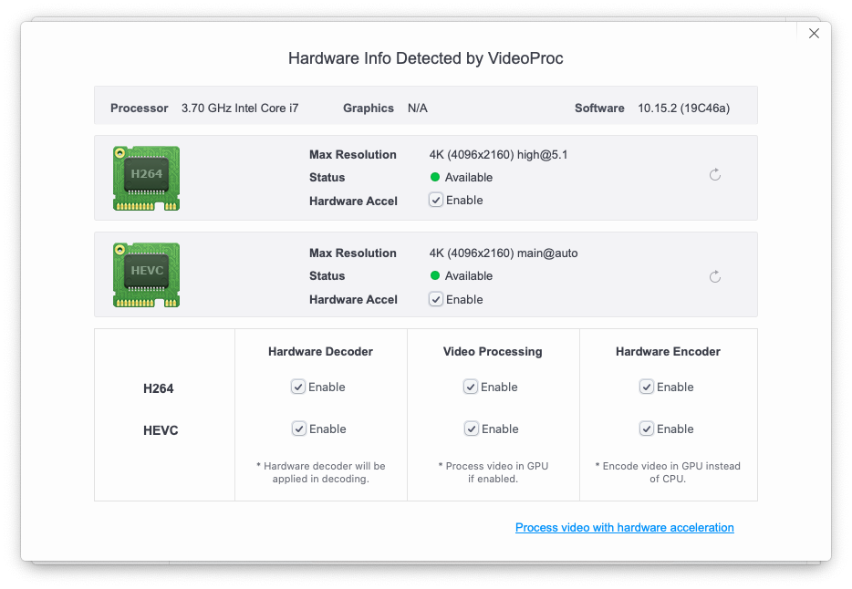

macandrea Posted November 19, 2019 Share Posted November 19, 2019 I have an X299, no IGPU, full support for H264 and HEVC from VideoProc, using Whatevergreen with an RX580, iMacpro1,1. If I follow the link https://bitmovin.com/demos/drm my hack hangs, I can only move the mouse pointer but everything else is freezed - I have to reboot. Is that normal with MacOS using the RX580 + drm content or can this be due to misconfiguration? @Pavo: have you tried using Sidecar with your XEON config? It works with my X299 using iMac19,1 but the image has a very poor quality and flickers up to a point it is unusable. Do I really need IGPU and/or T2 chip to make it work properly? Cheers, Andrea Link to comment Share on other sites More sharing options...

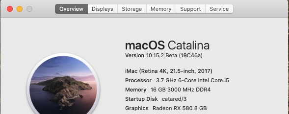

gengik84 Posted November 20, 2019 Author Share Posted November 20, 2019 beta 3 build 19C46a 6 2 Link to comment Share on other sites More sharing options...
justin Posted November 20, 2019 Share Posted November 20, 2019 21 minutes ago, gengik84 said: beta 3 build 19C46a what does this say? if it exists and value is 1, that means AMD RX 4xx/5xx HEVC capability is back, thanks. grep -w -A60 AMDEllesmereGraphicsAccelerator /System/Library/Extensions/AMDRadeonX4000.kext/Contents/Info.plist | grep -A1 -w IOGVAHEVCDecode 1 Link to comment Share on other sites More sharing options...

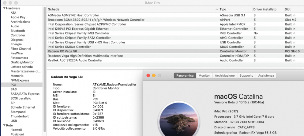

iCanaro Posted November 20, 2019 Share Posted November 20, 2019 1 Link to comment Share on other sites More sharing options...
justin Posted November 20, 2019 Share Posted November 20, 2019 Vega is fine of course. Can you run the grep command? Link to comment Share on other sites More sharing options...

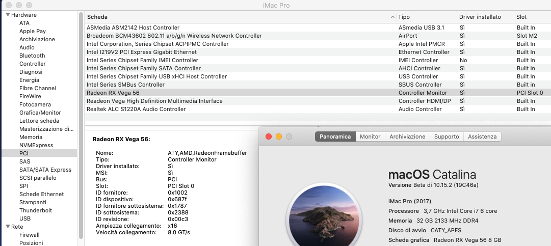

C.Frio Posted November 21, 2019 Share Posted November 21, 2019 hi... done on a MSI z390 c.frio 4 Link to comment Share on other sites More sharing options...
