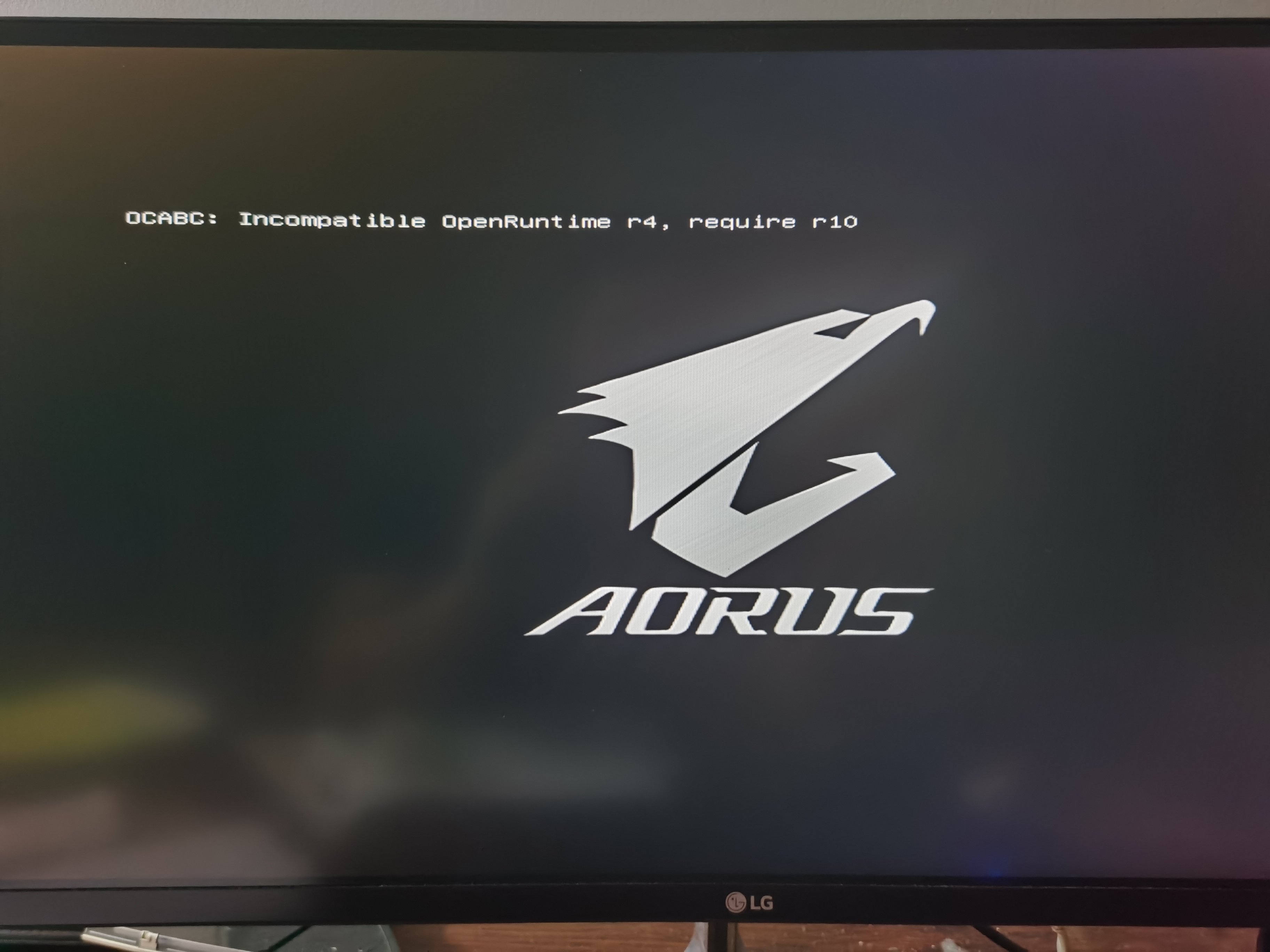

pl4n__b Posted April 9, 2020 Share Posted April 9, 2020 (edited) 3 hours ago, AudioGod said: Holly Cow what’s happened there then?? what EFI are you trying there? NDK or OC original? silly question but I must ask, did you merge or replace the EFI when you dropped mine into your EFI Partition? did you clear the NVRam? If I'm not mistaken i download the top one ( i saw clover file there ) and i replace everything one by one except my config.plist . But I have made a copy of my EFI, what should i do now buddy ? Edited April 9, 2020 by pl4n__b Link to comment https://www.insanelymac.com/forum/topic/340936-audiogods-aorus-z390-master-patched-dsdt-efi-for-catalina-mini-guide-and-discussion/page/33/#findComment-2716402 Share on other sites More sharing options...
AudioGod Posted April 9, 2020 Author Share Posted April 9, 2020 (edited) 48 minutes ago, pl4n__b said: If I'm not mistaken i download the top one ( i saw clover file there ) and i replace everything one by one except my config.plist . But I have made a copy of my EFI, what should i do now buddy ? What were you using before you tried my EFI? not using my plist and copying everything else over is simply not going to work unless you have been using my EFI from the start. you need to redownload my EFI and copy your serial number, uuid and MLB over to my plist and use the whole EFI replacing every part of you old one. No 2 configs are the same buddy and that’s where you have gone wrong, Edited April 9, 2020 by AudioGod 1 Link to comment https://www.insanelymac.com/forum/topic/340936-audiogods-aorus-z390-master-patched-dsdt-efi-for-catalina-mini-guide-and-discussion/page/33/#findComment-2716415 Share on other sites More sharing options...

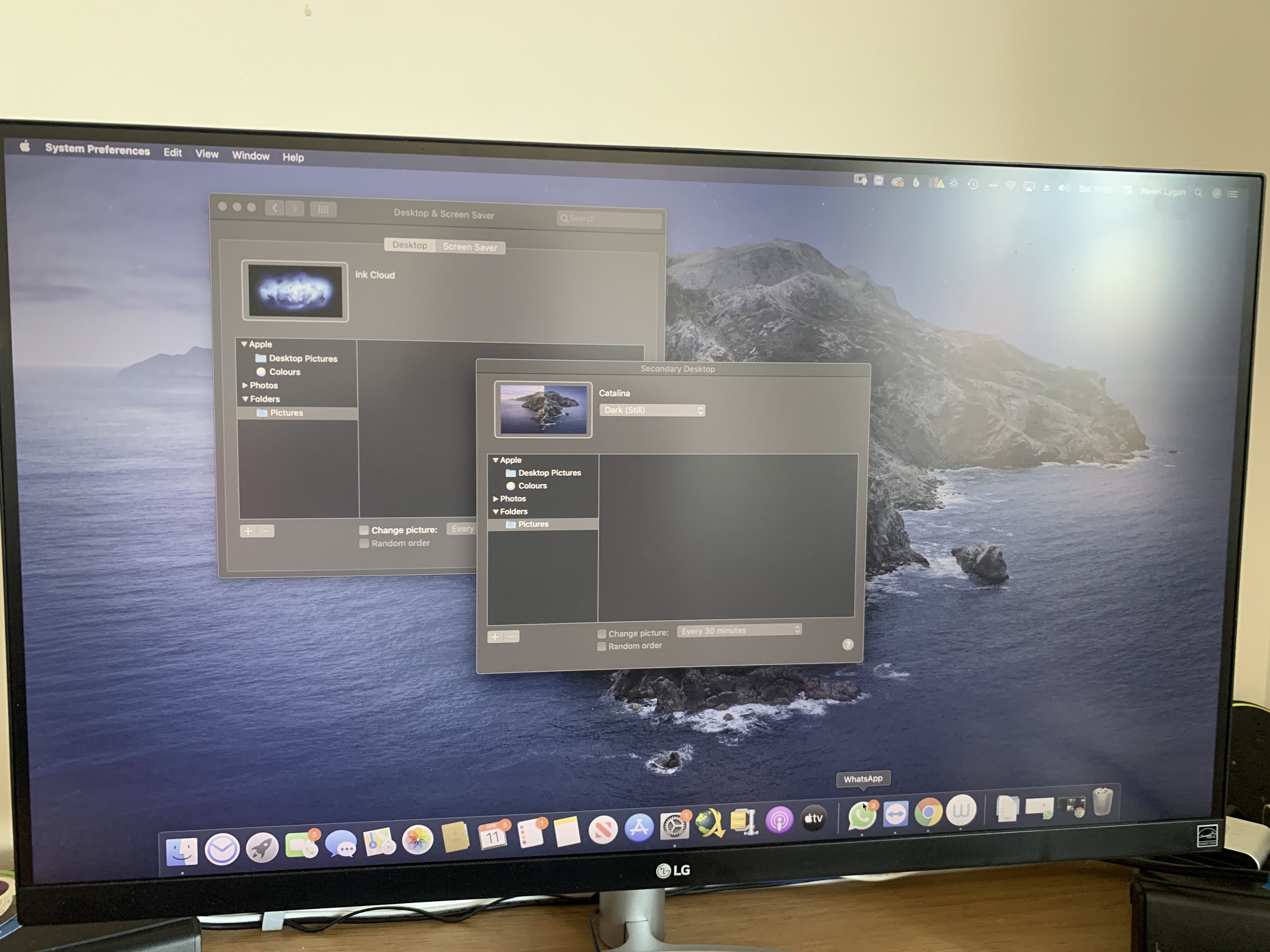

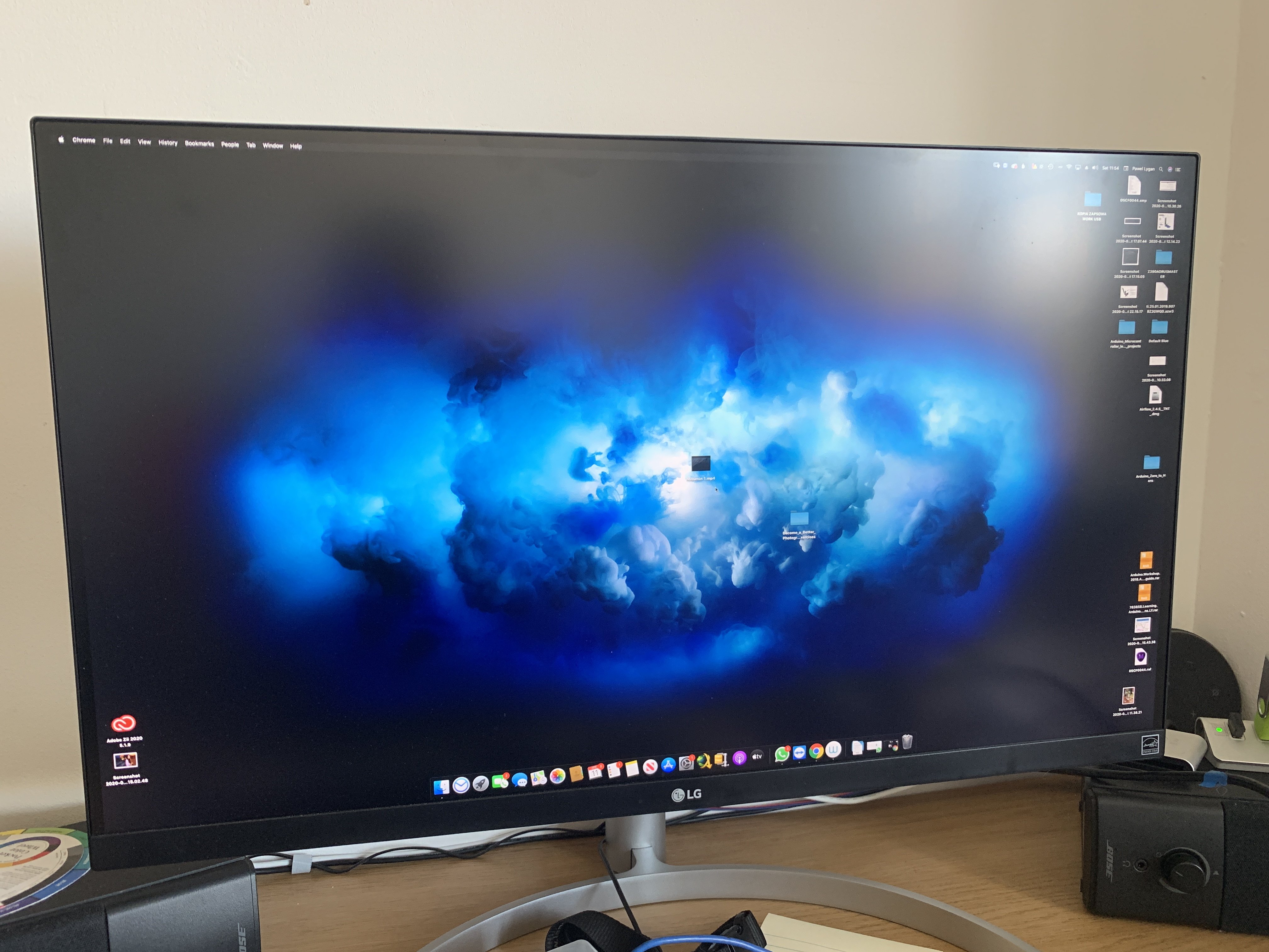

lygi Posted April 11, 2020 Share Posted April 11, 2020 Ok - after few days of testing newest EFI together with BIOS (clean profile without any tweaks), I have some display issues. almost every time I switch on my computer first thing I see is login srenn - before this is NO SIGNAL, sometimes it has no signal at all and have to reset the whole machine. When I simply restart from already booted system - I can see everything from the beginning (post etc) All above is when only DP I connected So I realised, that my machine is selecting my HDMI port first for some reason, so I decided to leave it on HDMI - but here is another problem - when the system is fully loaded, colours are completely OFF (and this is not a profile issue - My screen I calibrated and the right profile is loaded) Problem exists only on OSX and only on HDMI port. Does anyone have something similar? Master + Vega 64 one pic is from DP one is from HDMI Link to comment https://www.insanelymac.com/forum/topic/340936-audiogods-aorus-z390-master-patched-dsdt-efi-for-catalina-mini-guide-and-discussion/page/33/#findComment-2716797 Share on other sites More sharing options...
AudioGod Posted April 11, 2020 Author Share Posted April 11, 2020 (edited) @lygi That’s got nothing to do with the bios or the EFI, I would say that’s probably WEG related as that’s the kext in charge of your GPU. have you tried rolling WEG back to 1.3.7 to see if it helps? One other thing a next user noticed and reported on here is that MacOS hates colour profiles for monitors and they tend to cause all sorts of problems when used so to see if this is happening to you too stop using a colour profile made for the monitor and return to apples preset one. This is a Mac problem not a Hack problem. Edited April 11, 2020 by AudioGod 1 Link to comment https://www.insanelymac.com/forum/topic/340936-audiogods-aorus-z390-master-patched-dsdt-efi-for-catalina-mini-guide-and-discussion/page/33/#findComment-2716800 Share on other sites More sharing options...
lygi Posted April 11, 2020 Share Posted April 11, 2020 2 minutes ago, AudioGod said: @lygi That’s got nothing to do with the bios or the EFI, I would say that’s probably WEG related as that’s the kext in charge of your GPU. have you tried rolling WEG back to 1.3.7 to see if it helps? That is weird, as when I load bios defaults I see post screen every time - but when I load your profile the issues are starting. I think Kext has nothing to do as I canst see aorus logo when starting my computer on DP port. I can see it this when the screen is connected to HDMI - but then - colours are off (and at this point IT COULD BE WEG) Let me change next and I will leave it on HDMI. brb Link to comment https://www.insanelymac.com/forum/topic/340936-audiogods-aorus-z390-master-patched-dsdt-efi-for-catalina-mini-guide-and-discussion/page/33/#findComment-2716802 Share on other sites More sharing options...
AudioGod Posted April 11, 2020 Author Share Posted April 11, 2020 (edited) 10 minutes ago, lygi said: That is weird, as when I load bios defaults I see post screen every time - but when I load your profile the issues are starting. I think Kext has nothing to do as I canst see aorus logo when starting my computer on DP port. I can see it this when the screen is connected to HDMI - but then - colours are off (and at this point IT COULD BE WEG) Let me change next and I will leave it on HDMI. brb Ah ok I see I got you now sorry. Change win 8/10 whql to plain old win 8/10 in the bios . still nothing to do with the EFI, it’s actually the GPUs firmware getting it wrong via DisplayPort (my sapphire vega56 was a pig with bios res via a dp too). changing the bios setting above should correct it though. Edited April 11, 2020 by AudioGod Link to comment https://www.insanelymac.com/forum/topic/340936-audiogods-aorus-z390-master-patched-dsdt-efi-for-catalina-mini-guide-and-discussion/page/33/#findComment-2716807 Share on other sites More sharing options...
lygi Posted April 11, 2020 Share Posted April 11, 2020 14 minutes ago, AudioGod said: Ah ok I see I got you now sorry. Change win 8/10 whql to plain old win 8/10 in the bios . still nothing to do with the EFI, it’s actually the GPUs firmware getting it wrong via DisplayPort (my sapphire vega56 was a pig with bios res via a dp too). changing the bios setting above should correct it though. Boom! DP is fixed now With huge ugly aorus on post but I don't mind WEG didn't help for HDMI, but at this point I'm not using it ( I observed tho, when rebooting the system on HDMI with weird colours, there is a screen flick and colours are ok for 5 seconds, and after that computer restarts) Link to comment https://www.insanelymac.com/forum/topic/340936-audiogods-aorus-z390-master-patched-dsdt-efi-for-catalina-mini-guide-and-discussion/page/33/#findComment-2716809 Share on other sites More sharing options...
