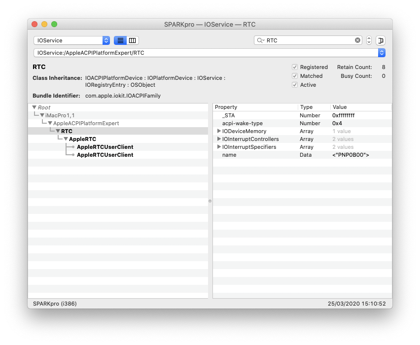

AudioGod Posted March 25, 2020 Author Share Posted March 25, 2020 1 minute ago, darthsian said: On Aorus Master without any of RTC patches there's RTC device with _STA returning 0xF. No need to patch anything, no need to patch RTC via config or SSDT. Ah ok so your running with no Patch and no SSDT? If you read the OC Guide it says to use RTC0 Quote From the Guide: For systems where no STAS shows up but you do have AWAC, you can use SSDT-RTC0 though you will need to check the naming of LPC in your DSDT By default the SSDT uses LPCB, you can check what your system uses by just searching for Name (_ADR, 0x001F0000). This address is used for Low Pin Count devices(LPC) but the device name can vary between LPCB, LBC or LBC0: Thats exactly what my DSDT returns @darthsian Im going to disable the ssdt and keep the patch off and reboot and see what happens right now. 1 Link to comment https://www.insanelymac.com/forum/topic/340936-audiogods-aorus-z390-master-patched-dsdt-efi-for-catalina-mini-guide-and-discussion/page/28/#findComment-2713704 Share on other sites More sharing options...
AudioGod Posted March 25, 2020 Author Share Posted March 25, 2020 (edited) ok well yes I can boot with no SSDT or Patch done on the RTC. I must check a few things to make sure there's no errors under the hood but its looking good. Thanks for that @darthsian, Thats extremely helpful of you Edited March 25, 2020 by AudioGod 1 Link to comment https://www.insanelymac.com/forum/topic/340936-audiogods-aorus-z390-master-patched-dsdt-efi-for-catalina-mini-guide-and-discussion/page/28/#findComment-2713706 Share on other sites More sharing options...
darthsian Posted March 25, 2020 Share Posted March 25, 2020 (edited) 1 hour ago, AudioGod said: Ah ok so your running with no Patch and no SSDT? If you read the OC Guide it says to use RTC0 Quote From the Guide: For systems where no STAS shows up but you do have AWAC, you can use SSDT-RTC0 though you will need to check the naming of LPC in your DSDT By default the SSDT uses LPCB, you can check what your system uses by just searching for Name (_ADR, 0x001F0000). This address is used for Low Pin Count devices(LPC) but the device name can vary between LPCB, LBC or LBC0: Thats exactly what my DSDT returns @darthsian Im going to disable the ssdt and keep the patch off and reboot and see what happens right now. In OC guide they write you can, but it is needed only if RTC device returning 0 from _STA status method. But on Aorus Master and i think on Aorus Pro too, we have 0xF returning from _STA status. And no AWAC in original DSDT of course... so we dont need fix RTC at all. Edited March 25, 2020 by darthsian Link to comment https://www.insanelymac.com/forum/topic/340936-audiogods-aorus-z390-master-patched-dsdt-efi-for-catalina-mini-guide-and-discussion/page/28/#findComment-2713722 Share on other sites More sharing options...
AudioGod Posted March 25, 2020 Author Share Posted March 25, 2020 Just now, darthsian said: In OC guide they write you can, but it is needed only if RTC device returning 0 from _STA status method. But on Aorus Master and i think on Aorus Pro too, we have 0xF returning from _STA status. And no AWAC in original DSDT of course. We have found a few RTC errors in the logs just now so I’m not so sure at this point. Il tell you more soon but it might be needed after all. Link to comment https://www.insanelymac.com/forum/topic/340936-audiogods-aorus-z390-master-patched-dsdt-efi-for-catalina-mini-guide-and-discussion/page/28/#findComment-2713723 Share on other sites More sharing options...
darthsian Posted March 25, 2020 Share Posted March 25, 2020 4 minutes ago, AudioGod said: We have found a few RTC errors in the logs just now so I’m not so sure at this point. Il tell you more soon but it might be needed after all. What RTC errors have you found in the log? I can check it on my side. Link to comment https://www.insanelymac.com/forum/topic/340936-audiogods-aorus-z390-master-patched-dsdt-efi-for-catalina-mini-guide-and-discussion/page/28/#findComment-2713725 Share on other sites More sharing options...
AudioGod Posted March 25, 2020 Author Share Posted March 25, 2020 (edited) 3 minutes ago, darthsian said: What RTC errors have you found in the log? I can check it on my side. @Matgen84 found them so he has the screen shots. Il be in front of my hack again soon to double check on my side. just look through your boot logs and check your clean. And put macOS into verbose mode and see what’s happening on boot up. Edited March 25, 2020 by AudioGod Link to comment https://www.insanelymac.com/forum/topic/340936-audiogods-aorus-z390-master-patched-dsdt-efi-for-catalina-mini-guide-and-discussion/page/28/#findComment-2713727 Share on other sites More sharing options...
darthsian Posted March 25, 2020 Share Posted March 25, 2020 (edited) 14 minutes ago, AudioGod said: @Matgen84 found them so he has the screen shots. Il be in front of my hack again soon to double check on my side. just look through your boot logs and check your clean. And put macOS into verbose mode and see what’s happening on boot up. I just check my kernel log and there is no error related to RTC. Im using last commit of OpenCore 0.5.7. and "No DSDT". Edited March 25, 2020 by darthsian Link to comment https://www.insanelymac.com/forum/topic/340936-audiogods-aorus-z390-master-patched-dsdt-efi-for-catalina-mini-guide-and-discussion/page/28/#findComment-2713733 Share on other sites More sharing options...
AudioGod Posted March 25, 2020 Author Share Posted March 25, 2020 Just now, darthsian said: I just check my kernel log and there is no error related to RTC. Im using last commit of OpenCore 0.5.7. As am I, im going to check on my side in a second buddy, il let you know what I see in a sec Link to comment https://www.insanelymac.com/forum/topic/340936-audiogods-aorus-z390-master-patched-dsdt-efi-for-catalina-mini-guide-and-discussion/page/28/#findComment-2713734 Share on other sites More sharing options...

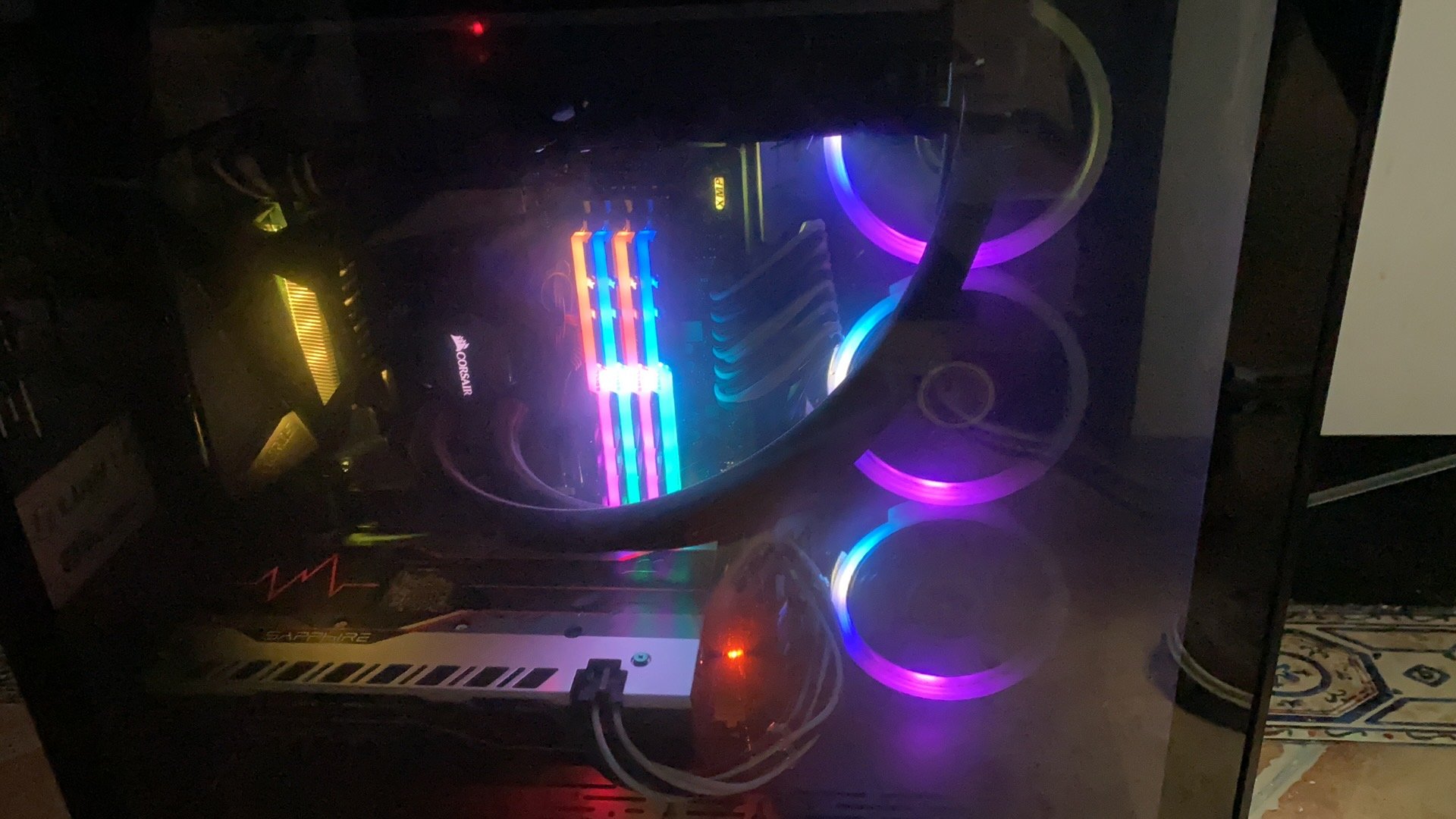

AudioGod Posted March 26, 2020 Author Share Posted March 26, 2020 (edited) 12 minutes ago, ucdosjiafu said: What do you use for cooling? Not a Corsair AIO I have a custom loop I put together myself. On page one of the thread there’s a pic of it. Edited March 26, 2020 by AudioGod 1 Link to comment https://www.insanelymac.com/forum/topic/340936-audiogods-aorus-z390-master-patched-dsdt-efi-for-catalina-mini-guide-and-discussion/page/28/#findComment-2713848 Share on other sites More sharing options...
