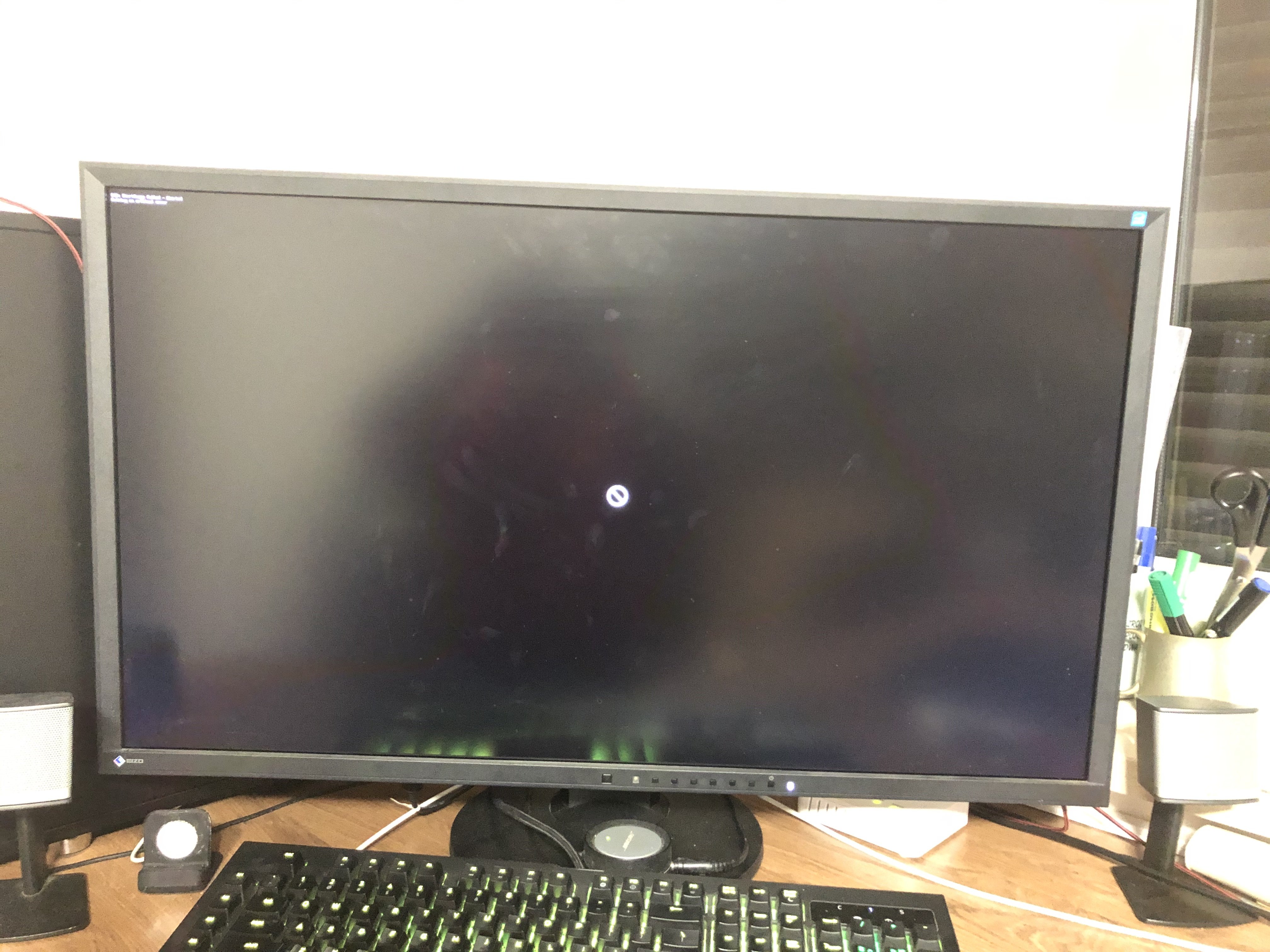

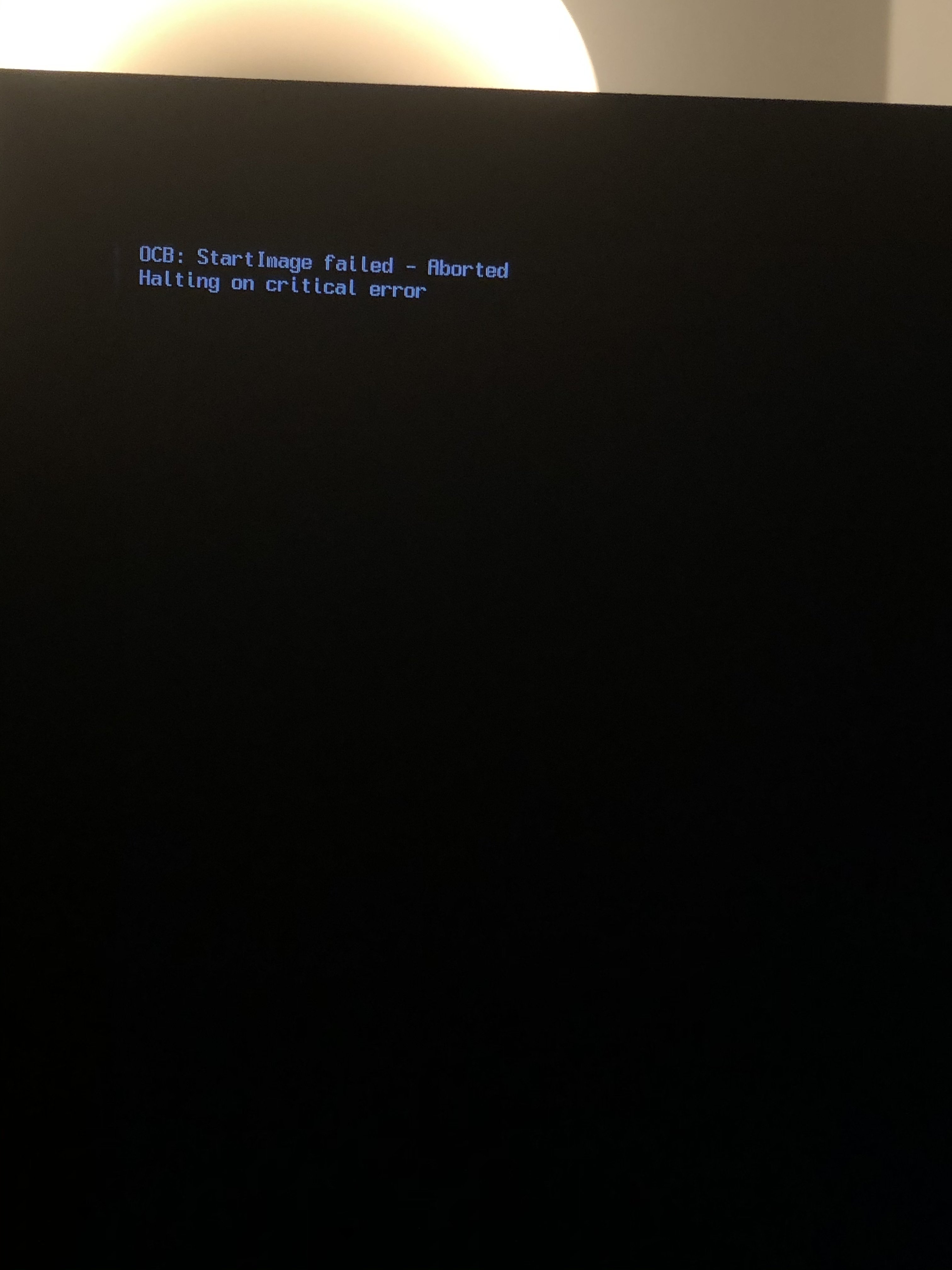

Filip71 Posted April 20, 2020 Share Posted April 20, 2020 (edited) On 4/1/2020 at 9:13 PM, Filip71 said: hi Thank you for the great work and spruce guide. Next to Windows 10 I put Hactkintosh on OpenCore 0.5.6 on my PC (Catalina 10.15.4) with files from AudioGod's "AG OpenCore 056 Z390 Master EFI 040320.zip" on another disk and I encountered a problem that requires your help because I don't know what to do next . The computer started up immediately, most of the things I was able to check worked (except FileVault), however, after a few hours of work, I restarted and after selecting "MacOs Catalina" from the Boot menu, an apple appeared for a few seconds and then the message "OCB: StartImage failed - Aborted. Halting on critical error "and black screen. In addition to Windows, I could only run the Boot menu option - Recovery. I did the installation again - the computer worked 1.5 days (with several reboots and running Windows 10) and the situation repeated, In AudioGod's config.plist, I only entered serial numbers in the platforminfo and I introduced 3840x2160 resolution in UEFI-Output-Resolution. The rest unchanged. My computer - specification: - Gigabyte Aorus Master Z390 - Intel i9-9900K - Sapphire Radeon XR 5700 XT - Samsung 970 EVO Plus 1 Tb SSD (only for MacOs) - 32 Gb Ram HyperX Fury 3600 Mhz - WiFi with OSX WIFI Apple Broadcom BCM943602CDP - Noctua NH-D15 cooling - Eizo EV3237 4K monitor In addition, the "F11c MSR Unlocked Profile" works on the motherboard, however, I did not complete point 6 of MSR placement because it was about Clover and I do not know if the motherboard is unlocked (probably not). What could be the problem - I would like to ask for feedback and thank you in advance for your help. Edited April 1 by Filip71 Hi. I was waiting for OpenCire 0.5.7 and installed Catalina 10.15.4 EFI AudioGood without any problems. Hactintosh has been in operation for 2 days and the problem reappeared as described earlier, ie "Unable to start and message as before" "OCB: StartImage failed - Aborted. Halting on critical error ". I did a reset on MB before installation and never tried to upload Clover. CFG is unlocked and MB is Bios 11c I don't know what to do next because the configuration is similar to many of you where everything works or any problems can be repaired. In addition, I do not understand this error and why it occurs after a few days of installation where all elements of the system worked. What do you advise - wait for the next version of OpenCore or just do the installation on Clover? I don't know if Clover will also have this problem? Thank you in advance for your advice and answers Edited April 20, 2020 by Filip71 Link to comment https://www.insanelymac.com/forum/topic/340936-audiogods-aorus-z390-master-patched-dsdt-efi-for-catalina-mini-guide-and-discussion/page/35/#findComment-2718429 Share on other sites More sharing options...
DarkMan2003 Posted April 21, 2020 Share Posted April 21, 2020 On 4/20/2020 at 7:16 PM, Filip71 said: Hi. I was waiting for OpenCire 0.5.7 and installed Catalina 10.15.4 EFI AudioGood without any problems. Hactintosh has been in operation for 2 days and the problem reappeared as described earlier, ie "Unable to start and message as before" "OCB: StartImage failed - Aborted. Halting on critical error ". I did a reset on MB before installation and never tried to upload Clover. CFG is unlocked and MB is Bios 11c I don't know what to do next because the configuration is similar to many of you where everything works or any problems can be repaired. In addition, I do not understand this error and why it occurs after a few days of installation where all elements of the system worked. What do you advise - wait for the next version of OpenCore or just do the installation on Clover? I don't know if Clover will also have this problem? Thank you in advance for your advice and answers I had same problem. I reset bios with button in backplate, then i restore settings with config file from AdioGod. Link to comment https://www.insanelymac.com/forum/topic/340936-audiogods-aorus-z390-master-patched-dsdt-efi-for-catalina-mini-guide-and-discussion/page/35/#findComment-2718651 Share on other sites More sharing options...
photom Posted April 21, 2020 Share Posted April 21, 2020 One thing that made a huge difference for me is to turn the computer OFF completely → remove the BIOS battery → wait 10 -15 minutes and then put it back in. BEFORE INSTALLING MACOS. Link to comment https://www.insanelymac.com/forum/topic/340936-audiogods-aorus-z390-master-patched-dsdt-efi-for-catalina-mini-guide-and-discussion/page/35/#findComment-2718655 Share on other sites More sharing options...
Filip71 Posted April 21, 2020 Share Posted April 21, 2020 (edited) 1 hour ago, DarkMan2003 said: I had same problem. I reset bios with button in backplate, then i restore settings with config file from AdioGod. Thank you for the advice - I'll try. Does it fix the problem permanently or do you have it from time to time? 1 hour ago, photom said: One thing that made a huge difference for me is to turn the computer OFF completely → remove the BIOS battery → wait 10 -15 minutes and then put it back in. BEFORE INSTALLING MACOS. I did so before installing MacOS Edited April 21, 2020 by Filip71 Link to comment https://www.insanelymac.com/forum/topic/340936-audiogods-aorus-z390-master-patched-dsdt-efi-for-catalina-mini-guide-and-discussion/page/35/#findComment-2718666 Share on other sites More sharing options...

DarkMan2003 Posted April 22, 2020 Share Posted April 22, 2020 7 hours ago, Filip71 said: Thank you for the advice - I'll try. Does it fix the problem permanently or do you have it from time to time? I did so before installing MacOS I had it few times. Not sure, but I think it was after I use windows. Also I found that after resetting bios and restoring the config, I should make other configs in one time, as a avx, voltage and etc. before I choose save and exit. Otherwise I had same problem if I do it separately. Link to comment https://www.insanelymac.com/forum/topic/340936-audiogods-aorus-z390-master-patched-dsdt-efi-for-catalina-mini-guide-and-discussion/page/35/#findComment-2718725 Share on other sites More sharing options...
Filip71 Posted April 22, 2020 Share Posted April 22, 2020 (edited) 7 hours ago, DarkMan2003 said: I had it few times. Not sure, but I think it was after I use windows. Also I found that after resetting bios and restoring the config, I should make other configs in one time, as a avx, voltage and etc. before I choose save and exit. Otherwise I had same problem if I do it separately. Cooool !! Thanks for the advice - after resetting Bios and uploading the "F11c unlocked" settings, MacOs has started. So the culprit is Bios and settings / or their changes. I will try on your advice to explore the subject of corrections in avx and Voltage. I will add that I got this error twice after using "restart MacOs" Once again, many thanks for the advice - now at least I know where to look for a mistake Edited April 22, 2020 by Filip71 Link to comment https://www.insanelymac.com/forum/topic/340936-audiogods-aorus-z390-master-patched-dsdt-efi-for-catalina-mini-guide-and-discussion/page/35/#findComment-2718765 Share on other sites More sharing options...

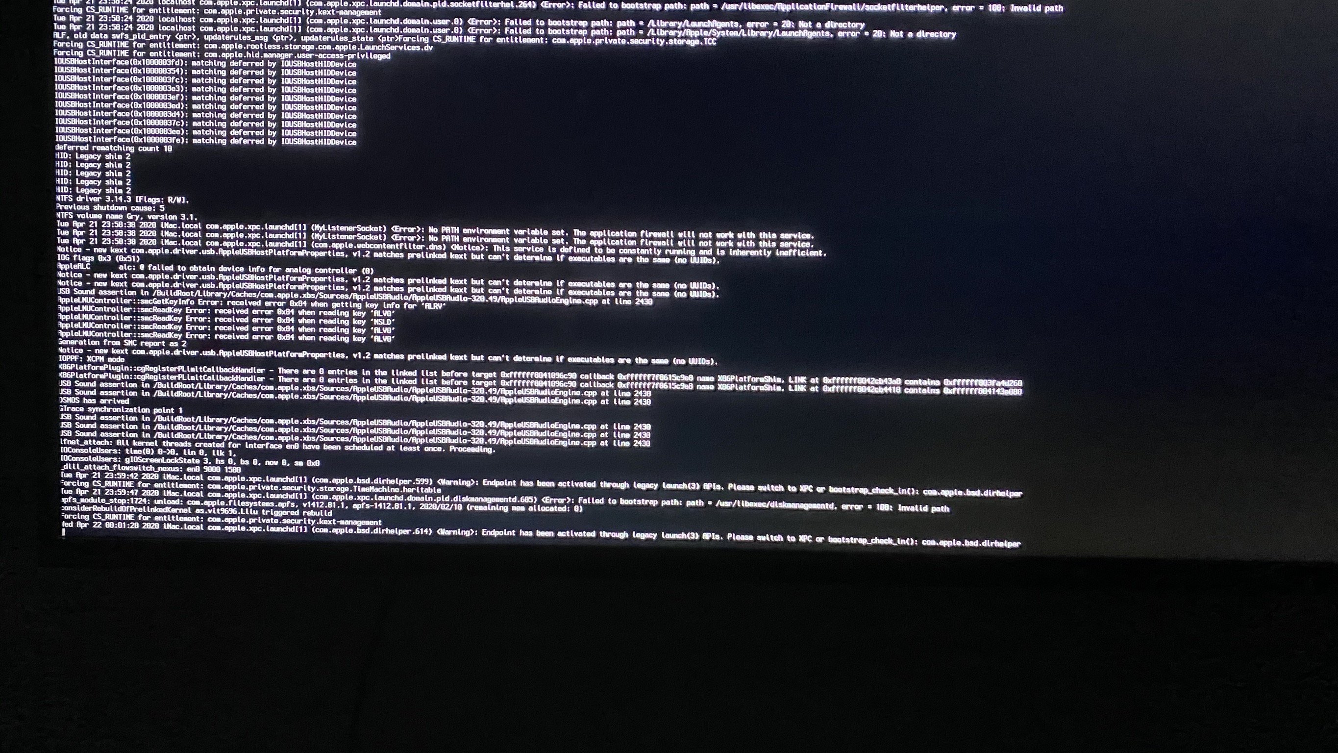

mark3p Posted April 29, 2020 Share Posted April 29, 2020 Hi @AudioGod, firstly thanks for the guide, it's been really helpful in explaining a lot with regards to how this setup all works. I've successfully had a Mojave install with Clover bootloader running on my Aorus Z390 Master with a 9900k and Saphire RX580 with no issues. Trying to do a clean install of Catalina with OpenCore using the 19,1 opencore EFI on a blank Samsung 970 EVO NVME and can boot into the installer with no issues. However when I select the drive to install Catalina to (which I have tried formatting as HFS and APFS) and then click install, the install macOS Catalina app closes and chucks me back to the macOS utilities screen. Have tried multiple USB ports on the board but still the same result and can't seem to figure it out! I wondered if this was something you've come across? Link to comment https://www.insanelymac.com/forum/topic/340936-audiogods-aorus-z390-master-patched-dsdt-efi-for-catalina-mini-guide-and-discussion/page/35/#findComment-2720027 Share on other sites More sharing options...
AudioGod Posted April 29, 2020 Author Share Posted April 29, 2020 (edited) 29 minutes ago, mark3p said: Hi @AudioGod, firstly thanks for the guide, it's been really helpful in explaining a lot with regards to how this setup all works. I've successfully had a Mojave install with Clover bootloader running on my Aorus Z390 Master with a 9900k and Saphire RX580 with no issues. Trying to do a clean install of Catalina with OpenCore using the 19,1 opencore EFI on a blank Samsung 970 EVO NVME and can boot into the installer with no issues. However when I select the drive to install Catalina to (which I have tried formatting as HFS and APFS) and then click install, the install macOS Catalina app closes and chucks me back to the macOS utilities screen. Have tried multiple USB ports on the board but still the same result and can't seem to figure it out! I wondered if this was something you've come across? No never heard of that one before, that new. remove all drives apart from the NVMe you want to use to install too and try again buddy. make sure your using my MSR Unlocked profile and the correct firmware revision and if you don’t want to unlock your MSR using my profile then make sure your using my bios settings as per page one and Change the oc config to work with a locked MSR. also make sure you clear your nvram. this has nothing to do with usb by the sound of it. Very strange. Edited April 29, 2020 by AudioGod Link to comment https://www.insanelymac.com/forum/topic/340936-audiogods-aorus-z390-master-patched-dsdt-efi-for-catalina-mini-guide-and-discussion/page/35/#findComment-2720034 Share on other sites More sharing options...
mark3p Posted April 29, 2020 Share Posted April 29, 2020 6 minutes ago, AudioGod said: No never heard of that one before, that new. remove all drives apart from the NVMe you want to use to install too and try again buddy. make sure your using my MSR Unlocked profile and the correct firmware revision and if you don’t want to unlock your MSR using my profile then make sure your using my bios settings as per page one and Chang the oc config to work with a locked MSR. also make sure you clear your nvram. this has nothing to do with usb by the sound of it. Very strange. Yup, using your MSR unlock profile and have it saved in my bios profiles. Haven't tweaked anything else or restored my overclock yet either as wanted to follow 100%. All other drives removed as didn't want to kill my Mojave or windows. Just tried with Clover and it's doing the same there so it's not OpenCore related. One thing I did note is the current Catalina 10.15.4 installer pulled down from Apple on a legit macbook is huge, 8.4gb on the USB (had to use a 16gb to get around that). I'm trying using gibMacOS to make an installer now, see if it gets it back to the 8gb stick. Link to comment https://www.insanelymac.com/forum/topic/340936-audiogods-aorus-z390-master-patched-dsdt-efi-for-catalina-mini-guide-and-discussion/page/35/#findComment-2720038 Share on other sites More sharing options...
AudioGod Posted April 29, 2020 Author Share Posted April 29, 2020 (edited) 5 minutes ago, mark3p said: Yup, using your MSR unlock profile and have it saved in my bios profiles. Haven't tweaked anything else or restored my overclock yet either as wanted to follow 100%. All other drives removed as didn't want to kill my Mojave or windows. Just tried with Clover and it's doing the same there so it's not OpenCore related. One thing I did note is the current Catalina 10.15.4 installer pulled down from Apple on a legit macbook is huge, 8.4gb on the USB (had to use a 16gb to get around that). I'm trying using gibMacOS to make an installer now, see if it gets it back to the 8gb stick. No it’s not Oc or EFI related I knew that straight away as 2000+ downloads of this months version has had very little problems Efi regardless and most the problems that have come up have been due to the user not the EFI. pull the battery from your board with no power connected and wait a few mins, put it all back together and try again. Just incase there’s somthing nasty remaining in the cmos that a nvram reset can’t clear. ah ok, download Catalina from the App Store, don’t get it from anywhere else. Big mistake that is bud. Edited April 29, 2020 by AudioGod Link to comment https://www.insanelymac.com/forum/topic/340936-audiogods-aorus-z390-master-patched-dsdt-efi-for-catalina-mini-guide-and-discussion/page/35/#findComment-2720039 Share on other sites More sharing options...
kapelan6 Posted April 29, 2020 Share Posted April 29, 2020 Look carefully at the settings in the BIOS, do everything as on the first page. With such equipment, you should not have problems. 1 Link to comment https://www.insanelymac.com/forum/topic/340936-audiogods-aorus-z390-master-patched-dsdt-efi-for-catalina-mini-guide-and-discussion/page/35/#findComment-2720043 Share on other sites More sharing options...
