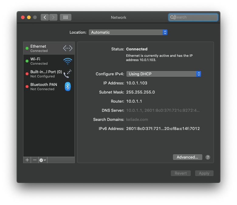

25 minutes ago, Squirrelf said:
thanks for looking into it !
USBPorts.kext.zip
I see what the problem is already.
if you look at your device list in networks your spot a device called built in ... port and that right there is the issue, it’s a serial port built into the board and it’s not compatible with macOS and causes all sorts of trouble and audio playback being messed with is one of them. there’s no option in the bios to disable it until now in the latest betas. I Can’t 100% say for sure that they have added the option on your boards latest bios but I’m betting they have.
Here give it a try.
Z390 AORUS Ultra - F10c
https://www.mediafire.com/file/i4bzrcevp74y3ve/Z390AORUSULTRA.F10c/file

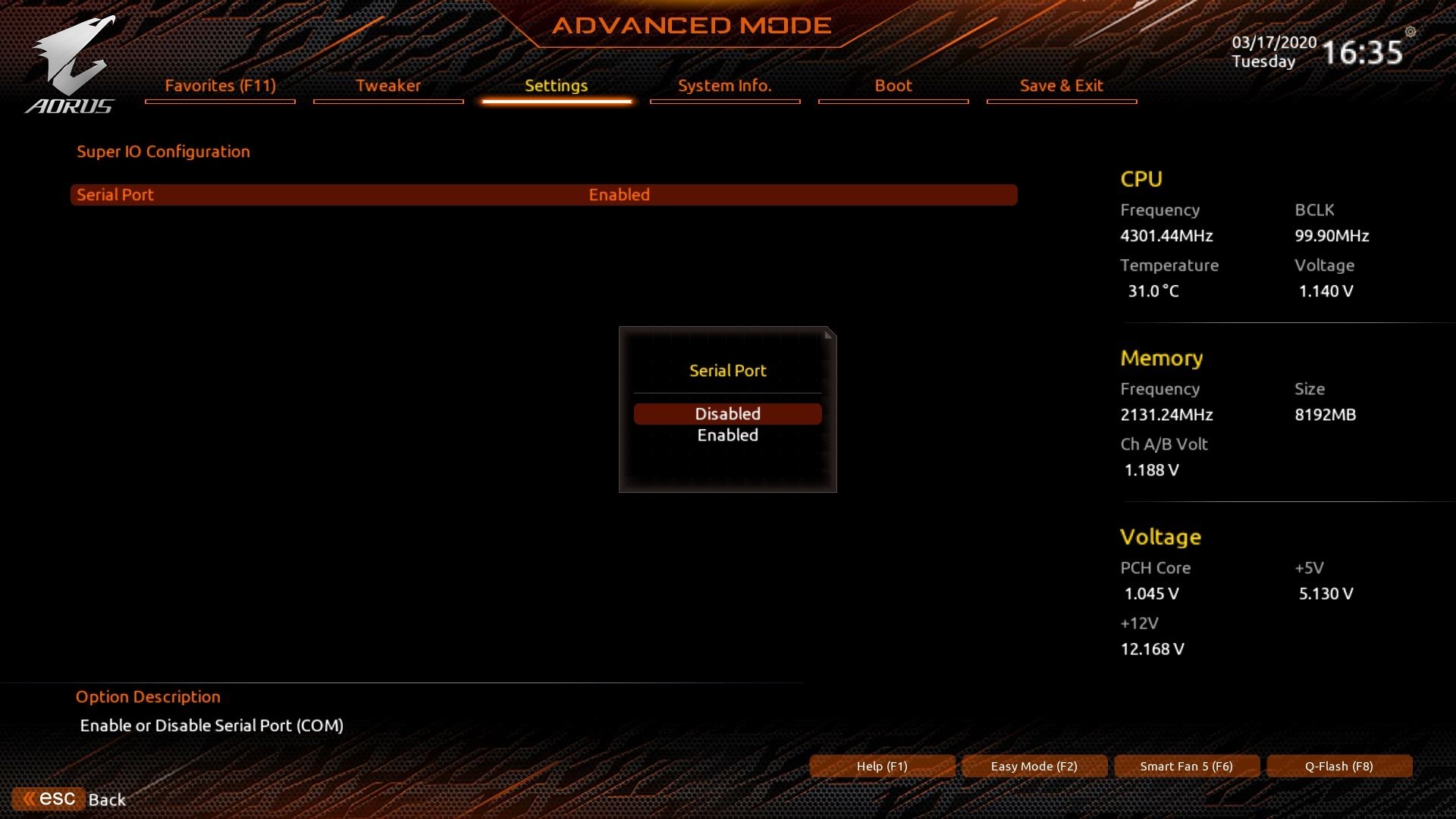

Your looking for this page and disable like so
Once its disabled in the bios it will still show up in the network menu but no longer active but you can simply remove it from there and it will be gone for good
Give that a try and I’m going to take a quick look at your usb.kext now for you.
@Squirrelf I corrected your USB.kext for you. You made two mistakes,
1. HS12 was active and this is actually not a port used for port assignment so I have removed it for you. (HS13 is the internal header and its a hub and the two ports both share HS13)
2. HS13 had the wrong power tables assigned to it so I have corrected that as well.
Here you go fella, :thumbsup_anim:
Here give it a try.
thank you,  I'll try that right away
Edited by Squirrelf
8 minutes ago, AudioGod said:
Good Luck, and use the corrected USB.Kext I posted for you too. :)
 It worked thank you so very much
even the Apple Watch unlock worked again
crazy that such a small thing did so much damage, though understandable
Out of curiosity how did you initially disable serial com when the bios didn't have the option ?

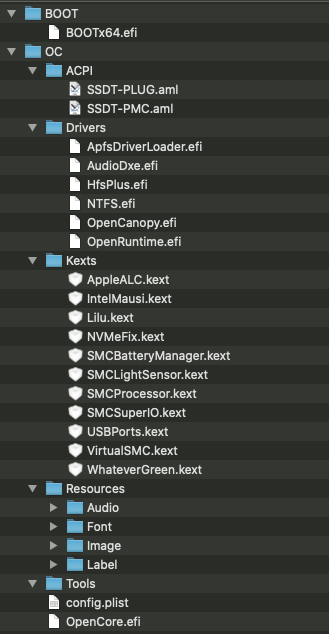

P.s. drop 2 kexts from your kexts folder and detach them from the oc config.plist.
SMCBatteryManager and SMCLightSnsor. Not needed or used in your setup.
You shouldn’t need nvmefix.kext either, why you using it?
Edited by AudioGod

thought the nvme fix was to better support nvme drives ? I have a WD sn750 black
