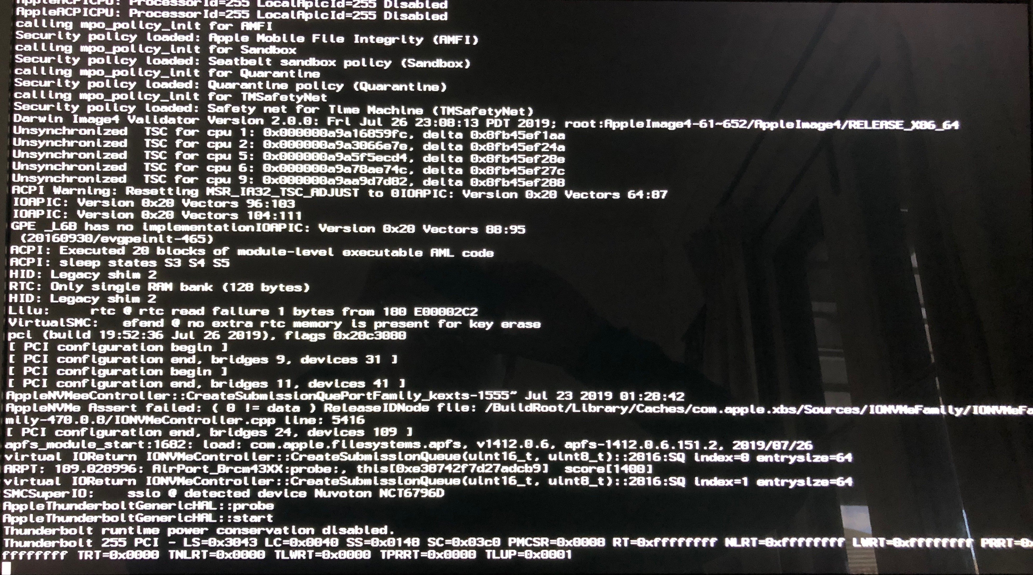

Anyone able to update through SU? I can't boot the installer; it just hangs ...
I updated it without any problems.
Weird VirtualSMC message you're getting there there. Also it hangs right on apfs load. I'd do a clover version and drivers check.

Guest ricoc90
Did already. Also tried with FakeSMC, apfs.efi instead of ApfsDriverLoader.efi but same issue regardless

Do you have also the VirtualSMC.efi in the drivers folder, alongside with VirtualSMC.kext in kexts folder?
https://github.com/acidanthera/VirtualSMC/tree/master/EfiDriver
Guest ricoc90
No, since AFAIk that's only needed if you're using FileVault which I'm not:
Quote
VirtualSMC.efi module is recommended for boot.efi compatibility when FileVault 2 is enabled.
Anyway, the VirtualSMC error is gone now, seemed to be a one-time error. The boot process is still stuck at the same spot though
Edit: Just to be sure I did add VirtualSMC.efi but no difference

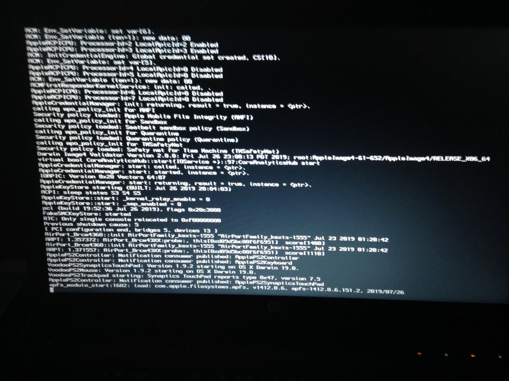

Edit2: I've compared a successfull boot of DP4 with the boot of DP5 and they're identical except that DP5 stops at:
apfs_module_start:1682: load: com.apple.filesystem.apfs, v1412.0.6, apfs-1412.0.6.151.2, 20/07/26
On DP4, the first line AFTER the above is:
AppleUSBLegacyRoot@:AppleUSBLegacyRoot::init: enabling legacy matching
before it continues booting.
If anyone has an idea, please shoot.

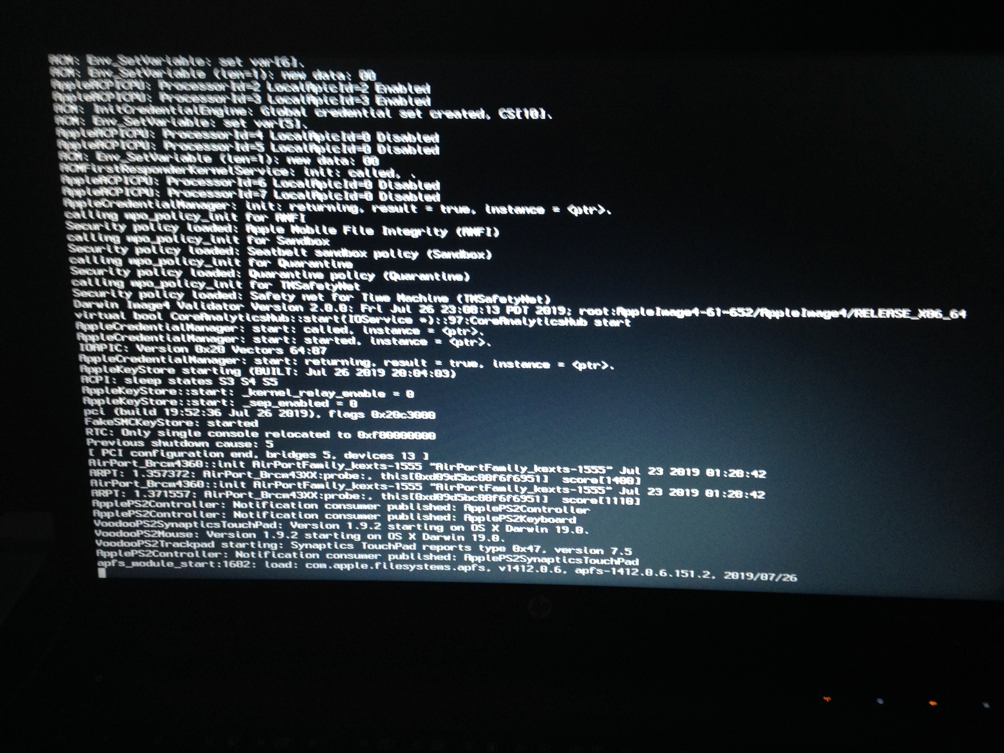

My HP ProBook 6570B stop at the same exact spot of you
Try boot with out kext , with ou DSDT, change apfs.efi     NO GO !
I never see an issue like this with this laptop
Problème now look relate to laptop :worried_anim:

For reference for those of us unable to boot the beta 5 installer, here is where my setup hangs:
