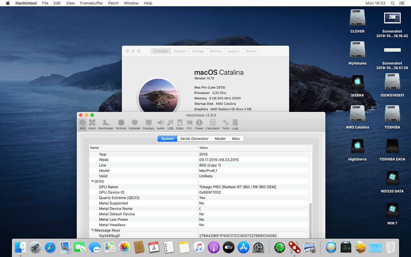

NMZI Posted November 4, 2019 Share Posted November 4, 2019 Hi! A lot of time passed idle, mojave didn't work for me but the cube turned, Catalina brought a change, working on FX 8300! I am very happy, I am grateful to those who made this possible! Great job! Thank you very much! The system works fine, only the metal is missing. I'm using 0x665C1002 fake id for r7 360 + RadeonDeInit, edit info.plist in AMD8000Controller.kext and AMDRadeonX4000.kext. I do not use the inject ati option because it restarts after IOConsoleUsers or only starts in safe mode. 1 Link to comment Share on other sites More sharing options...

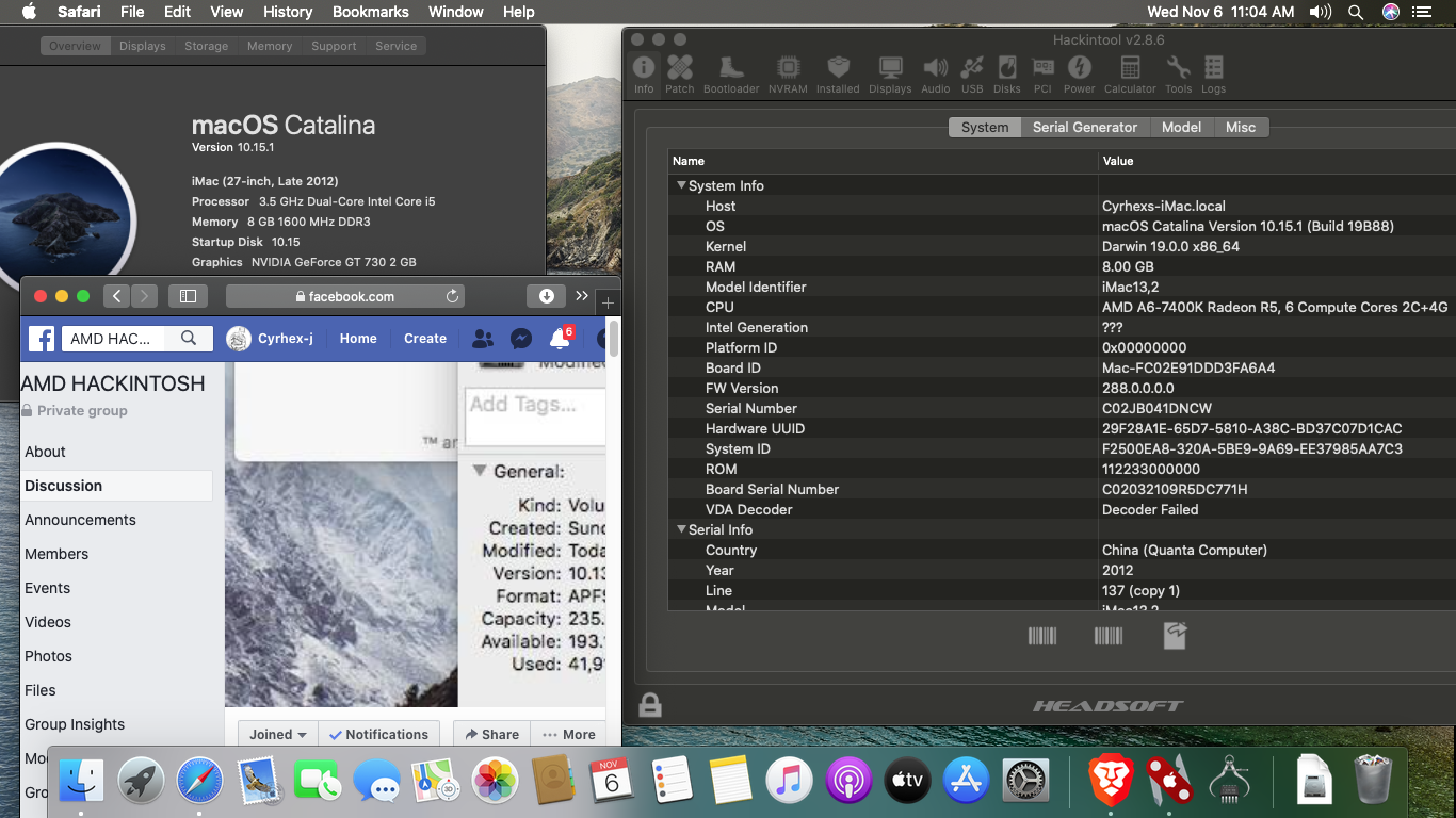

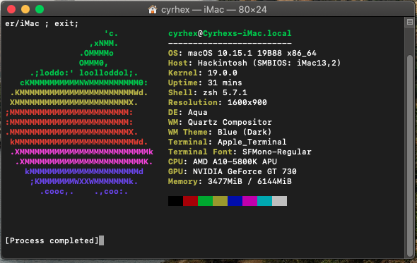

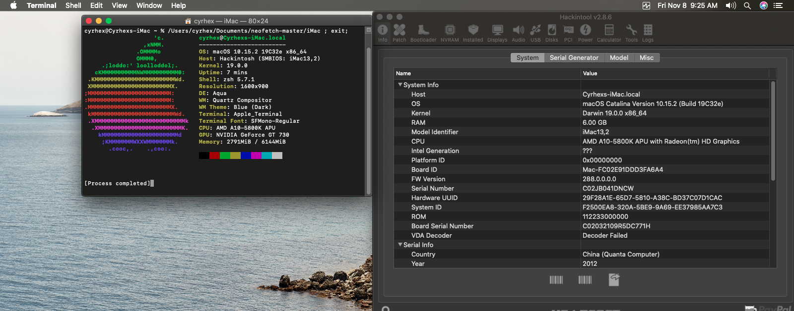

cyrhex Posted November 6, 2019 Share Posted November 6, 2019 open core bootloader,thnx to algrey,xlnc,shanee,,and to the developer of opencore team Link to comment Share on other sites More sharing options...
cyrhex Posted November 6, 2019 Share Posted November 6, 2019 amd a10 5800k Link to comment Share on other sites More sharing options...
jsl2000 Posted November 6, 2019 Share Posted November 6, 2019 On 11/1/2019 at 2:26 PM, iAstroboyid said: for AMD Ryzen 9 3900x with Asus TUF 5700 XT Unfortunately this patch did not work by Clover r.5097 at 10.15.1 in my Ryzen 1700X hackintosh. Only OpenCore 0.5.0's kernel patch worked for me. Link to comment Share on other sites More sharing options...
cyrhex Posted November 8, 2019 Share Posted November 8, 2019 done updating to 10.15.2 beta without no issues 1 Link to comment Share on other sites More sharing options...

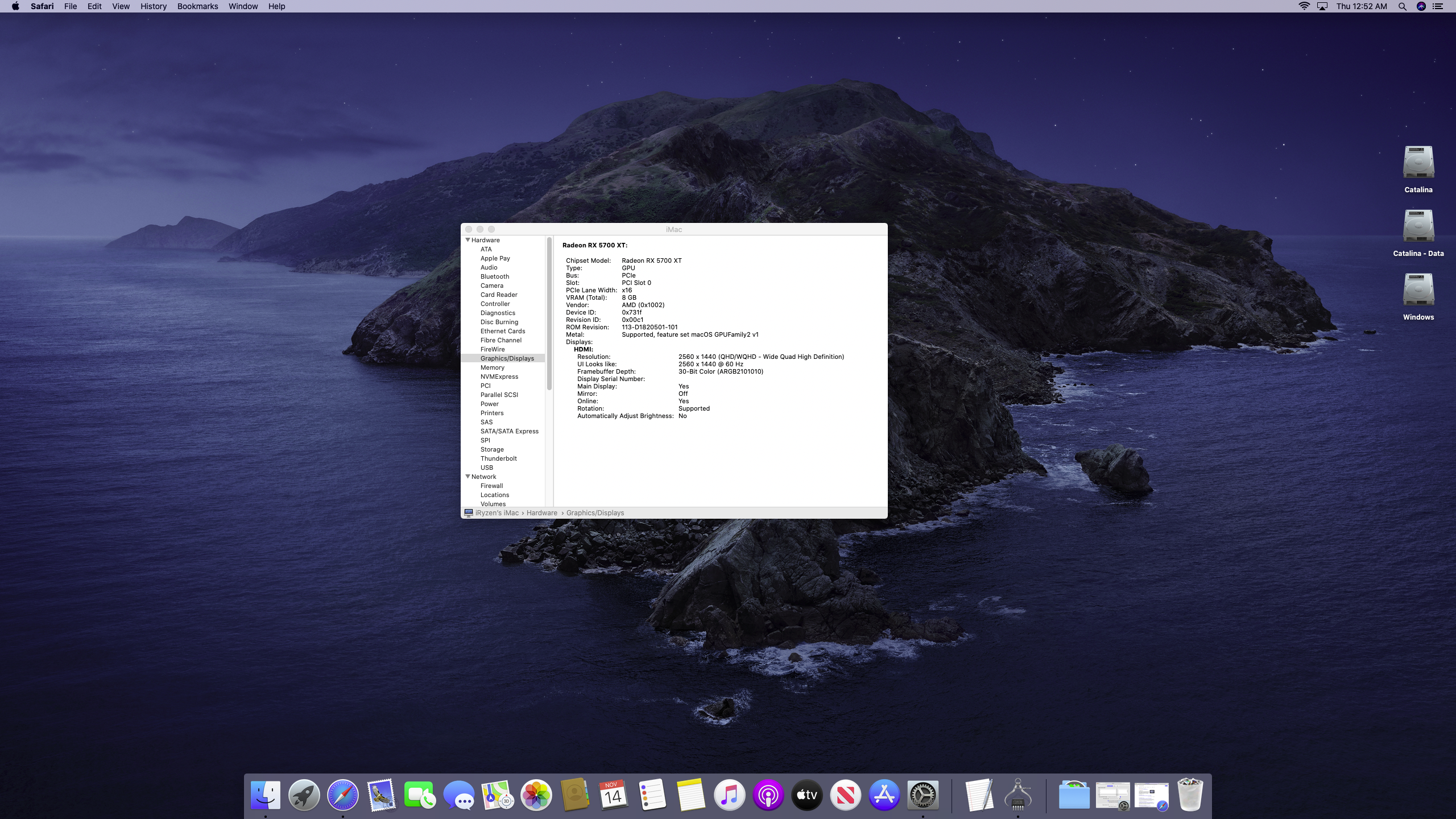

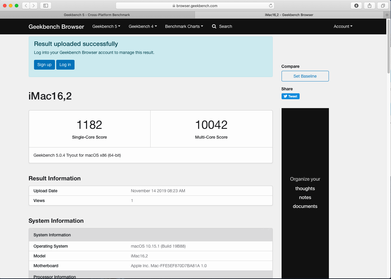

iAstroboyid Posted November 15, 2019 Share Posted November 15, 2019 (edited) Thank you XLNC for maintaining patches. The new 10.15.1 Patch work with Clover_v2.5k_r5098. 5700 Xt works great with new WhateverGreen.kext. have to use agdpmod=pikera avoid black screen. Edited November 15, 2019 by iAstroboyid Link to comment Share on other sites More sharing options...

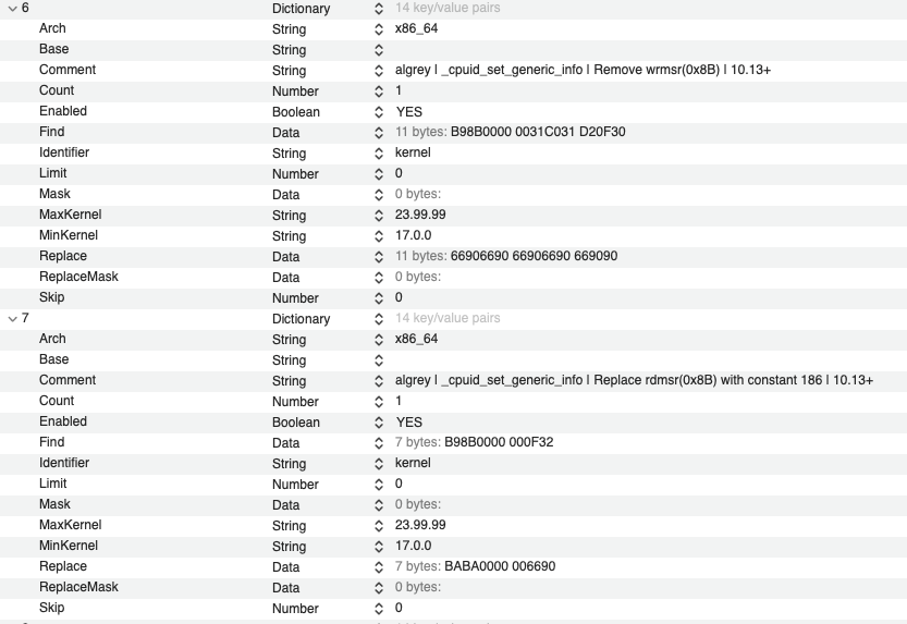

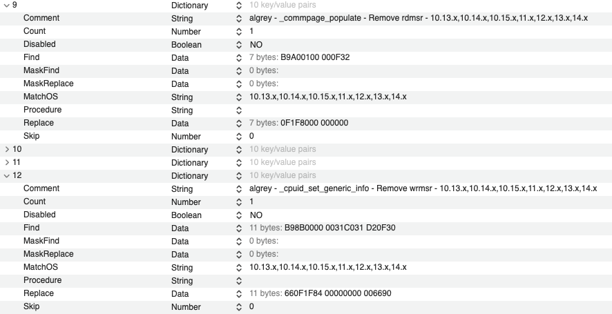

jsl2000 Posted January 28 Share Posted January 28 (edited) On 7/12/2023 at 9:39 AM, jalavoui said: patches from here seem quite fine https://github.com/AMD-OSX/AMD_Vanilla Thanks and I have two questions: 1. For these two patches to remove rdmsr & wrmsr is it the same for both FX-6300 and Ryzen 1700X CPUs ? 2. Which are the correct patches at Monterey/Ventura/Sonoma ? The first from OpenCore and the second from Clover : Edited January 28 by jsl2000 Link to comment Share on other sites More sharing options...
