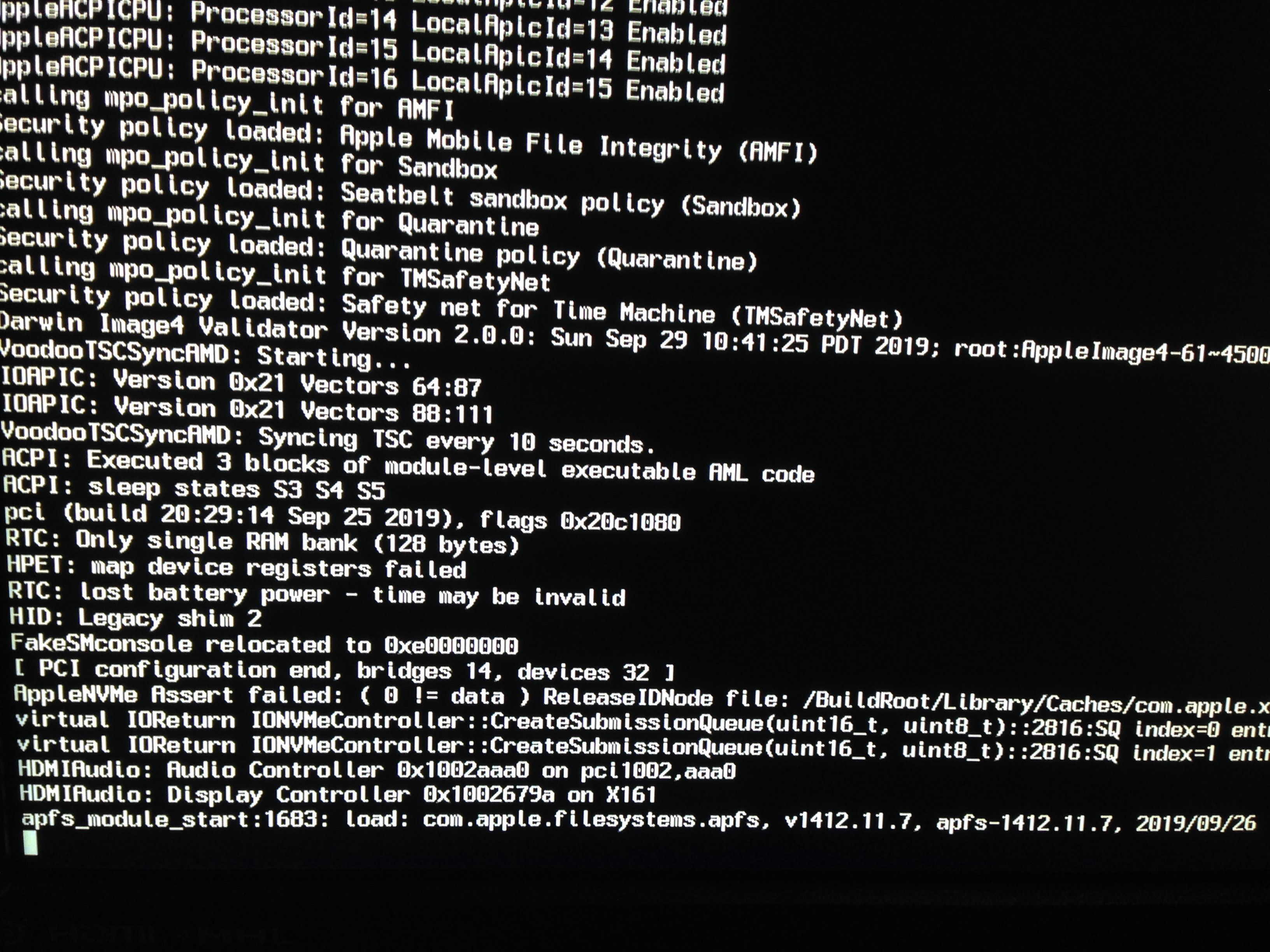

Thanks for this wonderful kernel patching config.plist for Clover at 10.15.0 which worked perfectly in my FX-6300 hackintosh, but always got frozen during booting after loading of apfs as shown here:
How to fix it ?
No such an issue at 10.13.6 and 10.14.6
It seems one patch for My Ryzen 1700X still not worked yet.
Can anyone confirm this patch for Ryzen CPU working at 10.15.0 ?
[Solved]
1. The specific patches of kernel at 10.15.0 created by XLNC are more correct and compatible to both FX-6300 and Ryzen 1700X hackintoshes.
2. After adding SSDT-EC0.aml and AppleMCEReporterDisabler.kext (not essential for FX-6300 hackintosh) properly it can work in Ryzen 1700X hackintosh now !
3. Big thanks for XLNC again, without your excellent patches my Ryzen 1700X can not work by Clover r5095. OpenCore not working in my hackintoshes yet.

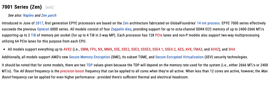

I want to  build Nas server.
Any AMD server CPU support AMD vanilla?
Ex
  • AMD EPYC™ 7002 and 7001 series processor family
Ex
I thing its possible please confirm @Shaneee
Thank you.
https://en.wikichip.org/wiki/amd/epyc
Edited by nmano

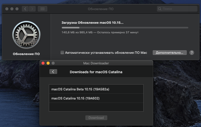

Any update for 10.15 (19A602) ?
[Solved]
The same patches still work after update.
