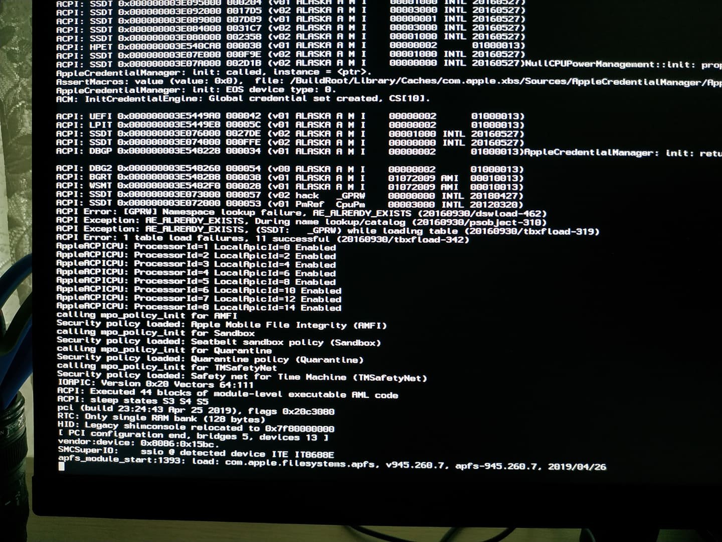

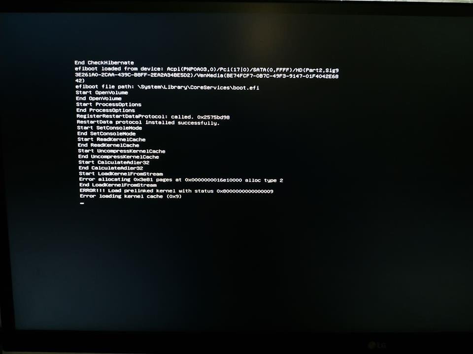

Hello,
First of all thanks a lot for this big tutorial !
however, I got a "big" issue. Everything was fine, I was at the end (on macOS, etc) and I have installed the wifi card. The wifi card work, I was able to use my magic keyboard & mouse.
I start to follow the steps to be able to use iMessage. After updated the list with Clover Configurator I rebooted my hackintosh and now it's stuck everytime at :
"apfs_module_start:1393: load: com.apple.filesystems.apfs, v945.260.7, apfs-945.260.7, 2019/04/26
I saw online that the bios for the motherboard should be an issue. But I tried with the F7, F8 and F9 ! Nothing works...
I setup and setup again de bios as mentioned in the topic just to be sure.
I also try to reset the list to the one that work just before (I made a copy). Still the same.
I confirm that I can boot for my original boot drive with the clover install and go to my macOS session.
But I can't boot from my main drive now...
Please, if any help, it would be awesome :)

8 hours ago, AntoineWill said:
Hello,
What are your full  system specifications, and can you attach your EFI folder.

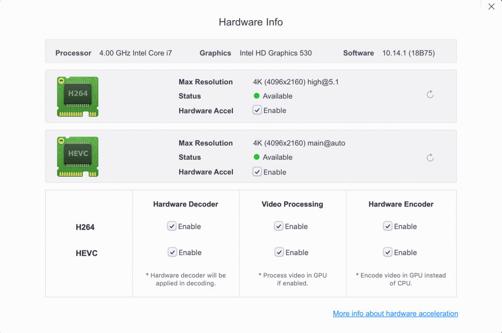

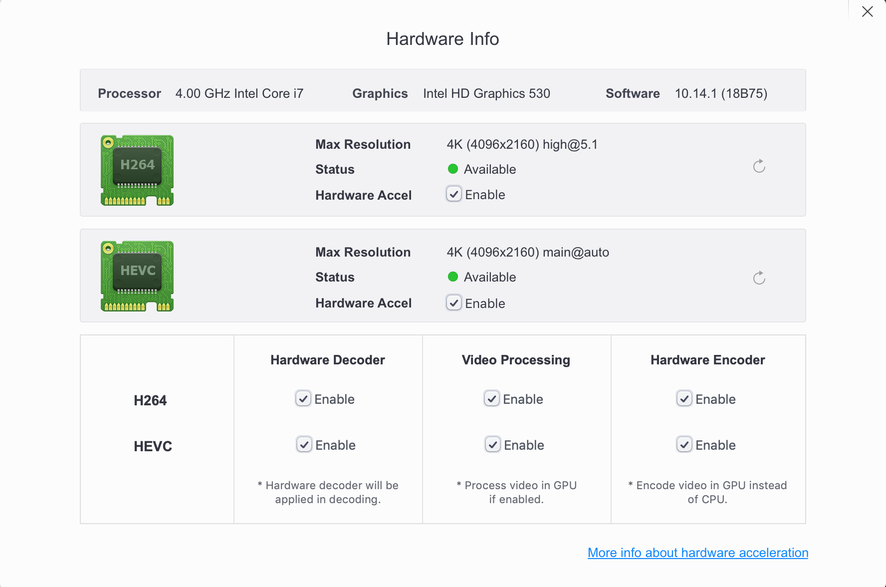

Hello, I try to make sure that hardware acceleration is working fine, I saw many other members posting a screenshot of an app "Hardware Info" which looks like this:
593567181_ScreenShot2018-11-11at7_08_59PM.png.98ad9c2a91cc15e02fb6955c9af53ab9.thumb.png.91b77281ec564a3bcb87716d18b43630.png
But I can't find the app that produces that info, could you point me to a URL? I searched in this forum, in google, reverse image search in google, but I could not find which app is that :/
Thanks!
Thanks!
Application is ==> VideoProc

I successfully installed Mojave 10.14.5 but I have a lot of problems.
1 - First I could not open pictures - do not ask me how, but I fixed it
2 - Almost every time I have a start up problem "stop in the darkness" I use an entire bag of spells to go. Restart and adjust bios or I use it as a last resort USB flash efi.
3 - I have a problem with shutdown too
I have been running for weeks on the Internet for a solution and try almost everything and naturally things get worse.. :(
If anyone helps I will be very grateful. I can provide remote access through TeamViewer.
I do not quite understand enough or I'm just stupid..
If I would have even paid for the help
Okay, this board sounds very familiar. Just kidding. I had the exact motherboard and has successfully used Glasgood EFI folder for it.
First: Use Glasgood install EFI, do not use the post installation EFI because his configuration is for Z390 Aorus Pro which has completely different devices and board layout.
Second: If you cannot open a photo file using preview or quick view, I assume it's a JPEG photo. That means your iGPU doesn't work properly. You will need to enter the right device info in the Device properties. Search this post, you will see the right device ID for 9700K / 9900K iGPU and where to put that. Glasgood is using a 8700K in his guide, so the iGPU device ID is different from 9700K.  The install EFI uses a lot of universal patches on the fly that may break in the future Mac OS update, but it works for a lot of the Z390 boards.
Third: Problem with shutdown means ACPI settings are wrong. Try Glasgood install EFI and it should work perfectly.
Keep us posted if you're still having problems after try my method.
