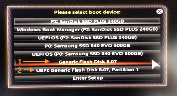

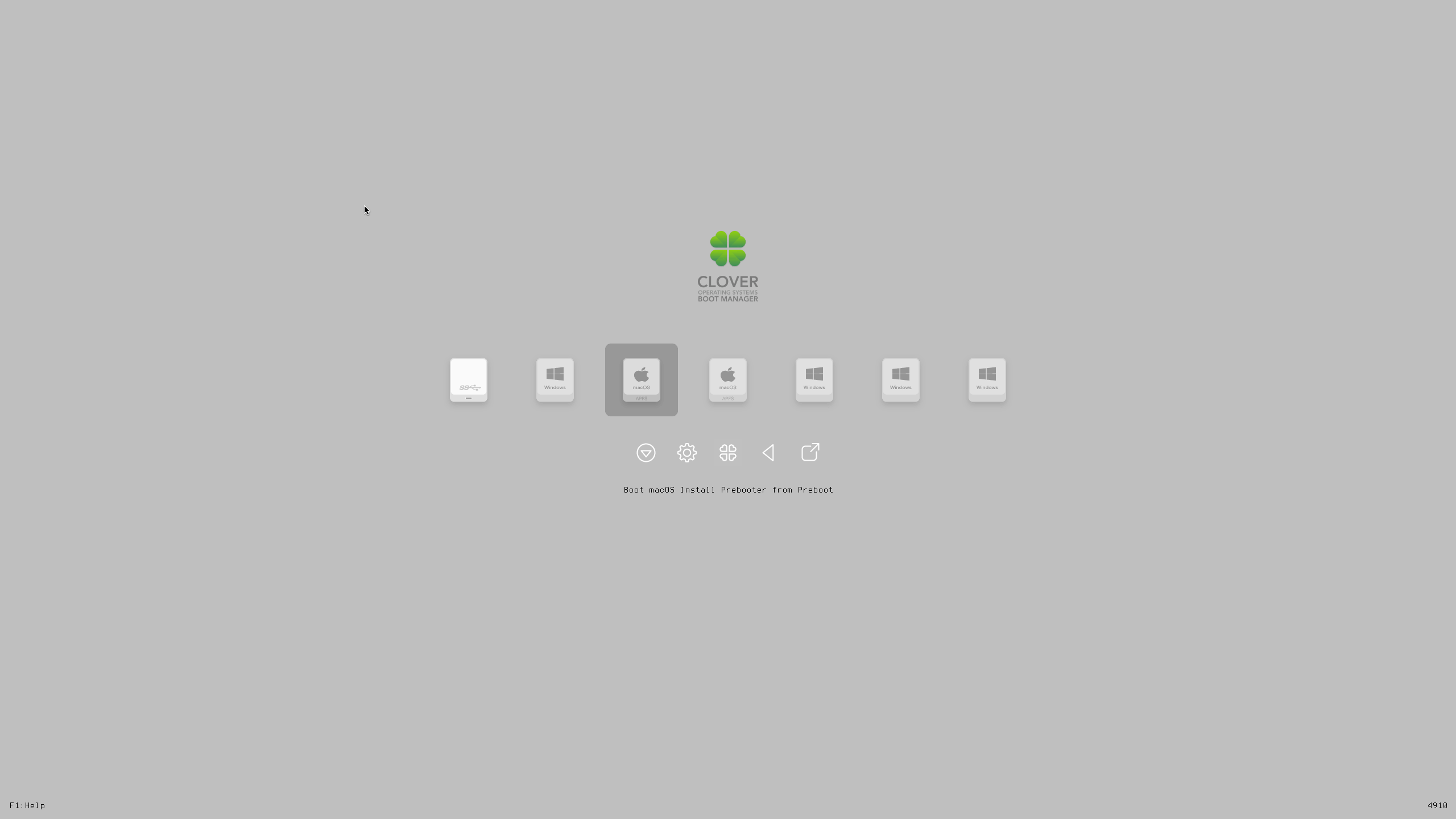

bleedingstar Posted June 20, 2019 Share Posted June 20, 2019 12 hours ago, glasgood said: Hi, On the USB installer there are two partitions, one partition with macOS Majave installer and second with Clover EFI boot image, you want to ensure you choose the partition on USB that starts with UEFI: (No 2 in screen shot below ) for instance, choosing the wrong partition, example Generic Flash Disk 8.07 on the USB installer will result in the Aorus logo appearing: followed by a redirect back to boot menu, as per below. Selecting UEFI: partition you would arrive at Clover boot Screen: USB 3.0 installer should work, did you try alternative USB ports. Please ensure you create USB installer as per this guide and it will work, double check that you placed the EFI folder inside the EFI partition. Thank you for the speedy reply. I tried both the usb as the efi of the usb, both got me back in to the boot select screen. The first fix that got me closer was changing my smbios to iMac 19.1, I assumed that would fit my system better as I have an i9900k and a Vega-56. The result then was that selecting the efi got me a strange green 3/D clover screen but every option there led me to the no parking sign. The next thing I tried was add a Vega 56 kext from a different build guide, switched virtualsmc with fakesmc and tried again. Its booting now, and although I haven't had the time to test everything at least the ssd speeds are finally as they should be! Link to comment https://www.insanelymac.com/forum/topic/337837-glasgoods-macos-mojave-successguide-for-aorus-z390-pro/page/27/#findComment-2678409 Share on other sites More sharing options...

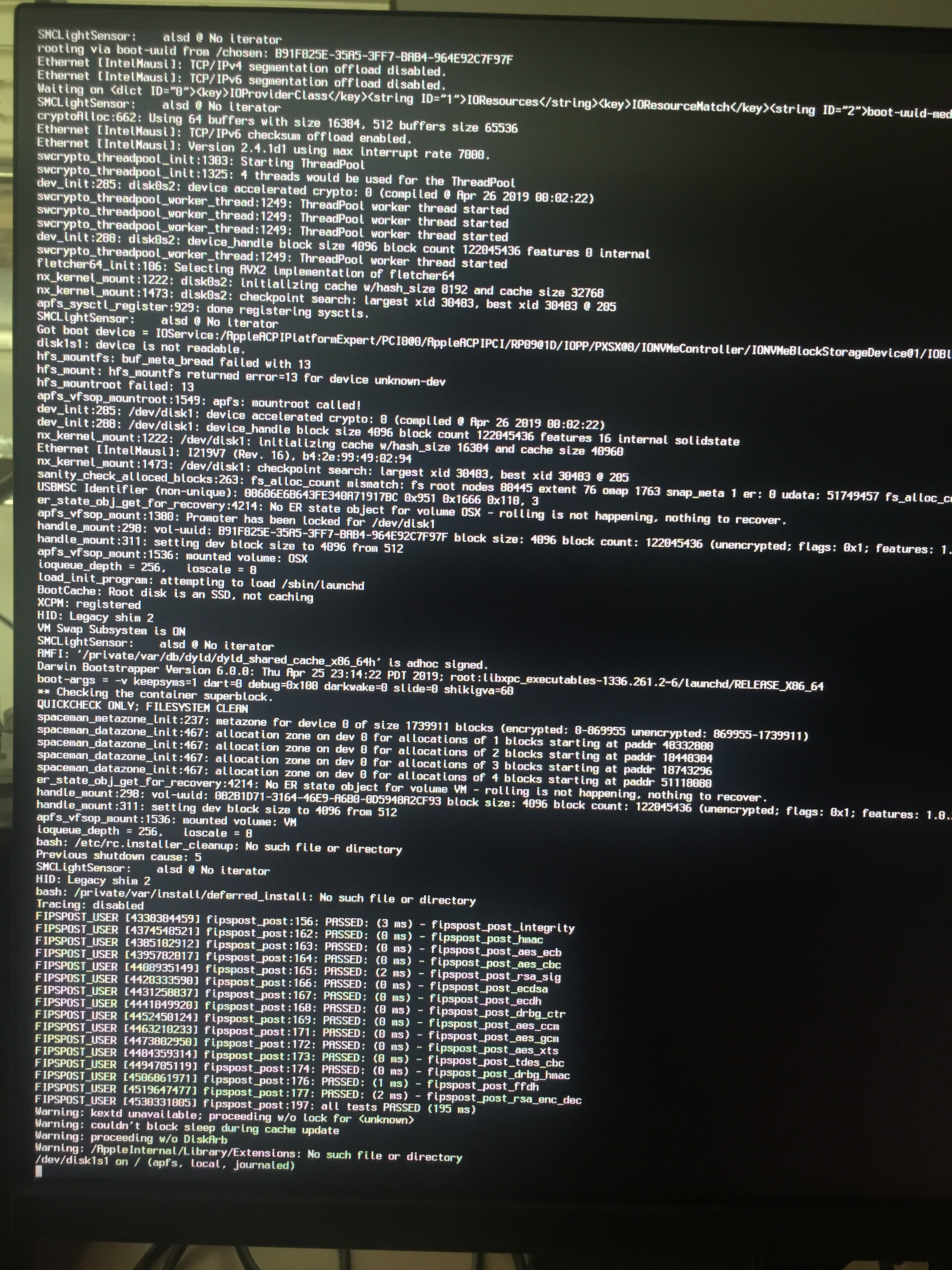

glasgood Posted June 20, 2019 Author Share Posted June 20, 2019 31 minutes ago, bleedingstar said: Thank you for the speedy reply. I tried both the usb as the efi of the usb, both got me back in to the boot select screen. The first fix that got me closer was changing my smbios to iMac 19.1, I assumed that would fit my system better as I have an i9900k and a Vega-56. The result then was that selecting the efi got me a strange green 3/D clover screen but every option there led me to the no parking sign. The next thing I tried was add a Vega 56 kext from a different build guide, switched virtualsmc with fakesmc and tried again. Its booting now, and although I haven't had the time to test everything at least the ssd speeds are finally as they should be! Can you attach your EFI folder. Link to comment https://www.insanelymac.com/forum/topic/337837-glasgoods-macos-mojave-successguide-for-aorus-z390-pro/page/27/#findComment-2678414 Share on other sites More sharing options...

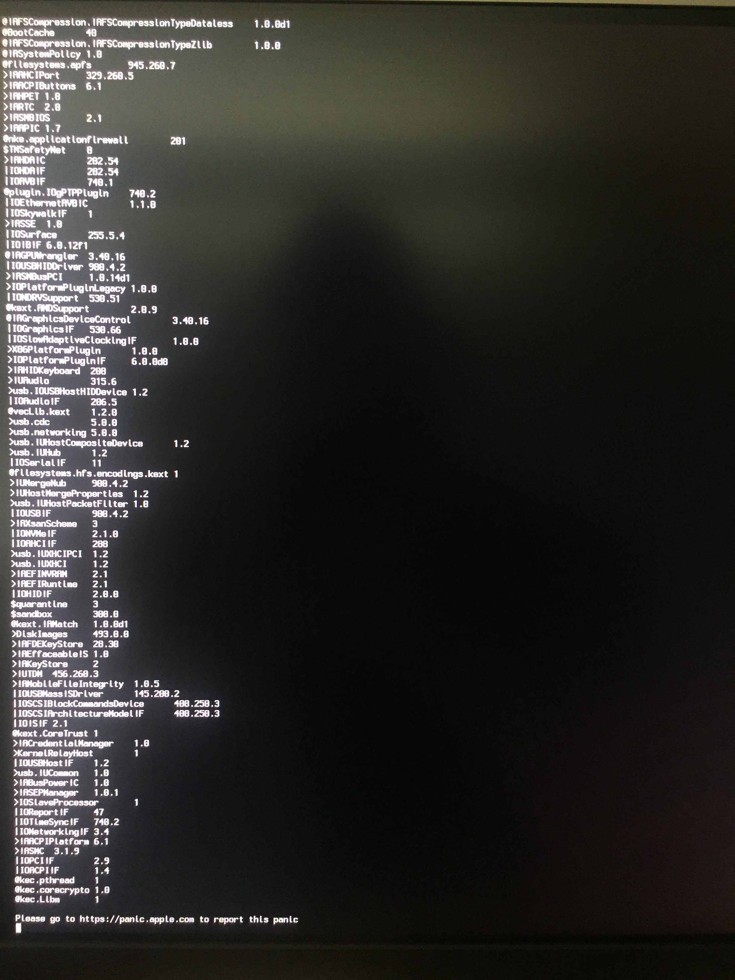

glasgood Posted June 20, 2019 Author Share Posted June 20, 2019 6 minutes ago, bleedingstar said: Nope, doesn't work. It starts again as soon as I revert the EFI to the pre-install version. When you arrived at the kernel panic below: Did you attempt a second boot ? Link to comment https://www.insanelymac.com/forum/topic/337837-glasgoods-macos-mojave-successguide-for-aorus-z390-pro/page/27/#findComment-2678434 Share on other sites More sharing options...
bleedingstar Posted June 20, 2019 Share Posted June 20, 2019 (edited) 15 minutes ago, glasgood said: When you arrived at the kernel panic below: Did you attempt a second boot ? I didn't remember so I reverted back to your AMD Post-efi and rebooted. Worked on the first boot. Restarted to see if it would work the second time and I got the panic again. Tried a third time and It worked again. Very strange EDIT: Chose restart (don't reopen windows) panic again.. EDIT2: After the last reboot it refuses to boot even after restarting several times. Reverted back to pre-install EFI: boots fine Do you have a suspicion why this would be? Edited June 20, 2019 by bleedingstar Link to comment https://www.insanelymac.com/forum/topic/337837-glasgoods-macos-mojave-successguide-for-aorus-z390-pro/page/27/#findComment-2678436 Share on other sites More sharing options...
glasgood Posted June 20, 2019 Author Share Posted June 20, 2019 (edited) 30 minutes ago, bleedingstar said: I didn't remember so I reverted back to your AMD Post-efi and rebooted. Worked on the first boot. Restarted to see if it would work the second time and I got the panic again. Tried a third time and It worked again. Very strange EDIT: Chose restart (don't reopen windows) panic again.. Do you have a suspicion why this would be? I tested last EFI on my Hack test drive, and it works. Though sometimes, when making large configuration changes it seems that something triggers firmware to cause a panic, but subsequent boots thereafter are normal. Have a look at my latest ==> BIOS settings Edited June 20, 2019 by glasgood Link to comment https://www.insanelymac.com/forum/topic/337837-glasgoods-macos-mojave-successguide-for-aorus-z390-pro/page/27/#findComment-2678439 Share on other sites More sharing options...
