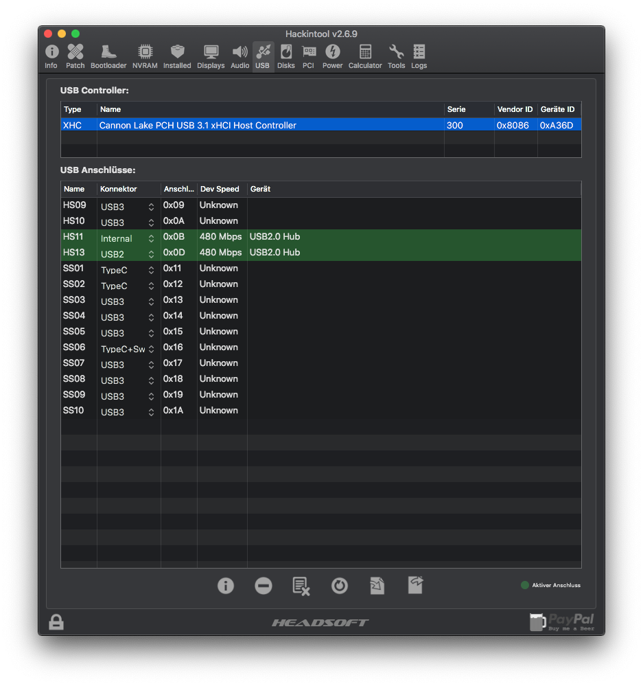

Cipha Posted July 9, 2019 Share Posted July 9, 2019 Ok so the Hackintosh is getting close to perfection. The only thing remaining are the USB ports. On the back only the 4 USB 2 ports are working. Before I start to digg into how to create a ssdt myself this is what hackintool looks like with the "post install rx 580" EFI. Does this look correct? Only two slots active? Link to comment https://www.insanelymac.com/forum/topic/337837-glasgoods-macos-mojave-successguide-for-aorus-z390-pro/page/34/#findComment-2680773 Share on other sites More sharing options...

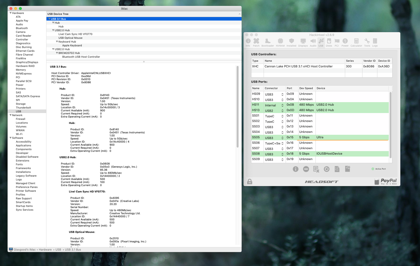

glasgood Posted July 9, 2019 Author Share Posted July 9, 2019 3 hours ago, Cipha said: Ok so the Hackintosh is getting close to perfection. The only thing remaining are the USB ports. On the back only the 4 USB 2 ports are working. Before I start to digg into how to create a ssdt myself this is what hackintool looks like with the "post install rx 580" EFI. Does this look correct? Only two slots active? It working good, if you keep Hackintool open and connect a USB3 storage device to back of motherboard plate, then you will see it register the correct speed. So in this instance I connected my SanDisk Ultra USB device to SS5 and it changed from Unknown to 5Gbps. Link to comment https://www.insanelymac.com/forum/topic/337837-glasgoods-macos-mojave-successguide-for-aorus-z390-pro/page/34/#findComment-2680813 Share on other sites More sharing options...
Cipha Posted July 9, 2019 Share Posted July 9, 2019 Thanks! Just for better understanding. What if I connect a USB 3.0 hub with 2.0 devices connected to it? I would still need a USB 2.0 lane on that port, right? Link to comment https://www.insanelymac.com/forum/topic/337837-glasgoods-macos-mojave-successguide-for-aorus-z390-pro/page/34/#findComment-2680815 Share on other sites More sharing options...

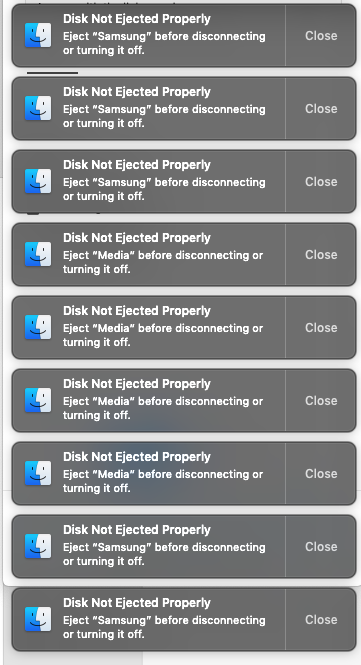

wdopulencia Posted July 10, 2019 Share Posted July 10, 2019 Hi! I have this problem with shutting down or restarting, it wont shutdown or restart unless i force quit every application. Is this normal or is there a fix for this? Thanks! Link to comment https://www.insanelymac.com/forum/topic/337837-glasgoods-macos-mojave-successguide-for-aorus-z390-pro/page/34/#findComment-2680871 Share on other sites More sharing options...
Cipha Posted July 10, 2019 Share Posted July 10, 2019 7 hours ago, panosru said: @glasgood hello again! It seems that it didn't work after all... I left my computer to sleep overnight and in the morning I got: This ia a bug in Mojave. I have exactly the same issue with my original iMac. Link to comment https://www.insanelymac.com/forum/topic/337837-glasgoods-macos-mojave-successguide-for-aorus-z390-pro/page/34/#findComment-2680938 Share on other sites More sharing options...

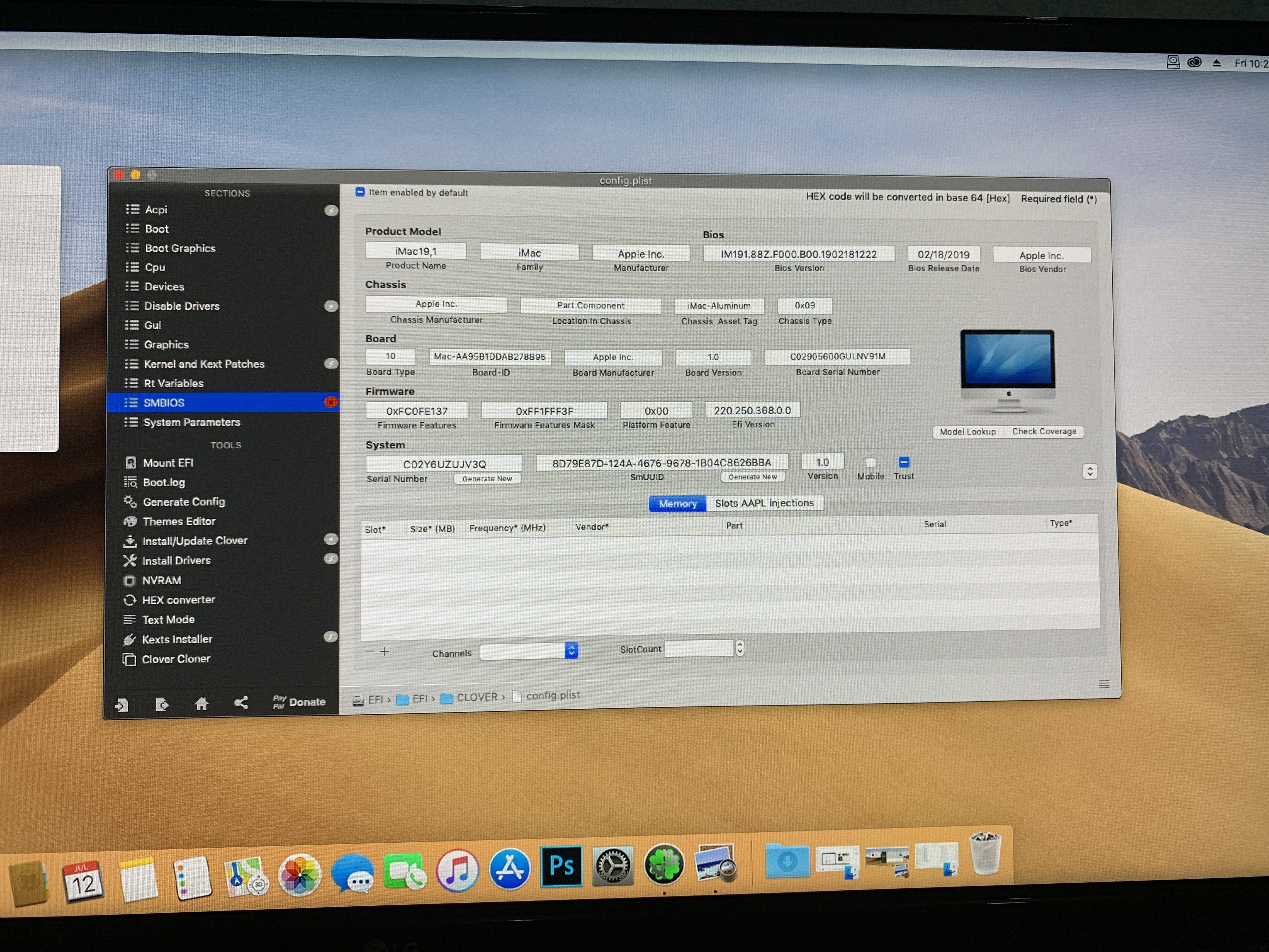

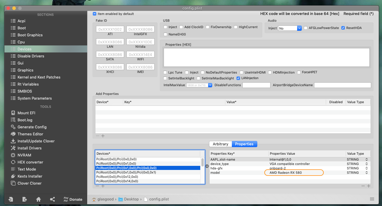

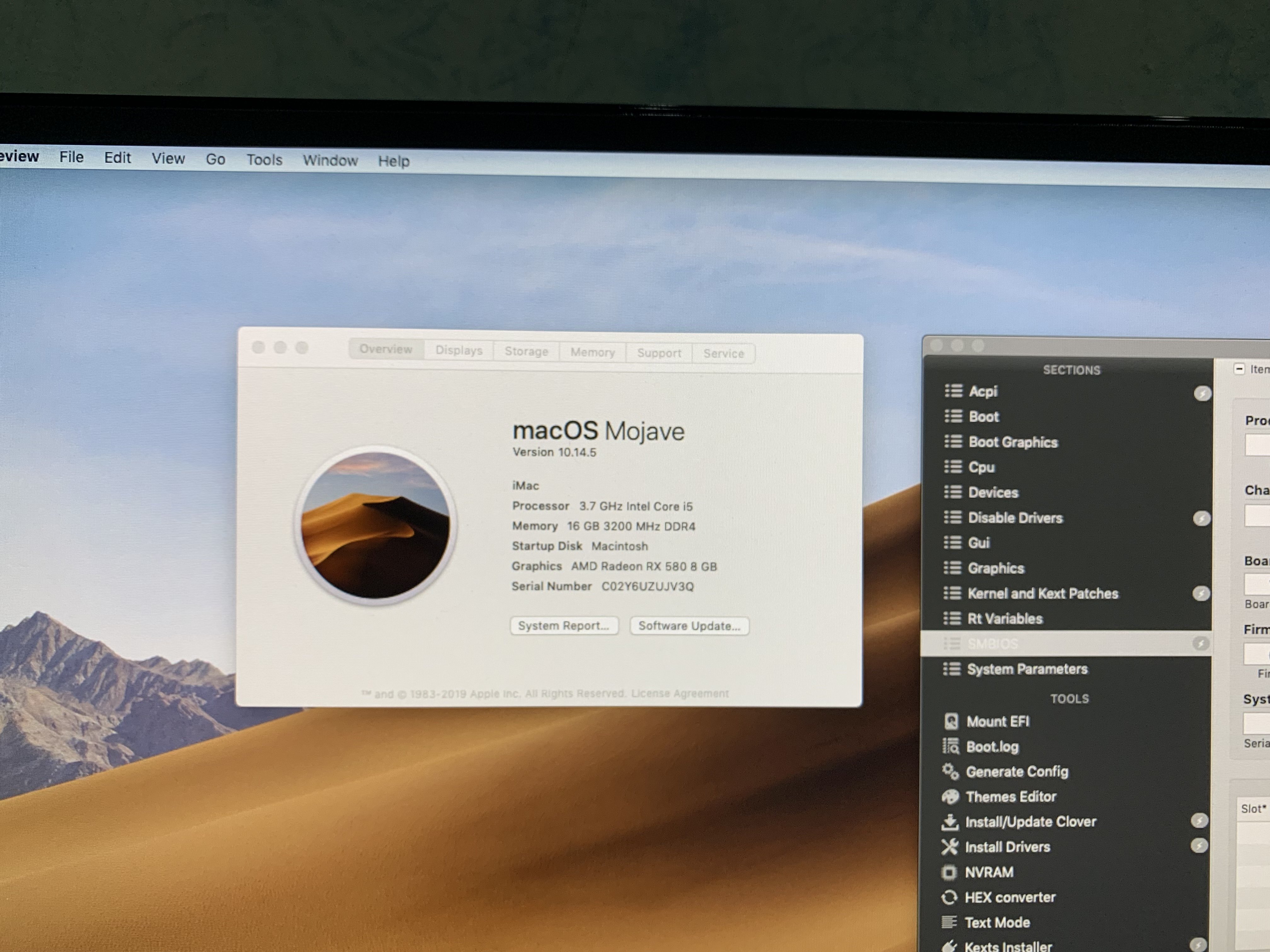

wdopulencia Posted July 12, 2019 Share Posted July 12, 2019 Just a question, in about this mac, it doesnt show the exact iMac model (such as 2019 model), and it shows rx580 but i have rx570. Do i need to change something in smbios in order for it to show the correct model in the about this mac? Link to comment https://www.insanelymac.com/forum/topic/337837-glasgoods-macos-mojave-successguide-for-aorus-z390-pro/page/34/#findComment-2681150 Share on other sites More sharing options...
glasgood Posted July 12, 2019 Author Share Posted July 12, 2019 44 minutes ago, wdopulencia said: Just a question, in about this mac, it doesnt show the exact iMac model (such as 2019 model), and it shows rx580 but i have rx570. Do i need to change something in smbios in order for it to show the correct model in the about this mac? Edit the string value shown below: Link to comment https://www.insanelymac.com/forum/topic/337837-glasgoods-macos-mojave-successguide-for-aorus-z390-pro/page/34/#findComment-2681155 Share on other sites More sharing options...
wdopulencia Posted July 12, 2019 Share Posted July 12, 2019 2 hours ago, glasgood said: Edit the string value shown below: Thanks!!!! How about for the model for the imac? Link to comment https://www.insanelymac.com/forum/topic/337837-glasgoods-macos-mojave-successguide-for-aorus-z390-pro/page/34/#findComment-2681191 Share on other sites More sharing options...
