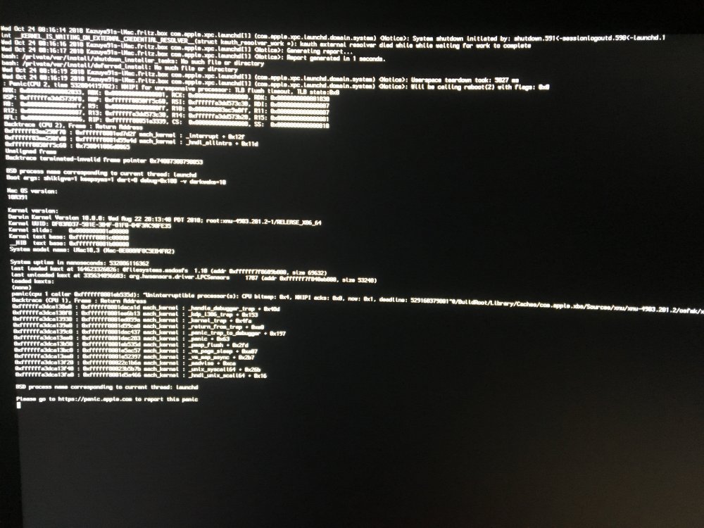

miguelcobain Posted October 26, 2018 Share Posted October 26, 2018 (edited) @MaLd0n thank you for your response. After using your CLOVER.zip I still got a kernel panic, but this time a slightly different one (see attached picture). Notice that there's no "Please go to https://panic.apple.com to report this panic" in the end. So I couldn't boot to run your "RunMe.app". Also an interesting thing is that on this panic, the fans are spinning like crazy. EDIT: seems like with this CLOVER.zip I'm but with the reboot problems which I wasn't before with the one you posted initially for z390! Edited October 26, 2018 by miguelcobain Link to comment https://www.insanelymac.com/forum/topic/336035-random-kernel-panic-on-shutdownreboot-and-nvram-problem/#findComment-2643218 Share on other sites More sharing options...
