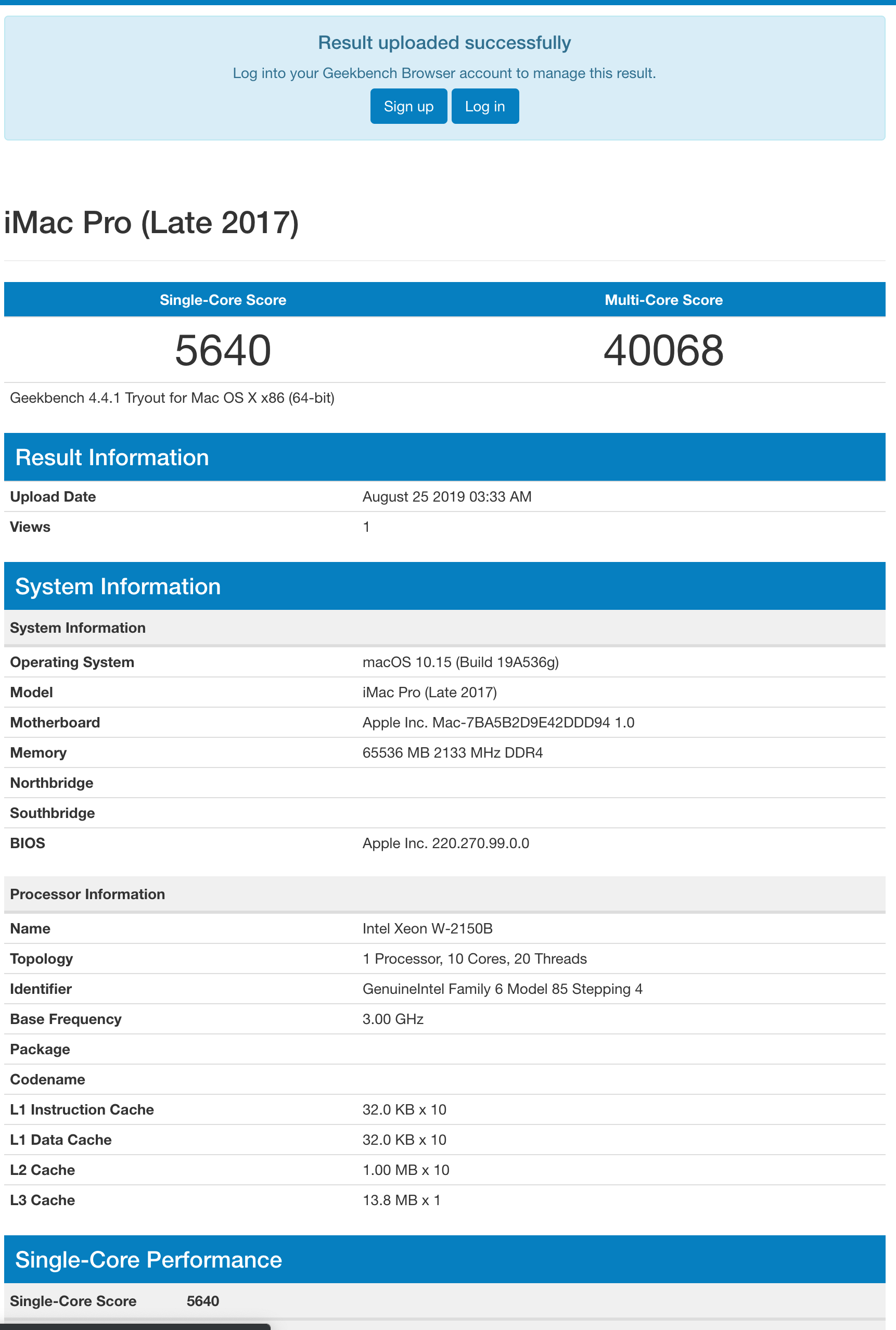

obus Posted August 29, 2019 Author Share Posted August 29, 2019 (edited) Geekbench has improved significantly. Cinebench shows approximately the same results. (all CPU settings in BIOS - in default or "Auto") Test Results.zip Nice to see. Edited August 29, 2019 by obus Link to comment https://www.insanelymac.com/forum/topic/335193-help-installing-mojave-on-xeon-w-2175-and-asus-ws-c422-mobo/page/14/#findComment-2687798 Share on other sites More sharing options...
yapan4 Posted August 29, 2019 Share Posted August 29, 2019 (edited) I have never seen 5000 points or more in Geekbench on this processor, including Windows. So the result with the latest OC changes is very good for me I would like the same in Clover Edited August 29, 2019 by yapan4 Link to comment https://www.insanelymac.com/forum/topic/335193-help-installing-mojave-on-xeon-w-2175-and-asus-ws-c422-mobo/page/14/#findComment-2687801 Share on other sites More sharing options...

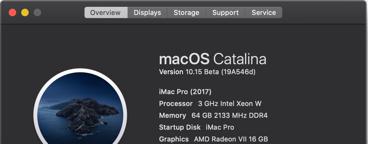

yapan4 Posted September 8, 2019 Share Posted September 8, 2019 (edited) Hi, @skyflying5 Is your CPU showing correctly in About This Mac? Edited September 8, 2019 by yapan4 Link to comment https://www.insanelymac.com/forum/topic/335193-help-installing-mojave-on-xeon-w-2175-and-asus-ws-c422-mobo/page/14/#findComment-2689240 Share on other sites More sharing options...
obus Posted September 8, 2019 Author Share Posted September 8, 2019 On 9/7/2019 at 8:02 AM, hotbullet said: Hi anyone success or can help me please. i have borrowd asus c422 and xeon w2195 to play around with so it is not in my signature. i am stuck at random seed. i am using vega 56 in this build. msr lock is disabled in my bios. thanks. Send me your OC EFI folder. Link to comment https://www.insanelymac.com/forum/topic/335193-help-installing-mojave-on-xeon-w-2175-and-asus-ws-c422-mobo/page/14/#findComment-2689290 Share on other sites More sharing options...

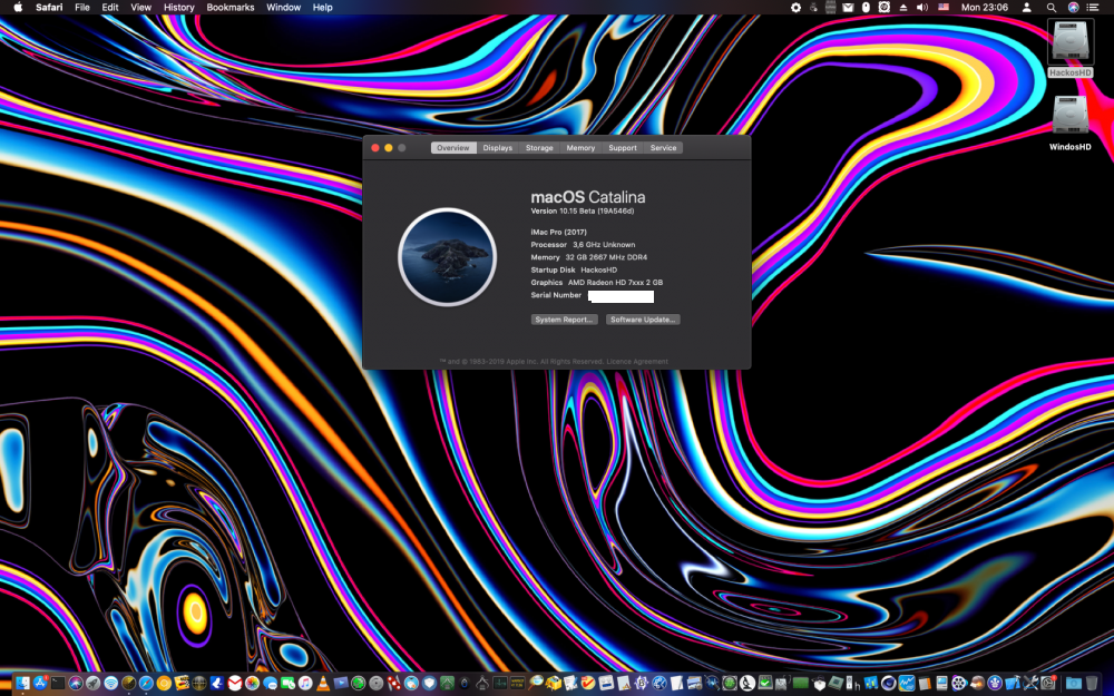

skyflying5 Posted September 9, 2019 Share Posted September 9, 2019 23 hours ago, yapan4 said: Hi, @skyflying5 Is your CPU showing correctly in About This Mac? 1 Link to comment https://www.insanelymac.com/forum/topic/335193-help-installing-mojave-on-xeon-w-2175-and-asus-ws-c422-mobo/page/14/#findComment-2689360 Share on other sites More sharing options...
yapan4 Posted September 9, 2019 Share Posted September 9, 2019 (edited) Well, using a native CPU is still a better option, since mine is always "Unknown"(with or w/o 0x0F01 CPU Type - no difference) Edited September 9, 2019 by yapan4 Link to comment https://www.insanelymac.com/forum/topic/335193-help-installing-mojave-on-xeon-w-2175-and-asus-ws-c422-mobo/page/14/#findComment-2689423 Share on other sites More sharing options...

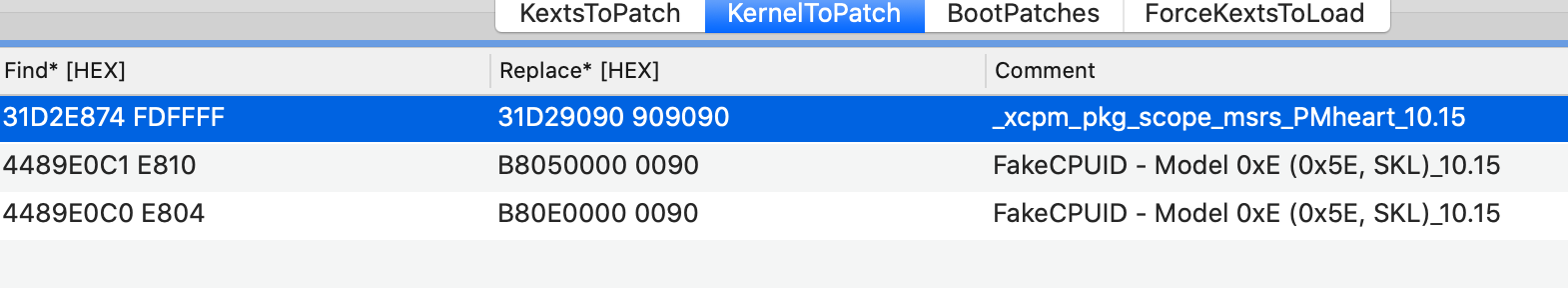

hotbullet Posted September 10, 2019 Share Posted September 10, 2019 (edited) finally i can see the install screen i use olarila x299 chipset efi folder and added _xcpm_pkg_scope_msrs_PMhart from obus post Posted August 17, 2018 (edited) For the first time with this rig I can get rid of FakeCPUID in Clover thanks to my saver @fabiosun with this (only) kernel patch: 89D804C4 3C227722 -> 89D804C1 3C227722 xcpm_bootstrap © Pike R. Alpha will update how it goes.. thanks obus and yapan. for OC i have no idea at all how it works. EVERYTHING seems ok geekbench 4 32K+ -SAME in windows. CINEBENCH20 5200 5300 Edited September 10, 2019 by hotbullet 1 Link to comment https://www.insanelymac.com/forum/topic/335193-help-installing-mojave-on-xeon-w-2175-and-asus-ws-c422-mobo/page/14/#findComment-2689482 Share on other sites More sharing options...

yapan4 Posted September 11, 2019 Share Posted September 11, 2019 (edited) 2 hours ago, hotbullet said: thanks I have read I have to add 3 more patches? I have attached my efi folder. thanks fro your guide. I am reading. if I hv doubt may I message you? thanks alot √ 31D2E87E FCFFFF replace 31D29090 909090 comment_xcpm_smt_scope find 31D2E891 FCFFFF replace 31D29090 909090 comment_xcpm_core_scope find 31D2E8AE FCFFFF replace 31D29090 909090 comment_pkg_core_scope EFI.zip For Mojave you need only FakeCPUID 0506E4(not 050654!) + _xcpm_pkg_scope_msrs_PMhart 31d2e8b4fcffff -> 31D29090909090 Edited September 11, 2019 by yapan4 Link to comment https://www.insanelymac.com/forum/topic/335193-help-installing-mojave-on-xeon-w-2175-and-asus-ws-c422-mobo/page/14/#findComment-2689632 Share on other sites More sharing options...
hotbullet Posted September 12, 2019 Share Posted September 12, 2019 9 hours ago, yapan4 said: For Mojave you need only FakeCPUID 0506E4(not 050654!) + _xcpm_pkg_scope_msrs_PMhart 31d2e8b4fcffff -> 31D29090909090 @yapan4 if I put those my system will stuck at randomseed. I tried using this as @obus discovery but my system will only boot in os with bootstrap enabled. otherwise it will stuck at ranndomseed. I have tested a little bit further.With FakeCPUID my rig boots with full powermanagment (xcpm) together with this patches:1._xcpm_pkg_scope_msrs_PMhart 31D2E8AE FCFFFF ->31D29090 9090902.pikeralpha reboot fix554889E5 41574156 41554154 53504189 D64889FB 4189F54C 8D3D7662 -> C34889E5 41574156 41554154 53504189 D64889FB 4189F54C 8D3D76623._xcpm_smt_scope31D2E87E FCFFFF -> 31D29090 909090With xcpm_bootstrap © Pike R. Alpha 89D804C4 3C227722 -> 89D804C1 3C227722 my rig is booting without FakeCPUID and with any other patch but always without native powermanagment (xcpm). Link to comment https://www.insanelymac.com/forum/topic/335193-help-installing-mojave-on-xeon-w-2175-and-asus-ws-c422-mobo/page/14/#findComment-2689676 Share on other sites More sharing options...
