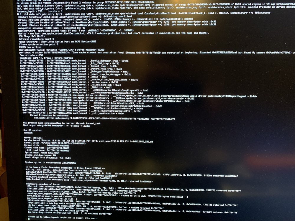

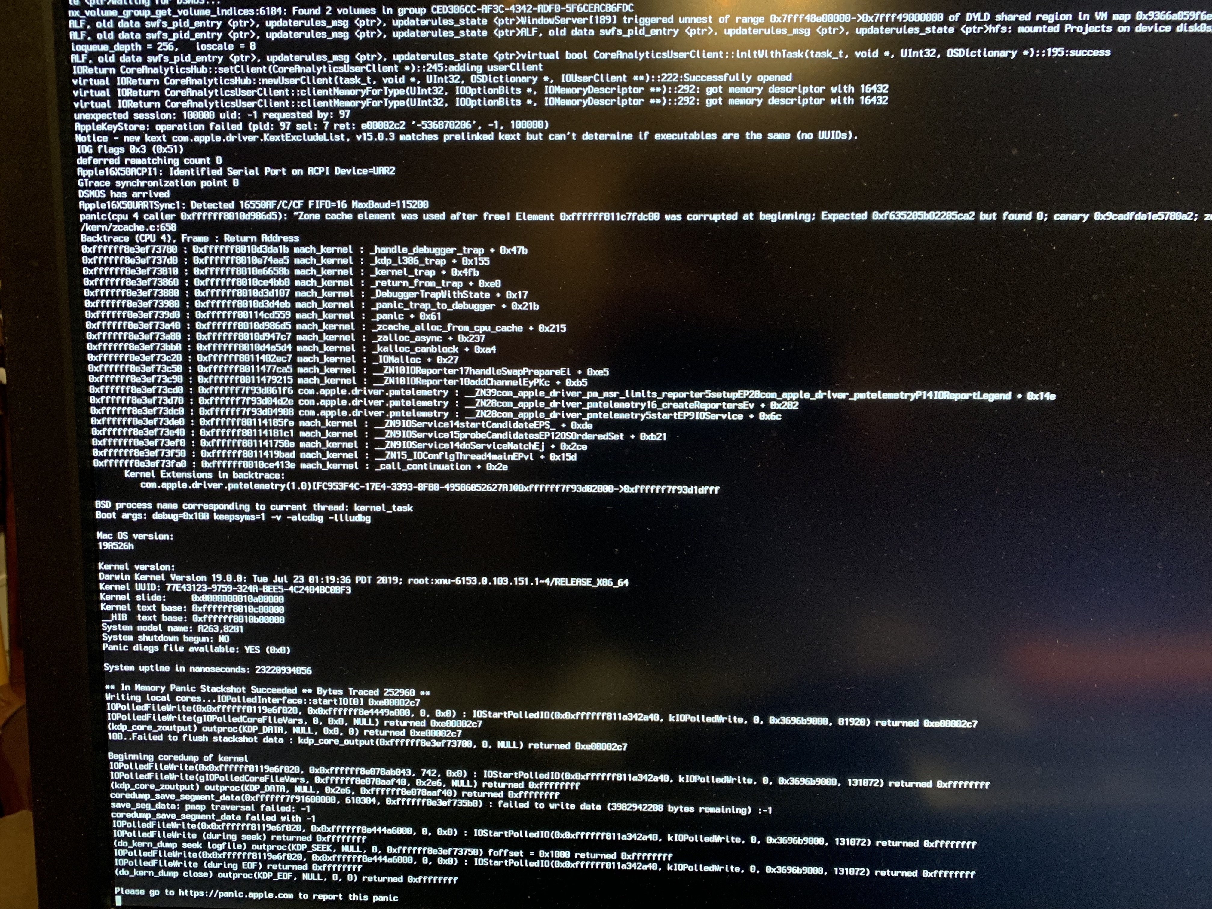

obus Posted August 5, 2019 Author Share Posted August 5, 2019 6 hours ago, eritius said: Me too! I'm getting a setup with a C621 chipset and dual Xeon Golds up and running at the moment. I've encountered a lot of the issues mentioned here. Unfortunately, the same CPUID patch (0x0506E3) causes all sorts of issues with my setup. For some reason, it causes random memory corruption in the kernel which results in kernel panics in all sorts of extensions and messages like: "Zone cache element was used after free!" and "a freed zone element has been modified" So far, the only workaround I've found is to use a less compatible CPUID 0x040674. In the handful of cases where I got luck and the memory scribbling didn't land on anything critical, the dual processors showed up as Xeon Ws in About This Mac. Geek Bench scores were not where I would expect them to be, though, so there are some issues to sort out even if that becomes stable. As well, as of Catalina beta 5, the C621 chipset doesn't appear to be entirely support. USB all work out of the box which is great, but there's no driver for the X722 ethernet ports, or at least not one that comes up automatically for the 1Gb ports on this motherboard. If anyone has any suggestions for things to try, I'm all ears! Are you running clover? And if that's the case may I see your EFI folder. Link to comment https://www.insanelymac.com/forum/topic/335193-help-installing-mojave-on-xeon-w-2175-and-asus-ws-c422-mobo/page/11/#findComment-2684457 Share on other sites More sharing options...

obus Posted August 5, 2019 Author Share Posted August 5, 2019 (edited) Which can means your MsrE2 register is locked. You can check more details about this here:https://github.com/acidanthera/AppleSupportPkg#verifymsre2 Try embedded config.plist and remove USBInjectAll.kext from your kext-folder. In embedded config.plist I have checked XhciPortLimit instead. (seeC onfiguration page 14 chapter 6.7.10) The best way is to make a XHCI.kext.zip with a 15 ports limitation (see embedded example). I'am not using TSCAdjustReset.kext for my rig. Try without and see if that make any difference in performance. You need SSDT-PLUG.aml to get native powermanagment. (Embedded you find an example from one of my rigs.) What kind of graphics are you running? iGPU only or??? If you have a HiDPI screen that value should be 02 instead of 01. Why npci=0x2000?? Test with that bootflag removed. Set csr-active-config with csr utility enabled respectively disabled in recovery partition instead of using csr-active-config -> <e7030000>. (I changed that to <00000000> in embedded config.plist). To get into recovery mode you have to swap VBoxHfs.efi too embedded HFSPlus.efi. (I changed that in config.plist) If you use ConsoleBehaviourOs and/or ConsoleBehaviourUi you need to set ConsoleControl to YES. (I've changed that in embedded config.plist) Don't forget to put back serials and mlb and so on in platform info. config.plist Edited August 5, 2019 by obus Link to comment https://www.insanelymac.com/forum/topic/335193-help-installing-mojave-on-xeon-w-2175-and-asus-ws-c422-mobo/page/11/#findComment-2684496 Share on other sites More sharing options...

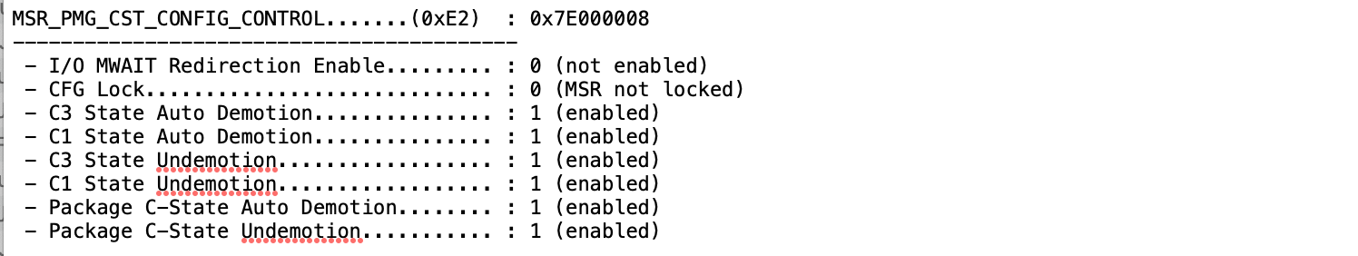

eritius Posted August 5, 2019 Share Posted August 5, 2019 41 minutes ago, obus said: Which means your MsrE2 register is locked. You can check more details about this here:https://github.com/acidanthera/AppleSupportPkg#verifymsre2 So strangely, when I run that tool, it says all my cores are unlocked which I assume is good. That said, I seem to need to apply a bunch of fixes for what I assume are related, e.g. AppleXcpmCfgLock and AppleXcpmExtraMsrs in OpenCore or the xcpm_pkg_scope_msrs kernel patch in Clover. Link to comment https://www.insanelymac.com/forum/topic/335193-help-installing-mojave-on-xeon-w-2175-and-asus-ws-c422-mobo/page/11/#findComment-2684502 Share on other sites More sharing options...
obus Posted August 5, 2019 Author Share Posted August 5, 2019 3 hours ago, eritius said: So strangely, when I run that tool, it says all my cores are unlocked which I assume is good. That said, I seem to need to apply a bunch of fixes for what I assume are related, e.g. AppleXcpmCfgLock and AppleXcpmExtraMsrs in OpenCore or the xcpm_pkg_scope_msrs kernel patch in Clover. Good news then. Try this setup in your config.plist config-1.plist Link to comment https://www.insanelymac.com/forum/topic/335193-help-installing-mojave-on-xeon-w-2175-and-asus-ws-c422-mobo/page/11/#findComment-2684525 Share on other sites More sharing options...
obus Posted August 5, 2019 Author Share Posted August 5, 2019 (edited) 4 hours ago, eritius said: GPU: Sapphire Pulse Radeon RX 580 8G Native. Works OOB. 4 hours ago, eritius said: It's been set to 0 up until about 3 hours ago when I was just doing some testing and I sent this to you. For what it's worth, I was able to boot into recovery just fine with VBoxHfs.efi, though it took a hot minute and I thought it had stalled at first. HFSPlus.efi is booting into recovery immediately VBoxHfs.efi can take up to 1 minute before you get into the recovery environment. 4 hours ago, eritius said: Bigger problem I suspect is I can't boot with my native CPUID (0x050654) or any of the alternates you all are using. 0x0506E3 causes random memory corruption in the kernel. It boots maybe 1 in 20 times if I get lucky and the memory overwriting doesn't scribble over something important. More likely, it causes kernel panics in all sorts of random locations. My rig is booting perfect on this Broadwell 0x040674 CPUID too. Use that until you have fixed your SSDT-PLUG.aml (native PM). When you have this in IOReg everything is cool. Our processors don't boot with the "Apple native" CPUID either. Send me a copy of your AppleIntelInfo.rtf and a copy of terminal output from command: sysctl -a | grep xcpm Edited August 5, 2019 by obus Link to comment https://www.insanelymac.com/forum/topic/335193-help-installing-mojave-on-xeon-w-2175-and-asus-ws-c422-mobo/page/11/#findComment-2684531 Share on other sites More sharing options...

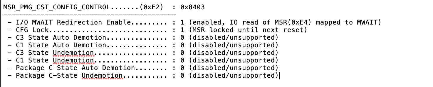

eritius Posted August 5, 2019 Share Posted August 5, 2019 53 minutes ago, obus said: Send me a copy of your AppleIntelInfo.rtf Alright, took me a sec to figure out what you were talking about but here you go. Also, I found out how to patch the EFI variables holding the CFG Lock setting that is hidden in my BIOS. I'm working to get that disabled on both CPUs at the moment. AppleIntelInfo.dat Link to comment https://www.insanelymac.com/forum/topic/335193-help-installing-mojave-on-xeon-w-2175-and-asus-ws-c422-mobo/page/11/#findComment-2684543 Share on other sites More sharing options...
obus Posted August 5, 2019 Author Share Posted August 5, 2019 6 minutes ago, eritius said: Alright, took me a sec to figure out what you were talking about but here you go. Also, I found out how to patch the EFI variables holding the CFG Lock setting that is hidden in my BIOS. I'm working to get that disabled on both CPUs at the moment. AppleIntelInfo.dat Sorry but it looks like your MSR0xE2 register is locked. This is mine: Did you test my last config? Link to comment https://www.insanelymac.com/forum/topic/335193-help-installing-mojave-on-xeon-w-2175-and-asus-ws-c422-mobo/page/11/#findComment-2684546 Share on other sites More sharing options...
eritius Posted August 5, 2019 Share Posted August 5, 2019 2 minutes ago, obus said: Sorry but it looks like your MSR0xE2 register is locked. This is mine: Did you test my last config? Not yet. As I said, I'm working on rewriting a hidden BIOS variable for CFG Lock that should keep it unlocked. 1 Link to comment https://www.insanelymac.com/forum/topic/335193-help-installing-mojave-on-xeon-w-2175-and-asus-ws-c422-mobo/page/11/#findComment-2684548 Share on other sites More sharing options...

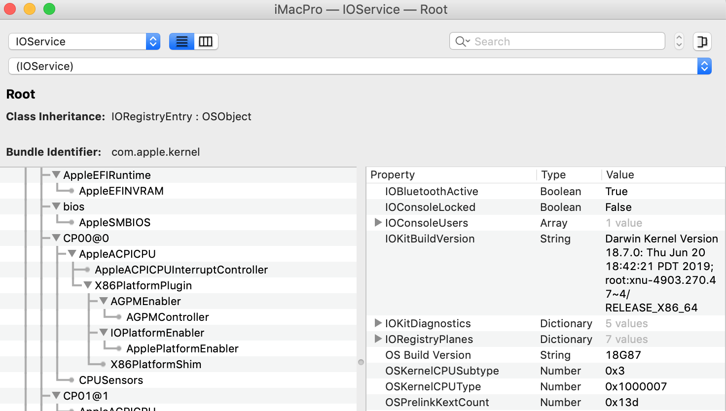

obus Posted August 5, 2019 Author Share Posted August 5, 2019 1 minute ago, eritius said: Not yet. As I said, I'm working on rewriting a hidden BIOS variable for CFG Lock that should keep it unlocked. OK I See. Could you send me a copy of your IOReg. Link to comment https://www.insanelymac.com/forum/topic/335193-help-installing-mojave-on-xeon-w-2175-and-asus-ws-c422-mobo/page/11/#findComment-2684549 Share on other sites More sharing options...
eritius Posted August 5, 2019 Share Posted August 5, 2019 (edited) 6 minutes ago, obus said: OK I See. Could you send me a copy of your IOReg. Yup, here you go! (The BIOS thing is a bit of a pain... I needed to modify https://github.com/datasone/grub-mod-setup_var to look at a different EFI variable for my motherboard, but I can't get it to compile under macOS so now I need to make an Ubuntu boot just to compile this EFI so I can go in and flip two bits. Sorry, just ranting hahaha) If you have any advice on getting the GC-Titan Ridge Thunderbolt card working, I'm all ears as well! eritius-ioreg.ioreg Edited August 5, 2019 by eritius Specified which TB3 card Link to comment https://www.insanelymac.com/forum/topic/335193-help-installing-mojave-on-xeon-w-2175-and-asus-ws-c422-mobo/page/11/#findComment-2684552 Share on other sites More sharing options...

skyflying5 Posted August 6, 2019 Share Posted August 6, 2019 (edited) the supermicro board can modify the bios file to enable the CFG LOCK option visible I all ready got mine worked with C422 chipset。 BUT YOU have to take the risk of Flashing the BIOS。 it's up to you。 X11DAi-N9.503-CFG-LOCK-DISABLED.rar Edited August 6, 2019 by skyflying5 Link to comment https://www.insanelymac.com/forum/topic/335193-help-installing-mojave-on-xeon-w-2175-and-asus-ws-c422-mobo/page/11/#findComment-2684591 Share on other sites More sharing options...
eritius Posted August 6, 2019 Share Posted August 6, 2019 It's been a long and eventful day. 1 hour ago, skyflying5 said: the supermicro board can modify the bios file to enable the CFG LOCK option visible I all ready got mine worked with C422 chipset。 BUT YOU have to take the risk of Flashing the BIOS。 it's up to you。 I went ahead and did this what was probably the hard way. I updated grub-mod-setup_var to modify the appropriate EFI variables I found by disassembling the BIOS. (Had to be compiled under an old version of Ubuntu too... ugh). I first switched off CFG Lock for both CPU sockets which turned out to not disable MSR E2. I then found another variable called MSR Lock Control which did seem to work, or perhaps the two together did. In doing this, I found a couple of other things. With so many cores, VerifyMsrE2 actually was timing out which is what gave me the false impression it was fine. I modified it so it could enumerate through to the end and submitted a pull request with the change to the main repo. I also noticed that Open Core was misidentifying the Xeon Gold as a much older Nehalem Xeon. I'm not sure if this affects anything really, but I submitted a pull request too, which pretends the new Xeon Scalable line is the same as a Xeon W, which it's roughly similar to. At this point, with MSR unlocked (and verified), I went ahead and made the SSDT for XCPM (plugin-type = 1). It's ever so slightly more involved because of the dual processors: SSDT-XCPM.dsl This in turn worked to enable the power management within 10.15: AppleIntelInfo.dat sysctl-xcpm.txt So that's good at least! Now, onto the funky: The processor now lists as 2.88 Ghz chip in About this Mac. It used to say 2.99 before I did any of this. It's still marked Unknown, because... The Kernel patches you suggested cause kernel panics on my machine in com.apple.driver.pmtelemetry: CPUID 0x506e3 still causes panics. I haven't fully experimented, but the most stable configuration for me still is 0x40674, AppleXcpmCfgLock=YES and AppleXcpmExtraMsrs=YES. I think I can maybe turn off AppleXcpmExtraMsrs and use the _xcpm_pkg_scope_msrs_PMheart_10.15 patch, but AppleXcpmExtraMsrs seems to encompass that patch and more. I haven't tested just turning off AppleXcpmCfgLock yet. For now, I've bailed on getting the Thunderbolt working. I realized I'm not good enough at following the DSDT to patch the X299 version to work for my board. Would still love to figure out how to make that work though and would love some help getting it going, though it's secondary to getting the performance numbers to where they should be. Lastly, I'm not sure if getting XCPM going was supposed to result in performance improvements, but the Geek Bench score is unchanged after all this. 1 Link to comment https://www.insanelymac.com/forum/topic/335193-help-installing-mojave-on-xeon-w-2175-and-asus-ws-c422-mobo/page/11/#findComment-2684601 Share on other sites More sharing options...
