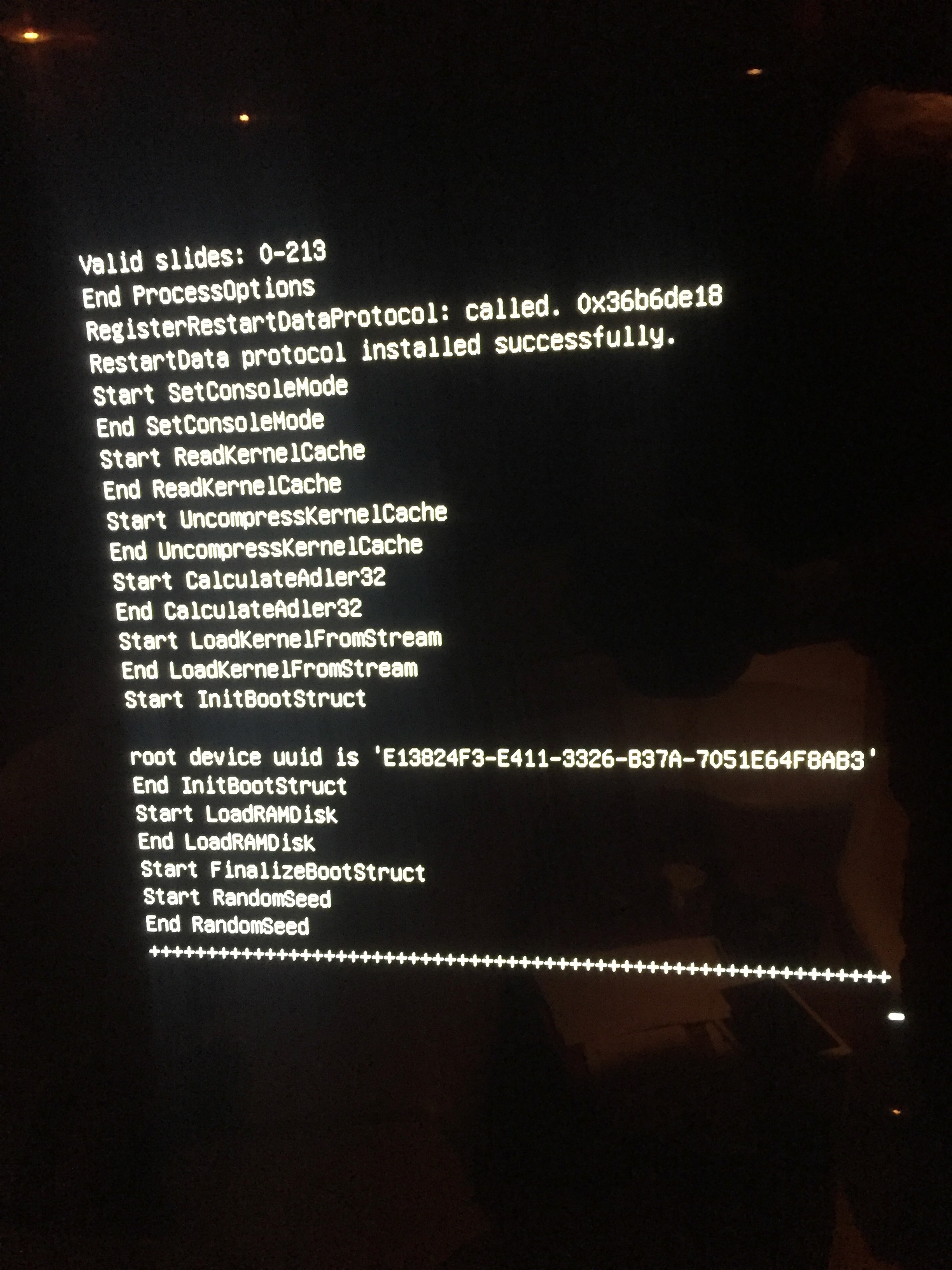

surfinchina Posted March 13, 2018 Share Posted March 13, 2018 (edited) 8 hours ago, obus said: Ok. Booted with SMBIOS mac Pro6.1 (board id Mac-F60DEB81FF30ACF6 plist attached) Exact same behaviour. preboot.log config.plist A few times the boot has stalled there for me because that USB port has stopped. Simple and you might have thought of it, but try a few different ports. Another thing that helped me sometimes was different OsxAptioFixDrv-64.efi versions and once setting different slide values. I feel your pain. When I did this on my X299 it was before anyone else and it took quite a while... You should remove as much as you can and then add kexts, drivers and patches, rather than removing them. Otherwise you end up chasing your tail. My config.plist has pretty well no patches and it works nicely. I'll attach it just in case it helps config.plist Edited March 13, 2018 by surfinchina Link to comment https://www.insanelymac.com/forum/topic/333229-help-installing-highsierra-on-xeon-w-2175-and-asus-ws-c422-mobo/page/2/#findComment-2602742 Share on other sites More sharing options...
obus Posted March 13, 2018 Author Share Posted March 13, 2018 (edited) Cheers Surfinchina. How do I change slides and what exactly is it. Is it memory/NVRAM related! I was thinking it perhaps could have something to do with my ECC SDRAM memory. Are you using the MSR 0xE2 register UEFI-patch. I'm not sure about this patch I mean if it works on my mobo. I initially patched my bios with the one I found on KGP:s excellent skylake-guide. But now I'm not sure if I can use that so I went back to use TSCAdjustReset.kext and PikeRAlphas kernel patch. Is there a generic patch for all ASUS - boards? Edited March 13, 2018 by obus Link to comment https://www.insanelymac.com/forum/topic/333229-help-installing-highsierra-on-xeon-w-2175-and-asus-ws-c422-mobo/page/2/#findComment-2602759 Share on other sites More sharing options...
obus Posted March 13, 2018 Author Share Posted March 13, 2018 (edited) Ok. So i stripped down everything on my rig. Just using USB-keyboard/mouse,Nvidia GTX 680 graphics card, a clean 240 GB Samsung ssd and only one 16 GB ram. Using attached config.plist and this time Lilu.kext and NvidiaGraphicsFixup.kext for the graphics. FakeSMC.kext, TSCAdjustReset.kext and SmallTree-Intel-211-AT-PCIe-GBE.kext for my ethernet. Unfortunately with the same result as earlier "End random seed" +++++++++++++++++++++++ In the Q-code table I can see that the system get stucked on 04 or "system is entering S4 sleep state". Could this maybe shed some light over my problems? During the day I tried at least 10 different releases of AptioMemoryFix.efi. For me with only basic knowledge it's most about t trial and error but this a little bit harder. Starting to get a little bit frustrating now. I'am 66 years old and have all the time in the world on daytime (my wife is still working so...) but you know it's always good to see some progress. Any creativity out there? This is the hackintosh set up for the future so the problem must be solved. config.plist Edited March 13, 2018 by obus Link to comment https://www.insanelymac.com/forum/topic/333229-help-installing-highsierra-on-xeon-w-2175-and-asus-ws-c422-mobo/page/2/#findComment-2602878 Share on other sites More sharing options...

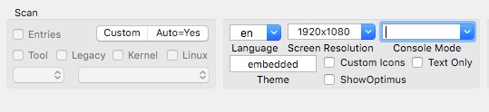

Dan968 Posted March 13, 2018 Share Posted March 13, 2018 Sorry, but could it be simply that you have a wrong graphical boot setting? I think it doesn't open the Clover graphical interface! I see you have 4k setting...do you have a 4k monitor?? Try to reset to default: Link to comment https://www.insanelymac.com/forum/topic/333229-help-installing-highsierra-on-xeon-w-2175-and-asus-ws-c422-mobo/page/2/#findComment-2602887 Share on other sites More sharing options...

obus Posted March 13, 2018 Author Share Posted March 13, 2018 (edited) 31 minutes ago, Dan968 said: Sorry, but could it be simply that you have a wrong graphical boot setting? I think it doesn't open the Clover graphical interface! I see you have 4k setting...do you have a 4k monitor?? Try to reset to default: Hi Dan968. Yes I'm using a 4k samsung oled 55 inch Tv screen. Please what do you mean by reseat? Do you mea n 1920x1080? Edited March 13, 2018 by obus Link to comment https://www.insanelymac.com/forum/topic/333229-help-installing-highsierra-on-xeon-w-2175-and-asus-ws-c422-mobo/page/2/#findComment-2602891 Share on other sites More sharing options...
