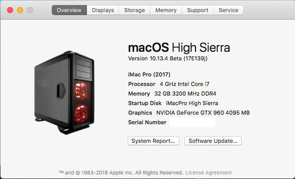

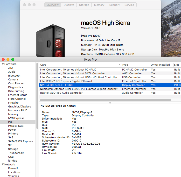

SavageAUS Posted January 31, 2018 Share Posted January 31, 2018 Running fairly smooth with the latest Nvidia drivers still a bit glitchy until new drivers are released or i roll back. But this is a fresh install of macOS High Sierra on an SSD iMacPro edition :-) Good job all. And the .4 beta 1 1 Link to comment Share on other sites More sharing options...
Cyberdevs Posted January 31, 2018 Author Share Posted January 31, 2018 Running fairly smooth with the latest Nvidia drivers still a bit glitchy until new drivers are released or i roll back. But this is a fresh install of macOS High Sierra on an SSD iMacPro edition :-) Good job all. Will this update work from appstore for iMacPro or is for non iMacPro versions? Did you install the macOS the normal way and changed the SMBIOS afterwards? Which version of macOS did you install 10.13.3? Link to comment Share on other sites More sharing options...
SavageAUS Posted January 31, 2018 Share Posted January 31, 2018 Did you install the macOS the normal way and changed the SMBIOS afterwards? Which version of macOS did you install 10.13.3? No I created a new install macOS High Sierra .app 10.13.3 from the guides script and installed it that way via usb with my standard config.plist but changed to iMacPro smbios. Sent from my SM-G930F using Tapatalk 1 Link to comment Share on other sites More sharing options...

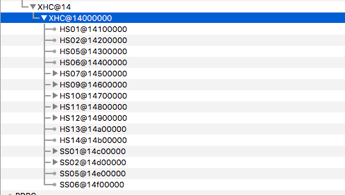

Guest Posted January 31, 2018 Share Posted January 31, 2018 If you have time and a solid backup try to use only port limit without any ssdt for usb Only a dsdt rename to XHC and XHCI enabled in bios In my x99 and in a x299 boards i have tested thiis is the only thing needed to have all usb ports working I am very curious to know if it works also in other platform The only drawback for me is without any ssdt or dsdt for Usb i loose sleep/wake functionality At all @gengik84 is helping me to find a way for this problem Link to comment Share on other sites More sharing options...
SavageAUS Posted January 31, 2018 Share Posted January 31, 2018 If you have time and a solid backup try to use only port limit without any ssdt for usb Only a dsdt rename to XHC and XHCI enabled in bios In my x99 and in a x299 boards i have tested thiis is the only thing needed to have all usb ports working I am very curious to know if it works also in other platform I believe renames are already done in DSDT as maldon created it. I'll do a few tests when I get some time with and without port limit patch and with and without my SSDT-UIAC. Sent from my SM-G930F using Tapatalk The only drawback for me is without any ssdt or dsdt for Usb i loose sleep/wake functionality At all @gengik84 is helping me to find a way for this problem What sort of cpu cooler do you have? Sent from my SM-G930F using Tapatalk Link to comment Share on other sites More sharing options...
Guest Posted January 31, 2018 Share Posted January 31, 2018 for USB part if your system starts without the need of DSDT try only port limits and a rename via config.plist (you can find in config.plist I posted here in a previous message My xeon CPU does not need great cooler but I use a good one Phantek Phanteks PH-TC14PE What sort of cpu cooler do you have?Sent from my SM-G930F using Tapatalk Link to comment Share on other sites More sharing options...
SavageAUS Posted January 31, 2018 Share Posted January 31, 2018 for USB part if your system starts without the need of DSDT try only port limits and a rename via config.plist (you can find in config.plist I posted here in a previous message My xeon CPU does not need great cooler but I use a good one Phantek Phanteks PH-TC14PE I only ask about cpu cooler because without my custom SSDT-UIAC my AIO liquid cooler prevents sleep. Sent from my SM-G930F using Tapatalk Link to comment Share on other sites More sharing options...
Guest Posted January 31, 2018 Share Posted January 31, 2018 Yes, it is possible that your ssdt do a remap of your port to have this functionality, in my case sleep is working if I use a dsdt. In my opinion with port limit and only XHC is it possible to have all port working well and for sleep I think is A _PWR related problem Off topic In my tests and also thanks @Matthew82 we discovered a similar behavior in two different motherboard chipset (X299 and X99) With thunderbolt inserted and configured "properly" sleep has some problem in his second cycle.. I only ask about cpu cooler because without my custom SSDT-UIAC my AIO liquid cooler prevents sleep.Sent from my SM-G930F using Tapatalk Link to comment Share on other sites More sharing options...
SavageAUS Posted January 31, 2018 Share Posted January 31, 2018 Yes, it is possible that your ssdt do a remap of your port to have this functionality, in my case sleep is working if I use a dsdt. In my opinion with port limit and only XHC is it possible to have all port working well and for sleep I think is A _PWR related problem Off topic In my tests and also thanks @Matthew82 we discovered a similar behavior in two different motherboard chipset (X299 and X99) With thunderbolt inserted and configured "properly" sleep has some problem in his second cycle.. I've been testing and I lose sleep no matter what I try without my custom SSDT-UIAC. Also during testing I did encounter the dread black screen occasionally. Dis anyone else get this? Sent from my SM-G930F using Tapatalk Link to comment Share on other sites More sharing options...

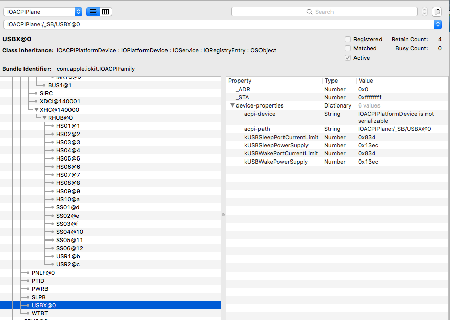

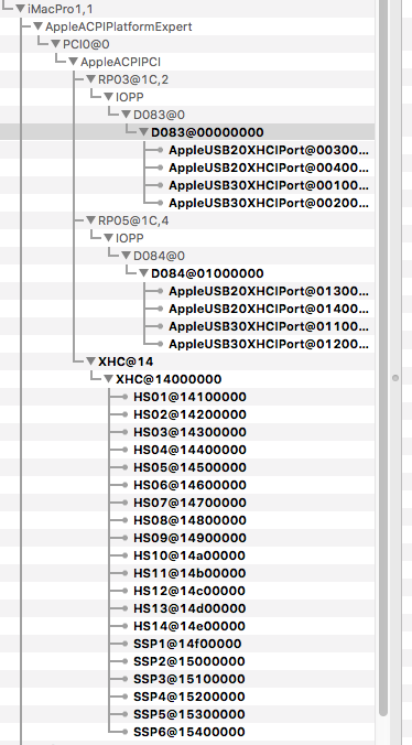

Guest Posted January 31, 2018 Share Posted January 31, 2018 What do you mean with "dread black screen"? without your custom SSDT have you checked in IOREG XHC part if there you have more ports available? In this condition (lose sleep) you have a reboot or an instal wake? Thank you Link to comment Share on other sites More sharing options...
SavageAUS Posted January 31, 2018 Share Posted January 31, 2018 What do you mean with "dread black screen"? without your customers SSDT have you checked in IOREG XHC part if there you have more ports available? In this condition (lose sleep) you have a reboot or an instal wake? Thank you Like using iMac17,1 without NvidiaGraphicsFixUp.Yes without SSDT-UIAC And the port patch I get way more ports but sleep gets instant wake. Sent from my SM-G930F using Tapatalk Link to comment Share on other sites More sharing options...

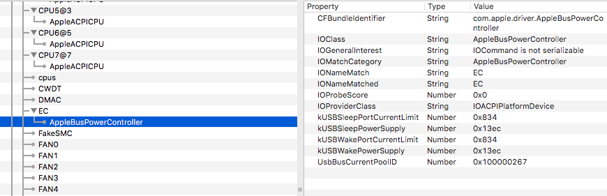

Guest Posted January 31, 2018 Share Posted January 31, 2018 ok for instant wake there is a solution I can't explain well one is in power option (disable power nap if it is enabled) other solution is _PWR or similar in DSDT (sorry here I am not confident at all) I know it is possible to have port limit patch used with no a remapping SSDT and a working sleep (more port available) In my case with Thunderbolt inserted all is more complicated (for sleep) Like using iMac17,1 without NvidiaGraphicsFixUp.Yes without SSDT-UIAC And the port patch I get way more ports but sleep gets instant wake.Sent from my SM-G930F using Tapatalk Link to comment Share on other sites More sharing options...

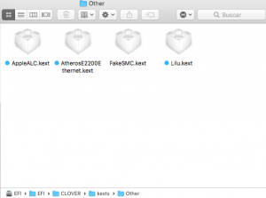

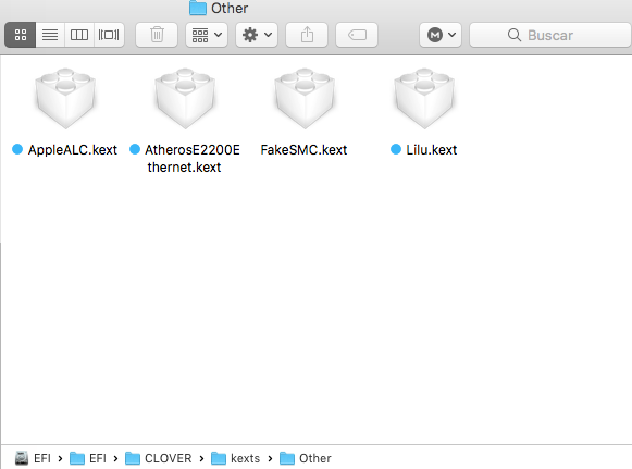

camillionario Posted January 31, 2018 Share Posted January 31, 2018 I do not use nvidiafix or kext USB injector and no screen and sleep problems. for port restriction I use fix clover kext to patch Link to comment Share on other sites More sharing options...

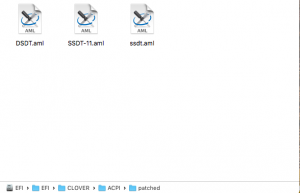

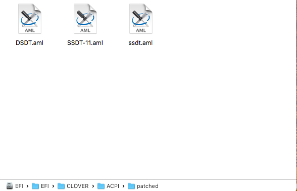

MaLd0n Posted January 31, 2018 Share Posted January 31, 2018 I do not use nvidiafix or kext USB injector and no screen and sleep problems. for port restriction I use fix clover kext to patch Captura de pantalla 2018-01-31 a las 16.15.14.png Captura de pantalla 2018-01-31 a las 16.15.49.png Captura de pantalla 2018-01-31 a las 16.18.20.png Captura de pantalla 2018-01-31 a las 16.19.05.png U don't need any SSDT, u can put all in DSDT SSDT just inject in DSDT, edit full DSDT patched and remove SSDTs 2 Link to comment Share on other sites More sharing options...
camillionario Posted January 31, 2018 Share Posted January 31, 2018 U don't need any SSDT, u can put all in DSDT SSDT just inject in DSDT, edit full DSDT patched and remove SSDTs Thanks, I'll try Link to comment Share on other sites More sharing options...
