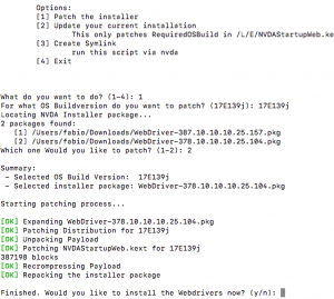

Guest Posted February 3, 2018 Share Posted February 3, 2018 you can use this app patcher from ricoc90 #758 How did you manage to install older web drivers? Imacpro smbios is working for me on the latest beta but no web drivers Link to comment Share on other sites More sharing options...

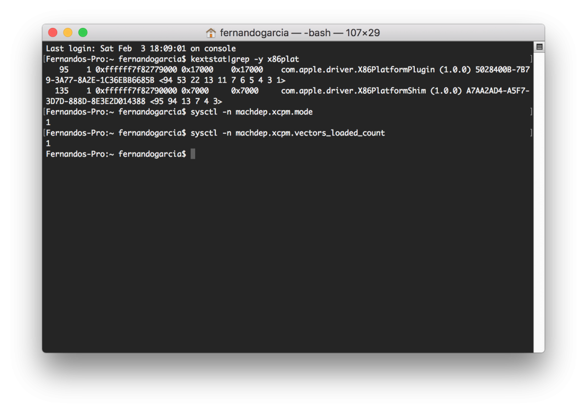

Fergarth Posted February 3, 2018 Share Posted February 3, 2018 Hi Fergarth you can try in a working condition to build an iMac Pro 1.1 config1.plist and then to use great spacebar clover feature to disable some kext or O option to disable other "unuseful" things maybe you are using with right combination you can boot fine I confirm what I have said time ago ImacPro system inject frequency vector and fv count will be 1 with unsupported cpu you would need of plugintype=1 or an ssdt/DSDT to inject value to have XCPM=1 I think is worth to try I´m using it with the latest beta.. I only used clover smbios to change to the iMac Pro 1.1 The board-id is in the plattformsupport.plist .. I did not modify it.. The system works smooth for me.. Greetings Yep, its working here now! 2 Link to comment Share on other sites More sharing options...

Guest Posted February 3, 2018 Share Posted February 3, 2018 Hi cyberdevs I have said time ago about sip related problem and also other people...I did some examples seeing in kext extensions loaded..with some Nvidiaweb driver and sip combination some kext extension (Nvidia related does not load and in some case produce weird situation) I think it is a problem with Nvidia postscript install and some permission but it is only for "pour parler" The weird thing is that if I use AptoiOsxDrv2fix and the AptioOsxDrv3Fix together (I know that is a bad idea to use those fixes together) I can boot into macOS with nVidia web drivers with SIP 0x0. It works with SIP set to 0x67 and as you said it is fast no more lags and no stuttering in the Safari and the Dock. not really true here! 104 driver Cheetara_2.jpg 156/157 drivers dm3lmg042lr40p7f2p3m8pymk.jpg Link to comment Share on other sites More sharing options...

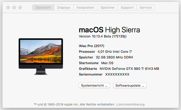

SV0911 Posted February 3, 2018 Share Posted February 3, 2018 Yep, its working here now! Great to read.. Now, just for the fun-part.. Off-Topic.. I hope it is ok .. If you (or anyone else..) like to have the iMacPro1,1 in your systemsettings.app like below, i attached a zip-file to this post with the tiff file to replace in the app. Now.. back to Topic Greetings SystemLogo.zip 2 Link to comment Share on other sites More sharing options...

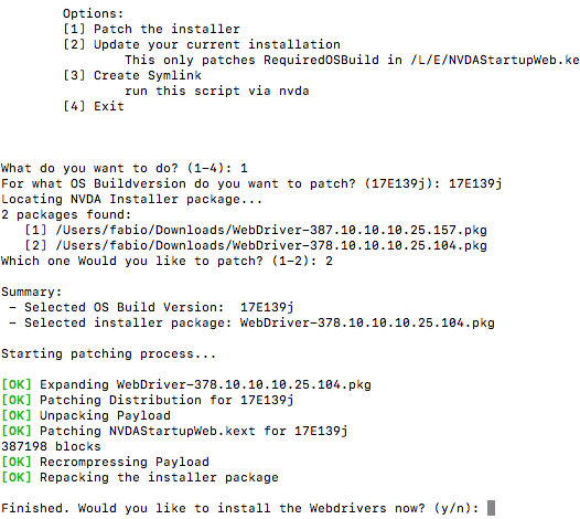

bbmatias3 Posted February 4, 2018 Share Posted February 4, 2018 in my rig no But I have not your problem with any driver I tested from 104 to 157 so could it be different okay ill report back thanks installer: Error - Mac OS X version 10.13.4 (17E139j) is not supported with this package. Please see NVIDIA’s website for further driver information. [ERROR] Unable to start the installation after i used the webpatcher. Link to comment Share on other sites More sharing options...
Guest Posted February 4, 2018 Share Posted February 4, 2018 (edited) okay ill report back thanks installer: Error - Mac OS X version 10.13.4 (17E139j) is not supported with this package. Please see NVIDIA’s website for further driver information. [ERROR] Unable to start the installation after i used the webpatcher. 104 https://we.tl/hhAChdWCLg I think you have to insert in a correct way OSX version which driver do you want to try? 157 https://we.tl/JIGk7evVdI Edited February 4, 2018 by Guest Link to comment Share on other sites More sharing options...
bbmatias3 Posted February 4, 2018 Share Posted February 4, 2018 104 https://we.tl/hhAChdWCLg I think you have to insert in a correct way OSX version which driver do you want to try? 157 https://we.tl/JIGk7evVdI Yes I’ll give it another go thanks!! 157 worked! 1 Link to comment Share on other sites More sharing options...
