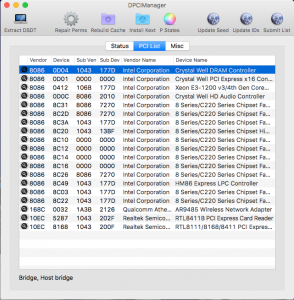

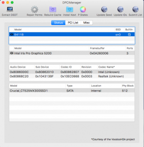

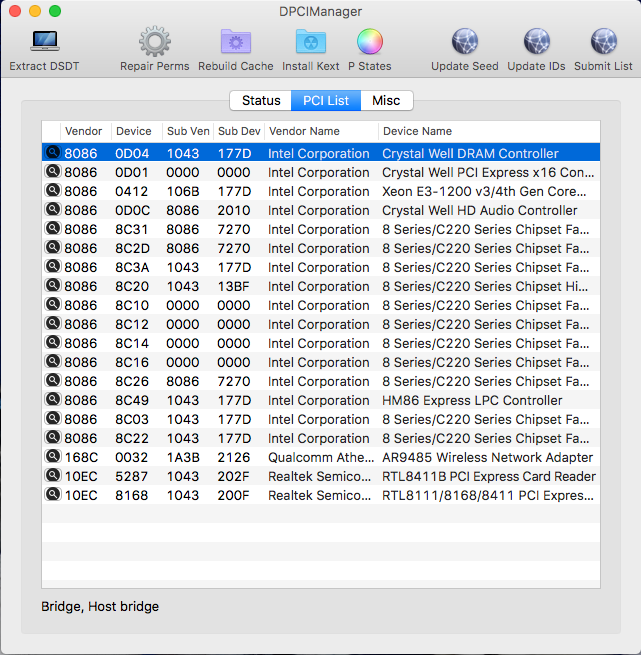

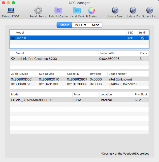

gengik84 Posted August 9, 2017 Share Posted August 9, 2017 Scarica DPCIManager.zip fai una foto alla parte status e PCI list postale entrambe Link to comment https://www.insanelymac.com/forum/topic/326027-sierra-su-asus-n551jw-laptop/#findComment-2476814 Share on other sites More sharing options...
gianni74 Posted August 9, 2017 Author Share Posted August 9, 2017 Ecco qui le due foto Link to comment https://www.insanelymac.com/forum/topic/326027-sierra-su-asus-n551jw-laptop/#findComment-2476819 Share on other sites More sharing options...
gengik84 Posted August 9, 2017 Share Posted August 9, 2017 Metti questo kext in EFI , riavvia e prova il lettore SD Sinetek-rtsx.kext.zip 1 Link to comment https://www.insanelymac.com/forum/topic/326027-sierra-su-asus-n551jw-laptop/#findComment-2476822 Share on other sites More sharing options...
gianni74 Posted August 9, 2017 Author Share Posted August 9, 2017 Grande, funziona Link to comment https://www.insanelymac.com/forum/topic/326027-sierra-su-asus-n551jw-laptop/#findComment-2476834 Share on other sites More sharing options...
