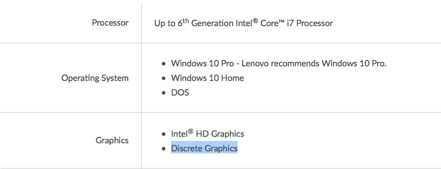

gengik84 Posted June 19, 2017 Share Posted June 19, 2017 luky35 you read about nvidia? Link to comment https://www.insanelymac.com/forum/topic/324458-help-boot-with-lenovo-m900z/page/6/#findComment-2447306 Share on other sites More sharing options...
luky35 Posted June 19, 2017 Author Share Posted June 19, 2017 luky35 you read about nvidia? I read post # 118 and # 120, just do not know what to do to try. Link to comment https://www.insanelymac.com/forum/topic/324458-help-boot-with-lenovo-m900z/page/6/#findComment-2447319 Share on other sites More sharing options...
gengik84 Posted June 19, 2017 Share Posted June 19, 2017 You know what nvidia models do you have? Link to comment https://www.insanelymac.com/forum/topic/324458-help-boot-with-lenovo-m900z/page/6/#findComment-2447325 Share on other sites More sharing options...
luky35 Posted June 19, 2017 Author Share Posted June 19, 2017 Where should I look in the BIOS is nowhere nVidia http://shrani.si/f/3d/jl/1jAaBgcd/biosvideo.png http://shrani.si/f/2Y/5L/119kHqp4/graphic.png Intel HD-530.zip Link to comment https://www.insanelymac.com/forum/topic/324458-help-boot-with-lenovo-m900z/page/6/#findComment-2447330 Share on other sites More sharing options...
