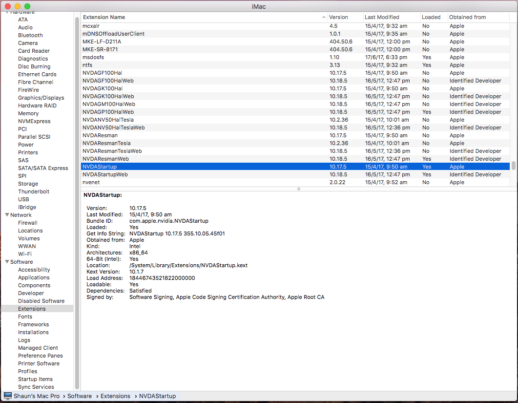

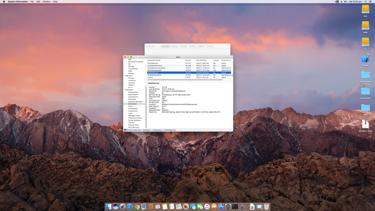

bbmatias3 Posted June 23, 2017 Share Posted June 23, 2017 For which problem? are you using a nvidia graphics card? are you still hitting space and all those commands? once your system is up and running you don't need them only bus ratio and npci. and if you have installed the web drivers use nvidia web. sometimes it hangs for me so i have to try to boot couples times Link to comment https://www.insanelymac.com/forum/topic/324392-ryzen-clover-installation-guide-macos-sierra/page/12/#findComment-2450435 Share on other sites More sharing options...

bbmatias3 Posted June 24, 2017 Share Posted June 24, 2017 You are getting more FPS than my GTX 1070 (around 45fps). Wth is going on with these webdrivers...as of now i belief that there is no solution i've been looking for a way for the last couple days and nothing i guesss we just have to wait till the web drivers are updated. i also was able to test a gtx 970 and i got around 48fps and heaven benchmark struggled like my gtx 1080tihttps://youtu.be/KE0bhLF72Zs Link to comment https://www.insanelymac.com/forum/topic/324392-ryzen-clover-installation-guide-macos-sierra/page/12/#findComment-2450585 Share on other sites More sharing options...
Martimar Posted June 24, 2017 Share Posted June 24, 2017 as of now i belief that there is no solution i've been looking for a way for the last couple days and nothing i guesss we just have to wait till the web drivers are updated. i also was able to test a gtx 970 and i got around 48fps and heaven benchmark struggled like my gtx 1080ti I believe i may have found the issue... I was digging around looking for OpenGL versions (trying to see if it's using nVidia OpenGL version perhaps?) and i come across this: Notice how it says "Loaded: No" Clearly it's loaded as i am getting graphics acceleration within OS X. I'm getting 34.8fps in Cinebench and roughly 25 - 30fps in Heaven benchmark. Could it be that os x isn't fully loaded the web drivers? Anyone know any trick to getting this to work? @Gigamaxxx can you post a screenshot like mine? You have no issues with your graphics, right? Edit: i rewrote nvda_drv=1 into my nvram (sudo nvram nvda_drv=1 in terminal) and rebooted. I then went to Graphics Injector area within clover and renamed my GPU to Gigabyte GTX 970 (just messing around here) I then rebooted back into Os X and it seems it has now loaded my nvidia driver fully, slight increase in FPS on all apps but it is still only at 40.93fps in cinebench. There has to be something else holding this back. I did also see Apple's nvidia driver also loaded as well as the nvdaweb driver, both have DIFFERENT versions. Could this be it?! See screenshot: 2 Link to comment https://www.insanelymac.com/forum/topic/324392-ryzen-clover-installation-guide-macos-sierra/page/12/#findComment-2450627 Share on other sites More sharing options...
gills83 Posted June 24, 2017 Share Posted June 24, 2017 as of now i belief that there is no solution i've been looking for a way for the last couple days and nothing i guesss we just have to wait till the web drivers are updated. i also was able to test a gtx 970 and i got around 48fps and heaven benchmark struggled like my gtx 1080ti https://youtu.be/KE0bhLF72Zs OpenCL is not OpenGL Cuda GPU is good for DirectX and OpenCL Link to comment https://www.insanelymac.com/forum/topic/324392-ryzen-clover-installation-guide-macos-sierra/page/12/#findComment-2450631 Share on other sites More sharing options...
Martimar Posted June 24, 2017 Share Posted June 24, 2017 I've been playing around some more, i've managed to get 50 fps on Cinebench now, i changed my smbios to imac14,2 wiped my nvram and entered nvda_drv=1 into it again. I gained a few extra fps in heaven benchmark, it's still not right though. I'll keep playing around.. I'm literally trying everything possible. Link to comment https://www.insanelymac.com/forum/topic/324392-ryzen-clover-installation-guide-macos-sierra/page/12/#findComment-2450633 Share on other sites More sharing options...
samaelestevez Posted June 24, 2017 Share Posted June 24, 2017 I've been playing around some more, i've managed to get 50 fps on Cinebench now, i changed my smbios to imac14,2 wiped my nvram and entered nvda_drv=1 into it again. I gained a few extra fps in heaven benchmark, it's still not right though. I'll keep playing around.. I'm literally trying everything possible.Last night I spent a lot of hours trying to find the culprit and came out empty-handed. I tried every possible smbios from macpro 4,1 and up and imac 14,1 and up (imac 15 and 17 were a challenge to get them to show image but I managed). I got nothing from trying different smbios, save probably that older macpro were ~45fps whereas newer macpro and imac gave ~55fps. I also played with the video card bios and changed its idle frequency to be near the boost frequency hoping to keep card at Max speed all the time, at the end still got the same result. One thing I noticed from this is that even if i set minimum core speed to, say 1320mhz, it wont idle higher than 486mhz (normally my 980ti idles at 135mhz). This tells me that something within macOS is still settings some limits on the card regardless of bios setting. What catches my attention is that it doesn't matter what card you have (I've seen reports here from 970 to 1080ti) everybody gets around ~50 fps. Looks to me like the drivers are limiting something. @bbmatias and @papiercul discovered that the ram bandwidth was limited, but there's many things that can cause that limitation, what is it? I don't know, but I will keep looking. Link to comment https://www.insanelymac.com/forum/topic/324392-ryzen-clover-installation-guide-macos-sierra/page/12/#findComment-2450636 Share on other sites More sharing options...
