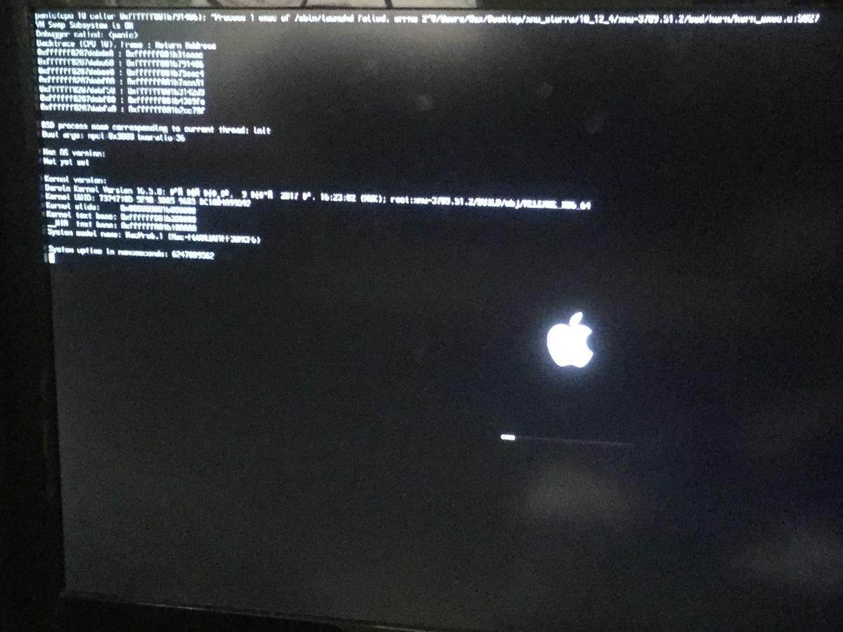

AMDCats Posted July 8, 2017 Share Posted July 8, 2017 I have prepared the hard drive using the second video after doing I got an apple and some text but within a second of it appearing it disappeared and restarted, doing the same thing. I have attached the best photo I was able to get of the text before it was gone. I am not sure why it is doing this as it seems to almost work before crashing. I am using a Ryzen 1700, GTX 1070, ASRock Fatal1ty gaming, Gskill Trident 3200 Ram and loading the OS onto a 500GB Seagate Momentus Thin SATA. Thank you Link to comment https://www.insanelymac.com/forum/topic/324392-ryzen-clover-installation-guide-macos-sierra/page/17/#findComment-2459063 Share on other sites More sharing options...
bbmatias3 Posted July 8, 2017 Share Posted July 8, 2017 IMG_0144 - Copy.JPGI have prepared the hard drive using the second video after doing I got an apple and some text but within a second of it appearing it disappeared and restarted, doing the same thing. I have attached the best photo I was able to get of the text before it was gone. I am not sure why it is doing this as it seems to almost work before crashing. I am using a Ryzen 1700, GTX 1070, ASRock Fatal1ty gaming, Gskill Trident 3200 Ram and loading the OS onto a 500GB Seagate Momentus Thin SATA. Thank you You were able to install mac is sierra on a hard drive right? So once your hard drive is done you have to replace the files mentioned in the tutorial you start off with library (mention in the tutorial post installation) then extension , framework , kernel , pre kernel (like the USB installer) after that you have to install clover in your fresh install. Once you install you should see your EFI folder mounted, you need to replace that EFI folder with the EFI from your USB pandora installer, I use pandora program (third option) to mount EFI once done just kext wizard Make sure to use correct npci and busratio and select the graphic options that apply to you Link to comment https://www.insanelymac.com/forum/topic/324392-ryzen-clover-installation-guide-macos-sierra/page/17/#findComment-2459075 Share on other sites More sharing options...

AMDCats Posted July 10, 2017 Share Posted July 10, 2017 I have managed to get to the clover screen and then all the text goes across the screen and I type the necessary commands. But then It goes to an apple screen and the bar fills a little and sits there (for 4 hours before I shut it down) and does not move at all. I am not sure what I did wrong as everything up to this point seemed to work very well. Link to comment https://www.insanelymac.com/forum/topic/324392-ryzen-clover-installation-guide-macos-sierra/page/17/#findComment-2459714 Share on other sites More sharing options...
