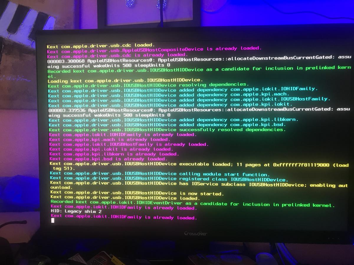

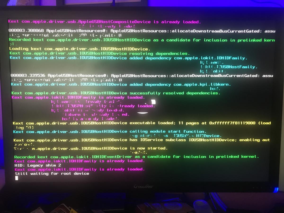

slikvic Posted July 7, 2017 Share Posted July 7, 2017 Did you use kext wizard on your pandora installer after you finish doing all the steps creating it? I don't use my front USB ports, only the directly to the mobo and only USB 3 ports. Sounds like maybe you missed a step in the USB installer??? Your almost there using usb 3 on back of computer, tried installing installer to a usb 16gb stick and a usb2 8gig stick ? i get no errors? it just gets to the white apple Step by step. this is all I'm doing: Open Pandora and select "Create Bootloader", select macOS Sierra and select install location (USB). Next, click on the Custom Kernel tab and go to top of window that pops up. Click on the Custom Kernel tab and scroll to location of your risen essentials package and select 16.5 kernel. It should appear in the window next to tab and check that you have USB and Sierra also loaded in the installer windows in Pandora. Hit "Start" button and wait (15-30 min + -). After instal is complete it will ask you if you want to instal Clover or chameleon, choose clover. When the Clover window opens check to see that UEFI and ESP boxes are checked in top left corner. Don't worry about other settings just go to bottom left and hit install. Now you have a pandora installer icon and an EFI (clover) folder on desktop. Open the EFI folder and open the Ryzen essentials EFI folder from package. Drag the Boot64EFI folder to the EFI (USB) and replace it. Next drag the Clover folder to the same EFI tab and choose replace option, don't merge this one. You should now have replaced all the clover files for the USB installer. Now, open the Pandora Installer and open the Kernel_16.5 folder packet. Open the usr folders for both windows and drag the Kernel16.5 files to the Installer usr folder and select "Merge" option. I did them one at a time, standalone, local and bin. Next, open the "System" folder on installer and then "Library" scroll to "Extrensions" folder and open. Drag the Extensions files from Kernel 16.5 folder to Installer Extensions folder tab. Choose replace option. Close Extensions folder tab when done. Open frameworks folder on Installer and got to kernel 16.5 files and drag Frameworks files one at a tine to Frameworks folder tab. you should get replace or Merge option. Choose Merge option. Close folder tab when done. Scroll to Kernel folder on Installer and open. there will be 2 kernels there, remove both top trash and drag the Kernel 16.5 kernel to installer Kernel folder tab, choose replace. Next, scroll to PreLinked Kernel folder and replace in same manner as above. ***** Now run Kext Wizzard and make sure to select the proper target disk "Pandora Installer". Take the usb installer from my MacBook place it in the risen box and.... The video has me moving the config.plist file as well Ive tried w/ moving and replacing and w/out Link to comment https://www.insanelymac.com/forum/topic/324392-ryzen-clover-installation-guide-macos-sierra/page/16/#findComment-2458516 Share on other sites More sharing options...
bbmatias3 Posted July 7, 2017 Share Posted July 7, 2017 I don't switch the plist till I'm done it seems your doing it right not sure what the issue is... I've been able to install on USB thumb drives, I followed the video except for the changing plist, once the pandora installer was finished it should have mounted the EFI folder from the USB pandora installer. Did you replace the EFI in that folder with the once provided from the package? Link to comment https://www.insanelymac.com/forum/topic/324392-ryzen-clover-installation-guide-macos-sierra/page/16/#findComment-2458522 Share on other sites More sharing options...

slikvic Posted July 7, 2017 Share Posted July 7, 2017 Slikvic pardon me I've been at work all day. I didn't find HPET on my bios either but it still worked for me. As soon as I get home I'll send you my clover folder from my installer USB. I got say its just weird that on all 3 video cards i get the same thing.. they all get through the single user verbose and die at the white apple? Link to comment https://www.insanelymac.com/forum/topic/324392-ryzen-clover-installation-guide-macos-sierra/page/16/#findComment-2458595 Share on other sites More sharing options...
bbmatias3 Posted July 7, 2017 Share Posted July 7, 2017 I got say its just weird that on all 3 video cards i get the same thing.. they all get through the single user verbose and die at the white apple? Maybe it's a problem with the pandora installer did you change the EFI ???! Like it says in the tutorial... if it was an issue with your graphic cards it would have stopped before the colored text. It would have just haulted so I doubt is that Link to comment https://www.insanelymac.com/forum/topic/324392-ryzen-clover-installation-guide-macos-sierra/page/16/#findComment-2458604 Share on other sites More sharing options...

slikvic Posted July 7, 2017 Share Posted July 7, 2017 Maybe it's a problem with the pandora installer did you change the EFI ???! Like it says in the tutorial... if it was an issue with your graphic cards it would have stopped before the colored text. It would have just haulted so I doubt is that ya know thats an interesting point.. and its the one constant in all builds maybe its corrupted or something? gonna try and re download it Link to comment https://www.insanelymac.com/forum/topic/324392-ryzen-clover-installation-guide-macos-sierra/page/16/#findComment-2458615 Share on other sites More sharing options...

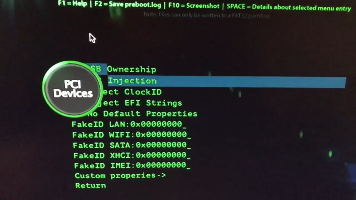

bbmatias3 Posted July 7, 2017 Share Posted July 7, 2017 I have Super IO port Disabled (pretty sure thats the serial port) Just did another clean boot loader from scratch and now I've got an error loading Do you have USB ownership enabled in the clover settings? Also you said your trying to install on USB? Make sure they are both 3.0 and directly to the mobo Link to comment https://www.insanelymac.com/forum/topic/324392-ryzen-clover-installation-guide-macos-sierra/page/16/#findComment-2458633 Share on other sites More sharing options...
slikvic Posted July 7, 2017 Share Posted July 7, 2017 Do you have USB ownership enabled in the clover settings? Also you said your trying to install on USB? Make sure they are both 3.0 and directly to the mobo where is usb ownership ? I copied your EFI folder direct so if its in your clover its in mine I overcame the error by disabling web drivers and just inject nvidia in clover, but still getting the same exact thing a split second flash and the just white apple logo with a bar thats frozen.. I reset my bios to optimal settings to see if that would help but same thing? I installed windows to see if it would work installs and cranks, installed linux it works? Im really baffled by this.. Don't get me wrong I can't compile code but i have installed os x on over 10 different computers (never an AMD box LOL ) but this is really confusing ! Link to comment https://www.insanelymac.com/forum/topic/324392-ryzen-clover-installation-guide-macos-sierra/page/16/#findComment-2458639 Share on other sites More sharing options...
bbmatias3 Posted July 7, 2017 Share Posted July 7, 2017 where is usb ownership ? I copied your EFI folder direct so if its in your clover its in mine I overcame the error by disabling web drivers and just inject nvidia in clover, but still getting the same exact thing a split second flash and the just white apple logo with a bar thats frozen.. I reset my bios to optimal settings to see if that would help but same thing? I installed windows to see if it would work installs and cranks, installed linux it works? Im really baffled by this.. Don't get me wrong I can't compile code but i have installed os x on over 10 different computers (never an AMD box LOL ) but this is really confusing ! Intel? Link to comment https://www.insanelymac.com/forum/topic/324392-ryzen-clover-installation-guide-macos-sierra/page/16/#findComment-2458646 Share on other sites More sharing options...
